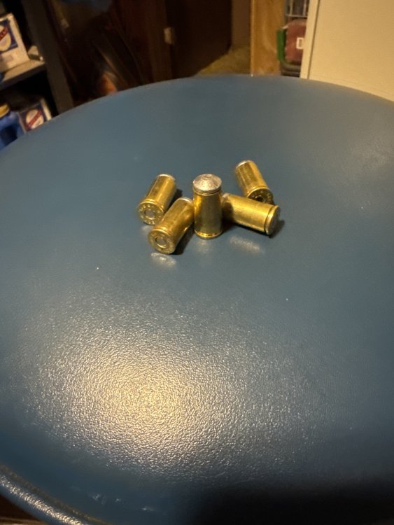

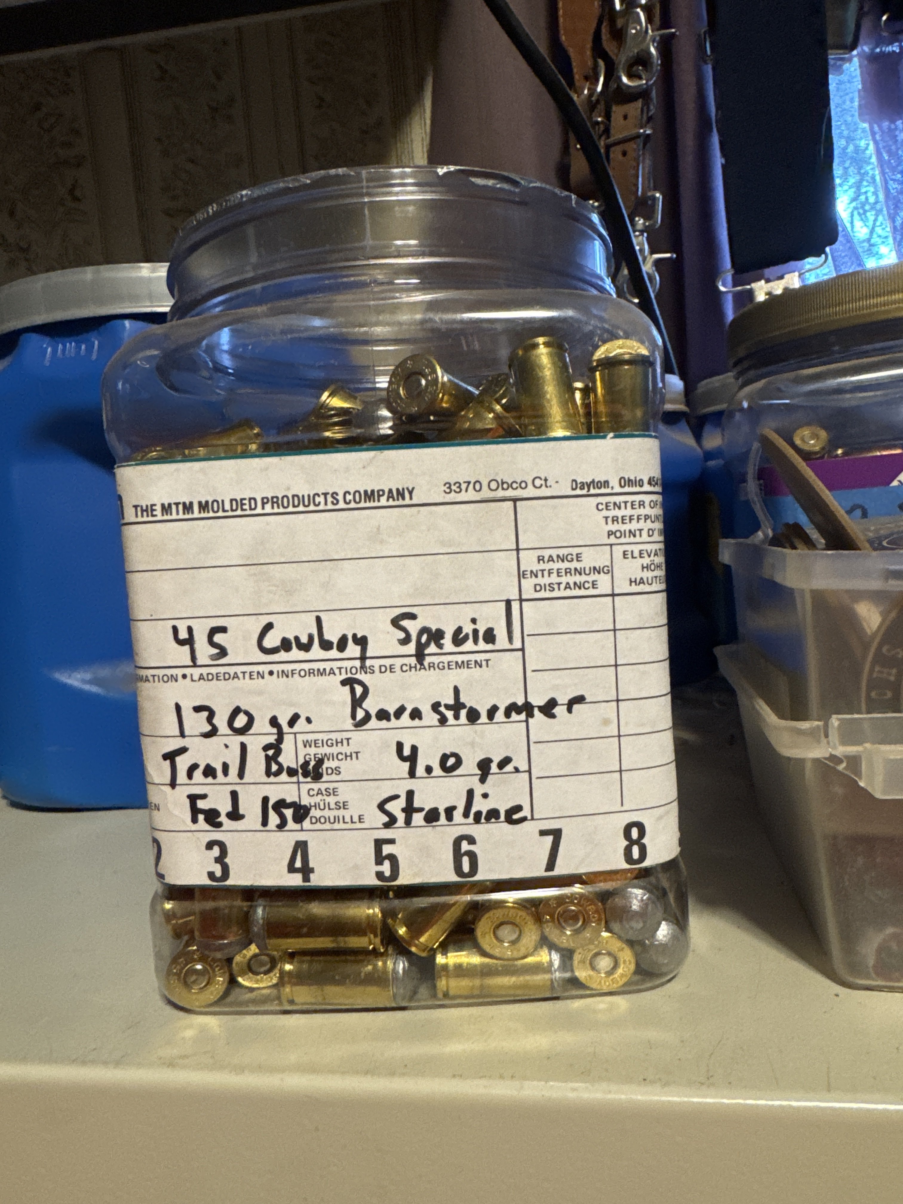

Dusty Chaps, SASS #5925 Posted October 6, 2025 Posted October 6, 2025 Howdy all. While cleaning the garage (yeah, what's that about), I found an old stash of both new and once-fired Starline 45 Cowboy Special Brass from a long ago experiment. I'm not sure why I quit. Is anybody else still using these? Quote
