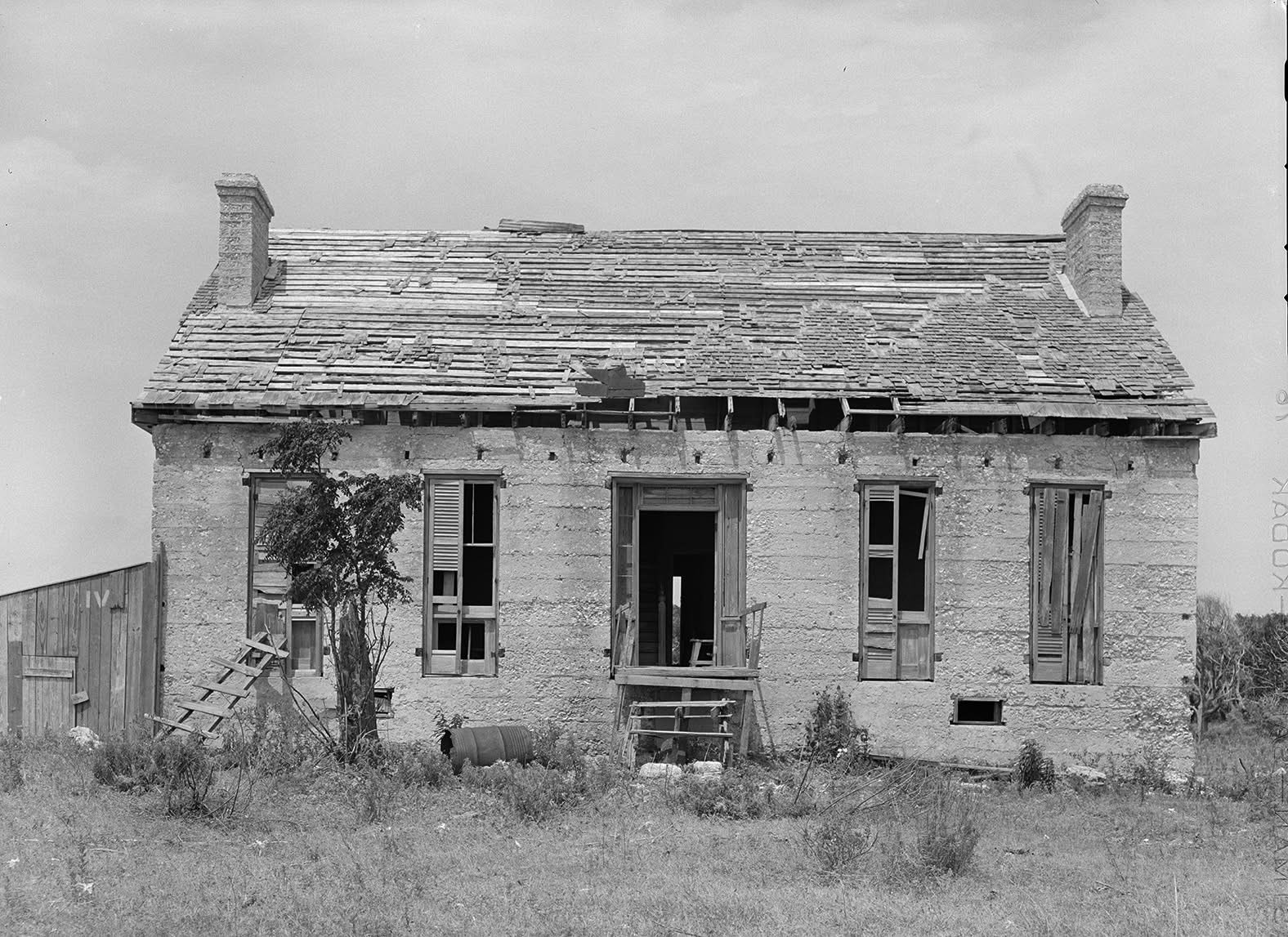

Subdeacon Joe Posted September 30, 2025 Posted September 30, 2025 This is so great I can hardly stand it. It's a house that was built by Irish immigrants out of oyster shells in 1850. The house was in Port O'Connor. John Vachon took this photo of the house in 1943, 93 years after it was built. The whole process of making houses out of oyster shells is fascinating. Here’s how it worked: people collected heaps of oyster shells, often from old middens (ancient shell piles left behind by Native peoples or settlers). The shells were burned in a kiln to create lime. When oyster shells are heated, the calcium carbonate in them turns into quicklime. That quicklime was then mixed with water, sand, and more whole oyster shells. The result was a kind of primitive concrete—strong, durable, and resistant to moisture. Builders poured this mixture into wooden forms, much like modern concrete, and let it harden. When the forms were removed, the walls had a distinctive speckled look, with oyster shells showing throughout. Over time, the surface could be plastered or whitewashed, but sometimes the shell-studded texture was left exposed. The material was especially common in coastal areas of Florida, Georgia, and the Carolinas, but it was also used in Texas and Louisiana where oyster shells were plentiful. So this house isn't literally just stacked oyster shells like bricks—it was oyster shells transformed into a concrete-like substance that could last for centuries. In fact, some oyster shell structures from the 1700s are still standing today. And some of the oyster shell structures in Texas, built in the 1800s, still stand. 1 3 Quote

Subdeacon Joe Posted September 30, 2025 Author Posted September 30, 2025 25 minutes ago, Alpo said: I wonder if they mixed it with fresh water or saltwater? Much available freshwater seems like there should be trees around. Why not cut the trees down and build a wood house? Piles of oyster shell means saltwater. They mix the lime with sand and water and more oyster shell. That sounds like the beach. Well: Quote AI Overview The water used to make oyster shell houses was freshwater. Historically, crushed oyster shells were mixed with freshwater and sometimes other materials to create a type of mortar for building. The shells themselves, however, come from oysters that live in saltwater or brackish environments. Here is a breakdown of the materials: Oyster shell: The primary ingredient came from oysters harvested from the sea. Freshwater: This was added to the crushed shells to create a mortar or concrete-like mixture. Other materials: Sometimes lime was added, but since oyster shells are primarily calcium carbonate, they could be used as the lime-rich ingredient in concrete. The resulting shell-based mortar was particularly common in coastal regions, such as the Eastern Shore of the United States, where oysters were abundant. My guesses are: 1.) The trees, for the most part, aren't suitable for construction. 2.) To conserve good lumber for other uses. 3.) You don't need to dress the cement walls to make them fit. 4.) You don't need to chink the walls to keep the wind out. 1 Quote

Ozark Huckleberry Posted October 1, 2025 Posted October 1, 2025 (edited) Tabby construction -- brought to the New World by Spanish settlers in the 16th century. The oldest tabby ruins in St Augustine are at Mission Nombre di Dios (c. 1670s). The Father Miguel O'Reilly House Museum was built in late 17th century. Edit to add: Based on the absence of vertical seams on the Irish immigrant house, I'd guess that instead of being built brick-by-brick, it was built with the more common method of the tabby being poured in place. Forms were built to pour one layer of the wall, when the material hardened the forms would be removed and shifted up to pour another layer. Repeat until the walls were as tall as you wanted them. Edited October 1, 2025 by Ozark Huckleberry 3 Quote
Pat Riot Posted October 1, 2025 Posted October 1, 2025 Portland cement contains lime so it makes sense that oyster shells would make a good “concrete”. Interesting article. Thanks Joe. 1 Quote
