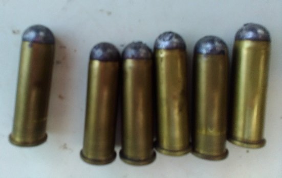

Todd Hayseed Posted September 24, 2025 Posted September 24, 2025 4 hours ago, Dapper Dave said: ...38 Smith and Wesson...loaded with 5 gr of OE 3F. Great "gallery load". There's a 1/3 over powder card and a lubricated wad, both from Track of the Wolf. .38 Special, 18 grains of my own powder, card wad cut from a Ritz cracker box, a "grease cookie" made of pan lube, and a OOO Buckshot. I can fire 60 of these without having to swab or really clean anything. They do not lead the bore. These are crimped in a Dillon SDB and the ball stays in place. I usually tumble the completed rounds in my dry tumbler that makes them all shiny but these haven't had that treatment. It doesn't make them any more functional they just look better. These .38 special have an OAL of 1.33 and I use them in revolvers. Same load in a .357 case has an OAL of 1.42 or 1.46 and cycles in a lever action just fine. Most of these are loaded sprue down and are 1.42 but one out of three of the bullets my buckshot mold casts has a sprue on both sides and those wind up being 1.46. White River "factory second" primers, my own BP and a 70 grain buckshot makes the entire round cost less than a nickel. The 18 grains of powder gets the power factor over 60 but still under 1,000 FPS. Though I have since been told power factor doesn't apply to black powder loads. Well in my case it works anyway!
La Sombra Posted September 24, 2025 Posted September 24, 2025 5 hours ago, Dapper Dave said: ...38 Smith and Wesson...loaded with 5 gr of OE 3F. Great "gallery load". There's a 1/3 over powder card and a lubricated wad, both from Track of the Wolf. DD, Just to confirm that the load is 38 S&W not 38 Special. If so great idea! La Sombra
Dapper Dave Posted September 24, 2025 Posted September 24, 2025 Yes, .38 SW due to the 000 Buck being .360 diameter, makes a dandy zero recoil load for my Iver Johnson Second Model and Da Boys Harrington and Richardson "America". Both are guns rescued from bar wall plaques by an expert gunsmith who put them back in working order. Shot close range with the Iver - NOT a long range load. The black splotches are from my first loads, which had lube over ball. The new ones I use a thin overshot card and a lubed wad under the ball, almost not enough room for everything! Da Boy shooting them in his Harrington and Richardson at 10 yards. The group at 10 yards.
