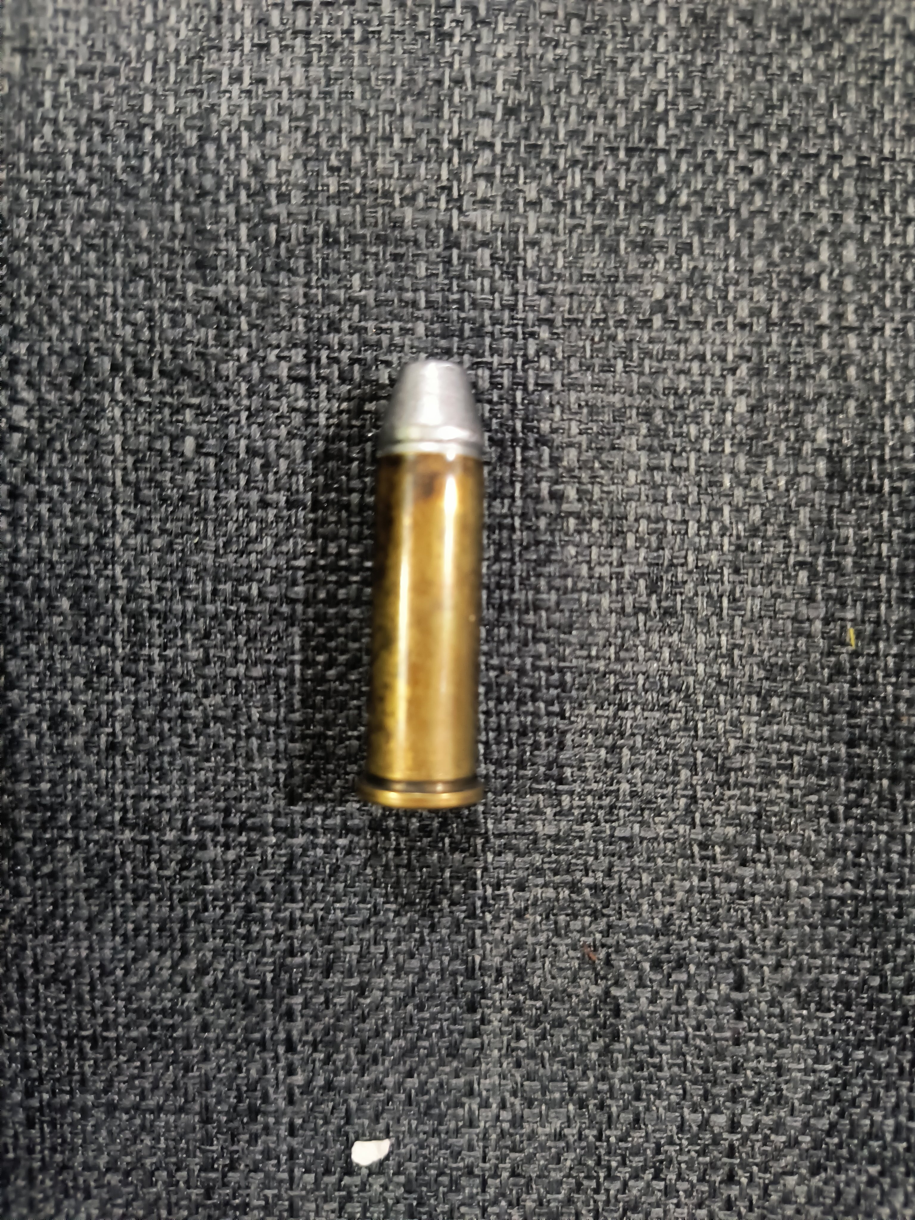

Todd Hayseed Posted September 20 Posted September 20 6 hours ago, Jackalope said: Three grains of Bullseye and a 125 grain Lee TCFP bullet in a .38 Special case registers 711 fps from a 4 5/8 inch Ruger Vaquero and 895 fps from a 20 inch 1873. Regardless of powder - I can't get a 125 TCFP bullet to work in a .38 special case. Fine in a revolver, but my rifle double feeds those, they are too short. They work for you? 1 Quote
Tye Riverman, SASS #41433 Posted September 20 Posted September 20 8 minutes ago, Todd Hayseed said: Regardless of powder - I can't get a 125 TCFP bullet to work in a .38 special case. Fine in a revolver, but my rifle double feeds those, they are too short. They work for you? I load them long, 1.48 or so. Just crimp in the driving band. YMMV Tye 1 1 Quote
Boggus Deal #64218 Posted September 20 Posted September 20 15 minutes ago, Todd Hayseed said: Regardless of powder - I can't get a 125 TCFP bullet to work in a .38 special case. Fine in a revolver, but my rifle double feeds those, they are too short. They work for you? A lot of folks load 105 gr bullets and use them in rifles. As mentioned, load them long. 2 Quote
Jackalope Posted September 20 Posted September 20 2 hours ago, Todd Hayseed said: they are too short. They work for you? My bride has not mentioned otherwise, but I do intend to load that bullet/powder combination in .357 Magnum cases to see if there's a noticeable difference. It seems that a longer overall length would be beneficial... 1 1 Quote
Edward R S Canby, SASS#59971 Posted September 20 Posted September 20 My family has three rifles that feed smoother with .357 mag cases. Give them a try. 1 Quote
Branchwater Jack SASS #88854 Posted September 20 Posted September 20 3 hours ago, Todd Hayseed said: Regardless of powder - I can't get a 125 TCFP bullet to work in a .38 special case. Fine in a revolver, but my rifle double feeds those, they are too short. They work for you? Out of three rifles, we have one that has a bit of a hiccup. We load them to 1.465 in. That seems to work well for us 1 1 Quote
Sheriff Dill Posted September 20 Posted September 20 I load 125 gr .38’s at 1.45 for both pistols and rifles. 1 Quote

Beartrap SASS#57175 Posted September 20 Posted September 20 If you load outside the crimp groove on a bullet (or if it doesn't have one) the Lee Factory Crimp die does a wonderfull job Just make sure you get the .38 ROLL crimp die (they also make a .38 taper crimp die). Quote
wyliefoxEsquire Posted September 20 Posted September 20 For rifle we use 125 Bear Creek, no crimp groove, so crimp that works for you. 2.5 grains Clays or Clay Dot. 1.500 COL prevents this 45 minutes ago, Garrison Joe, SASS #60708 said: The problem - as cartridge length gets shorter, the second round coming out of the magazine hangs up because the carrier's cartridge return ramp can't catch the rim on the ramp and push the second round back into the magazine. ...also make sure your primers at "seated" 1 Quote
Sam Sackett Posted September 20 Posted September 20 I run 38 special and 357 mag casings to the same loaded cartridge length. 1.535”. My 1892 likes this length, so I stick to it, using 3.0 of Bullseye for 125 or 158 grain bullets. As mentioned, it leaves a soot film on 5he casing, but it cleans right up. No problems…. Sam Sackett 1 1 Quote
