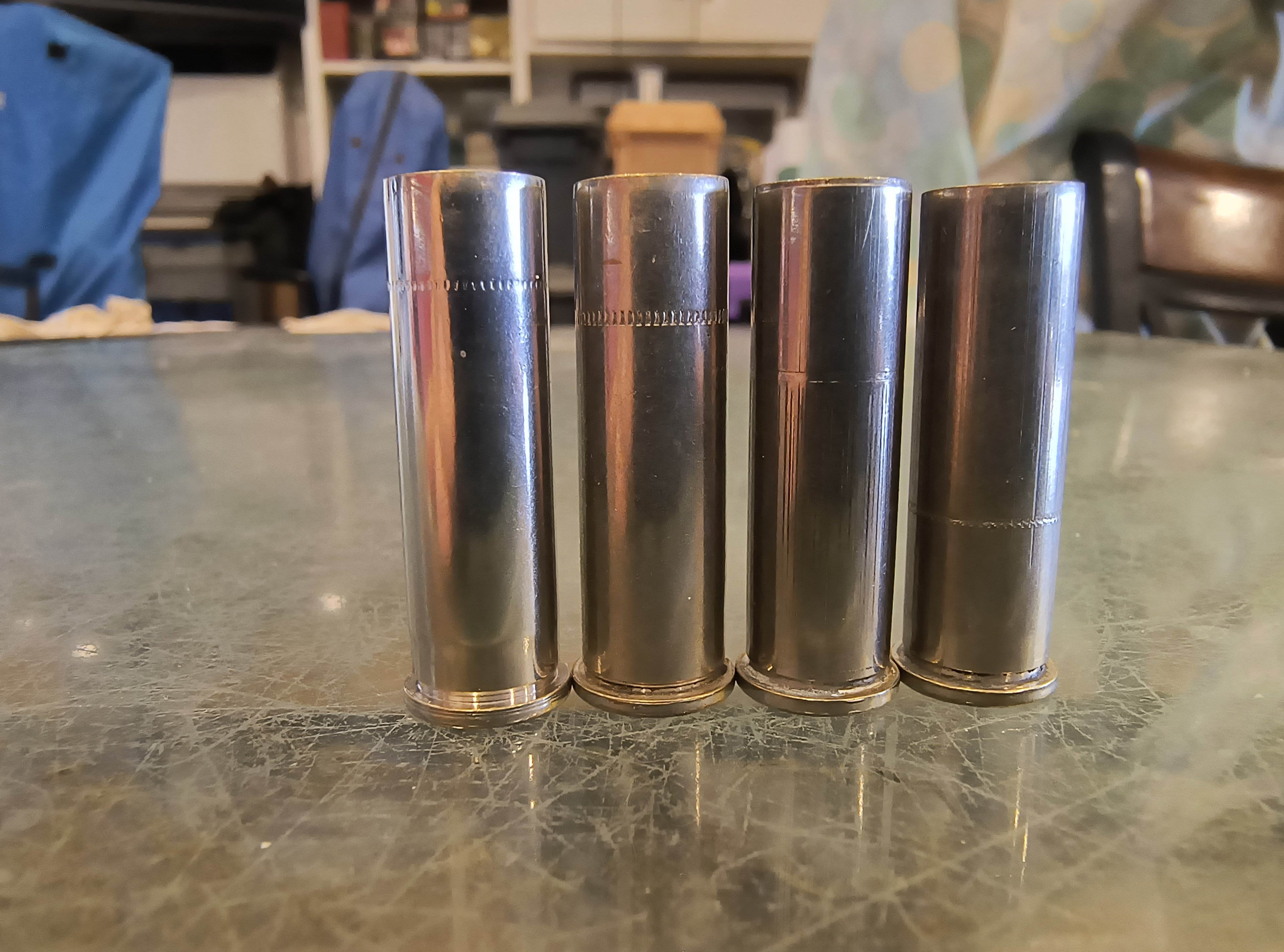

Chas B. Wolfson, SASS #11104 Posted September 19, 2025 Posted September 19, 2025 Recently a good friend was telling me that his wife's rifle had a case separation. 38spl case. With that conversation in my mind, I got to thinking and the three watt bulb in my brain flickered on. Is there any real, factual proof that the cannelure on a case is a primary factor to separation in the chamber? In all the years of participation in this sport, Annie has had only one instance of this happening. That separation occurred at the very base of the case where the body meets the solid part of the case. And yes, she has always used nickel cases shooting BP due to easier case cleaning. 357mag in rifle, 38spl in pistols. There is a lot of conjecture out there but is there any real substantiation? Chas B Quote
Gateway Kid SASS# 70038 Life Posted September 19, 2025 Posted September 19, 2025 I have very limited experience with case separation. None in my guns (knock on wood), but I have personally seen three in about 16 years. 1. ALL were traditional brass, not nickel plated. 2. Only 1 separated at the cannelure, the other two were nearer the base of the shell. All separated in the rifle. 3. All were well used (older) brass that had been used for cowboy ammunition exclusively. Hence lower pressure but reloaded a lot. Don’t know how many times. 4. Per the shooters involved none had been trimmed over their life cycle. I have never trimmed my own cowboy brass but I suspect for those who do that would be an opportune moment to see precursor damage to the case. 5. I DO inspect for cracks and shiny spots, anywhere on the case, on brass I get back at the unloading table, after I separate it from my dry tumbling media, as it is going through the reloading machine, as I put it into strips and lastly when I load my guns. BTW my alias to my alias is OCD Kid. 6. ANY brass, nickel or traditional, that has even a tiny crack anywhere on the case hits the recycle bucket. I have plenty and it’s cheap insurance to avoid what could be a serious problem. Possibility that it could happen but I do what I can and so far been successful. YMMV Regards Gateway Kid 3 2 Quote
Sarge Posted September 19, 2025 Posted September 19, 2025 My wife has had three in her .38spl. rifle in four years. All three were cases with cannelures. I now throw them out when I come across them. Haven't had a separated case since. 4 Quote
Garrison Joe, SASS #60708 Posted September 19, 2025 Posted September 19, 2025 I've seen and helped remove three circumferential case separations in .38 special (firing) rifles. Where a ring breaks off and sticks in the chamber. 2 were nickle plated cases, one brass. All three occurred at a cannelure. I've seen many more longitudinal case splits, though, that seem to happen with nickle and brass cases in a mix that is similar to the cases that the shooter has loaded. If a case separation is a game killer for you, don't use nickle or cannelured cases in your rifle. Shoot 'em up in revolvers. If you clean fired BP cases within a day and get all fouling and corrosion off the OUTSIDE of the case, there is no reason you need to be using nickle cases! good luck, GJ 3 Quote
C. W. Knight # 47289L Posted September 19, 2025 Posted September 19, 2025 Chas, I have had two. Both .38 sp, one was a RP with cannelure amidships, and the first one I don't know because we never found the base. After the second I have never used any brass with mid case cann's. I regulate those for pistols. C.W. Quote
I. M. Crossdraw, SASS# 8321 Posted September 19, 2025 Posted September 19, 2025 I've had two and they are also 38 spl. I load them on my pistol whenever I see a cannelure on the cases. It is easier to extract split case from a pistol than a rifle. There is no way to predict When it can happen but if it does, hopefully it's not on the day of a major match. Quote
Go West Posted September 21, 2025 Posted September 21, 2025 (edited) I had two in .38 special nickel with cannelures that separated at that location. They ruined my match to say the least. I chucked all nickel cases that I found in my supply and any that found their way to me since and have had zero splits thereafter. Edited September 21, 2025 by Go West 1 Quote

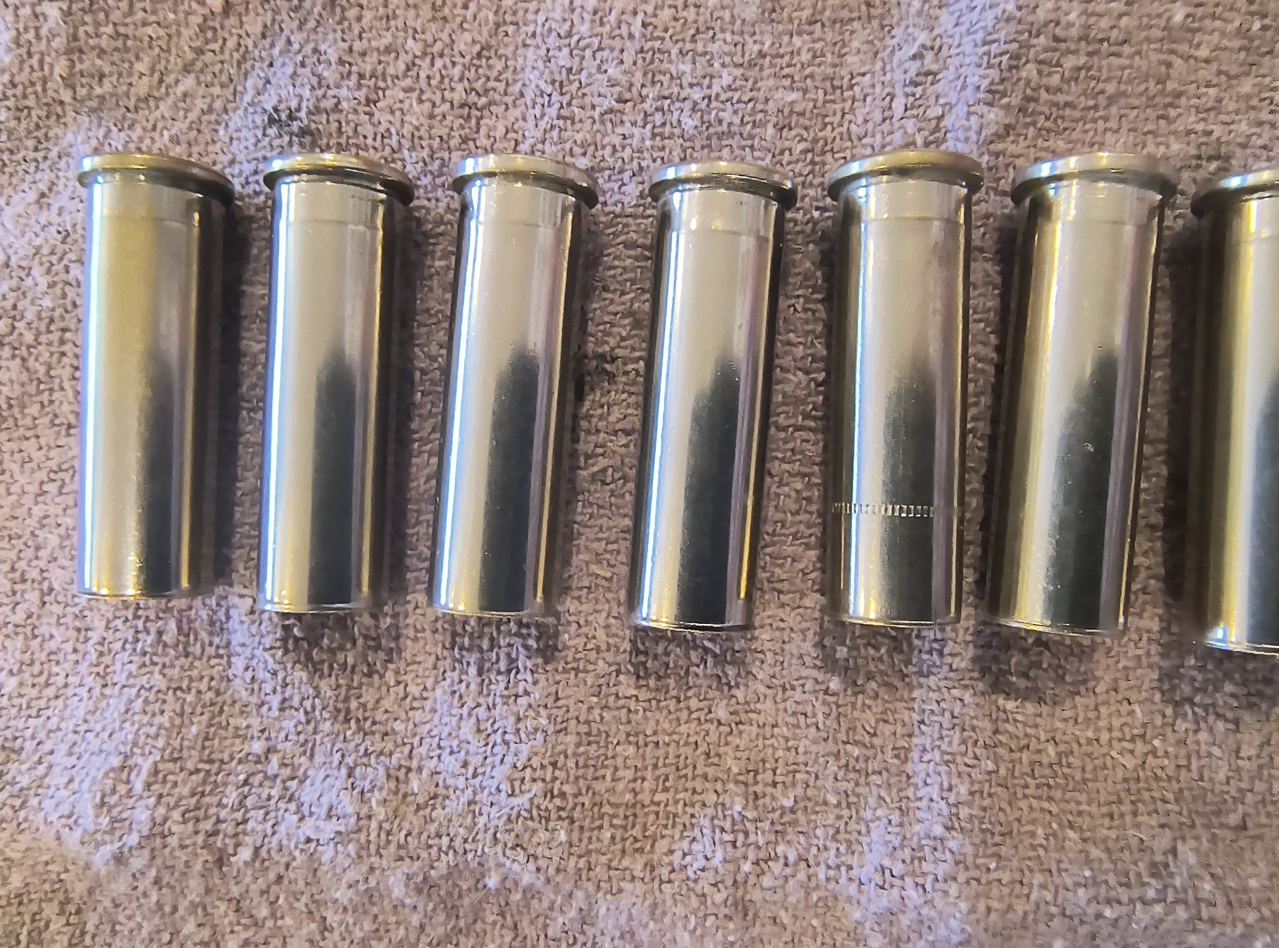

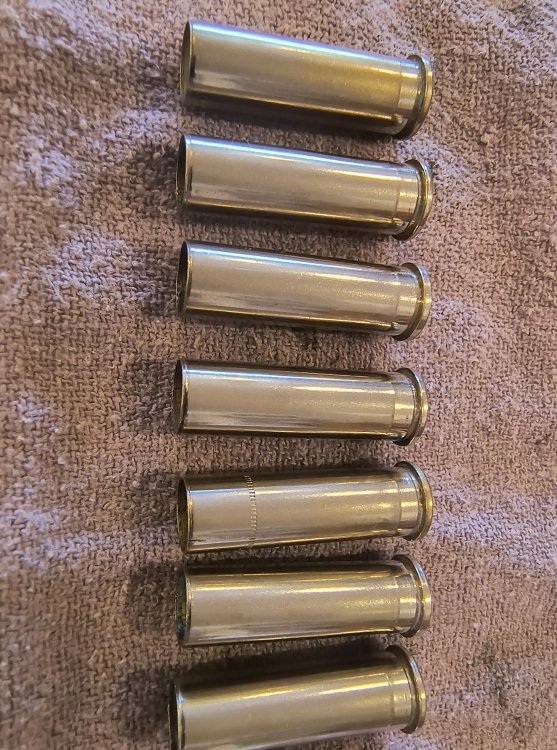

Chas B. Wolfson, SASS #11104 Posted September 21, 2025 Author Posted September 21, 2025 The following pics show where I have witnessed case separation. The case body meets the base/web of the case. 1 Quote
Garrison Joe, SASS #60708 Posted September 21, 2025 Posted September 21, 2025 5 hours ago, Chas B. Wolfson, SASS #11104 said: pics show where I have witnessed case separation. Wow, that is not something I've seen before. First, is your chamber in good shape? Examine with a good flashlight and look at chamber walls closely. Almost seems like your chamber is oversized - has it been heavily honed for some reason? I'd "chamber cast" that chamber with CerroSafe alloy and see if it is over-diameter. You can get that alloy from Midway or Brownells, and it melts over boiling water. Follow instructions to make the casting and then wait correct time after solidification to measure the diameters. A .38 special chamber should not be any larger than 0.385" diameter near the base of the cartridge. Down to 0.381" would be the minimum chamber diameter (but you are not having problems at that end of chamber size, where chamber is tighter than normal). The base end of the case is of course fairly thick, the walls are thin and can expand into an oversize chamber. Looks like your sizing die is reducing most of the case down to normal diameter, and the bottom of sizer die stops where that line and slight bulge shows on the cases in your pic. About three or four cycles of major expansions (during firing) then reducing diameter (when sizing) could be work hardening your brass and leading to an early separation right at the transition from head of case to thin wall. good luck, GJ Quote
Chas B. Wolfson, SASS #11104 Posted September 21, 2025 Author Posted September 21, 2025 (edited) 1 hour ago, Garrison Joe, SASS #60708 said: Wow, that is not something I've seen before. First, is your chamber in good shape? Examine with a good flashlight and look at chamber walls closely. Almost seems like your chamber is oversized - has it been heavily honed for some reason? I'd "chamber cast" that chamber with CerroSafe alloy and see if it is over-diameter. You can get that alloy from Midway or Brownells, and it melts over boiling water. Follow instructions to make the casting and then wait correct time after solidification to measure the diameters. A .38 special chamber should not be any larger than 0.385" diameter near the base of the cartridge. Down to 0.381" would be the minimum chamber diameter (but you are not having problems at that end of chamber size, where chamber is tighter than normal). The base end of the case is of course fairly thick, the walls are thin and can expand into an oversize chamber. Looks like your sizing die is reducing most of the case down to normal diameter, and the bottom of sizer die stops where that line and slight bulge shows on the cases in your pic. About three or four cycles of major expansions (during firing) then reducing diameter (when sizing) could be work hardening your brass and leading to an early separation right at the transition from head of case to thin wall. good luck, GJ Brother, you are way over thinking this. Brass has been reloaded numerous times. Natural progression of stretch and resizing. The examples shown are pulled from about 2000 cases. Nothing wrong with three different rifle chambers or the sizing dies. Just old age. Thanks for your insight and remarks. We all learn every day from others. Chas B Edited September 21, 2025 by Chas B. Wolfson, SASS #11104 Quote
Assassin Posted September 22, 2025 Posted September 22, 2025 No nickle or cannelured cases in rifles. Nickle plated brass is a problem. Two different metals, they expand at different rates. That is the reason nickle plated cases split more frequently. They usually separate at the cannelure, I've seen a couple split about 1/8" above the rim. Too much head space could possibly lead to splitting near the rim because the case has no support. Cold weather, nickel does not expand in low pressure loads. I chronographed nickle and brass cases in 20 degree temps. Nickel was sometimes 150 fps slower than brass. Once I added powder or warmed the cases the velocity stabilized. 1 Quote
Garrison Joe, SASS #60708 Posted September 22, 2025 Posted September 22, 2025 5 hours ago, Chas B. Wolfson, SASS #11104 said: Nothing wrong with three different rifle chambers or the sizing dies. Just old age. Well, guess if you have no curiosity to try to find the cause, you will just have to endure a few ruptured cases. Or figure out when you have to discard cases after several firings. Best be carrying a broken shell extractor for .38s. GJ Quote
