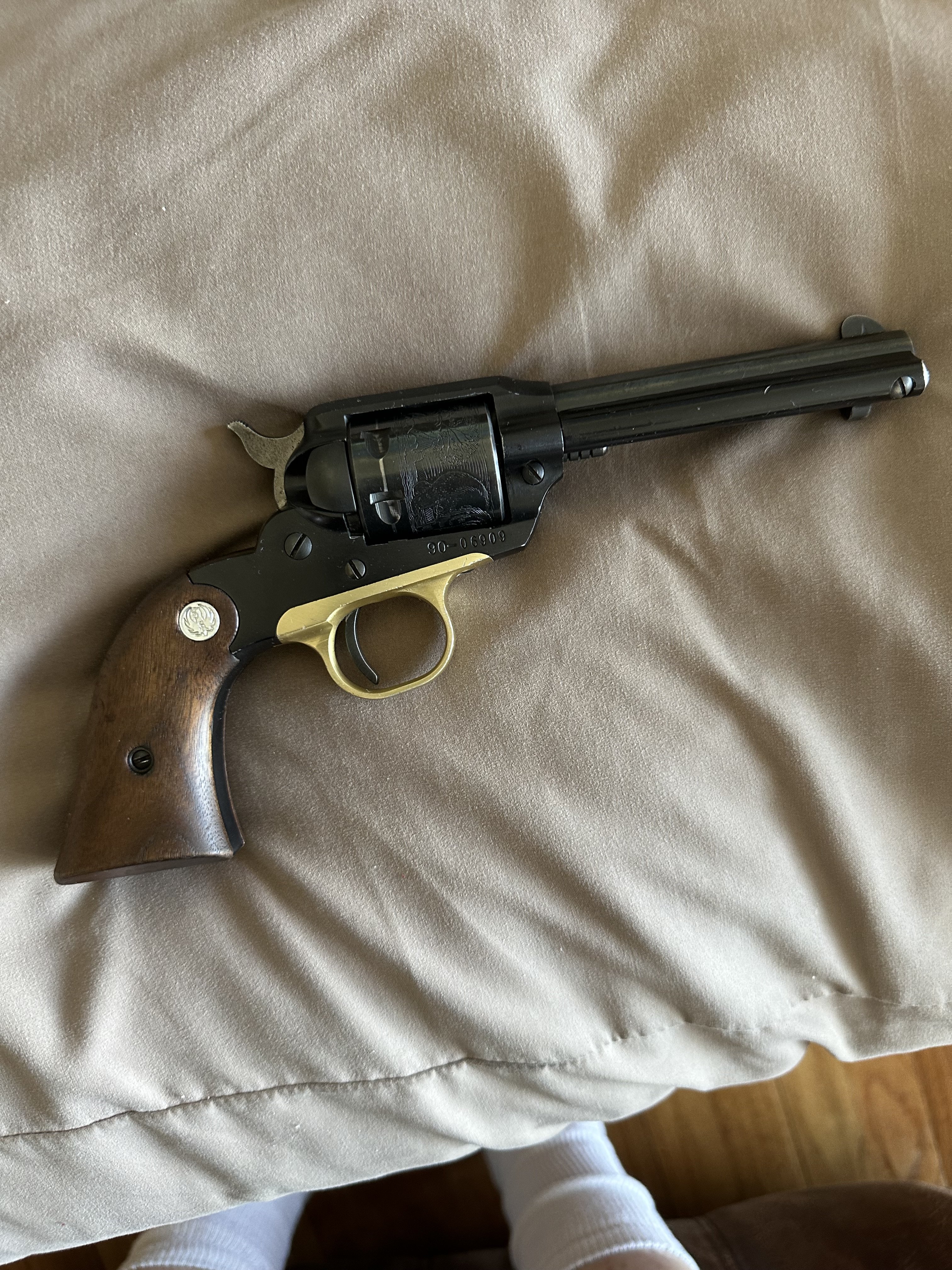

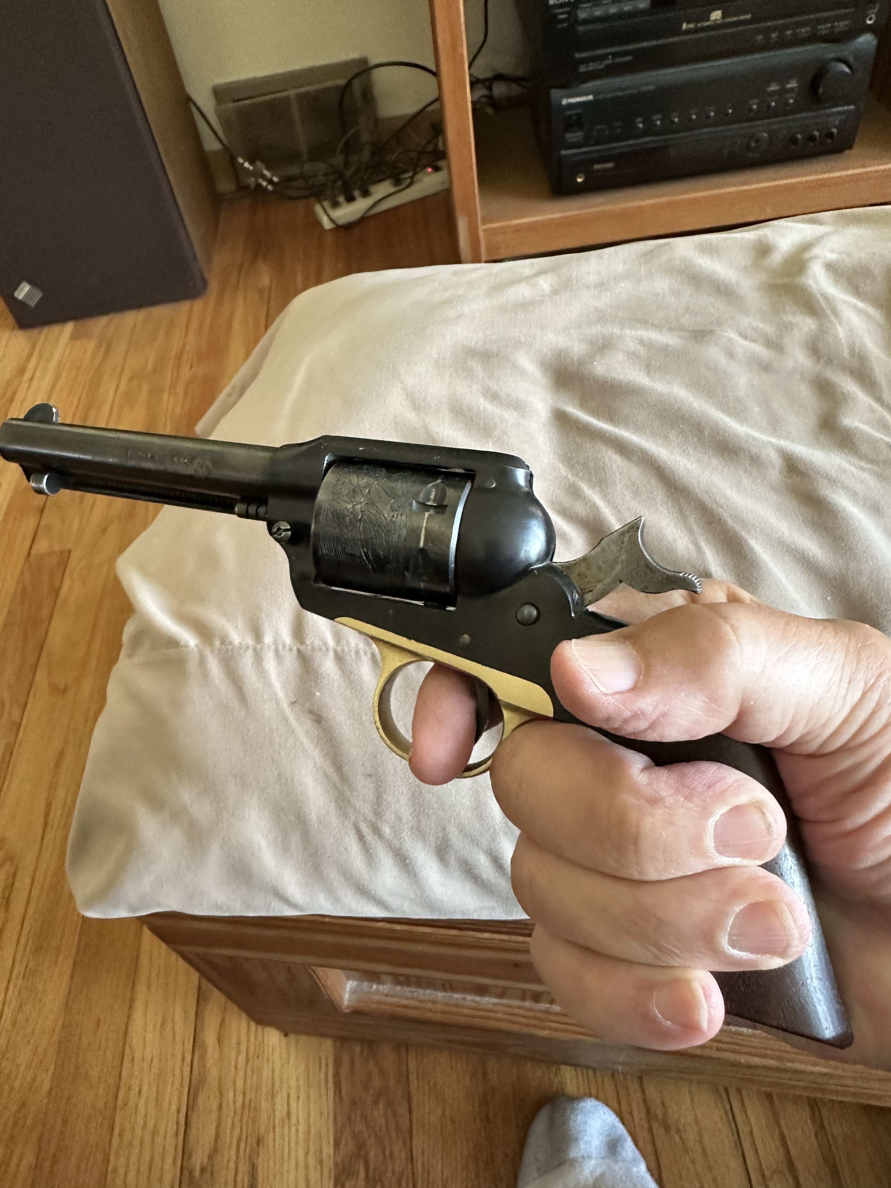

Rip Snorter Posted September 17, 2025 Posted September 17, 2025 The Lipsey exclusive Ruger Bearcat might be an interesting base gun.

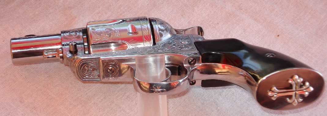

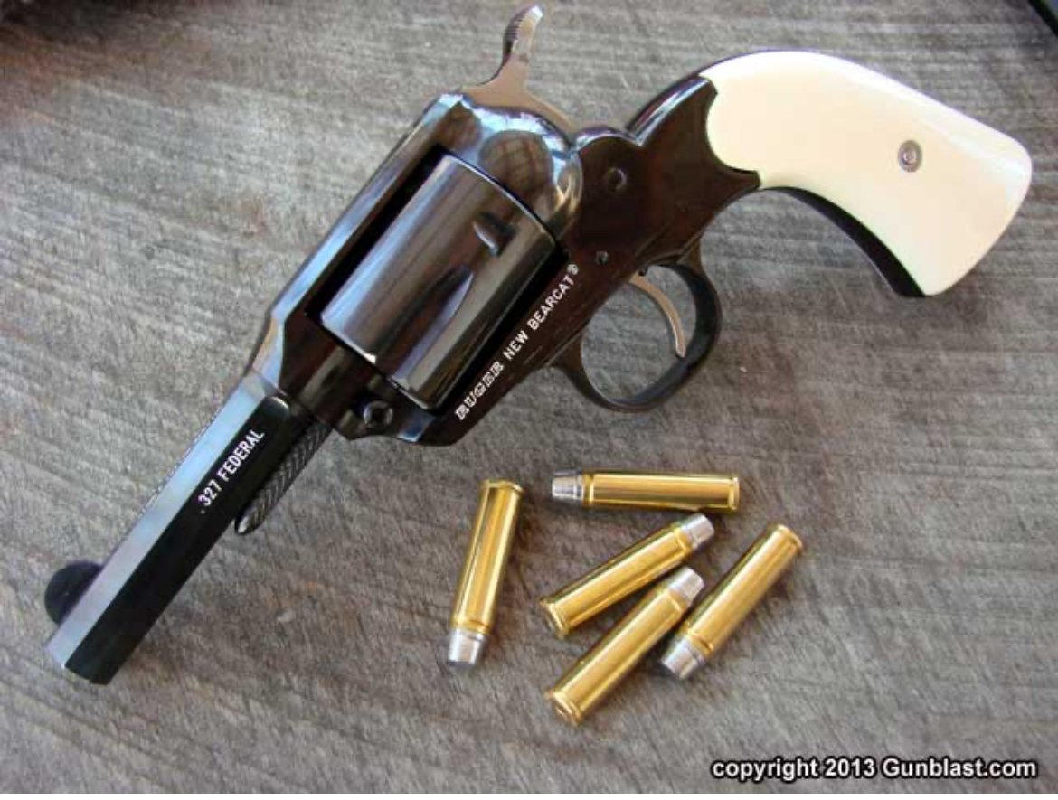

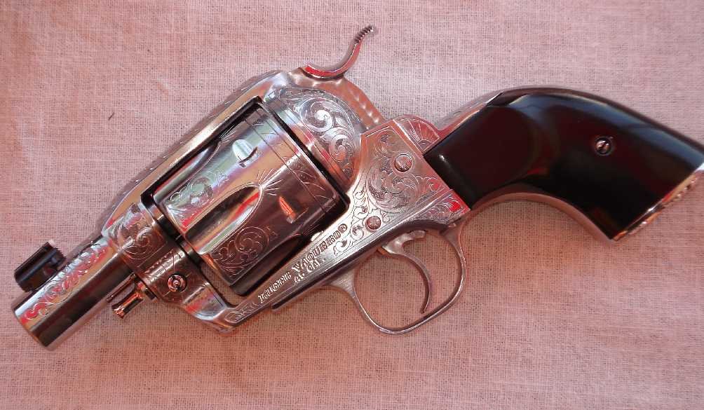

H. K. Uriah, SASS #74619 Posted September 23, 2025 Author Posted September 23, 2025 8 minutes ago, Hoss said: Ruger Bearcat to 327 Mag Ooh... That's interesting. A factory small iron. Do they still make it?
Hoss Posted September 23, 2025 Posted September 23, 2025 6 minutes ago, H. K. Uriah, SASS #74619 said: Ooh... That's interesting. A factory small iron. Do they still make it? https://www.gunblast.com/Harton-327Bearcat.htm
H. K. Uriah, SASS #74619 Posted September 23, 2025 Author Posted September 23, 2025 3 minutes ago, Hoss said: https://www.gunblast.com/Harton-327Bearcat.htm Ah, so it's a custom gun. I like it.
Hoss Posted September 23, 2025 Posted September 23, 2025 I kinda thought about one for pocket pistol side matches. Might be some question if it was PP legal. Either way, woukd be a neat little iron!
