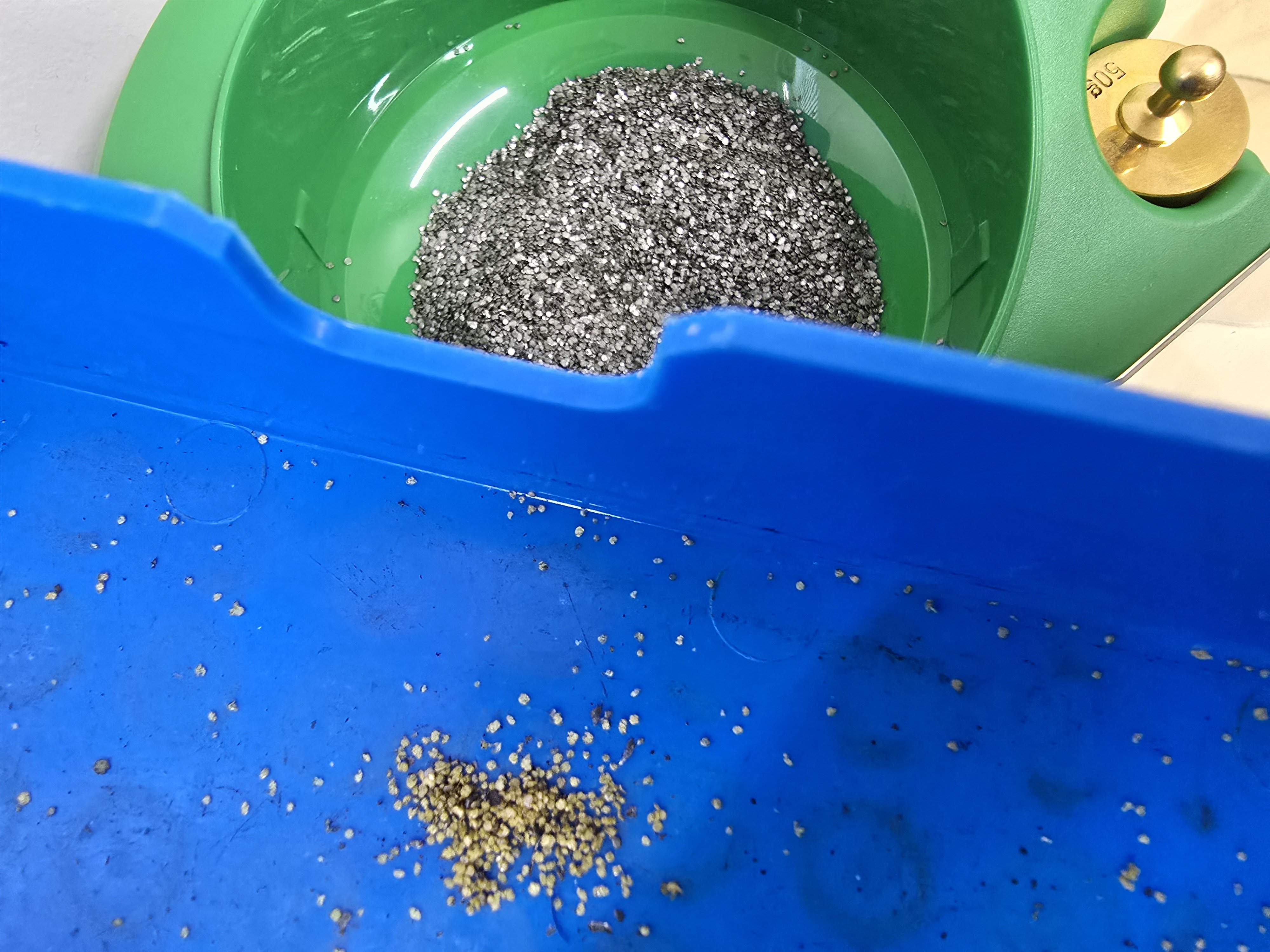

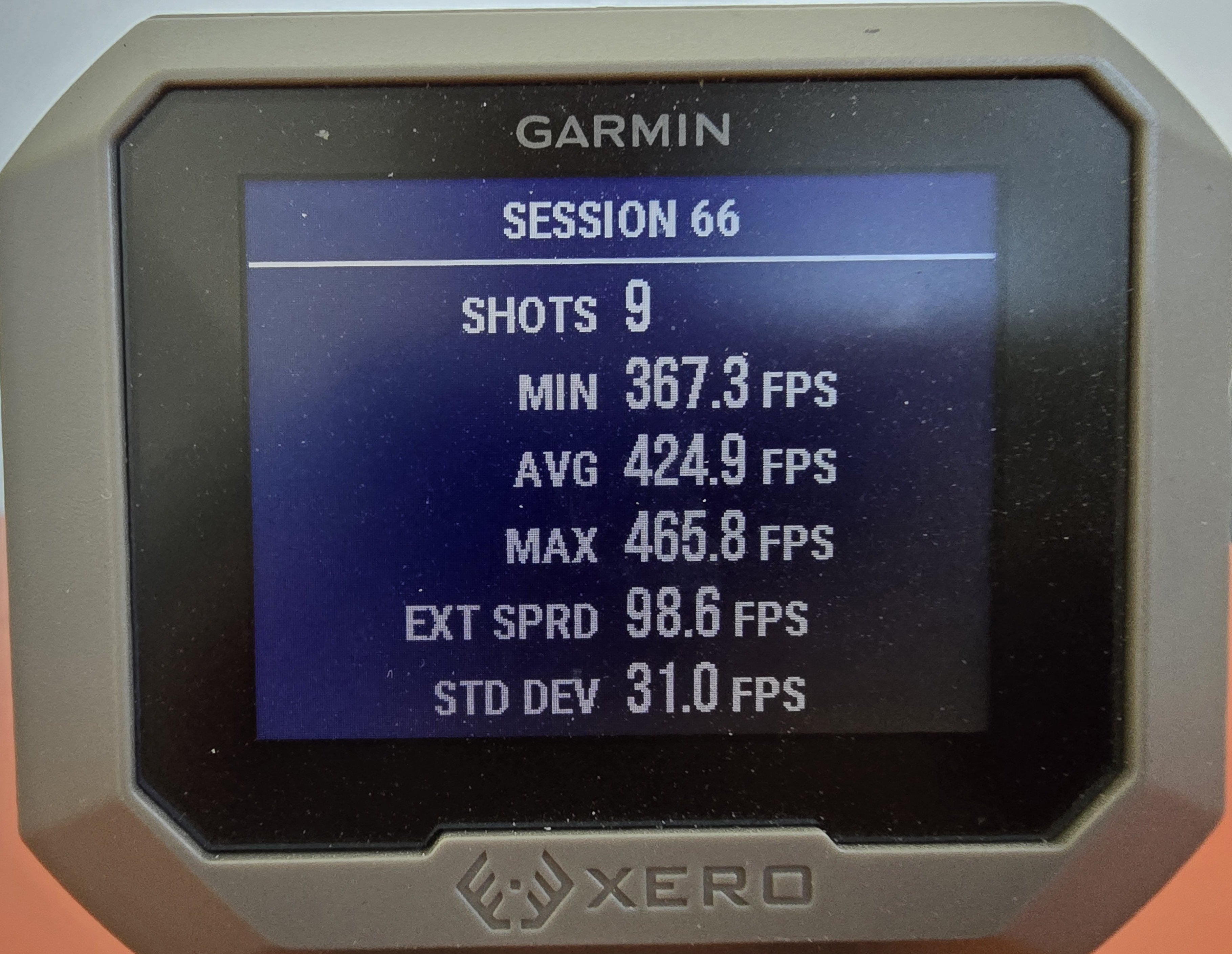

IndianCent Posted September 22, 2025 Author Posted September 22, 2025 3 minutes ago, Cholla said: Skip the cornmeal. You don't need it with C45S cases. I thought so too, but I had something grainy coming out of the fired shells...unburned powder? The color does not match. Corn Cob media? What could that be? New brass, primer, 3.4 gr of TiteGroup and the bullet, that's all that was there before I fired it. The picture shows the grainy material I collected inside the blue lid and the TiteGroup powder above as it sits in the RCBS charge master. i am leaving now and I will shoot another 10 rounds with 3.7 gr TiteGroup and cornmeal to keep the powder concentrated above the primer. Quote
Rip Snorter Posted September 22, 2025 Posted September 22, 2025 Looks like corncob media - seen it before. 1 Quote
Eyesa Horg Posted September 22, 2025 Posted September 22, 2025 Looks like corn cob to me too. Is that from numerous fired rounds or just one? Quote
Griff Posted September 22, 2025 Posted September 22, 2025 18 hours ago, Three Foot Johnson said: A few decades ago, RCBS .45 acp dies used a roll crimp die. Taper crimp dies weren't all that common I guess, so the crimp protocol was to run the case in just far enough to remove the bell. I've been loading 45Auto with same RCBS die set I bought in 1974, sizer/decapper, expander, seater/crimp (taper), until I bought a Dillon 550B in 1987 when I added a carbide sizer, then in the mid 2,000s when I bought my first "Cowboy45Special" brass from Adirondak Jack, I added a 45Auto roll crimp die to a spare toolhead along with a 45Colt carbide sizer. And have used those ever since. (Why does everyone seem set on butcherin' the name the creator gave the cartridge)? Except for its numerical listing Starline uses the proper name: "The Cowboy .45 Special is a case that is optimized for use with light loads in .45 Colt caliber revolvers for Cowboy Action Shooting. Light loads with excessive airspace are a recipe for case splits and erratic function. By using the Cowboy .45 Special case, with its .45 Colt rim and .45 Auto length, the problem no longer exists. While many claim that .45 Auto load data can be used in this caliber, it is important to realize the limitations of the firearm it is chambered in and only use loads that fall within the pressure range of that firearm. Generally these can be loaded using .45 Colt dies and a modified (shortened) crimp die, or .45 Auto Rim roll crimp die." Quote
IndianCent Posted September 22, 2025 Author Posted September 22, 2025 1 hour ago, Rip Snorter said: Looks like corncob media - seen it before. Agree, but it is not. I got the same result again today (although with less grainy residue). I am using all NEW brass, primer, bullet and powder. Shooting that can not produce corn cob. I am mystified......help me! Quote
Boggus Deal #64218 Posted September 22, 2025 Posted September 22, 2025 (edited) 8 minutes ago, IndianCent said: Agree, but it is not. I got the same result again today (although with less grainy residue). I am using all NEW brass, primer, bullet and powder. Shooting that can not produce corn cob. I am mystified......help me! It looks like unburned powder that the coating was burned off of. Trying up the charge a few tenths. Or more crimp. Edited September 22, 2025 by Boggus Deal #64218 Dang autocorrect 2 Quote
IndianCent Posted September 22, 2025 Author Posted September 22, 2025 1 hour ago, Eyesa Horg said: Looks like corn cob to me too. Is that from numerous fired rounds or just one? Agree, but it is not. I got the same result again today (although with less grainy residue). I am using all NEW brass, primer, bullet and powder. Shooting that can not produce corn cob. It is created by a small amount from either each of the 10 rounds or just by a few rounds. I did not see it until all rounds were fired and had unloaded most of the cylinder. I got less today, as I used 4.7 grain of TiteGroup (instead of 4.3) and corn meal to keep the powder concentrated above the primer. It has to be unburned powder, because there is nothing else inside the shell. It was less today because the cornmeal kept the powder in one place and forced more of it to burn. Yesterday I did not use corn meal. 1 Quote

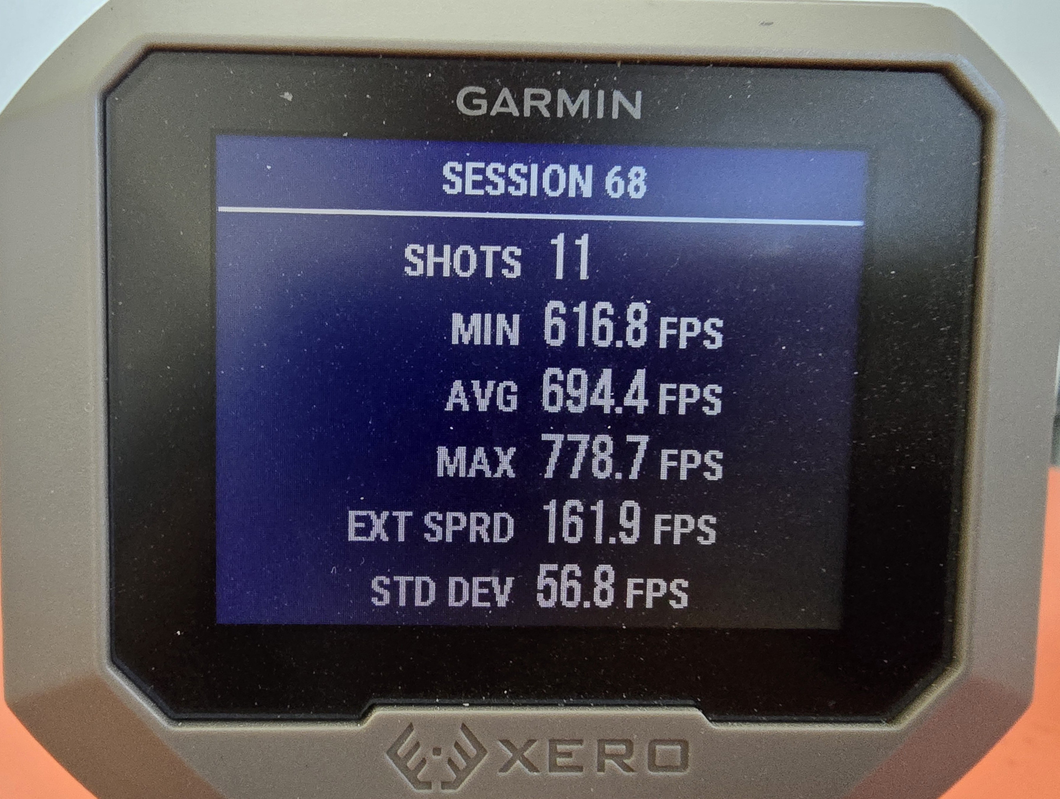

IndianCent Posted September 22, 2025 Author Posted September 22, 2025 1 minute ago, Boggus Deal #64218 said: It looks like I burned powder that the coating was burned off of. Trying up the charge a few tenths. Or more crimp. I increased the charge from 3.4 gr to 3.7 and added cornmeal. I got a lot less of this residue. The average speed went from 430 to 650'isch. I am looking for 650 fps average with low ES and SD. So far I only arrived at the average fps level. I will list the ES/SD in a little bit, it is terrible. On the good news side, I hit the target pretty well regardless of lousy SD/ES. 😵💫 Quote
Rip Snorter Posted September 22, 2025 Posted September 22, 2025 Assuming new powder you bought sealed? Factory new brass. Got me stumped. You would see grains like that in the powder, from the photo they are absent. Be easy to visually inspect the inside of the brass before loading, no other suggestion. You should not need the cornmeal in the smaller case, the primer ignition should be adequate to literally contact all of the charge. I think Cholla hit the nail on the head. Quote

IndianCent Posted September 22, 2025 Author Posted September 22, 2025 6 minutes ago, Rip Snorter said: Assuming new powder you bought sealed? Factory new brass. Got me stumped. You would see grains like that in the powder, from the photo they are absent. Be easy to visually inspect the inside of the brass before loading, no other suggestion. You should not need the cornmeal in the smaller case, the primer ignition should be adequate to literally contact all of the charge. I think Cholla hit the nail on the head. I agree, but I got a lot more grainy residue yesterday with the 3.4 grain of TiteGroup sitting free in the case than I did today with the 3.7 grain plus cornmeal. That seems to indicate that more powder (not all) burned today during the firing process compared to yesterday. I would prefer not use corn meal, as it is yet another step in the process. All components are brand new, the powder was bought at Cabela's three weeks ago, the bottle was sealed. Maybe I just discovered an expensive way to produce corn cob. 😉 Quote

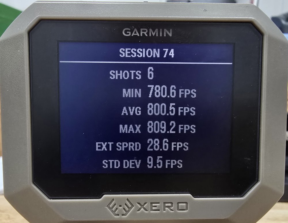

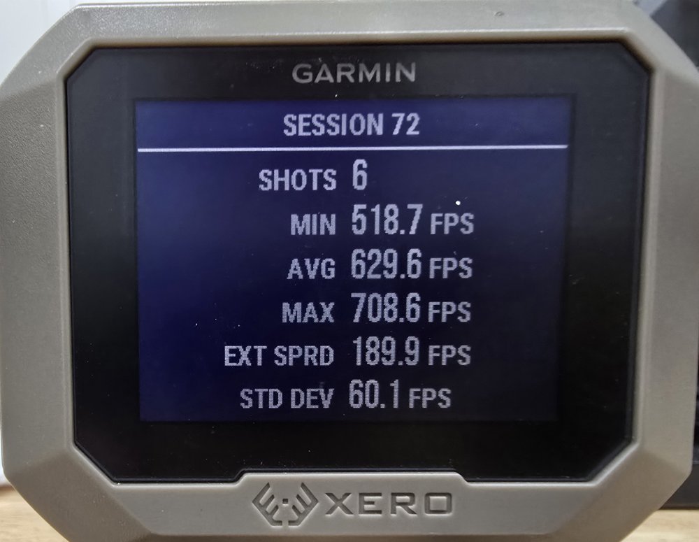

IndianCent Posted September 22, 2025 Author Posted September 22, 2025 (edited) Here are my velocity results with TiteGroup so far: 3.4 grain with powder free in case (see session 66) 3.7 grain powder plus cornmeal (see session 68) My best results with TiteGroup in 32 WCF are 10.8 fps SD and 42.1 fps ES ( a far cry from what I am getting now). This just a snap shot along the way, maybe I will try my left over 26 year old Clays powder next. Edited September 22, 2025 by IndianCent Quote
IndianCent Posted September 22, 2025 Author Posted September 22, 2025 18 minutes ago, Eyesa Horg said: How did the 4.7 work? That seems hot to me. I posted the results below, not too hot but made the SD and DS worse. Quote
Griff Posted September 22, 2025 Posted September 22, 2025 (edited) 2 hours ago, IndianCent said: I thought so too, but I had something grainy coming out of the fired shells...unburned powder? The color does not match. Corn Cob media? What could that be? New brass, primer, 3.4 gr of TiteGroup and the bullet, that's all that was there before I fired it. The picture shows the grainy material I collected inside the blue lid and the TiteGroup powder above as it sits in the RCBS charge master. i am leaving now and I will shoot another 10 rounds with 3.7 gr TiteGroup and cornmeal to keep the powder concentrated above the primer. Incompletely burnt powder. Need firmer crimp for good ignition. Explains the low velocity also. I'm getting 625fps with 3.4grains of TiteGroup & 200 grain RFN. 614 fps w/ the 160 grain version and a FIRM rollcrimp in the crimp groove from my 4-¾" Colt SAAs. Edited September 22, 2025 by Griff 4 Quote
IndianCent Posted September 22, 2025 Author Posted September 22, 2025 16 minutes ago, Griff said: Incompletely burnt powder. Need firmer crimp for good ignition. Explains the low velocity also. I'm getting 625fps with 3.4grains of TiteGroup & 200 grain RFN. 614 fps w/ the 160 grain version and a FIRM rollcrimp in the crimp groove from my 4-¾" Colt SAAs. I will see what I can do with the Redding Crimp die. It is taper first and then becomes a roll crimp. My 3.4 gr load had taper and roll crimp applied. My 4.7 gr load only the taper to take out the bell. I will try 3.7 grain free with a stronger crimp and see what the results are. Thanks 1 Quote
