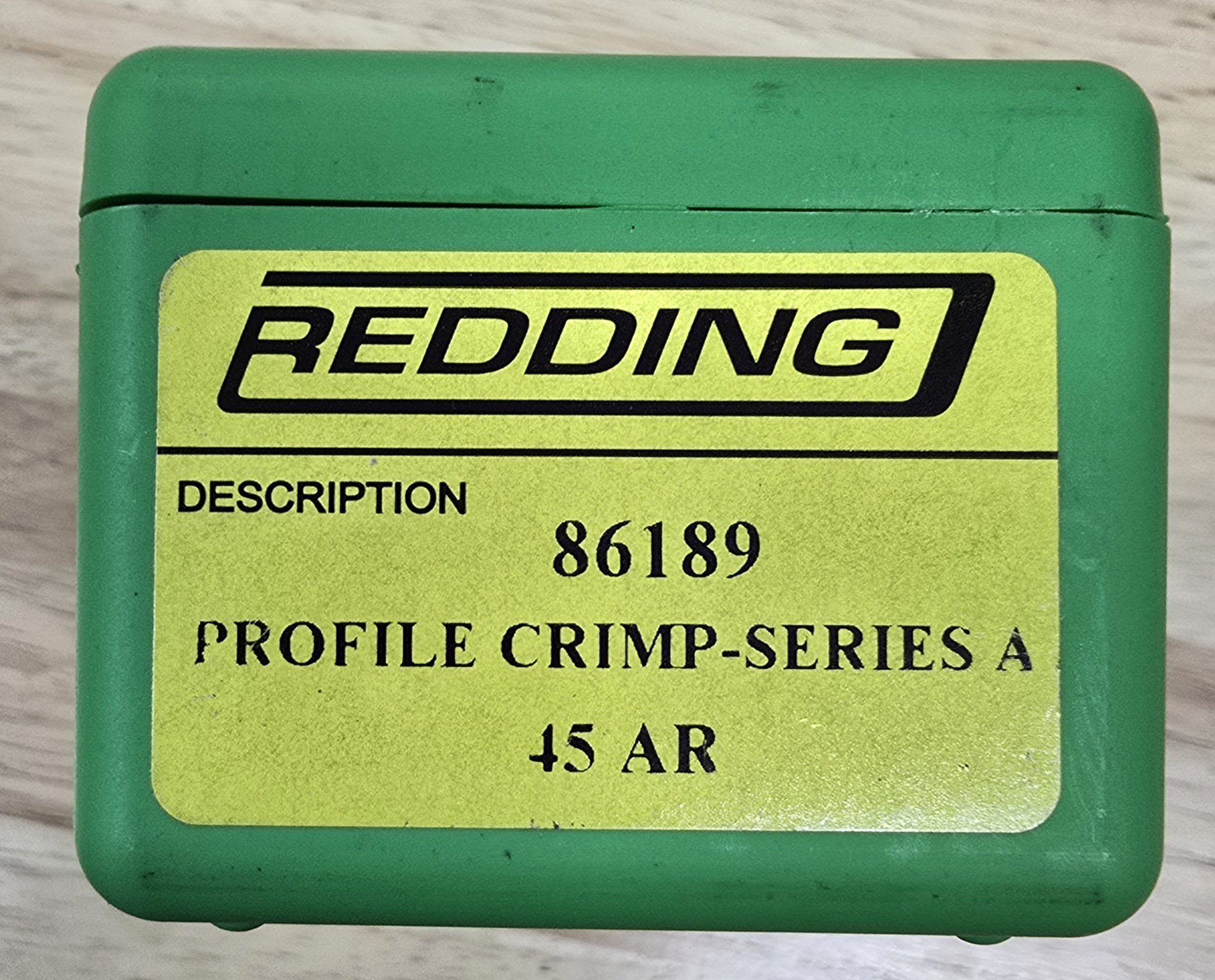

Colorado Coffinmaker Posted September 14 Posted September 14 Indian Cent I beg to differ. Whether Pistol or Rifle, a solid crimp is essential to a good/complete powder burn and to prevent bullet creep from recoil. My personal recommendation for a Crimp Die is the Redding 45 Auto Rim Profile Crimp Die. Gives a nice solid roll crimp. I also don't suggest using a 45 ACP resize die (give a slight taper), a 45 Colt resize die works just fine. 4.0Gr TightGroup works just fine with 160Gr bullets with very manageable recoil. I also use that load with 130Gr Barnstormers. Have FUN!! 10 Quote
Leroy Luck Posted September 14 Posted September 14 The Redding die (number 86189) he’s referring to works extremely well. If only using them in pistols it’s hard to beat 3.5grs of Titegroup. With rifle you need just a bit more powder. 2 Quote

IndianCent Posted September 14 Author Posted September 14 (edited) 1 hour ago, Leroy Luck said: The Redding die (number 86189) he’s referring to works extremely well. If only using them in pistols it’s hard to beat 3.5grs of Titegroup. With rifle you need just a bit more powder. Would this be it? Auto Rim ACP? https://www.midwayusa.com/product/1012355584?pid=124288 Edited September 14 by IndianCent Quote

Leroy Luck Posted September 15 Posted September 15 18 minutes ago, IndianCent said: Would this be it? Auto Rim ACP? Same one I’ve been using. Also if you get into APP at all… a 1.0cc Lee dipper of it in a C45S is perfect. Roughly 13grains by WEIGHT is what it figures to. 1 Quote

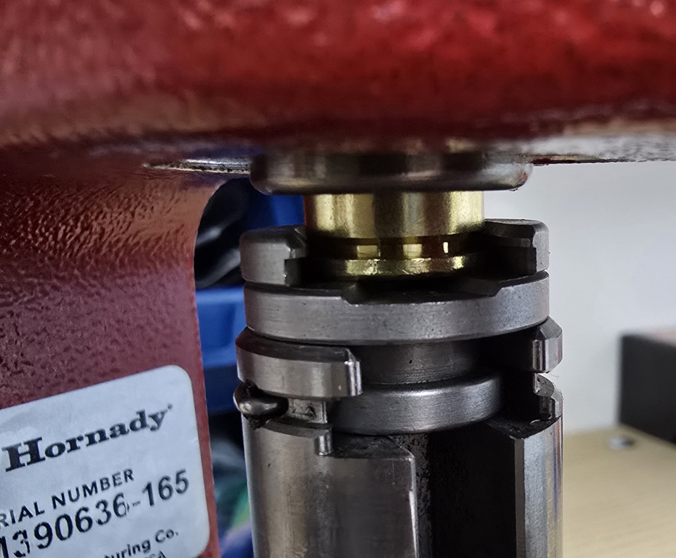

IndianCent Posted September 20 Author Posted September 20 (edited) Well, the Starline 45 CS brass, 160 grain bullets and the Redding Crimp die 86189 arrived. Everything seems to work fine, but I have one more question about the crimp die. When the slightly belled shell with the bullet seated (not crimped) enters the crimp die, the taper crimp engages first and then the roll crimp takes over. The picture shows the loaded cartridge inside the crimp die, but it does not enter the die fully (see picture). There is about a 1/4" inch gap between the top of the shell holder and the very bottom of the crimp die. I can force it, but that does not feel right. Can someone using the Redding crimp die comment? It seems that the cartridge is fine without forcing it the last 1/4" into the crimp die. Thanks Edited September 20 by IndianCent Quote
Leroy Luck Posted September 20 Posted September 20 (edited) The way a crimp die works in most cases, the shell holder won’t touch the die. Edited September 20 by Leroy Luck 3 Quote
