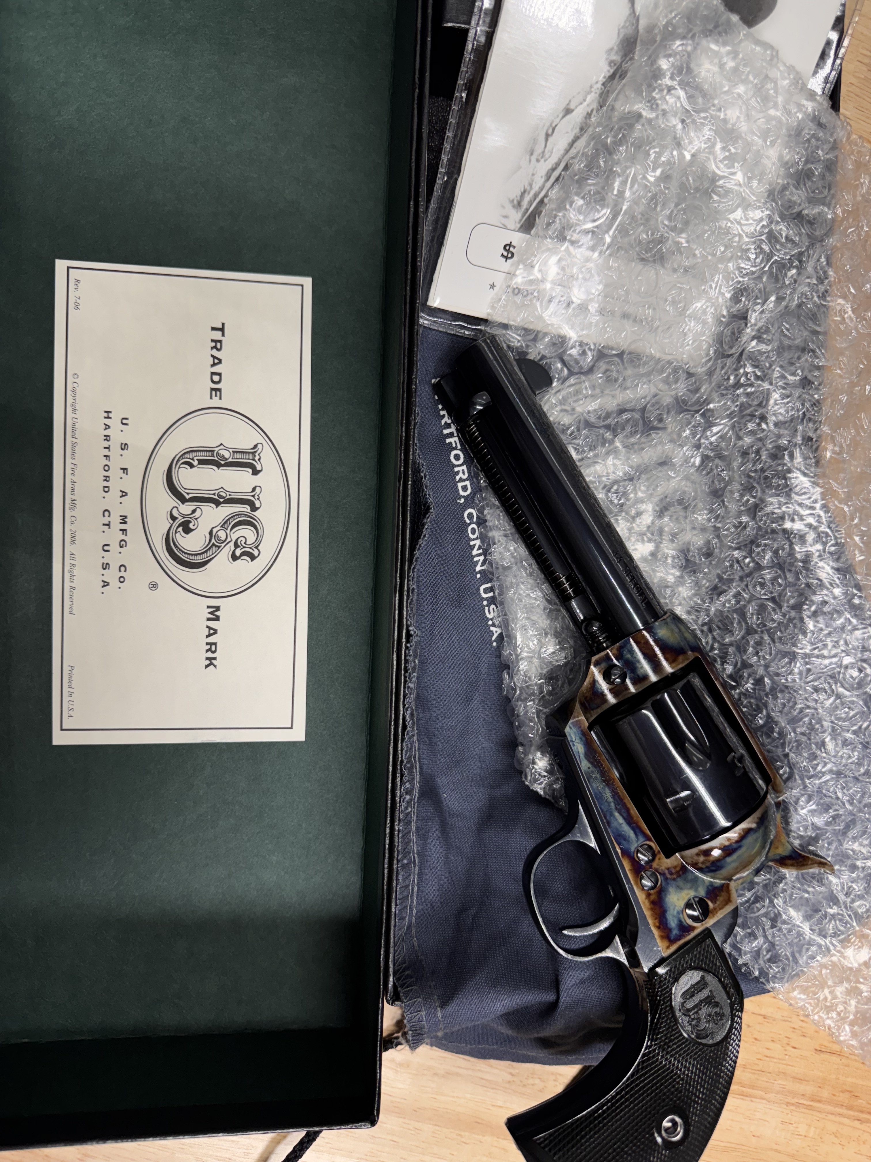

Looks like some kind of a box.    I wonder what's inside of it.USFABox.thumb.jpg.0caf3667f0f80d2f55e34fdc9f3fa708.jpg
Well, call me surprised!   Here's something I never expected to find at a gun store in Massachusetts!

I guess this is as good a time as any to mention that the box my pistol came in is not the original.   For one thing the box clearly says the pistol inside is a 7-1/2" barrel.   Mine is  5-1/2.
But all of this has led me to be more curious about the specifics of my pistol.

I knew Bob Munden and USFA.  The USFA smiths (most work for Standard now) simply needed no help.  Although Jim Finch aka "Longhunter", a SASS World Champion, firearms instructor and gunsmith did a lot  to support and help USFA along.

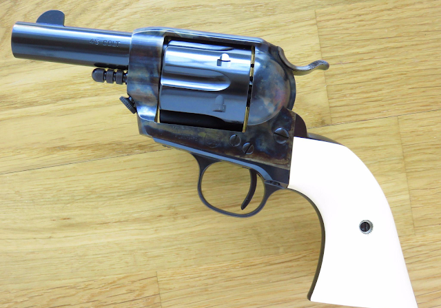

This photo clearly shows your CC gun was fully built on Uberti parts, and assembled (in the white) in the USA.  Firing pin is tapered and not a full cone like an early 1st Gen Colt.  Hammer checkering is cast typically.  Firing pin alone tells me it is an Italian parts guns.  Checkering just affirms it.   We, my wife's guns, own CC 243 and CC 244 and are the same parts guns as your 45 with cast checkering on the hammer.

There is a bunch of other nonsense, frames, cylinder flutes and more, that makes it a Uberti parts gun but the hammer and  big blade and tapered front sight is one of the easiest to spot.
Quality of the guns?  As noted above USFA did spend some extra time on the CC guns getting them right.  Yes it is believed that less than 400 were made.  And the vast majority of those finished in the white.   Not all were targeted.  But most 45s were.   They are excellent guns.  IMO some of the best guns that USFA built.   Hamilton Bown raved about how good they were and built on them.  The CC guns don't command the prices of the later USFA guns made with USA made parts but you certainly have a fine shooter that should actually print point of aim.   Our pair of 32-20s shoot exceptionally well and at POA.

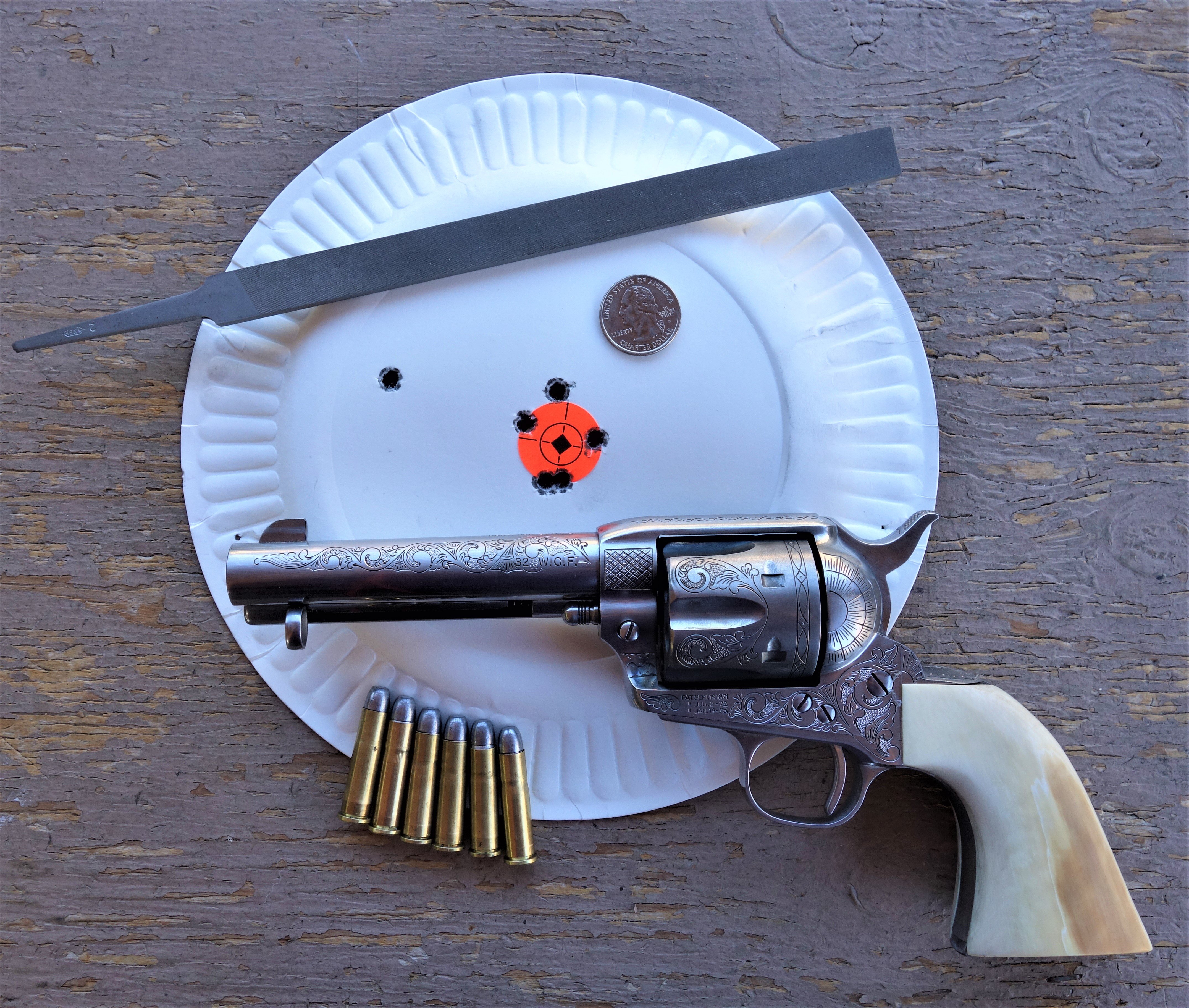

3rd Gen 44 sp. here.    I won that year only because I was the only one to actually hit all the targets, using my heavy bullet .44 hunting ammo that just happened to be in the truck.  That surely wasn't intentional.
I'd actually rather shoot this 1892, 45 Colt.   Simply because it still shoots very well and I know some of the history of this one.
The pair of 32-20 China Camps I showed have shoot better than dang near any handgun I have shot.  I bought them for the cartridge and the ivory, not for the name on the gun.

>Colts don't hit anything compared to clones, possibly it's not the gun, might be the shooter.
Some funny stuff right there pard.  The targets I posted above are real.   I don't count shooting 24" x 24" steel at 10 yards as "hitting".  I knew Bob well enough, and Becky too, shot with them many times.  Even had Bob work on one gun.  Just one for obvious reasons.  30 years of shooting a Munden action job?   Mine didn't last a year.  But I still have the parts he butchered.
Bob could shoot.  That too was obvious.   But forget that and the typical SASS steel.   Try one of Bob's fun past times, a thumb tack with your Colts, at whatever distance you can still see a thumb tack and get back to me.   Last time I was shooting thumb tacks I could still see them easy enough, with good light, at 15 yards.  Hint for you?  That job is easier done with a 45 than a 38.
I have a few Colts that can manage that job.  But dam few, out of the several dozen I own and shoot.
