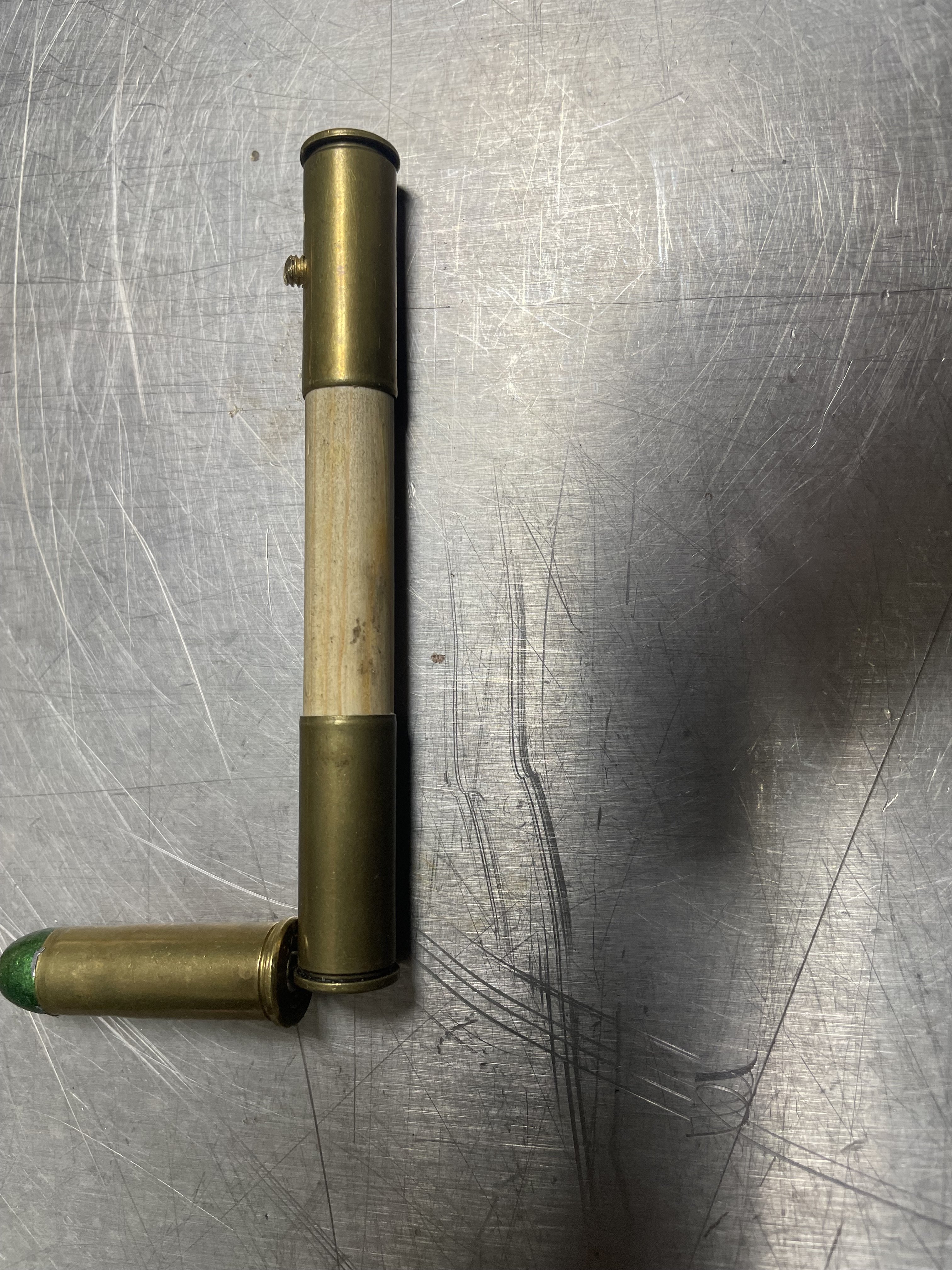

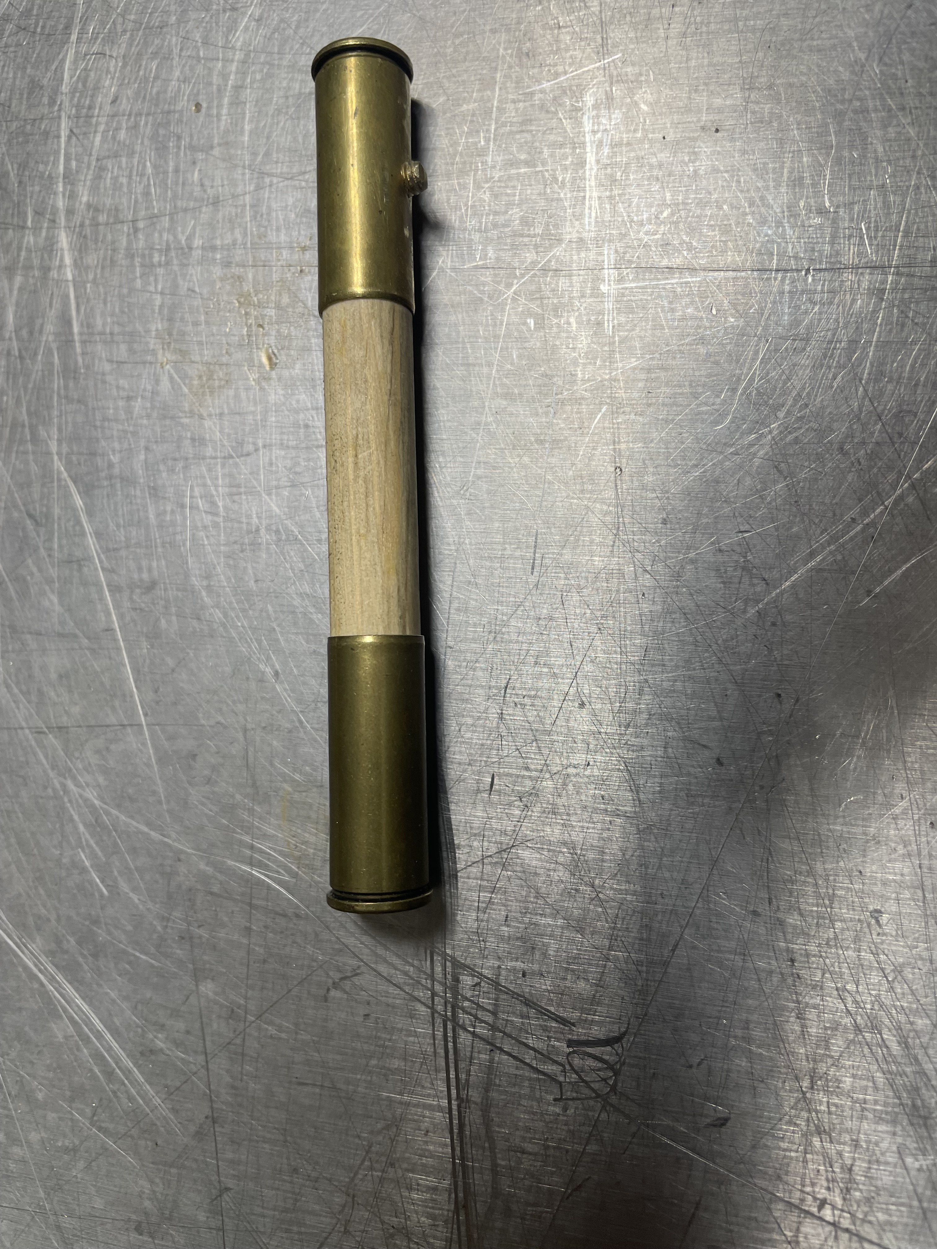

Sedalia Dave Posted September 13, 2025 Posted September 13, 2025 20 hours ago, Prairie Dawg, SASS #50329 said: Charlie: Make yerself a spacer stick, so you don't have to do the "Henry Hop" --Dawg Driftwood copy.pdf 349.06 kB · 8 downloads I put a 45 Colt case on each end of mine. Stick will need to be shorter as it hits the case web plus the thickness of the case head. Held in place with a little JB weld. Makes it slide easier as only the case heads touch the magazine. Made stop pins from a machine screw. After screwing in place cut the head off and filed the sharp edges off. The stop pins keeps the stick from locking up the action.

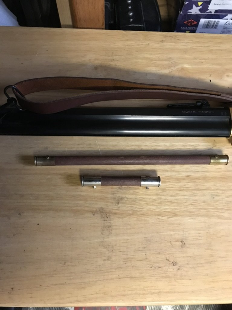

Colorado Coffinmaker Posted September 14, 2025 Posted September 14, 2025 Above, Henry with Sling and examples of "Stick, Mark 1, A1" Short stick is for a "normal" cartridge stack and the longer one if for a stack C45S. I used cut down 45 Schofield cases and brass screws for the stops. Lucky R. K., I also have an 18.5 Carbine. .45 Colt and when loaded with 45 Schofield with 180Gr or 200Gr RNFP it will hold 10. Not much help for a 44-40 though.

Colorado Coffinmaker Posted September 14, 2025 Posted September 14, 2025 I forgot to mention, as I showed the sling mounted on my "Martial" Henry, one CANNOT use the sling to aid in actually shooting in CAS. No rule against the sling just "being there." Attaching the sling is just for "show and tell." I found the sling looks really trix but actually, it just gets in the way.

Sedalia Dave Posted September 16, 2025 Posted September 16, 2025 Here is a pic of the ones I have made.
