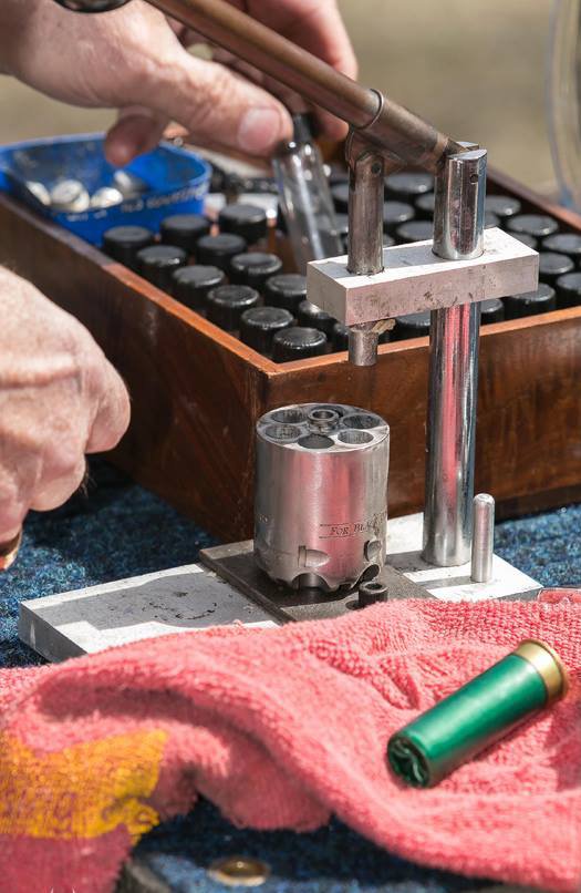

Buckeye Pete, SASS # 29941 Posted September 12 Posted September 12 Years ago I had a pair of ROAs that I would shoot at our monthly matches and I would load the cylinders using a press on my gun cart. I found that it gave me a chance to wipe down the inside of the frame and the outside of the cylinders before I loaded them. My ROAs ran very well. I found that it took about 10 minutes to load the cylinders. I've always helped in posse duties. Buckeye Pete 3 Quote

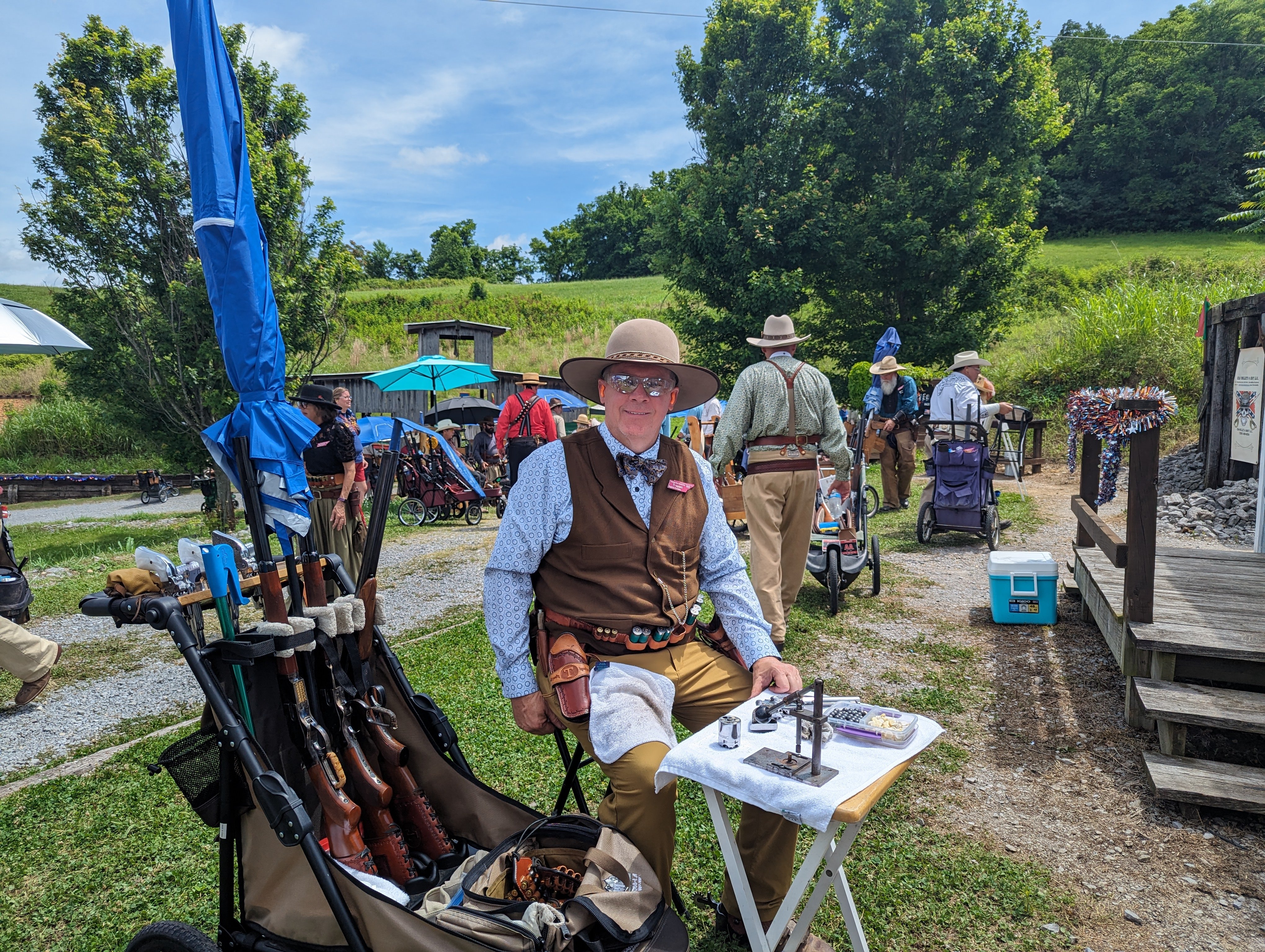

Sgt. Hochbauer, SASS #64409 Posted September 13 Posted September 13 After having my pistols cleared I head over to my gun cart to reload. I have tried to watch the unloading table and reload at the same time and found it a bit distracting. Using a stand on my cart it takes me about two to three shooters and then can help with posse duties. I use plastic tubes that I pre-charge and top off with a ball then place 10 in a ziplock baggie. This system works well for me. I also carry extra pre-loaded tubes just in case. Hochbauer 2 Quote
T-Square Posted September 13 Posted September 13 (edited) These is much wisdom above. I too, and I reload on a stand at my cart. My contribustion is this; I can do any of the posse work, if you get your timing right. Dont get caught in the middle of reloading when the posse moves. Get started with a enough time, or reload after you move. This is my set-up at War Trace this year. Edited September 13 by T-Square 6 Quote
