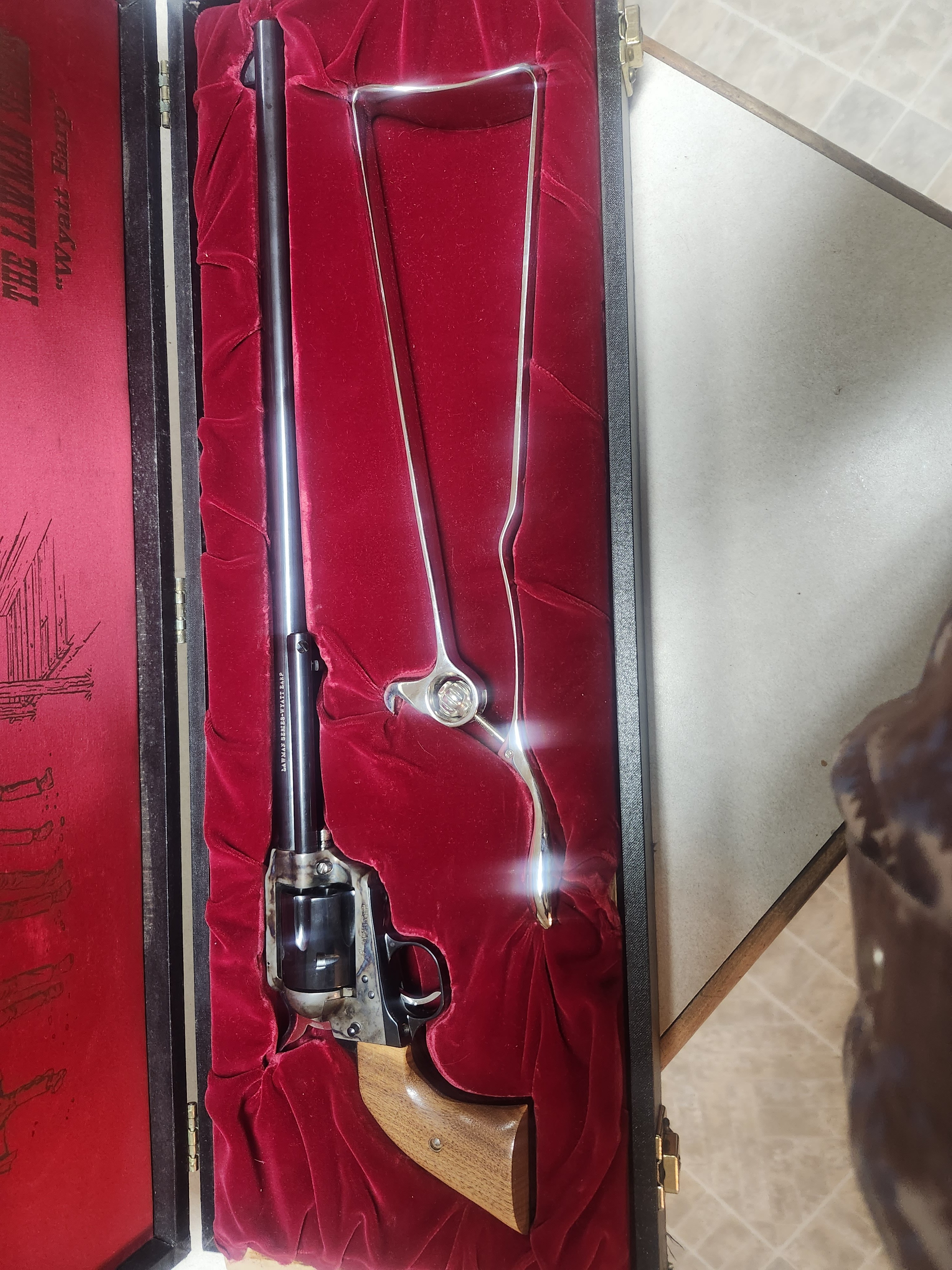

Jeff, #21334 Posted September 11, 2025 Posted September 11, 2025 Can anybody tell me if the wyatt earp commemorative is a second or third generation colt the serial number has 3 numbers. And then the letters Wac Quote
H. K. Uriah, SASS #74619 Posted September 11, 2025 Posted September 11, 2025 42 minutes ago, Jeff, #21334 said: Can anybody tell me if the wyatt earp commemorative is a second or third generation colt the serial number has 3 numbers. And then the letters Wac Neither. It's an Uberti. The only Colt commemorative Buntline I know of is the Ned Buntline one. It is 2nd Generation, and a New Frontier model for some unknown reason. But it is C&R. Quote
Cholla Posted September 11, 2025 Posted September 11, 2025 If you’re talking about the “Buntline” it should be a Second Generation Colt. 500 were made so your three digit serial number falls right in. https://www.rockislandauction.com/detail/78/3850/colt-lawman-series-wyatt-earp-commemorative-buntline-revolver 1 Quote

Jeff, #21334 Posted September 12, 2025 Author Posted September 12, 2025 It's a colt it has a 16 inch barrel right now. I'm looking to buy a 7. And a 1 inch barrel. That's what I need to know.If it was first or second generation anybody have a 7 and a 1 inch second generation Colt barrel for sale. Quote

Cholla Posted September 12, 2025 Posted September 12, 2025 If you are looking to change the barrel, I highly recommend selling what you have and using the funds to buy what you want. What you show has collectors value. 3 Quote
El Sobrante Kid Posted September 12, 2025 Posted September 12, 2025 5 minutes ago, Cholla said: If you are looking to change the barrel, I highly recommend selling what you have and using the funds to buy what you want. What you show has collectors value. THIS ,^^^ 100%. A friend of mine who collected old swords said this to me (paraphrased), during our lives we are only the temporary custodians of these unique items as they will outlive us. We can make changes to them, but we shouldn't. 3 Quote

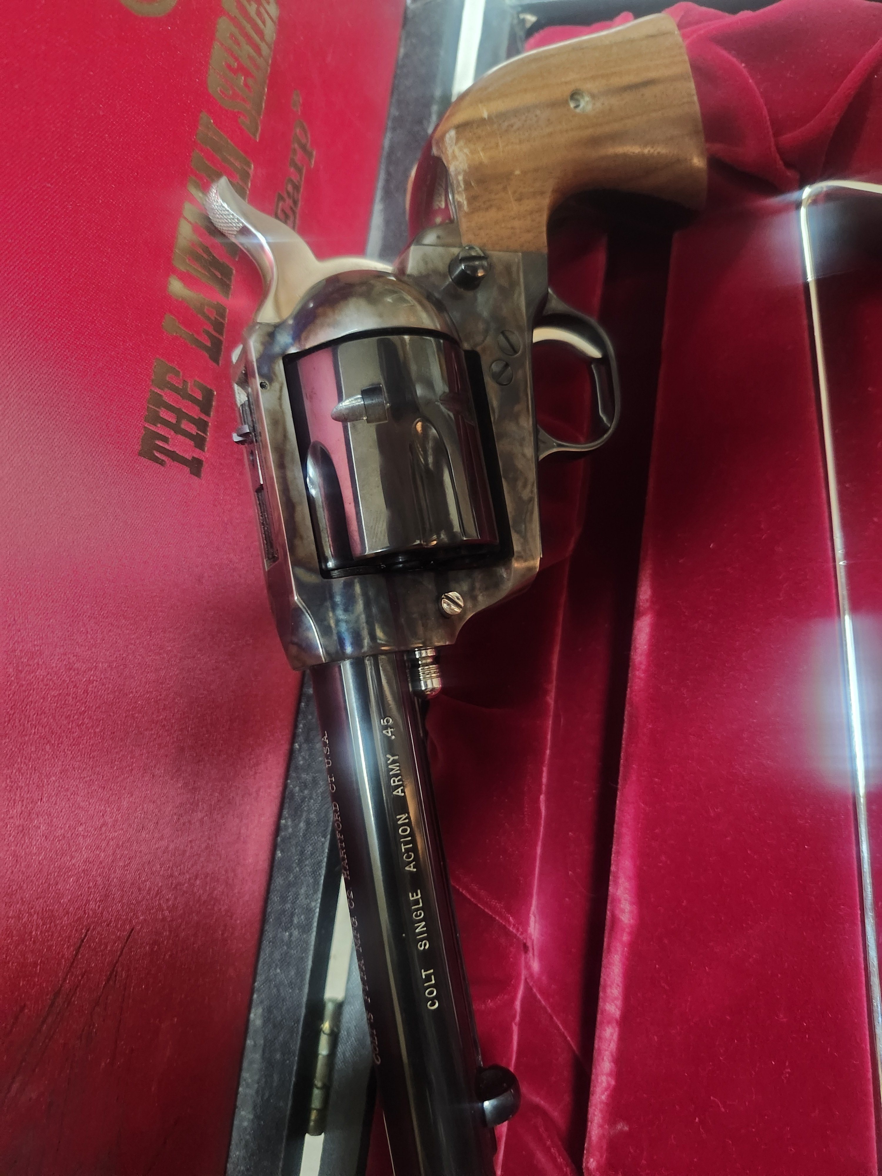

Boggus Deal #64218 Posted September 13, 2025 Posted September 13, 2025 Definitely not a first generation. Is the cylinder bushing removable? Quote
Jeff, #21334 Posted September 13, 2025 Author Posted September 13, 2025 No, it's not removable.I think it's an early third or possibly a second.But I don't know that's why i'm asking Quote
Cholla Posted September 14, 2025 Posted September 14, 2025 I think the black boxes were a Second Generation thing. Quote

Boggus Deal #64218 Posted September 14, 2025 Posted September 14, 2025 I think non removable bushings were a 3rd generation thing. Quote
Cholla Posted September 14, 2025 Posted September 14, 2025 These were made in 1970. The three digit serial number should be followed with WYE. That makes them Second Generation. Quote
Texas Jack Black Posted September 14, 2025 Posted September 14, 2025 Yup, 2nd gen run ended in 74 and 3rd gen started in 76 Quote
Jeff, #21334 Posted September 14, 2025 Author Posted September 14, 2025 Thanks. I thought it was a second, but I wasn't sure it's got a real stiff. Action. I'm not really throwing that much money at just a new barrel. I kind of like the sights on the gun. It's got these real cool flip up sites. And I don't like that 16 inch barrel. Anybody know where I can get it? A 7 1/2 blued second generation barrel Quote
