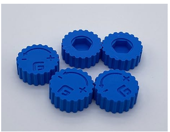

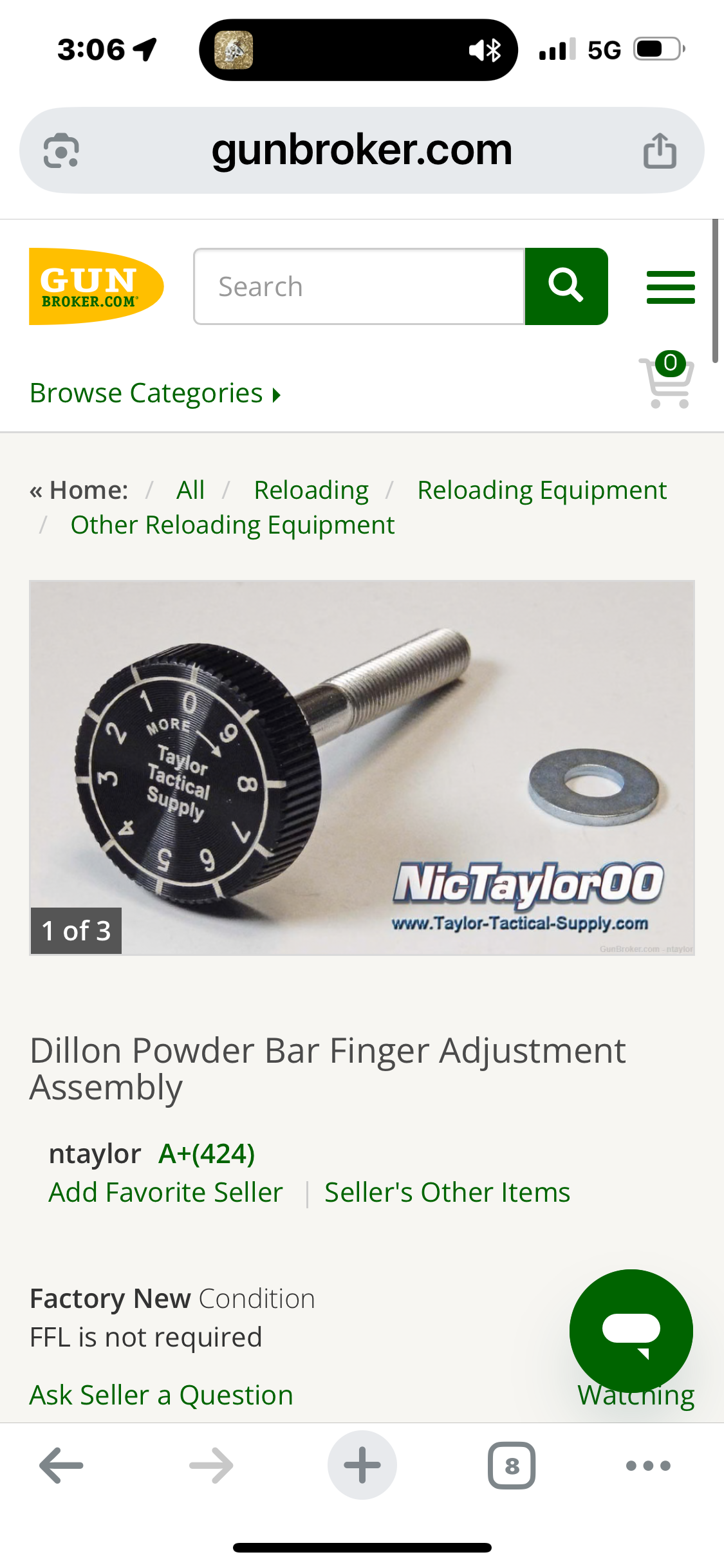

Sheriff Dill Posted September 10, 2025 Posted September 10, 2025 Looking into getting one of these for my press. Anyone have experience with them ? Quote
DukeSoprano Posted September 10, 2025 Posted September 10, 2025 Yes, I have about 6 of them on my 650s and love them, I do not use the numbers, it just makes it easier to dial in a drop rather then using a wrench or a knob that falls off the bolt. 1 Quote

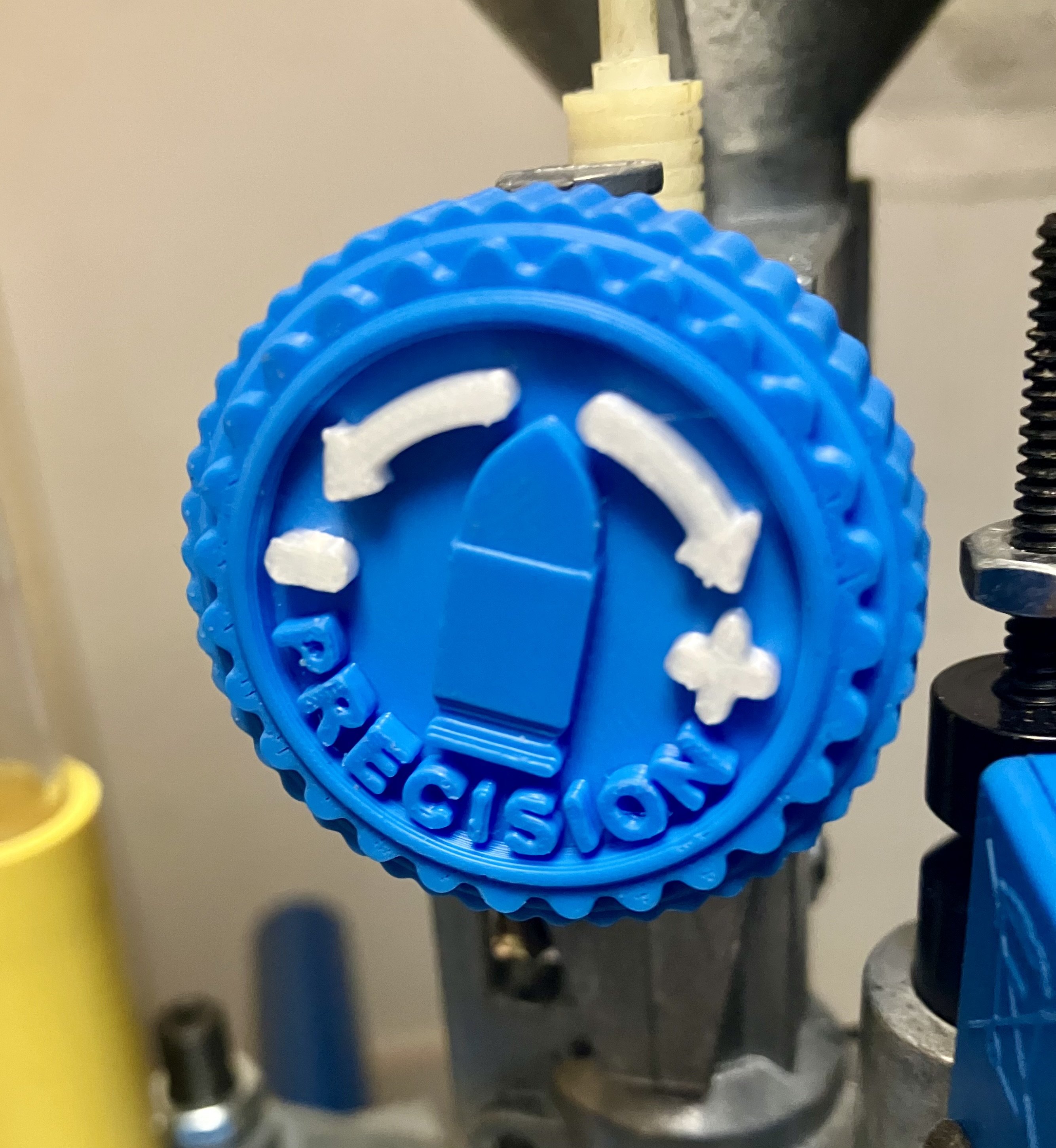

Sedalia Dave Posted September 10, 2025 Posted September 10, 2025 A lot more cost effective Dillon Powder Measure Knobs - 5 Pack, Dillon Blue 6 4 Quote
Sheriff Dill Posted September 10, 2025 Author Posted September 10, 2025 Do these stay on the nut ? I saw these a well I was just afraid they would come off. Quote
Sedalia Dave Posted September 10, 2025 Posted September 10, 2025 1 minute ago, Sheriff Dill said: Do these stay on the nut ? I saw these a well I was just afraid they would come off. They hold pretty good. If not a bit of glue solves the problem. 2 1 Quote

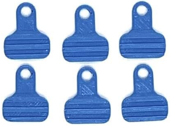

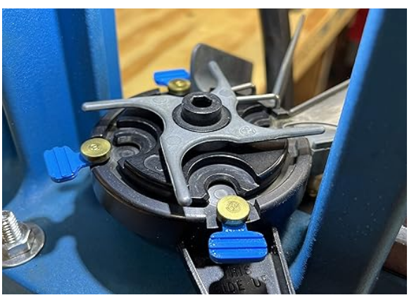

Sedalia Dave Posted September 10, 2025 Posted September 10, 2025 (edited) I LOVE these. Besides make it easier to remove the pins it also keeps them from disappearing when dropped. Dillon Locator Pin Tabs - 12 Pack, Dillon Blue Edited September 10, 2025 by Sedalia Dave 5 2 Quote
Sheriff Dill Posted September 10, 2025 Author Posted September 10, 2025 That’s genius. Thanks. 1 Quote
Sedalia Dave Posted September 10, 2025 Posted September 10, 2025 3 minutes ago, Sheriff Dill said: That’s genius. Thanks. When putting them on, radius the locator pin shank just a bit. To keep the tab from breaking, I lay the tab over a hole in piece of metal or dense wood. The hole needs to be slightly bigger than the pin. For some really small locator pins, I file the tab even with the head after installing. 1 2 Quote

Nostrum Damus SASS #110702 Posted September 11, 2025 Posted September 11, 2025 17 hours ago, Sedalia Dave said: When putting them on, radius the locator pin shank just a bit. To keep the tab from breaking, I lay the tab over a hole in piece of metal or dense wood. The hole needs to be slightly bigger than the pin. For some really small locator pins, I file the tab even with the head after installing. I Dremel'd a bit off the corners of the tabs as they're larger than they need to be. They work great. 1 Quote
Eyesa Horg Posted September 11, 2025 Posted September 11, 2025 19 hours ago, Sedalia Dave said: I LOVE these. Besides make it easier to remove the pins it also keeps them from disappearing when dropped. Dillon Locator Pin Tabs - 12 Pack, Dillon Blue I've had the best results with actual Dillon tabs. They are thinner so the cartridge rim doesn't get under them. Have you had any such issues with these? Quote

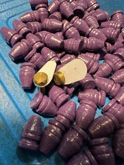

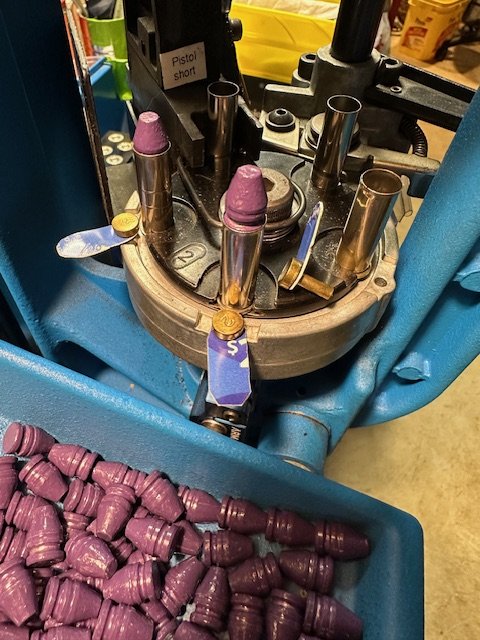

J.S. Sooner, SASS #73526 Posted September 11, 2025 Posted September 11, 2025 19 hours ago, Sedalia Dave said: I LOVE these. Besides make it easier to remove the pins it also keeps them from disappearing when dropped. Dillon Locator Pin Tabs - 12 Pack, Dillon Blue I make my own out of thin plastic mail promo cards. Use a leather hole punch and sand paper or file to fit the pin. Quote
Sheriff Dill Posted September 11, 2025 Author Posted September 11, 2025 3 minutes ago, J.S. Sooner, SASS #73526 said: I make my own out of thin plastic mail promo cards. Use a leather hole punch and sand paper or file to fit the pin. Could you post a photo? Quote

boom pop Posted September 17, 2025 Posted September 17, 2025 Those blue dillon knobs 5/$13.45 amazon 1 Quote
Springfield Slim SASS #24733 Posted September 17, 2025 Posted September 17, 2025 Gallon milk jug material makes nice thin tabs also. 2 1 Quote

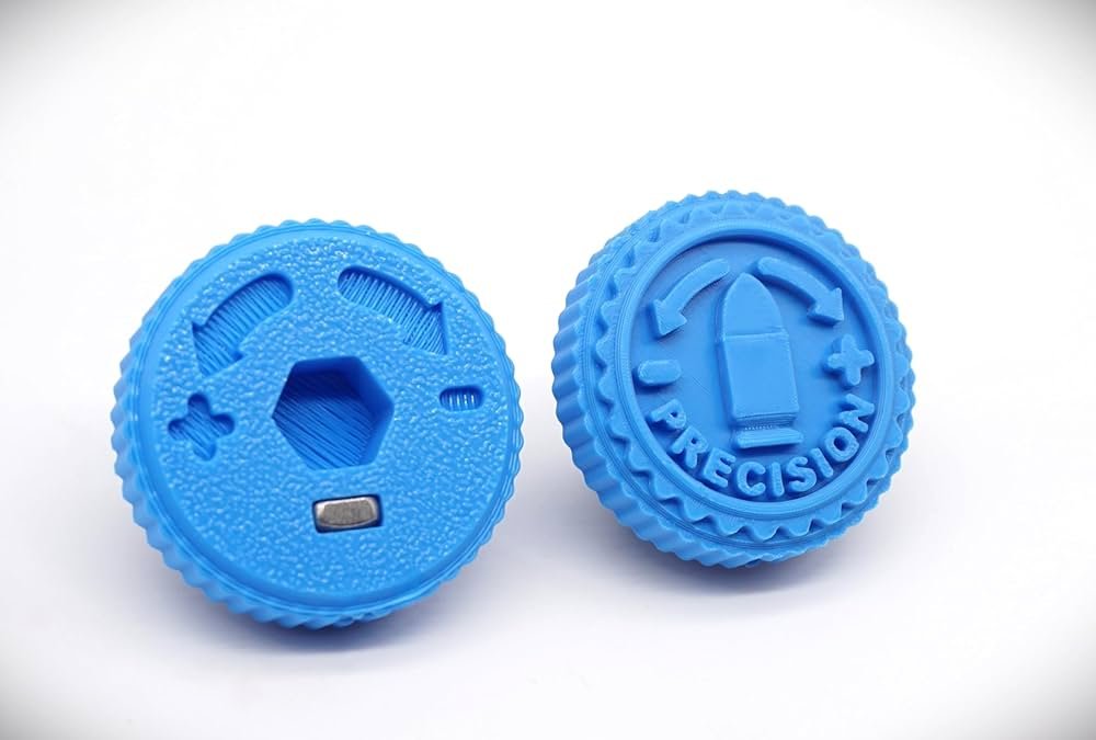

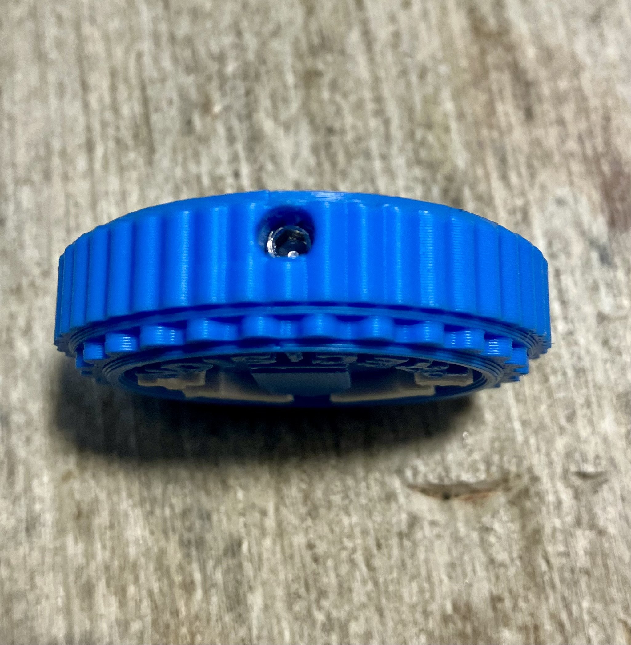

Blackwater 53393 Posted September 21, 2025 Posted September 21, 2025 (edited) The tabs for the Dillon pins arrived a couple of days ago, but I waited to try them out until the powder measure knobs arrived. They came in today. I discovered that these particular knobs have a tiny set screw in them to lock them onto the hex head adjusting bolt in the powder bar. COOL!! I discovered a small problem with the tabs!! On the 750, the tab, at the station where I have my powder check, the tab hits the frame at the top of the stroke and turns sideways so that it interferes with the shell plate. I’m going to have to play with that a little to see what modification I need to make to alleviate the problem. I very seldom have to pull that pin, so it might just be a nonissue! Markings are highly visible. Set screw is on the bottom of the knob and is backed up by a steel nut embedded into the plastic! Edited September 21, 2025 by Blackwater 53393 1 2 Quote
