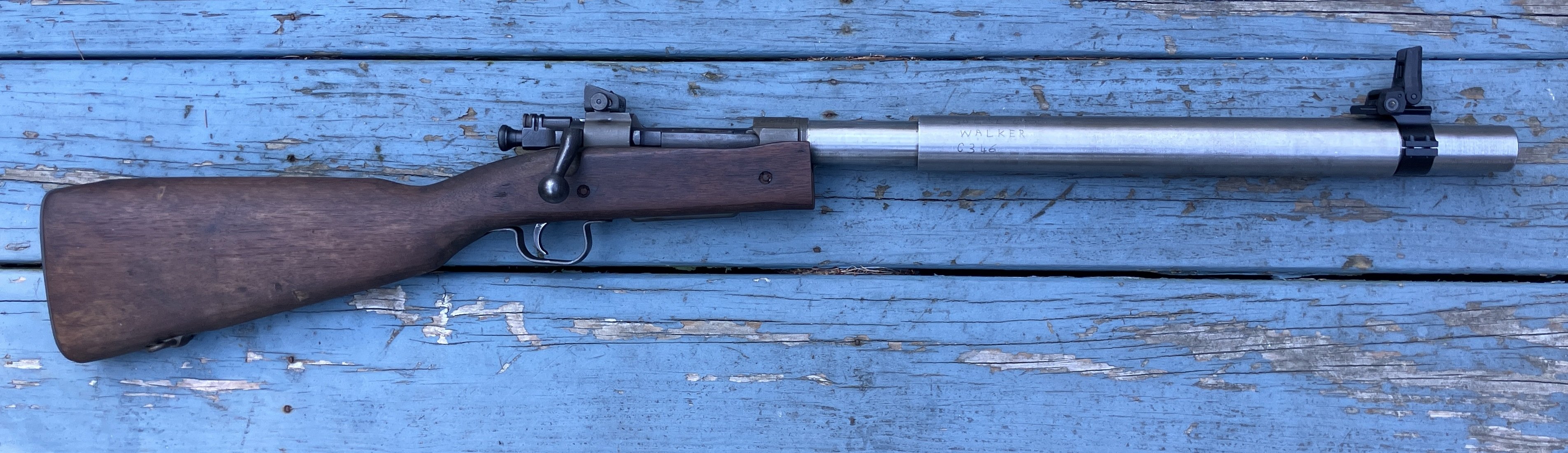

H. K. Uriah, SASS #74619 Posted September 13, 2025 Author Posted September 13, 2025 Here's the latest.... Looking more like a rifle, sort of. I think the front sight will probably be something mounted on a scope ring that can clamp on and off. Just have to find one that fits. First time I shouldered it like this, I found myself thinking, "This is wicked cool!" Gonna be a nice plinker in .30 Carbine when it's done. And then, I'll start thinking about finding one in .30-'06 and putting a 1903A4 scope on it. Maybe. Time will tell.

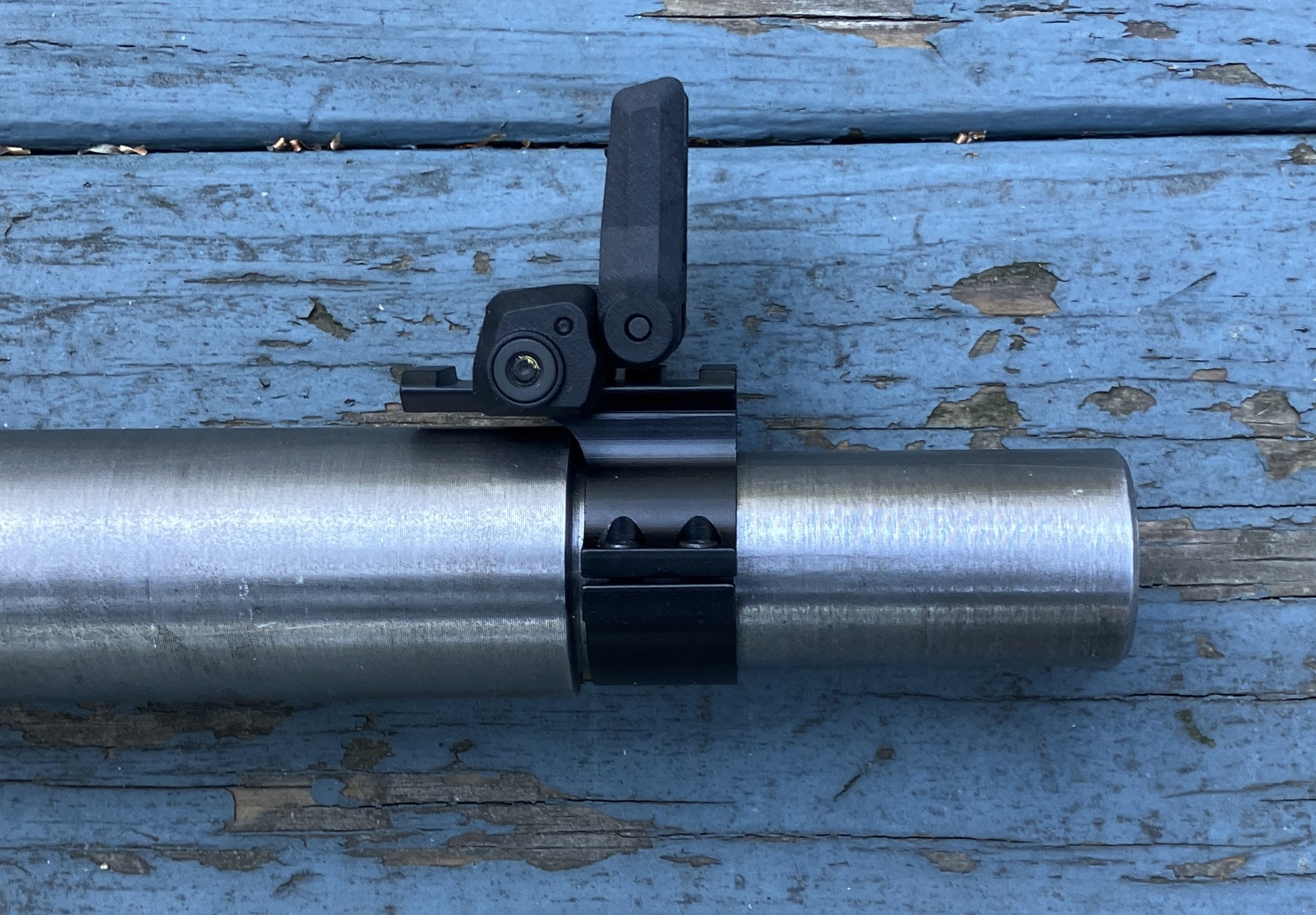

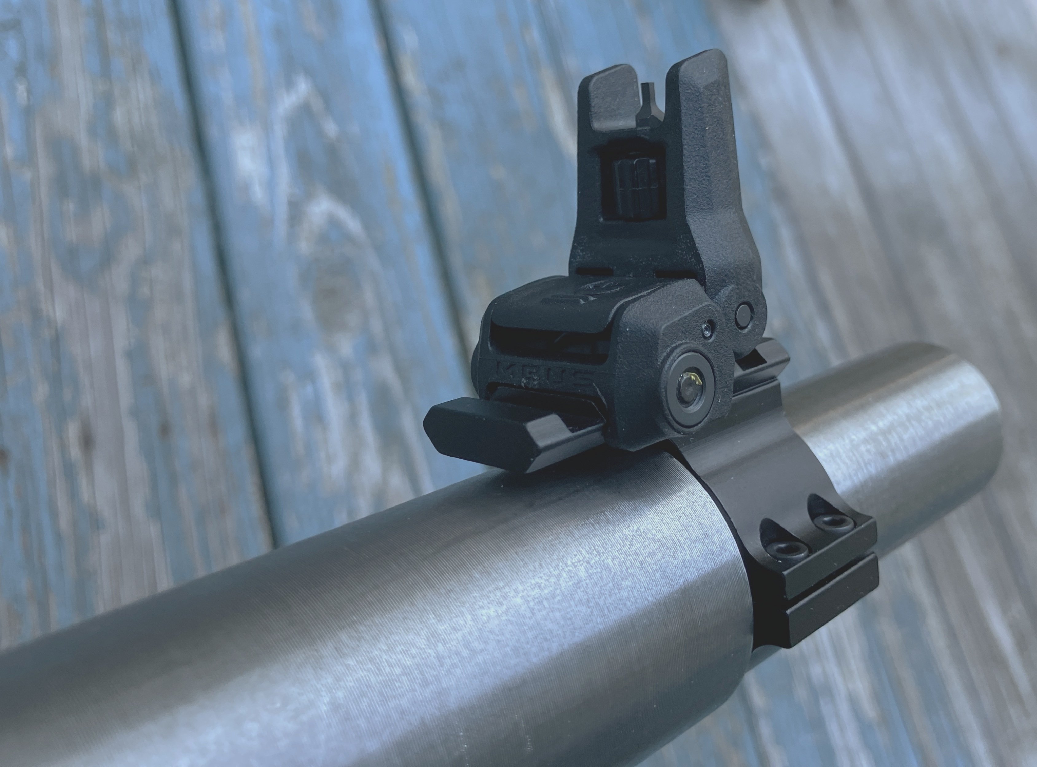

H. K. Uriah, SASS #74619 Posted September 19, 2025 Author Posted September 19, 2025 And the final result of the project is ready to be shared. And now it looks like a rifle again! The "front sight." It's basically a ring with a picatinny rail attached and clamped to the barrel. Then, the sight is attached to the rail. Although the sight itself is plastic, to me, it looks "right" somehow. In other words, I like it. It was a fun project, and while it is front heavy, and just plain heavy, you can shoulder it. I look forward to taking it to the range and seeing how accurate it is. And, the idea of getting another one in 7.62 Nato or .30-'06 is in my mind. Time will tell. I hope you enjoyed seeing this project unfurl as much as I did sharing it.
Doc Shapiro Posted September 19, 2025 Posted September 19, 2025 The rear sight looks awful low for that front sight.
H. K. Uriah, SASS #74619 Posted September 19, 2025 Author Posted September 19, 2025 1 hour ago, Doc Shapiro said: The rear sight looks awful low for that front sight. The protectors make it look taller than it is. But, the post can be lowered, and if need be, the rear can be raised a little. I'll look into getting a .30 carbine bore laser sight and adjust it maybe 100 yards. Or actually, since I see this more as a plinker than anything else, maybe to 25.
