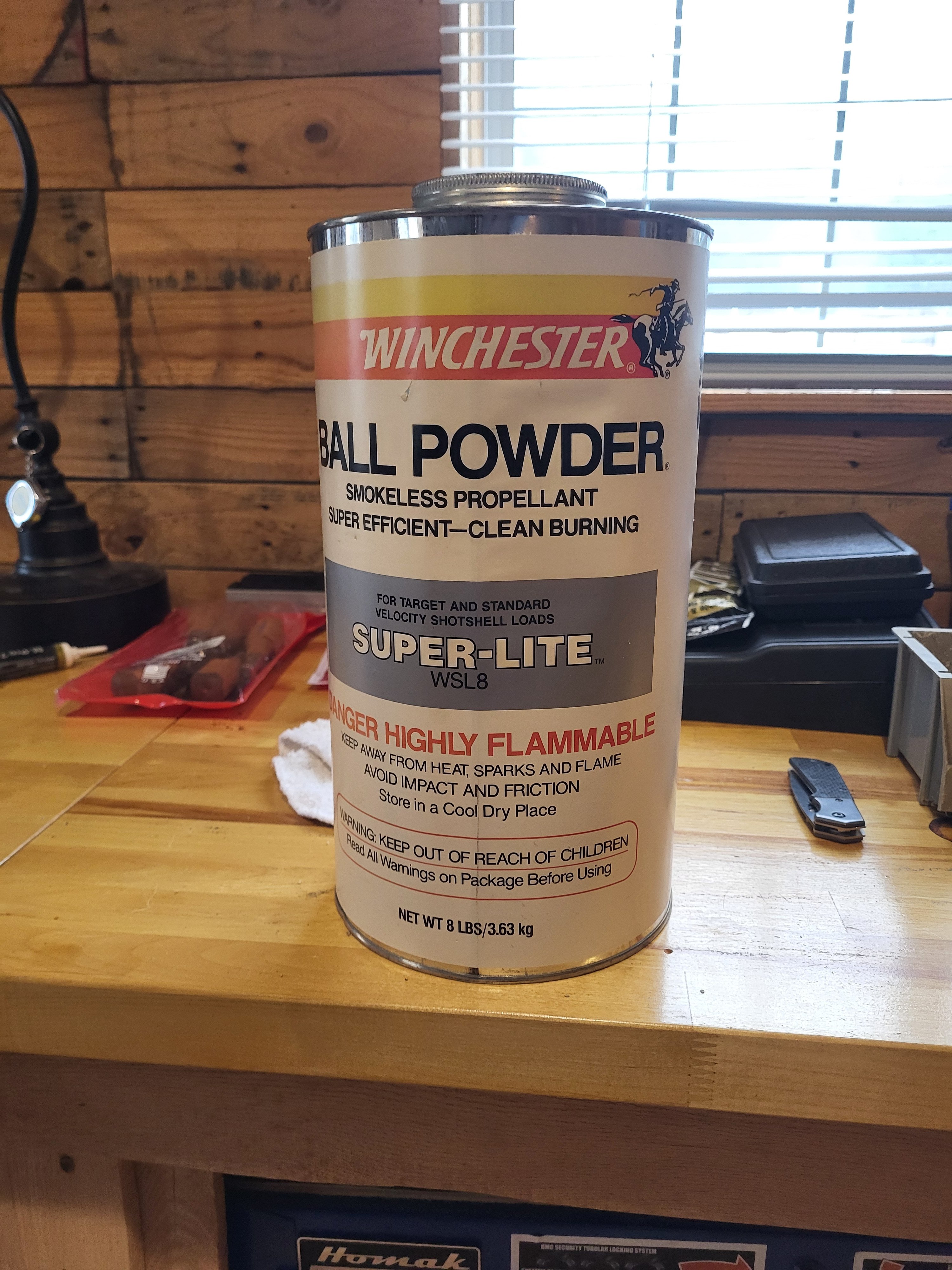

MBFields Posted September 3, 2025 Posted September 3, 2025 (edited) Anyone know any load data for 38 spl 105 or 125 grain bullets and Winchester Super Lite WSL8? I know its an old ball powder. Picked this up back when first reloading and never used it. PS: Don't find powder in cans like this anymore.🤠Edited September 4, 2025 by MBFields 1 Quote

The Original Lumpy Gritz Posted September 3, 2025 Posted September 3, 2025 For .38 Special, try 3.0-3.2 gn. Use a firm roll-crimp. 1 Quote

watab kid Posted September 6, 2025 Posted September 6, 2025 ill double down on that load above , but start low at 3grn - these old powders have lots less data but can be very affective in use , it wont be long till we will be saying the same of red dot , clays , and a few others but new powders will become common , 1 Quote
MBFields Posted September 6, 2025 Author Posted September 6, 2025 Loaded a few at 2.8 and went well. Do.not have a chrono but it was behind 125 gr bullets. No dirtier on the brass than clays. Think it will work fine. Would like to chrono somehow someday. Need to run a few more. Quote
watab kid Posted September 8, 2025 Posted September 8, 2025 sounds like you hit in , on , or near your load , id stick with that if it made you happy Quote
