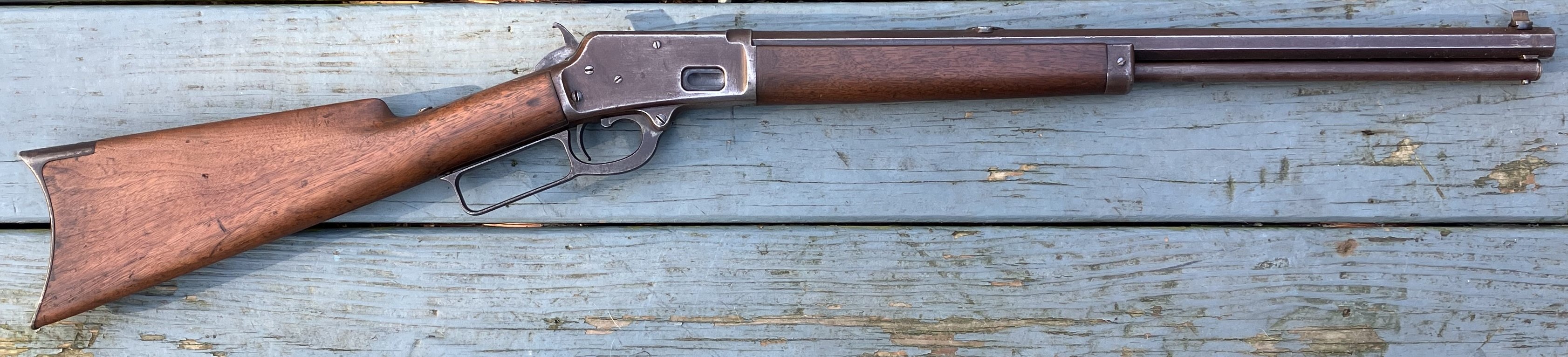

High Spade Mikey Wilson Posted August 23, 2025 Posted August 23, 2025 I need someone with expertise about this rifle. I have the opportunity to purchase a Marlin 1889 in 32-20 to add to my collection made in 1890. It's in pretty good shape with decent bore. I understand this is a "use black powder cartridge" rifle made before smokeless powder became prevelent. I read conflicting reports from don't use smokeless at all to light smokeless loads with cast bullets can be used. Anyone out there have one of these rifles that can give me your assessment about using smokeless powder? I don't shoot black powder, and I have no interest in starting. My 32-20 cowboy load is 2.3 grains of Trail Boss under a 100 grain cast bullet. Thoughts?
Spiritmaker Posted August 23, 2025 Posted August 23, 2025 I have the same rifle in that caliber. Your loading should be fine. It's a hoot ta shoot!
Cotton Eye Joe Posted August 23, 2025 Posted August 23, 2025 I obviously keep it reasonable, but smokeless/cast bullets have been fine in all of my 1889s. Very glad that starline made so much in the last year or so. That's a 32-20 in the photo, but I've also used smokeless in my 44-40 and 38-40 1889s as well.

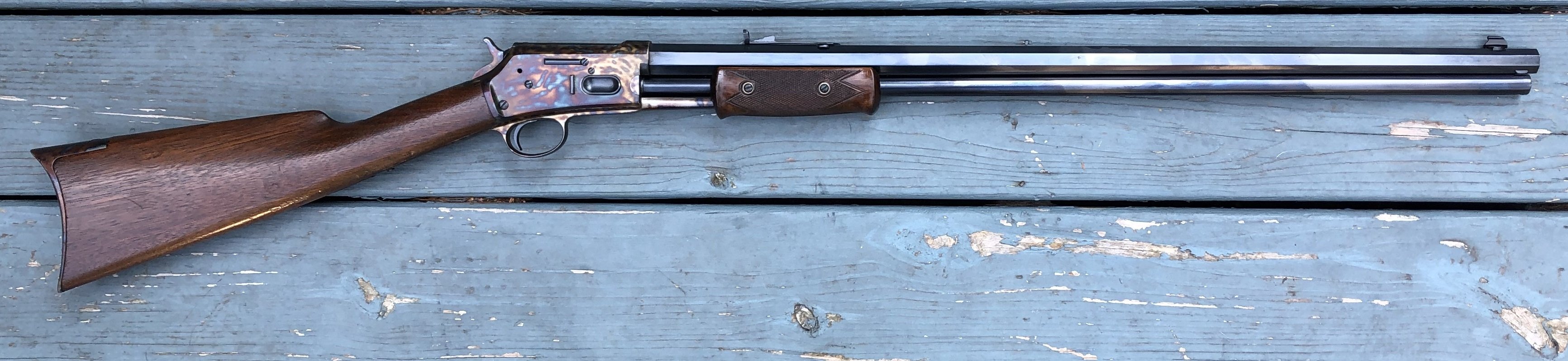

H. K. Uriah, SASS #74619 Posted August 24, 2025 Posted August 24, 2025 I would use that load in that gun. I USE that load in my Marlin 1888. (And my antique Lighting.) I will shoot *light* smokeless loads in old rifles, especially in .32-20, that I would not let near an old pistol. BTW, should you decide that you don't want it, I'll pay you what you paid for it. Or, just let me know where it is. I wish to have more .32-20's
H. K. Uriah, SASS #74619 Posted August 24, 2025 Posted August 24, 2025 And for giggles, here's the Lighting...

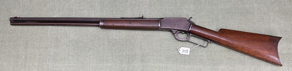

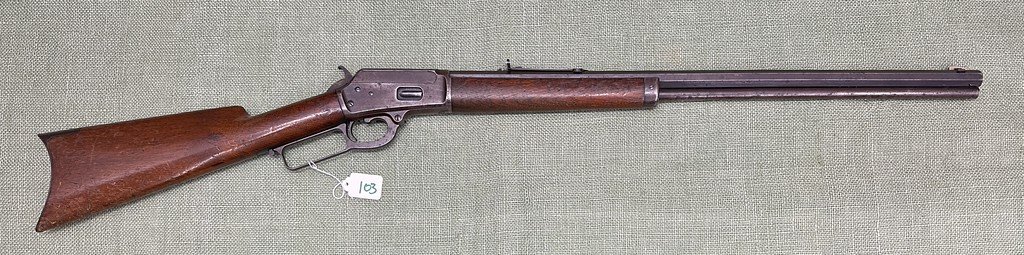

High Spade Mikey Wilson Posted September 6, 2025 Author Posted September 6, 2025 I picked her up at a gun auction today. Everything seems to check out fine. I'll be taking her to the range next week!
Dapper Dave Posted September 7, 2025 Posted September 7, 2025 Beautiful, sir. I have a hankerin' for .32 myself, but no cash yet to scratch that itch.
