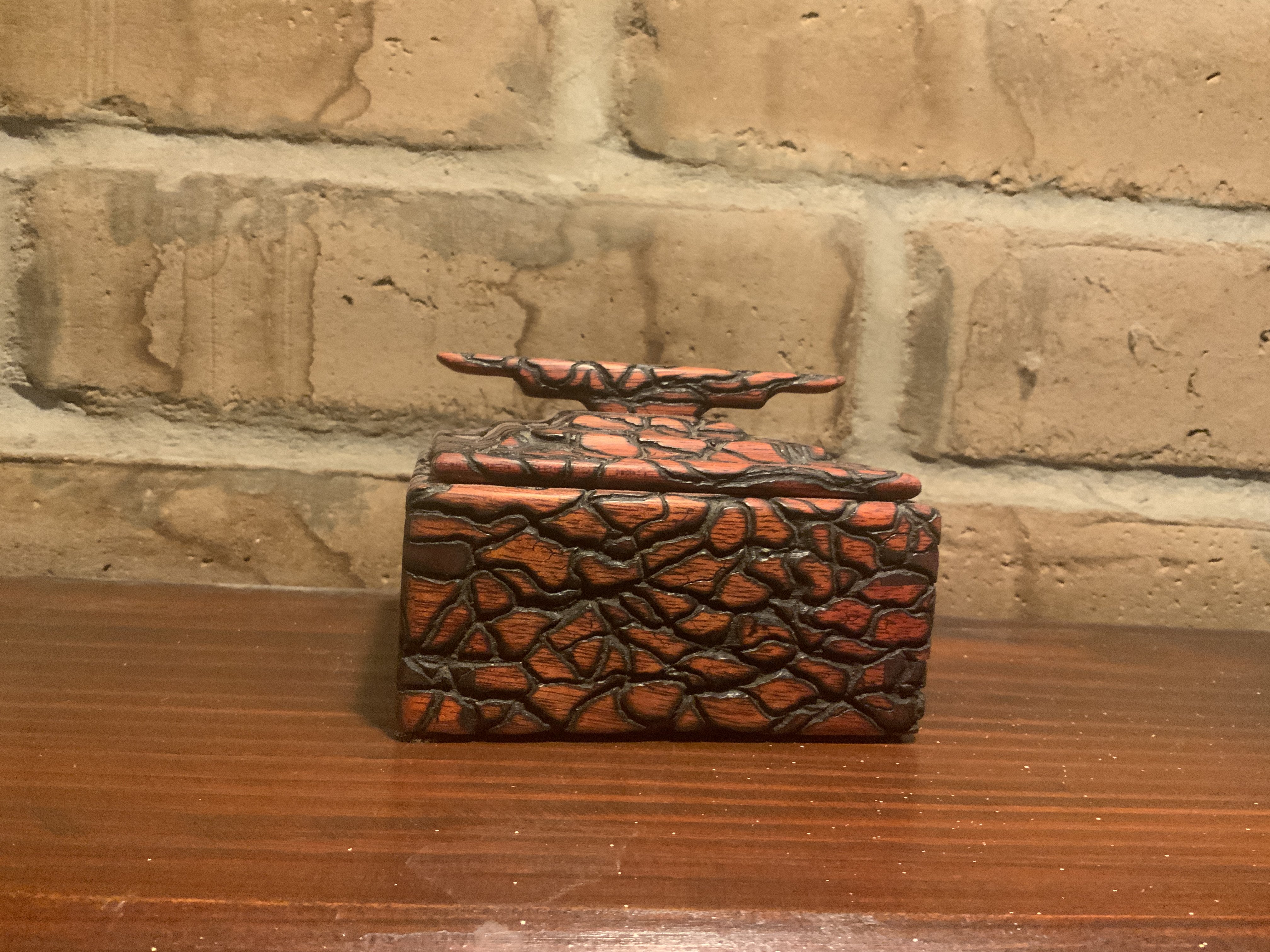

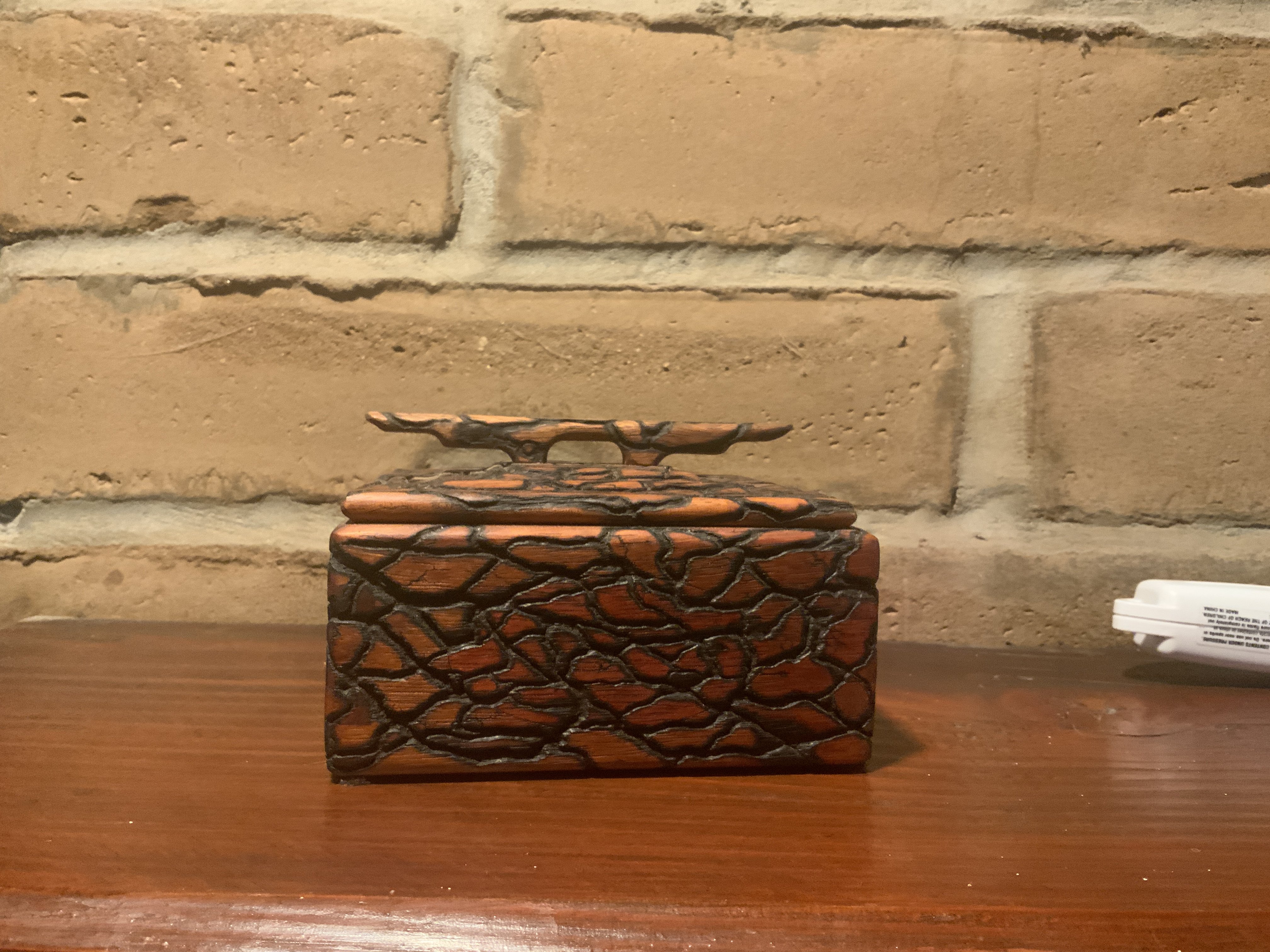

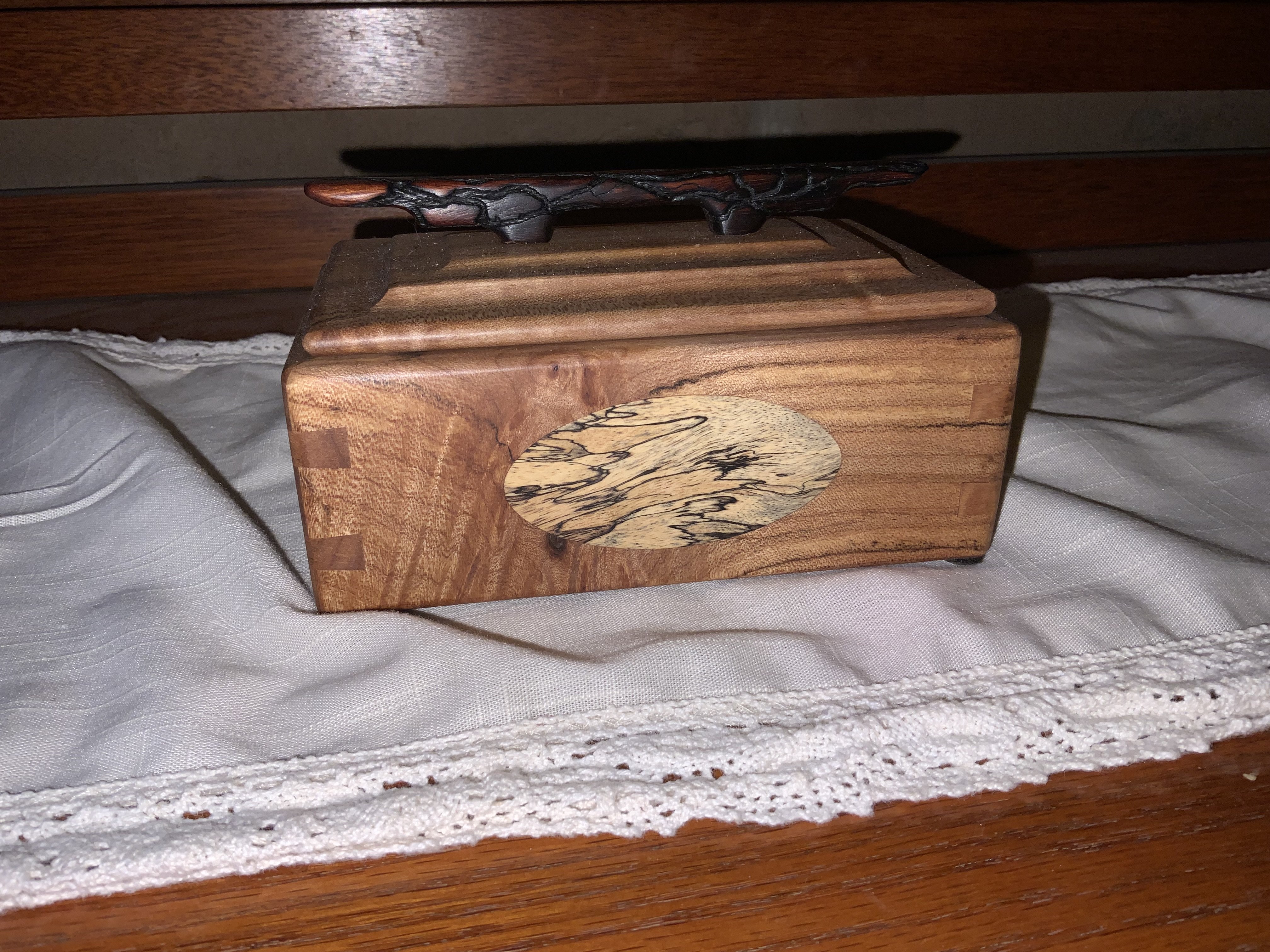

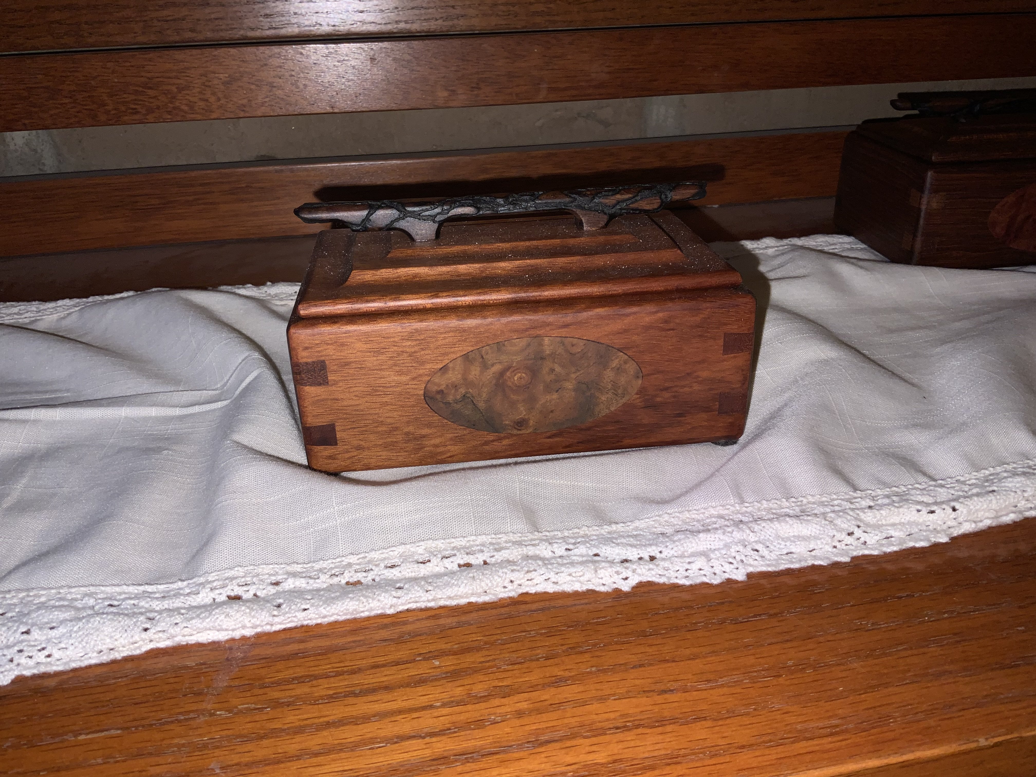

Yul Lose Posted August 17, 2025 Posted August 17, 2025 I’ve been using the sho sugi ban technique for awhile to enhance the lid lifts on boxes that I build. Here are a couple of boxes that I fractal burned and then toasted them with a Bernzamatic torch and then lightly sanded them before the oil finish. The lid lifts were fractal burned and then toasted with the torch, sanded and then finished. I think it adds a lot of character.
Rip Snorter Posted August 17, 2025 Posted August 17, 2025 2 minutes ago, Yul Lose said: I’ve been using the sho sugi ban technique for awhile to enhance the lid lifts on boxes that I build. Here are a couple of boxes that I fractal burned and then toasted them with a Bernzamatic torch and then lightly sanded them before the oil finish. The lid lifts were fractal burned and then toasted with the torch, sanded and then finished. I think it adds a lot of character. Really fine work!

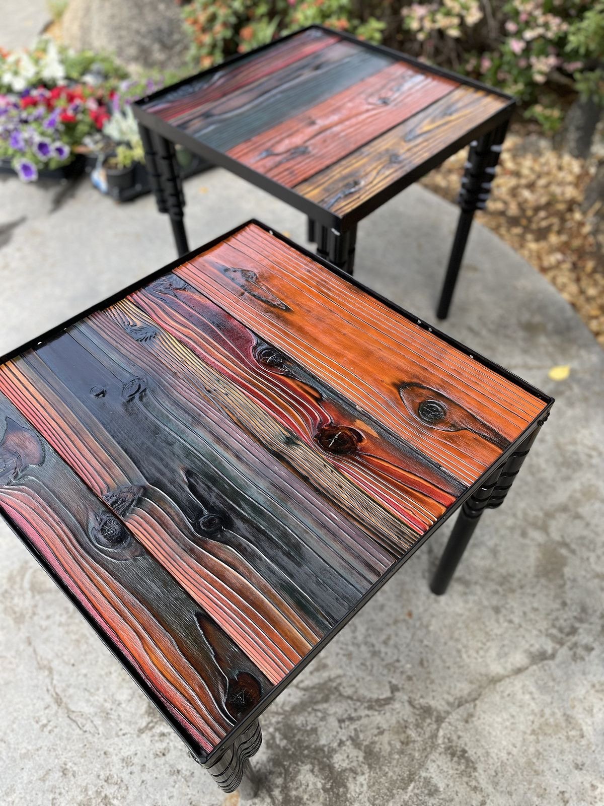

Yul Lose Posted August 17, 2025 Posted August 17, 2025 10 minutes ago, Alpo said: So at its simplest, that's just playing over the surface of the wood with a blowtorch? Pretty much. Here are some Sho sugi ban items from Pinterest where there are thousands of examples of it.

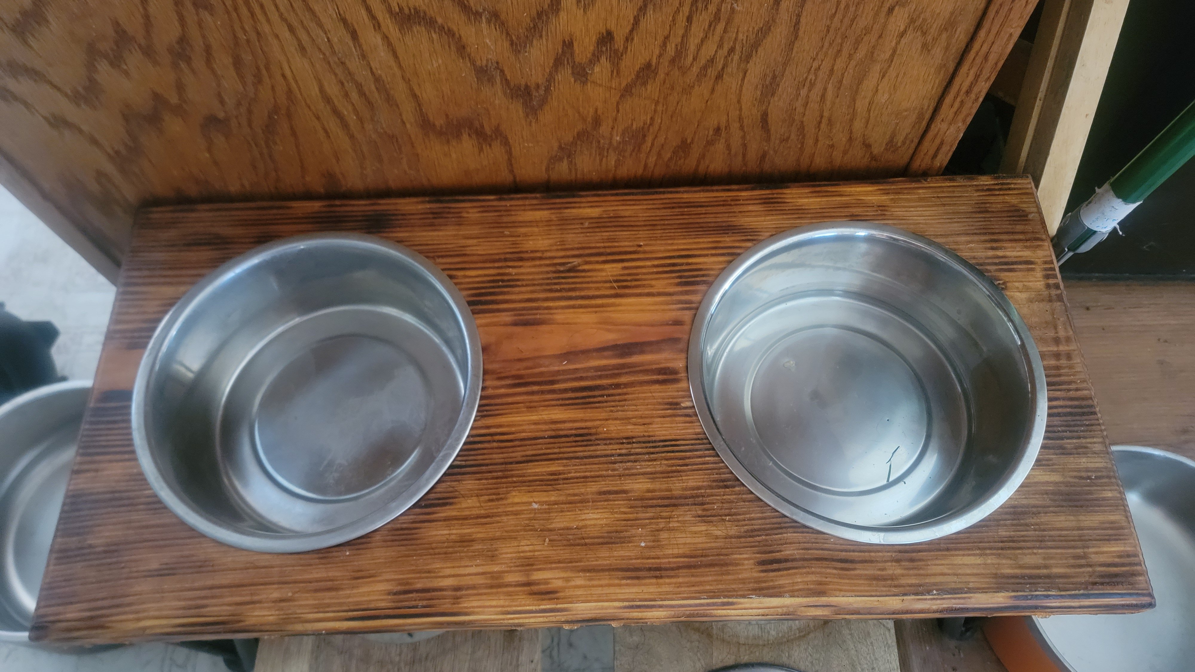

Perro Del Diablo Posted August 17, 2025 Author Posted August 17, 2025 Photo added of dog food stand. Clear coated with linseed oil 3 hours ago, Yul Lose said: Pretty much. Here are some Sho sugi ban items from Pinterest where there are thousands of examples of it. Awesome
