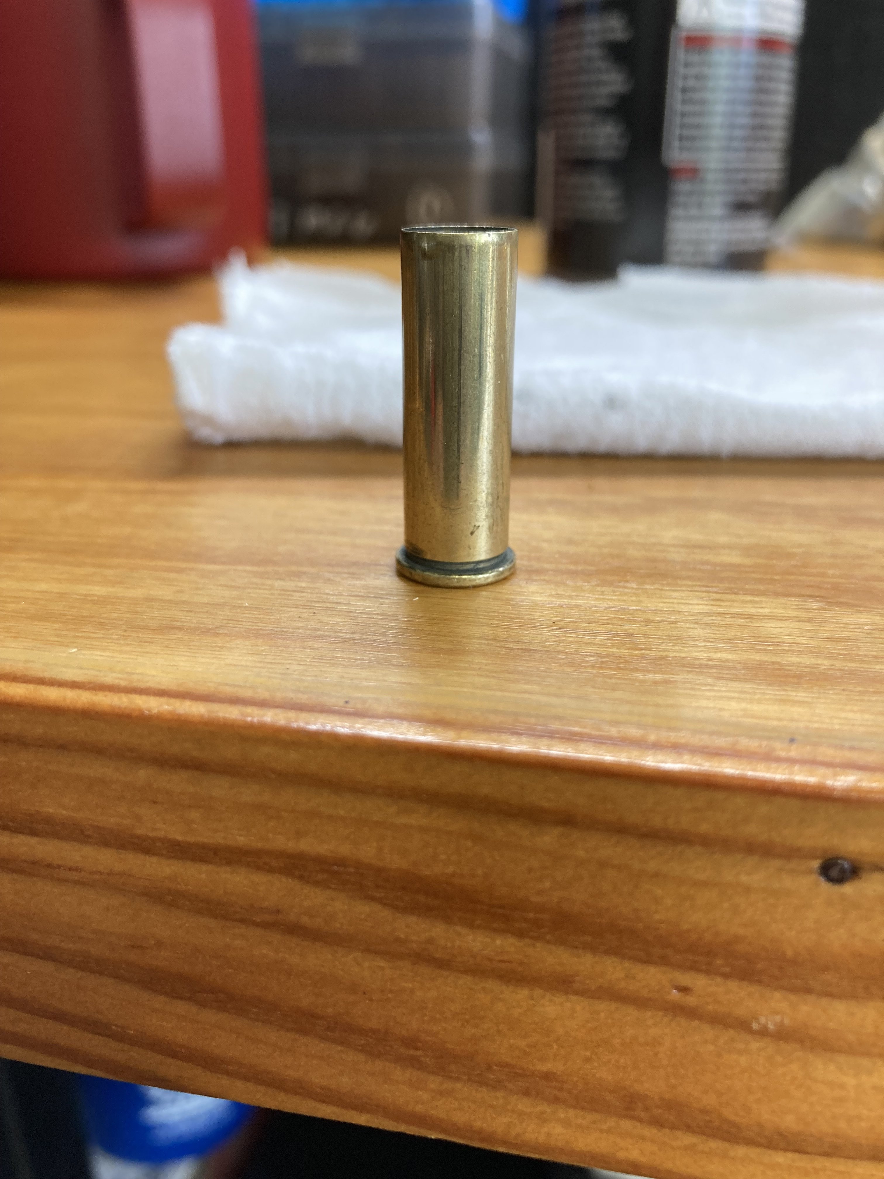

Muggins Posted August 12, 2025 Posted August 12, 2025 My resize die occasionally gets excess material embedded in the carbide ring and then scratches the brass casing during resize. It starts with a single vertical scratch then quickly escalates to multiple vertical scratches as additional material gets embedded in the carbide ring then more and more vertical scratches appear in the brass. I tumble my brass for several hours in corn cob media before resizing with Hornady dies. I’ve sent the resize die back to hornady twice before for them to clean and polish the die back. I reloaded thousands of rounds before the first time it happened, then a couple thousand before it got gunked up again. I purchased another resize die thinking that maybe I just needed to replace that particular die, but now the new one too has a bit of garbage stuck inside the die that I can’t remove. I tried spraying the die with brake cleaner then attacking with a bronze brush in a drill. Soaking the die in brake cleaner then again attacking with an oversized bronze brush. I’ve pounded a wooden dowel inside trying to dislodge, and then I’ve tried Flitz polish to try and clean it. I clean the dies every 500 rounds or so in an attempt to prevent this now frequent occurrence. Since this has happened more than once to two separate Hornady dies resizing 38 special brass I’m assuming I’m doing something wrong. I’m culling split cases and necks but maybe some of the older brass is depositing material inside the die? I’m at a loss for what is causing this and I can’t seem to get the gunk out. Sending the dies back to hornady every 5k rounds doesn’t seem to jive with what other reloaders are doing. I’m sure the fellows with the blue machines will tell me to just buy the blue Dillion dies, but before I do, any insight on what I might be doing wrong? Picture has one vertical scratch down the center. It’s hard to see with the reflection on the brass, but it’s there - the other spots and lines are just the reflection. Quote
Kid Rich Posted August 12, 2025 Posted August 12, 2025 Try making sure your brass is CLEAN before you resize it. Maybe you will have to rinse it with soapy water and then clean water after it is cleaned in the corncob mixture. By the way that piece of brass in your picture is not clean, look down by the base. kR 2 1 Quote

Eyesa Horg Posted August 12, 2025 Posted August 12, 2025 It also looks like the issue I've had with brass filings. The mouth looks rough as did mine. Maybe the brass is just plain old or needs annealing. I switched to brand new brass and will see how it does. I was concerned it was due to wet tumbling as I never had the issue with corncob. Are you possibly putting too much in the hopper dinging up the mouths? Good Luck Quote
