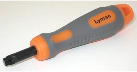

Rye Miles #13621 Posted August 10, 2025 Author Posted August 10, 2025 (edited) 12 minutes ago, Marshal Ruger said: Have you look into using a primer pocket uniformer when you prep the new brass? I use my RCBS case prep machine and it ensures wall and depth is consistent. I have not and I don’t have one. Maybe I’ll look into it. I never even heard of that tool. How about this? Edited August 10, 2025 by Rye Miles #13621 Quote
Marshal Ruger Posted August 10, 2025 Posted August 10, 2025 Personally I have not used the Lyman primer pocket hand tool. It seems it will work. However when I get an order or box of brass from Starline i.e. 500 the hand tool will take alot longer in my opinion. 1 Quote

Sedalia Dave Posted August 10, 2025 Posted August 10, 2025 (edited) 2 hours ago, Rye Miles #13621 said: I have not and I don’t have one. Maybe I’ll look into it. I never even heard of that tool. How about this? All that tool does is clean the primer pocket. It does not make them uniform. 3 hours ago, SouthwestShooter said: Could that compromise the primers during reloading???? Once dry, there is no possibility of contamination. Edited August 10, 2025 by Sedalia Dave 1 2 Quote
