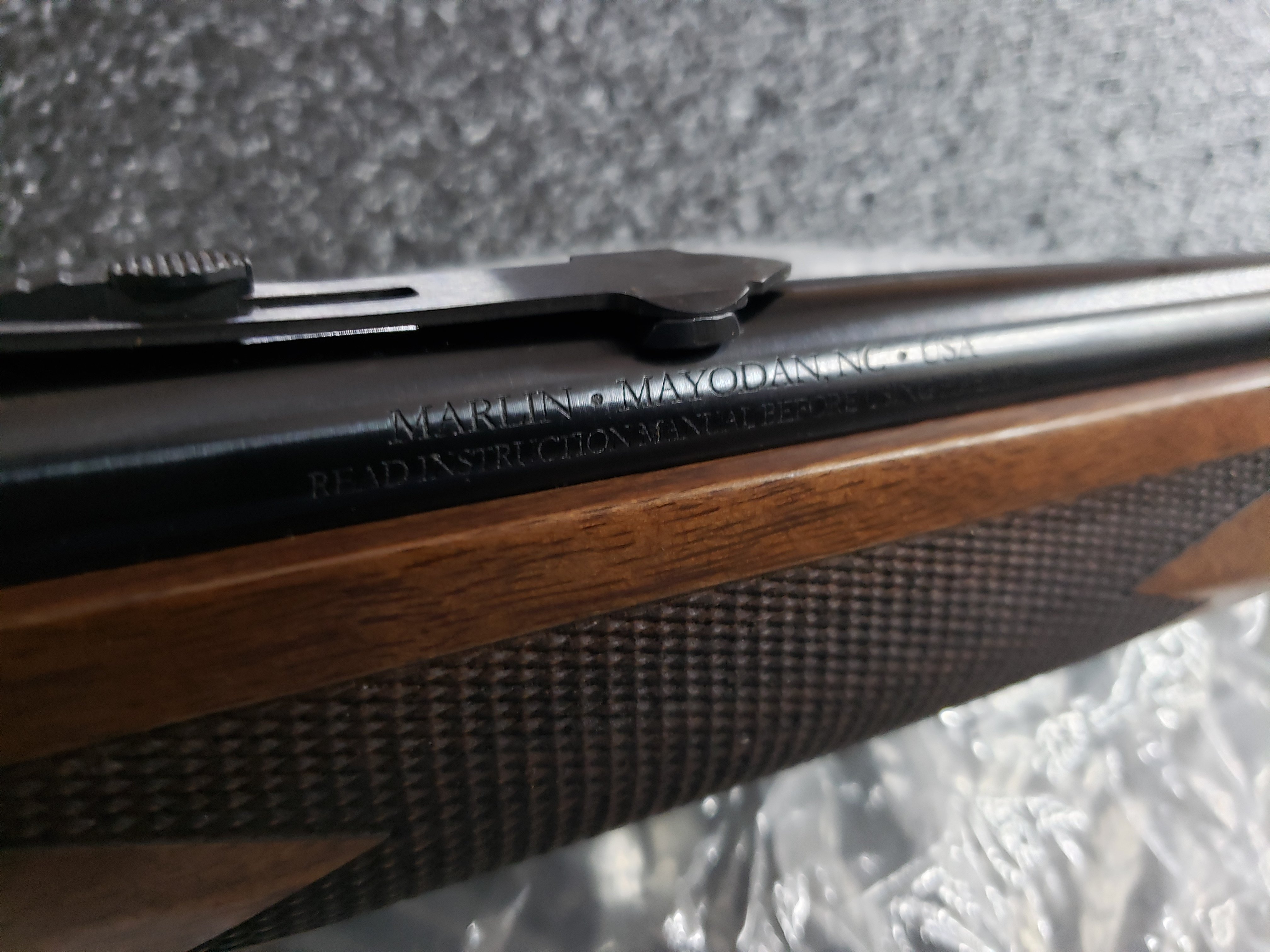

El Mulo Vaquero, SASS #55942 Posted August 5, 2025 Posted August 5, 2025 Barrel markings on a new Ruger made Marlin 1894. The serial number also begins with RM. 2 2 Quote
