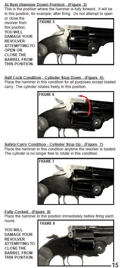

Can't do that on mine. To lower the hammer, the Schofield has to be fully cocked first. The bolt stop is up preventing the cylinder from being moved.
Also, though not mentioned above, in normal operation, the latch cannot be closed when the hammer is down (See 2) below). So the revolver should be on half cock or the safety/carry position when it is being closed and with proper operation and only five rounds loaded, the hammer would then be lowered on an empty cylinder.
1) With six loaded or with five and improperly indexed, the hammer could be lowered on a loaded chamber. And, if moved from the half cock or safety/carry to fully cocked and the hammer is forcefully lowered, e.g. trigger pulled, BANG!
2) The latch can be closed with the hammer down if enough force is used but it will most likely bend the bolt stop pin and cause indexing problems. (As mentioned in the User Manual)
As to the original question of purpose - I have no idea.
From the users manual:
