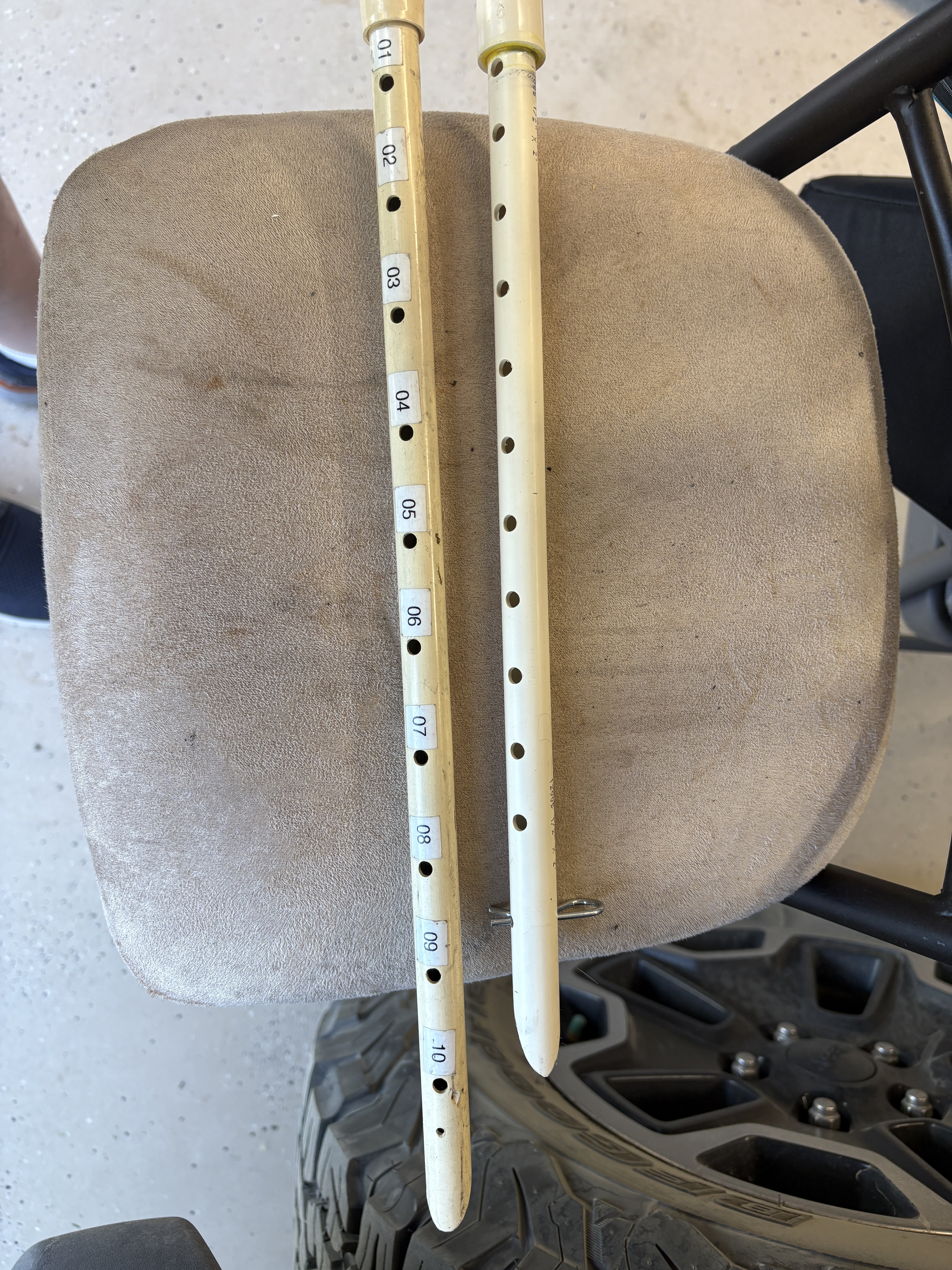

Cholla Posted July 24, 2025 Author Posted July 24, 2025 58 minutes ago, Sheriff Dill said: I would love to see a photo of one for the 73 in 357. My son has been wanting one but I can’t find one to make Here two without the push sticks. Ones for 9mm and the other 357. 1 1 Quote
Sheriff Dill Posted July 24, 2025 Posted July 24, 2025 39 minutes ago, Cholla said: Here two without the push sticks. Ones for 9mm and the other 357. Thanks. Appreciate it. Do just use a wooden dowel to push the rounds in ? Quote
Cholla Posted July 24, 2025 Author Posted July 24, 2025 27 minutes ago, Sheriff Dill said: Thanks. Appreciate it. Do just use a wooden dowel to push the rounds in ? Yes, a 3/8" hole is drilled through the CPVC cap. A 3/8" dowel with a wooden drawer pull tops the dowel. Quote

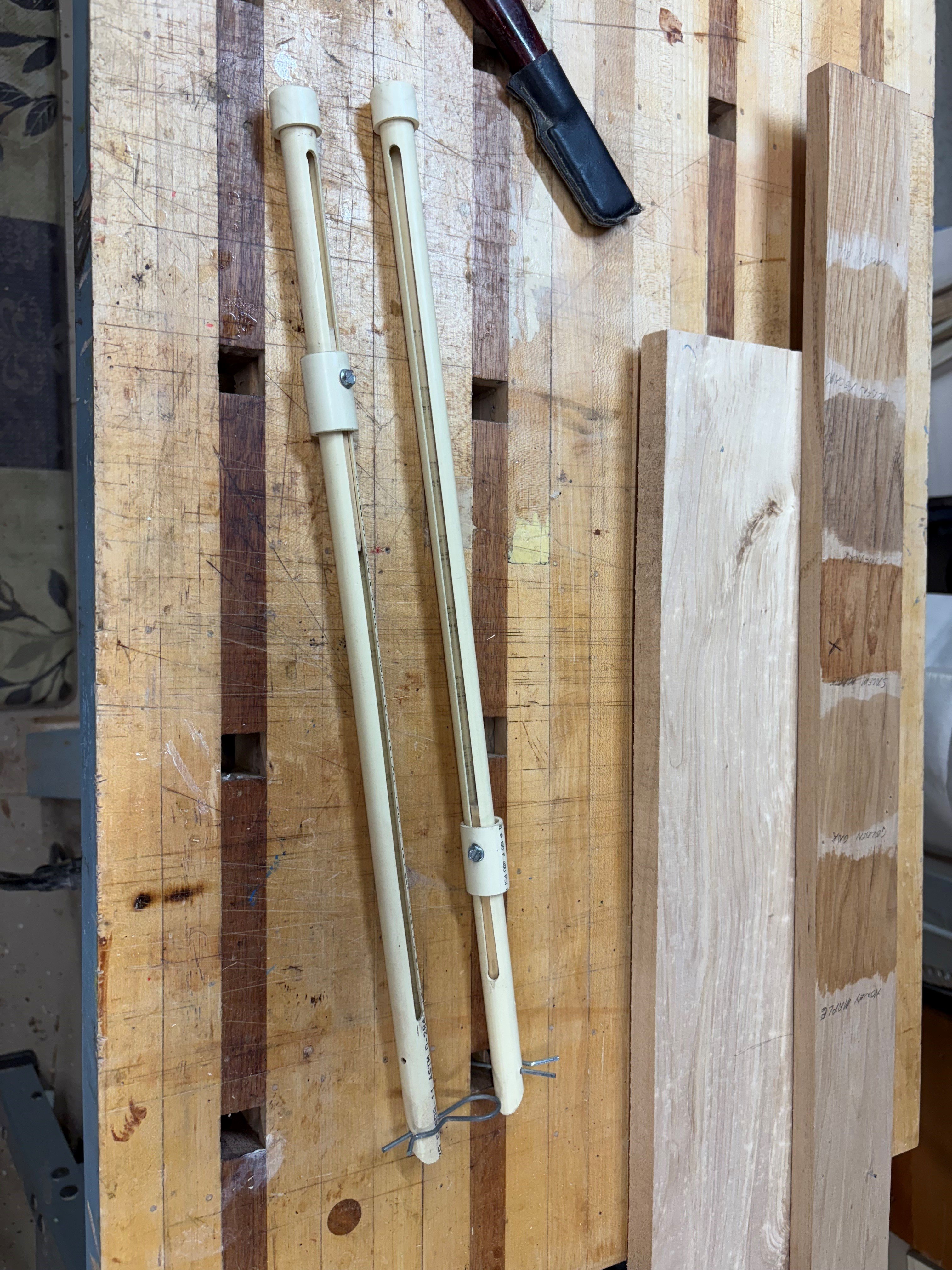

Chancy Shot, SASS #67163 Posted July 24, 2025 Posted July 24, 2025 These are what I use for my Marlin. The Marlin bites my fingers. My 73 loads very easily and I don't need them for it. They are a little more complicated to make. The slot is made with a router. The plunger is a dowel captured by the slider. There are two sets of holes for the spring clip. One for 10 rounds and one for nine. Chancy 4 Quote

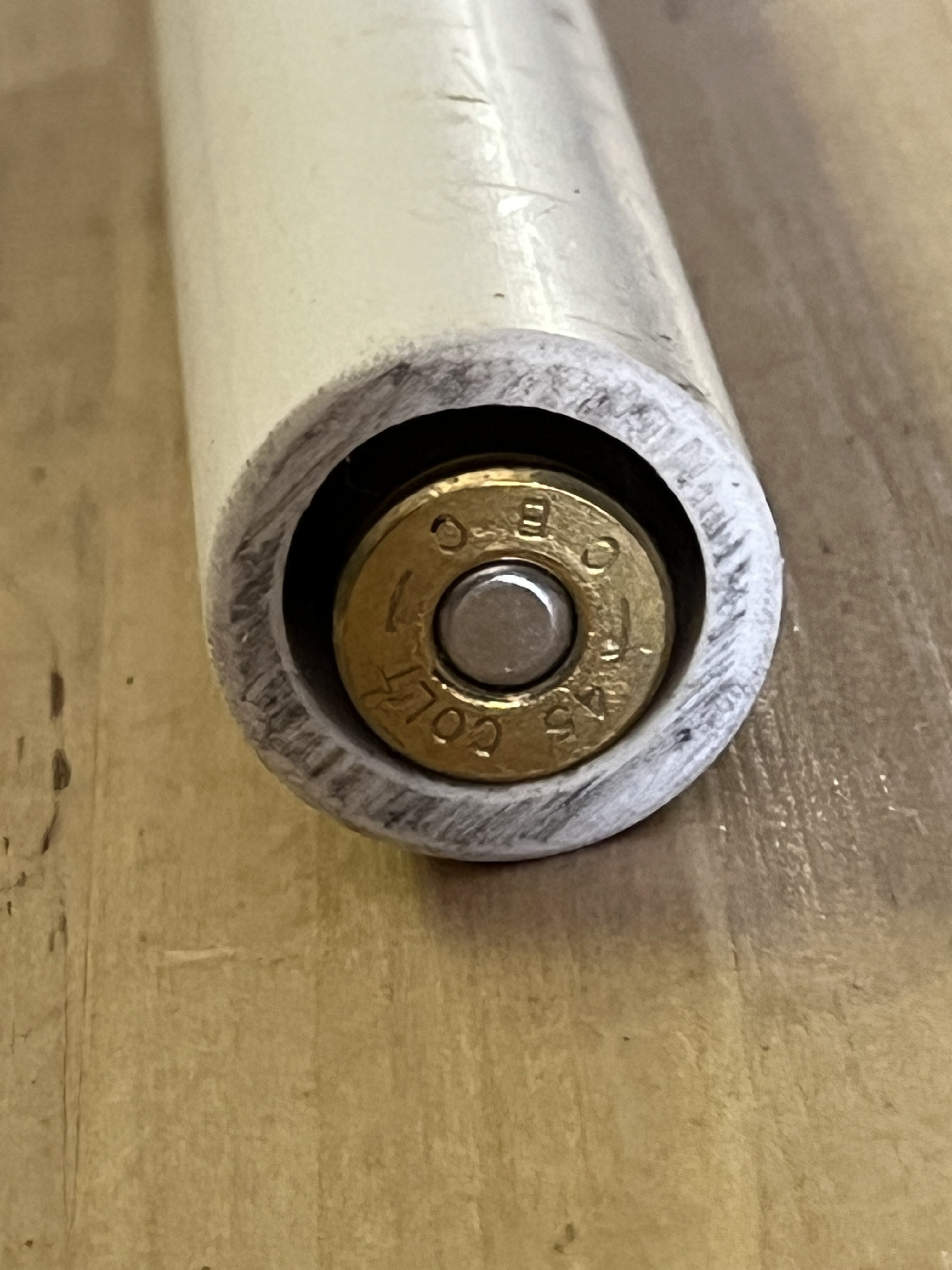

KingSnake Posted July 25, 2025 Posted July 25, 2025 1/2” PVC Schedule 40 with a 45 Colt cartridge 1 Quote
