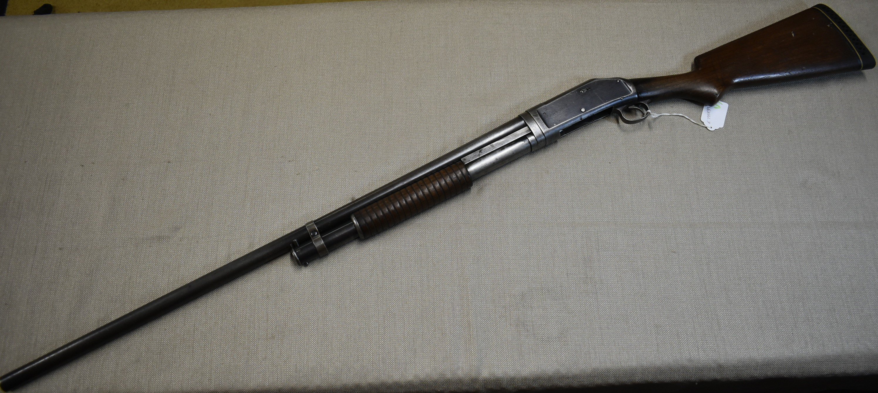

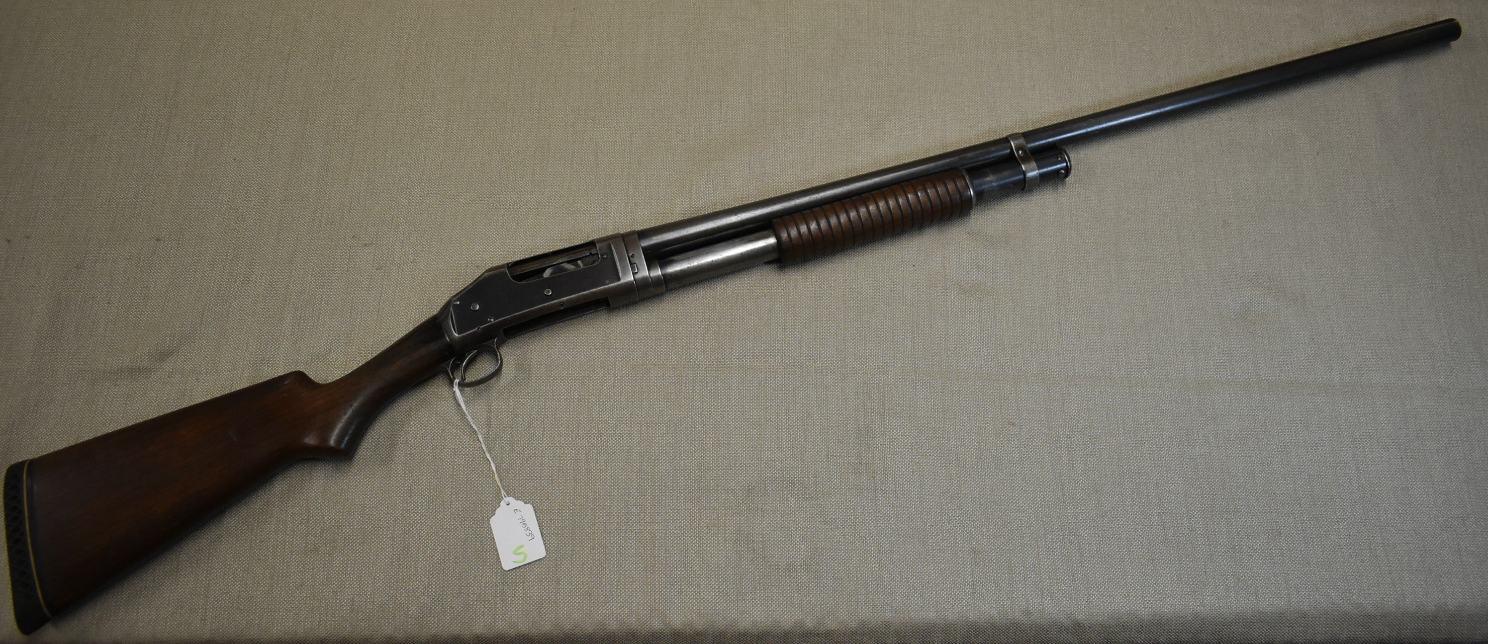

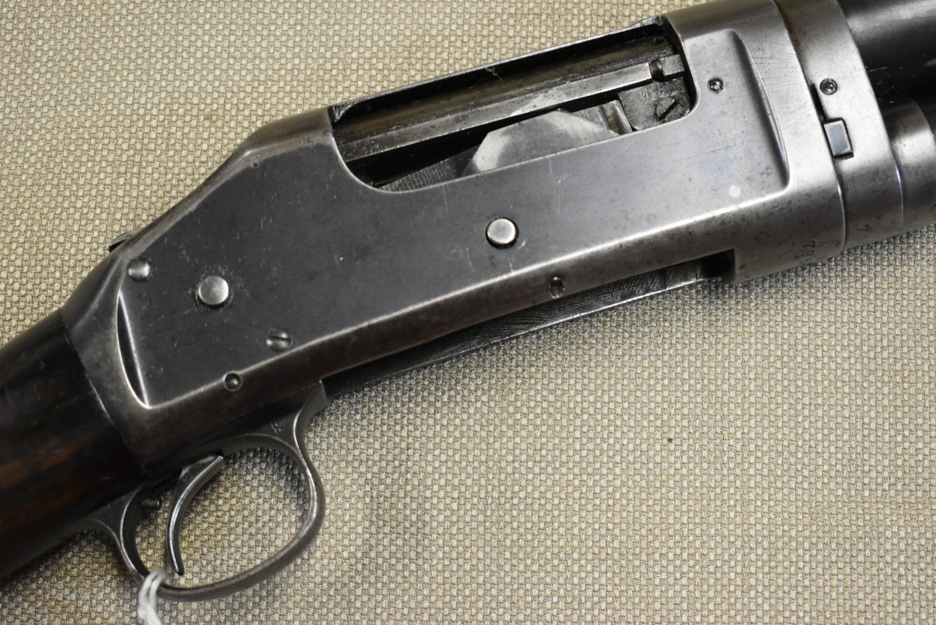

Trenchgun831 Posted July 20, 2025 Posted July 20, 2025 Hello, I just picked up a 30” full choke 1897 Winchester made in 1927 that I’m hoping to use for dove season this year. (Hunting with an almost 100 year old gun sounds very cool) I was wondering, I know you can’t shoot steel birdshot out of them. what is the cheapest/best birdshot that you can shoot out of it without harming the barrel? Quote

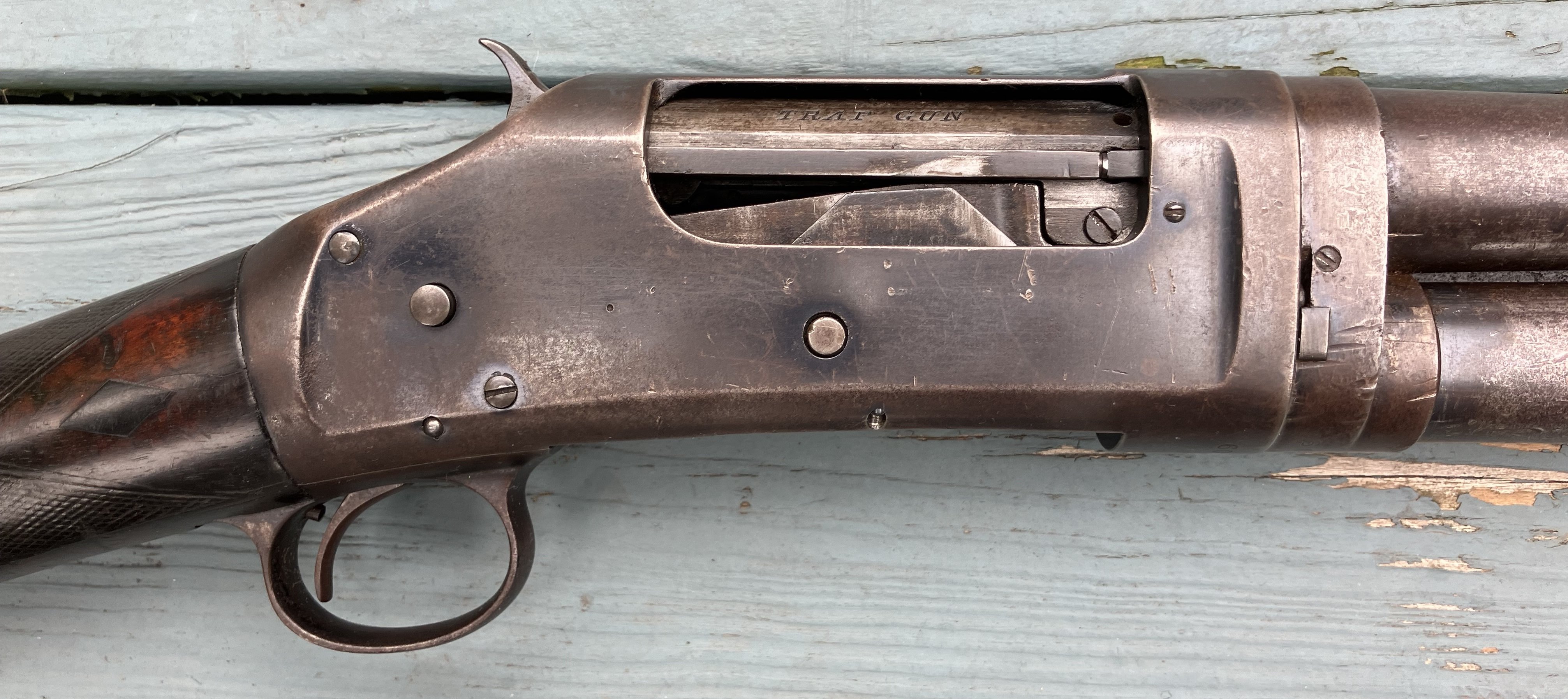

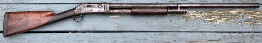

H. K. Uriah, SASS #74619 Posted July 20, 2025 Posted July 20, 2025 (edited) Roll your own ammo. Use either all brass 2.5" Magtech, or trim some AA's back to that length. 12 grains of Red Dot with anywhere from 1 to 1-1/8 oz of shot should be adequate. If you want a stouter load, go with 16.4 grains of Red Dot with 1-1/8 ounce. This load was what my father used for trap shooting. I used it for years in Cowboy shoots until I realized that it had too much recoil in my 19" Parker, so I developed the 12 grain load after deciding that the 10 grain load I'd read about was too wimpy. And this is my primary Main Match shotgun... And, if you are not sure what's so special about it... Yep, it's a Black Diamond Trap model. It may have a faded finish, but it's the tightest 97 in my collection, or that I've ever handled. It is one heck of a sweet shooter, and has the most natural pointing aim of any of the ones I have. (This, a generic 30", a 20", a replica Trench Gun, a 93/97 and a real 93 with a 30" barrel.) Edited July 20, 2025 by H. K. Uriah, SASS #74619 1 Quote
