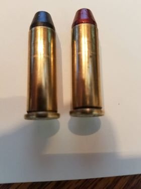

Texas Maverick Posted June 29, 2025 Posted June 29, 2025 I have shot this load for 7 years now without any issues. 38 case 3.2 grains of Cleanshot for smokeless loads (can get from @Scarlett) 1cc Lee dipper for my APP blackpowder loads which you can also get from Scarlett 125 grain bullet (can get from Slippery Bullets - https://slipperybullets.com/product/38-357-125-tfp-ht/) Federal SPP primers OAL 1.45 This load is shot in my NMV and my Uberti 1873. This makes it easier, one load for revolvers and rifle. I load my smokeless with either the red or green lead bullet and my black powder with the black lead bullets. Nice clean reload and not a lot of kick. TM
