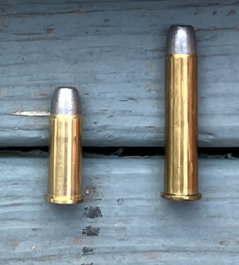

H. K. Uriah, SASS #74619 Posted June 21, 2025 Posted June 21, 2025 Well, I already designed the cartridge.... The cartridge on the right is a .45-70. The cartridge on the left is a .45-70 cut back to .45 Colt length. I call it the .45-45. Both are loaded with the same 300 grain .458" bullet I used data for a .45 Colt with a 300 grain bullet to develop a load. I "designed" it for use as a sub round in single shot rifles chambered for .45-70 for informal plinking. It works very well in that context. No recoil whatsoever. On a whim, I loaded some into my Winchester 1886, and they worked! You have to be a little careful, but they did properly cycle. I also tried them in a Uberti 76 in .45-60. The double feeded, (Or is that double fed?) so they did not work. Then I tried them in my large frame Colt Lighting. Dang it all of they did not function flawlessly and with no need to slow down or be careful. That made me quite happy. I did ask the powers that be if the cartridge would be SASS Legal in several different contexts, and I was told no. No biggie. I did it for informal reasons to begin with. But now that the cartridge "exists," it would perhaps be fun if I purpose built gun could be made for it. It would of course work in those behemoth sized pistols chambered for .45-70, but maybe something only slightly larger than a standard SAA could work with it. Or some sort of a repeating rifle. No need to purpose build a single shot rifle, as any .45-70 would do. Hey! Maybe a derringer for it would be nice. As far as I know, the only derringers for .45-70 are single barrel ones, this one could be no more powerful than the hottest .45 Colt loads. Interestingly, I did not design this to be a "hot .45" I designed it to be a "mild .45-70." 1 Quote
Sgt. C.J. Sabre, SASS #46770 Posted June 22, 2025 Posted June 22, 2025 (edited) 19 minutes ago, H. K. Uriah, SASS #74619 said: Hey! Maybe a derringer for it would be nice. As far as I know, the only derringers for .45-70 are single barrel ones, this one could be no more powerful than the hottest .45 Colt loads. Interestingly, I did not design this to be a "hot .45" I designed it to be a "mild .45-70." Would it work in a Taurus Judge? Or a S&W Governor? How about a pic comparing it to a .45 Colt? Maybe somebody knows of another .45 Colt with a slightly longer cylinder. Edited June 22, 2025 by Sgt. C.J. Sabre, SASS #46770 Quote
H. K. Uriah, SASS #74619 Posted June 22, 2025 Posted June 22, 2025 2 minutes ago, Sgt. C.J. Sabre, SASS #46770 said: Would it work in a Taurus Judge? Or a S&W Governor? If those pistols are chambered for .45-70, yes. If they are not, no. Quote
Sgt. C.J. Sabre, SASS #46770 Posted June 22, 2025 Posted June 22, 2025 1 minute ago, H. K. Uriah, SASS #74619 said: If those pistols are chambered for .45-70, yes. If they are not, no. Okay, I guess that any existing pistol except for a BFR or an old Century would be out. Would it be worth it, (to you), to have an SAA, or anything else for that matter, barrel bored out to handle the .458 bullet, and the chamber reamed out for the case? Maybe a .454 Casull like a Taurus Raging Bull. Or might a Super Blackhawk have the beef to handle it. Quote

H. K. Uriah, SASS #74619 Posted June 22, 2025 Posted June 22, 2025 5 hours ago, Sgt. C.J. Sabre, SASS #46770 said: Okay, I guess that any existing pistol except for a BFR or an old Century would be out. Would it be worth it, (to you), to have an SAA, or anything else for that matter, barrel bored out to handle the .458 bullet, and the chamber reamed out for the case? Maybe a .454 Casull like a Taurus Raging Bull. Or might a Super Blackhawk have the beef to handle it. Too make a long story short, I did some measuring. A Walker is not big enough. Nor is the Uberti SAA clone in .44 Magnum that has a slightly enlarged frame. Part of the "problem" is that the .45-70 is not a straight case, it is tapered jus a bit to be wider at the base than the mouth. Just wider enough that things don't fit. I'd still enjoy finding one of the old Centuries though, just for fun. Quote
Boggus Deal #64218 Posted June 22, 2025 Posted June 22, 2025 4 hours ago, H. K. Uriah, SASS #74619 said: Too make a long story short, I did some measuring. A Walker is not big enough. Nor is the Uberti SAA clone in .44 Magnum that has a slightly enlarged frame. Part of the "problem" is that the .45-70 is not a straight case, it is tapered jus a bit to be wider at the base than the mouth. Just wider enough that things don't fit. I'd still enjoy finding one of the old Centuries though, just for fun. A New Model Blackhawk or Super Blackhawk would work with a 5 shot cylinder. John Limbaugh used them and the .45-70 case to make the .475 Limbaugh. The .475 is a shortened and straightened .45-70. Quote

H. K. Uriah, SASS #74619 Posted June 22, 2025 Posted June 22, 2025 Let's assume that there is a revolver on the market that could handle the .45-45. All it would need would be a cylinder that holds the cartridges, and a barrel with the correct bore. The latter is easy enough to do. The former is more questionable, but if a large enough cylinder exists, it could be done. Quote

Boggus Deal #64218 Posted June 22, 2025 Posted June 22, 2025 33 minutes ago, H. K. Uriah, SASS #74619 said: Let's assume that there is a revolver on the market that could handle the .45-45. All it would need would be a cylinder that holds the cartridges, and a barrel with the correct bore. The latter is easy enough to do. The former is more questionable, but if a large enough cylinder exists, it could be done. Nothing to assume. It has been done. Cylinders made from scratch or I’d look at a Ruger Bisley in .454 should be enough meat to rechamber. It would be only a five shot gun. Bowen made a .577 Redhawk. Quote
