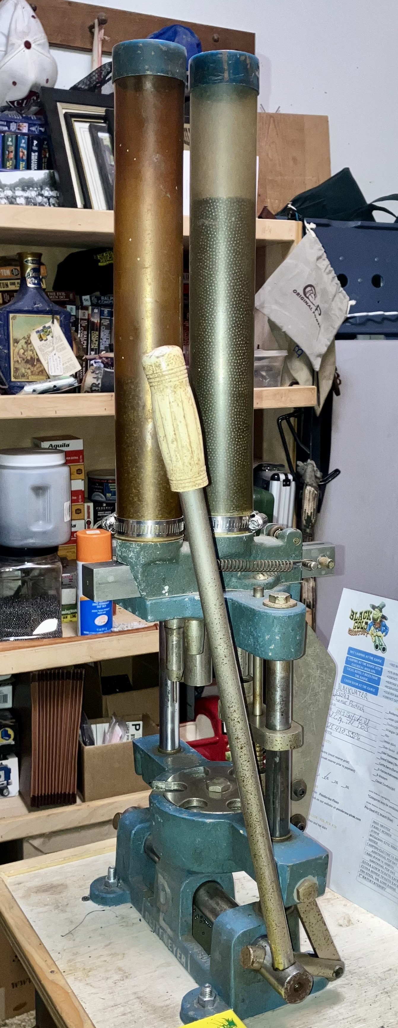

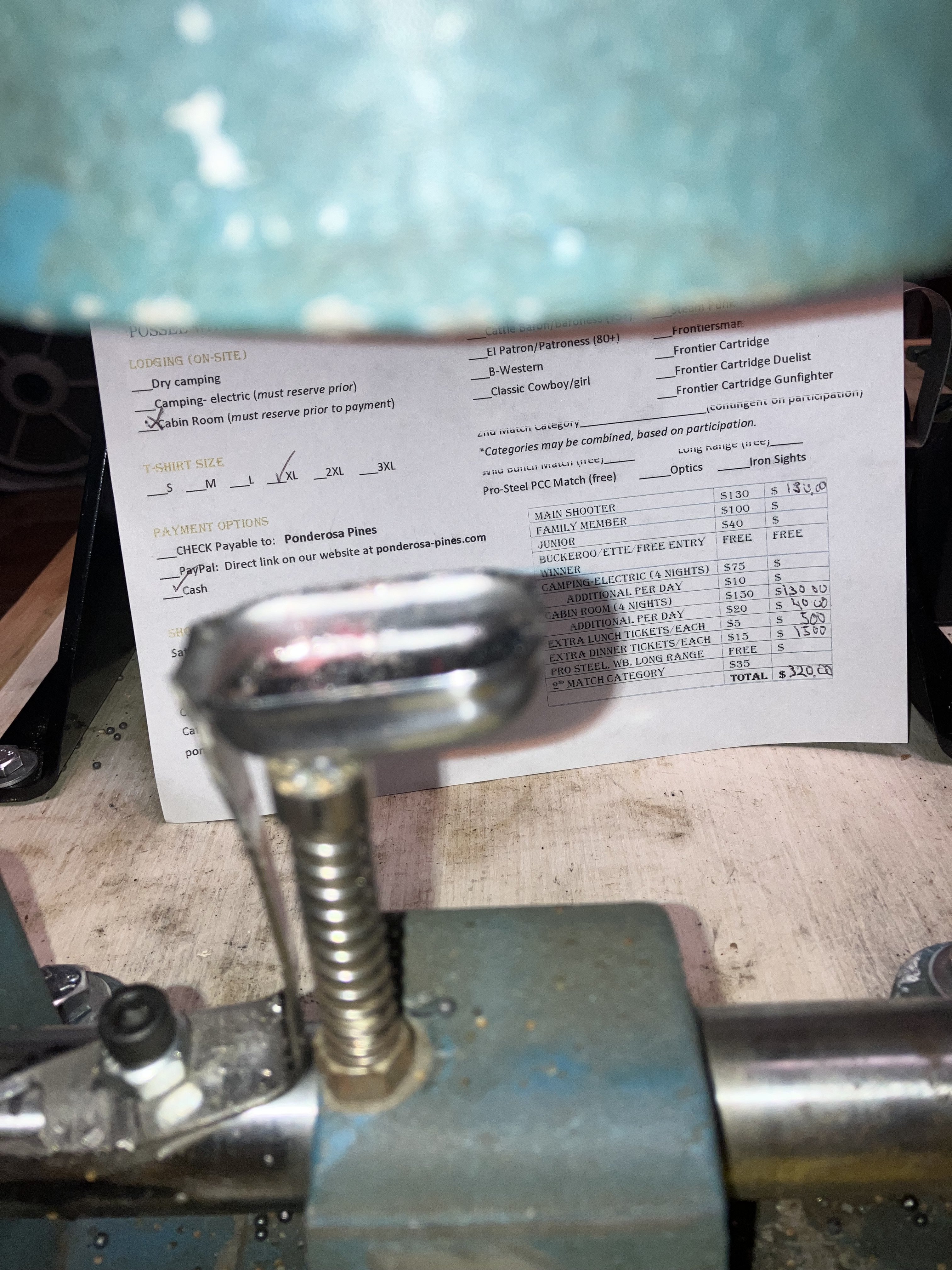

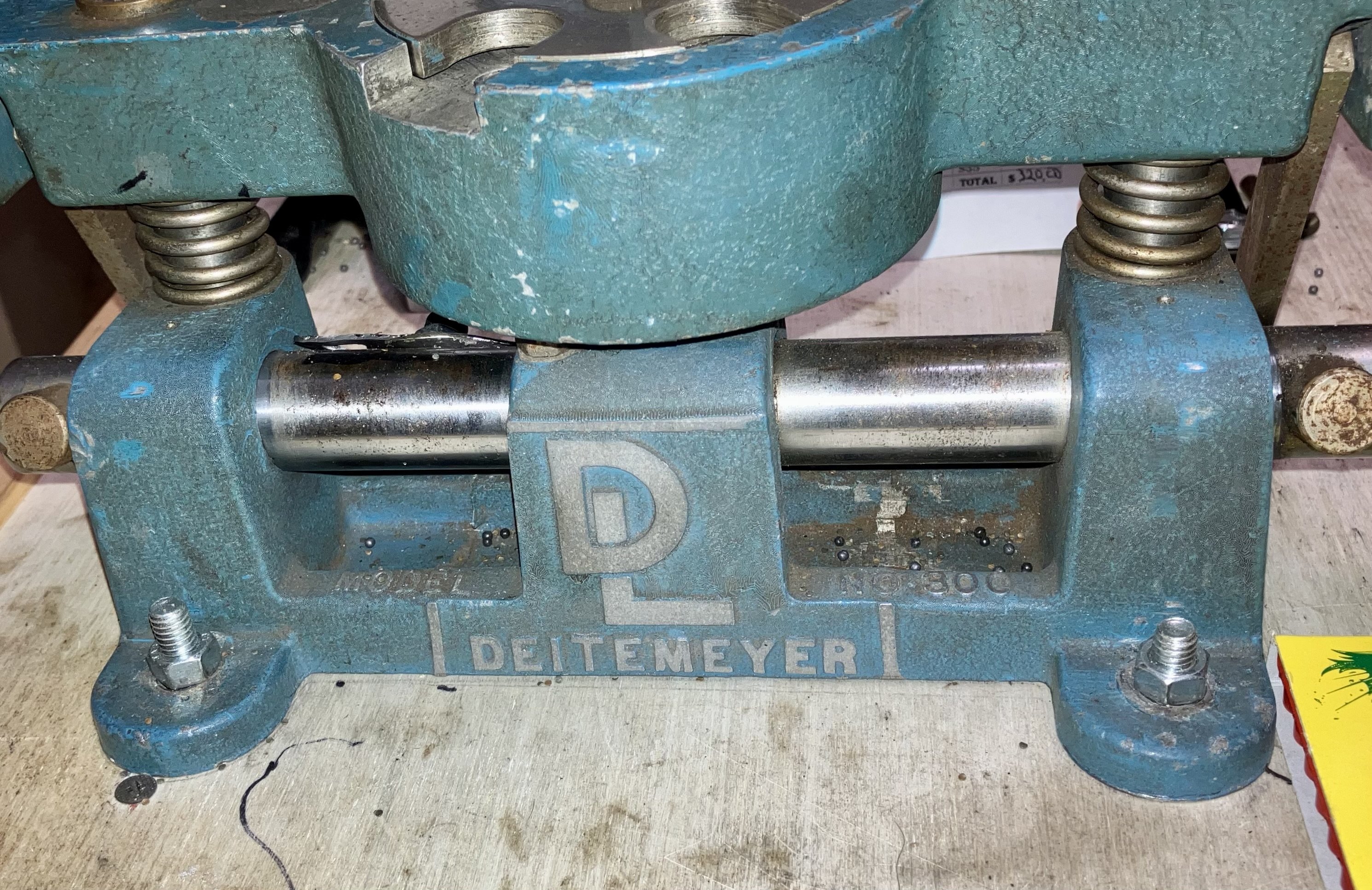

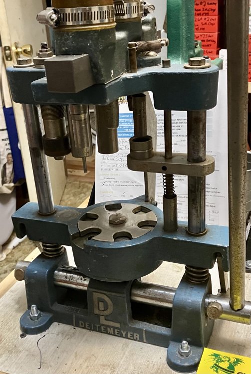

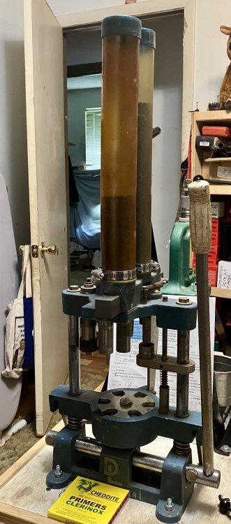

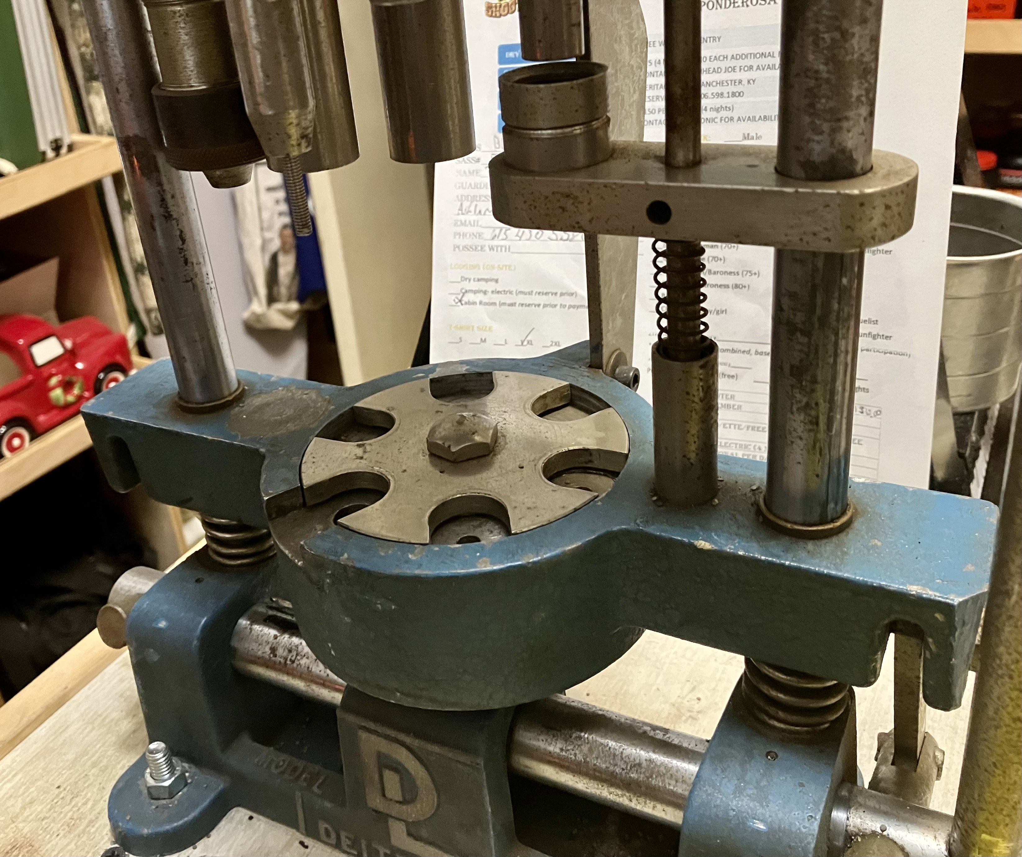

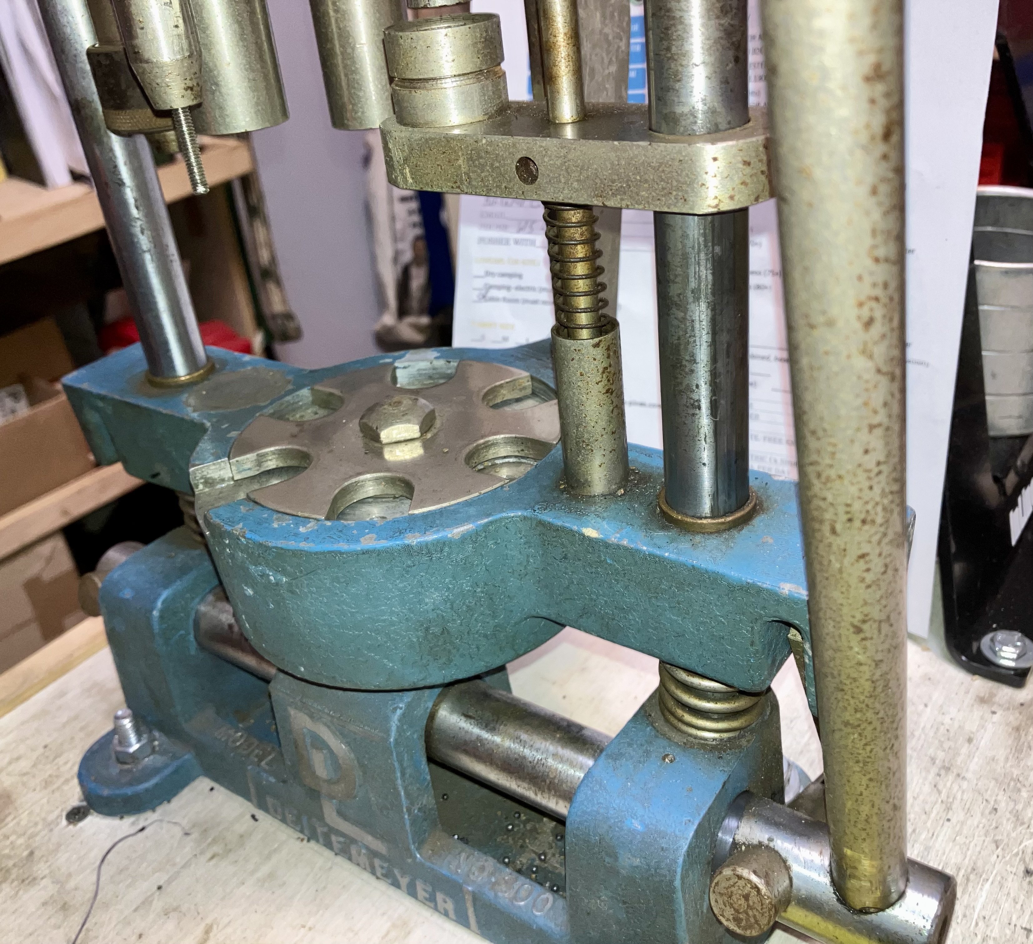

Blackwater 53393 Posted June 19 Posted June 19 (edited) Just for a good laugh, I’m posting pictures of my Deitemeyer 300 semi-progressive shot shell press. It was manufactured in the ‘50s and it still works great! I use it for my standard smokeless CAS loads. It’s not fully progressive as you do have to advance the shells manually, but it drops powder and shot consistently and gives really nice finished crimps. I HAVE made a few modifications to it. The charge bar has been machined to accept bushings for powder and shot. The originals were bored like some of the MEC bars with no provision to change charges without replacing the entire bar. A full set of bushings cost me less than $50.00 and the machine shop charged me $20.00. I fabricated a spent primer catcher to keep primers from falling all over everything when they get punched out. ‘Bout $10.00 for a pack of measuring spoons and some allen bolts to attach it. I still have a little tinkering to do with it, but it’s working fairly nicely. My son, Hatfield, has produced an easy couple hundred shells on it in an hour or so and they all go BANG!!! It’s a fun old machine and it’s built like an anvil! The thing is somewhere around 70 years old and it is pretty darned reliable if I do my part Edited June 19 by Blackwater 53393 5 2 Quote
