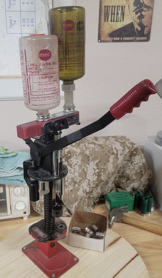

Texas Maverick Posted June 8, 2025 Posted June 8, 2025 On 6/8/2025 at 1:20 AM, Dapper Dave said: So, to jump in here, another newbie shotgun reloader with MEC jr questions. First, this happened today. Thank you, Kid Rich! I am going to find a nice thick board to mount it on, but I have never used a MEC or reloaded shotgun other than tool-less black powder shell loading. I was kinda apprehensive until I saw the video above - this thing looks really easy to use! You might want to buy a cookie sheet with the turned up edges. This is a trick most of us use to keep the powder and shot from spilling all over your bench. They are reasonably cheap and you just put it between the press and your loading bench. Just drill holes through the sheet and bolt it all down. TM

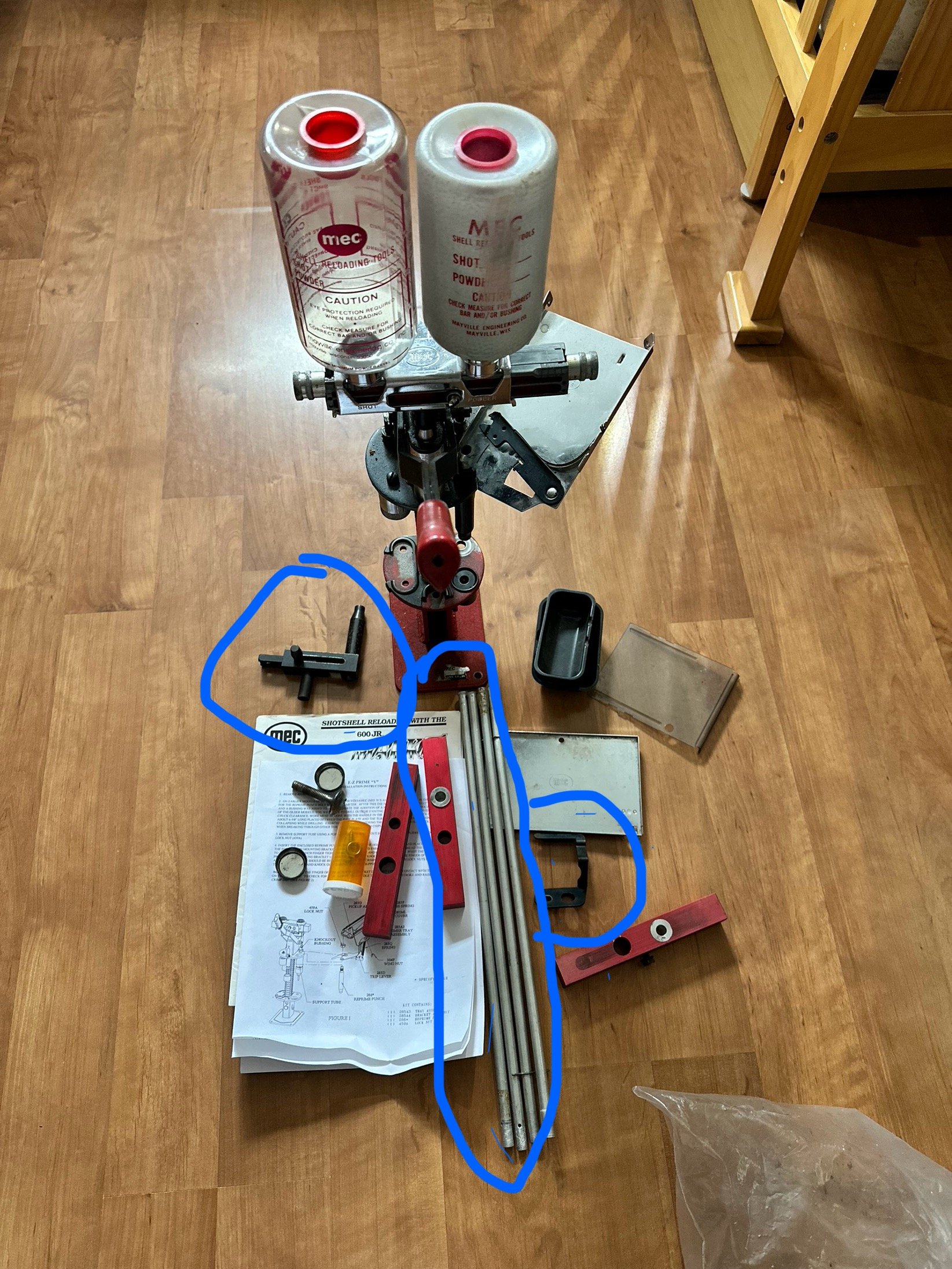

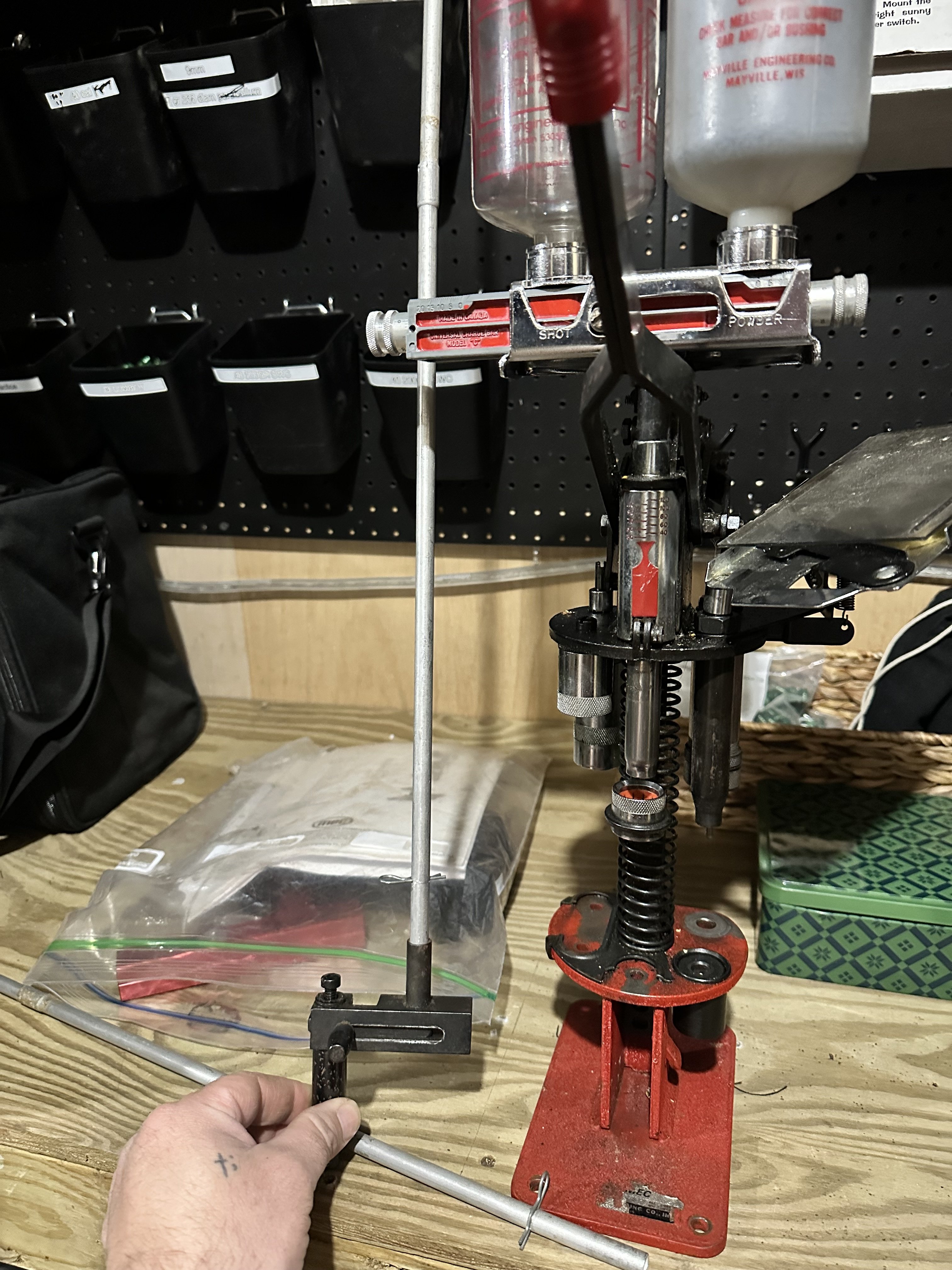

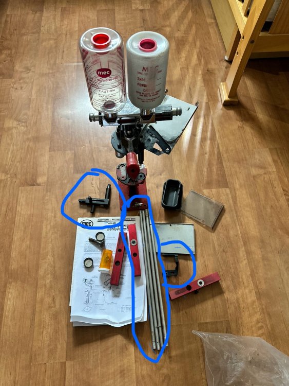

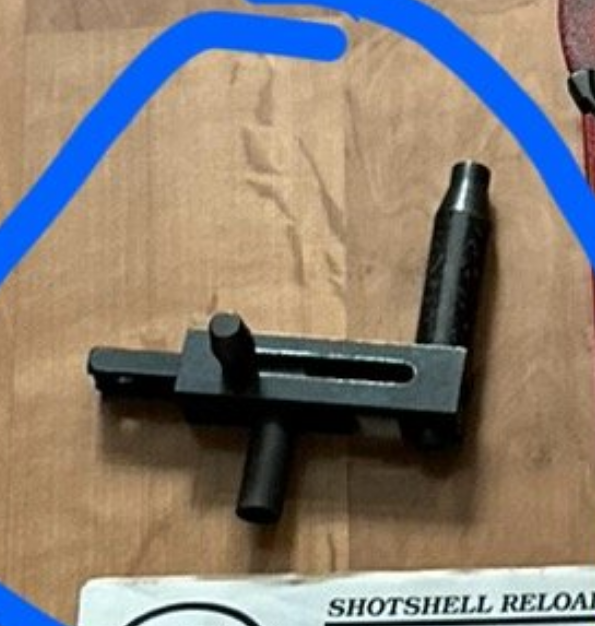

Sheriff Dill Posted June 10, 2025 Author Posted June 10, 2025 Picked the press up. Got a few pieces I’m not sure what they are assuming they go to a different press. Any help would be great. The circled items are the items I’m not sure about. The silver tubes appear to be some type of primer picker as they have the pin at one end.
Eyesa Horg Posted June 10, 2025 Posted June 10, 2025 6 minutes ago, Sheriff Dill said: Picked the press up. Got a few pieces I’m not sure what they are assuming they go to a different press. Any help would be great. The circled items are the items I’m not sure about. The silver tubes appear to be some type of primer picker as they have the pin at one end. The piece on the right is the finger lever for moving the powder/shot bar. There should be a hex bolt with it as well.
Sheriff Dill Posted June 10, 2025 Author Posted June 10, 2025 35 minutes ago, Eyesa Horg said: The piece on the right is the finger lever for moving the powder/shot bar. There should be a hex bolt with it as well. Does it attach even with the adjustable charge bar ? Only two screws with it. One with washer in orange bottle and bigger one behind bottle on manual
Sedalia Dave Posted June 10, 2025 Posted June 10, 2025 The silver tubes are primer tubes or primer pickup tubes for use with metallic cartridge reloading . What they actually fit I couldn't tell you with having them in hand.
Sedalia Dave Posted June 10, 2025 Posted June 10, 2025 1 hour ago, Eyesa Horg said: The piece on the right is the finger lever for moving the powder/shot bar. There should be a hex bolt with it as well. How does that mount? I have never seen anything like that on a MEC Press
Eyesa Horg Posted June 10, 2025 Posted June 10, 2025 59 minutes ago, Sheriff Dill said: Does it attach even with the adjustable charge bar ? Only two screws with it. One with washer in orange bottle and bigger one behind bottle on manual It goes on the front and is used to slide the bar back and forth to drop powder or shot. It also holds the bar in there.
Sheriff Dill Posted June 10, 2025 Author Posted June 10, 2025 30 minutes ago, Eyesa Horg said: It goes on the front and is used to slide the bar back and forth to drop powder or shot. It also holds the bar in there. I’ll look at it when later and see how it goes. It appears just like you said that bolt is missing. Did the older ones have this piece also?
Sedalia Dave Posted June 11, 2025 Posted June 11, 2025 2 hours ago, Eyesa Horg said: It goes on the front and is used to slide the bar back and forth to drop powder or shot. It also holds the bar in there. Part is held o by a 1/4" - 20 bolt. It does have a spacer that goes between it and the charge bar. It allows you to tighten the bolt without pinching the black part and causing problems. I may have an extra. I'll look and let you know.
J.S. Sooner, SASS #73526 Posted June 11, 2025 Posted June 11, 2025 25 minutes ago, Sedalia Dave said: Still no idea what this part is Could be an older primer drop to be. MEC did have priming systems that worked wire tubes instead of the tray type. Prior user may have changed it to a tray system. The tubes may fit if they are large enough for 209 primers. A friend had the tube style and said he used a longer proper size curtain rod that would hold more primers. I sold a MEC 650 with tube feed. Turned a piece of aluminum tubing to fit.
Blackwater 53393 Posted June 11, 2025 Posted June 11, 2025 41 minutes ago, J.S. Sooner, SASS #73526 said: Could be an older primer drop to be. MEC did have priming systems that worked wire tubes instead of the tray type. Prior user may have changed it to a tray system. The tubes may fit if they are large enough for 209 primers. A friend had the tube style and said he used a longer proper size curtain rod that would hold more primers. I sold a MEC 650 with tube feed. Turned a piece of aluminum tubing to fit. Now that you mention it, I believe you are correct!! The tapered end, (pointing toward the top of the photo) looks just like the primer seating tube on my 600 jr with the new style primer feed.
Sheriff Dill Posted June 11, 2025 Author Posted June 11, 2025 Found the screw it was screwed into one of the other charge bars. The adjustable charge bar has a different screw in it and it appears that the bracket will not work with the adjustable as the screw in the adjustable bar isn’t long enough. Think this is how the tubes go with the black piece. The black piece would replace the auto primer tube and tray allowing the operator to load one primer at a time manually until tube was empty

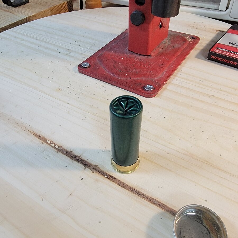

Dapper Dave Posted June 14, 2025 Posted June 14, 2025 Due to some small issues Kid Rich was able to solve, I now have a new MEC 600jr, and tonight I loaded my first ever smokeless load. The load, per the recipe I found from Hodgdon, is 1 ox shot, a #30 bushing which dropped 19.5 grains of WST, (double checked with scale), a STS hull and a WAA12 wad. I also loaded the same into some Gun Club hulls. Can't get out to the range right now, but next weekend I will see how these pattern out of my Stoeger Coach Gun. I did have some odd-looking crimps with the used hulls, and the ones that were JUST wide enough to let shot out, I put a tiny dollop of hot glue over the hole, as I found described online at a different source. Needless to say, I am VERY stoked, moved into an aspect of reloading I never ever thought I would be doing, and this looks like plain fun! To those of you I was donating my hulls to at the matches, sorry, I'm keeping them now! I only have maybe 100 hulls left, but I have factory ammo on the way to make more empties!
Sedalia Dave Posted June 14, 2025 Posted June 14, 2025 Down load the manual and read up on how to adjust the crimp. Be aware that the settings for STS and Gun Club hulls will be slightly different than the settings for AA hulls. This is because AA hulls are shorter in length than STS hulls. The quality control of SG hulls is not very good these days. So don’t expect every hull to have a perfect crimp. Strive to get crimps that don’t allow any shot leakage.
Sheriff Dill Posted June 14, 2025 Author Posted June 14, 2025 7 hours ago, Dapper Dave said: Due to some small issues Kid Rich was able to solve, I now have a new MEC 600jr, and tonight I loaded my first ever smokeless load. The load, per the recipe I found from Hodgdon, is 1 ox shot, a #30 bushing which dropped 19.5 grains of WST, (double checked with scale), a STS hull and a WAA12 wad. I also loaded the same into some Gun Club hulls. Can't get out to the range right now, but next weekend I will see how these pattern out of my Stoeger Coach Gun. I did have some odd-looking crimps with the used hulls, and the ones that were JUST wide enough to let shot out, I put a tiny dollop of hot glue over the hole, as I found described online at a different source. Needless to say, I am VERY stoked, moved into an aspect of reloading I never ever thought I would be doing, and this looks like plain fun! To those of you I was donating my hulls to at the matches, sorry, I'm keeping them now! I only have maybe 100 hulls left, but I have factory ammo on the way to make more empties! You can also make homemade shot cards out of thin boxes like cereal of beer boxes. Use a large punch or a paper cutter and make them. I made some and started putting one in each shell.
Edward R S Canby, SASS#59971 Posted June 14, 2025 Posted June 14, 2025 37 minutes ago, Sheriff Dill said: You can also make homemade shot cards out of thin boxes like cereal of beer boxes. Use a large punch or a paper cutter and make them. I made some and started putting one in each shell. I make mine 1/2-inch square. They prevent shot from dribbling out of reloads in Gun Club hulls that don't always crimp perfectly. STS and Nitro hulls really don't need these as they crimp more reliably.
Edward R S Canby, SASS#59971 Posted June 14, 2025 Posted June 14, 2025 7 hours ago, Dapper Dave said: Due to some small issues Kid Rich was able to solve, I now have a new MEC 600jr, and tonight I loaded my first ever smokeless load. The load, per the recipe I found from Hodgdon, is 1 ox shot, a #30 bushing which dropped 19.5 grains of WST, (double checked with scale), a STS hull and a WAA12 wad. I also loaded the same into some Gun Club hulls. Can't get out to the range right now, but next weekend I will see how these pattern out of my Stoeger Coach Gun. I did have some odd-looking crimps with the used hulls, and the ones that were JUST wide enough to let shot out, I put a tiny dollop of hot glue over the hole, as I found described online at a different source. Needless to say, I am VERY stoked, moved into an aspect of reloading I never ever thought I would be doing, and this looks like plain fun! To those of you I was donating my hulls to at the matches, sorry, I'm keeping them now! I only have maybe 100 hulls left, but I have factory ammo on the way to make more empties! You can use a wad designed for 7/8 oz or 3/4 of shot oz and get a load that is cheaper and more comfortable to shoot. I load with CB 0178-12 grey wads. Regarding hulls, Remington has a current rebate for STS shells. It's a good way to get a supply of quality hulls. You can pick up free once-fired Gun Club hulls at clays ranges. They reload pretty good too. BTW, you can load black powder shotgun shells on your Mec Jr too.

Sheriff Dill Posted June 14, 2025 Author Posted June 14, 2025 10 hours ago, Dapper Dave said: Due to some small issues Kid Rich was able to solve, I now have a new MEC 600jr, and tonight I loaded my first ever smokeless load. The load, per the recipe I found from Hodgdon, is 1 ox shot, a #30 bushing which dropped 19.5 grains of WST, (double checked with scale), a STS hull and a WAA12 wad. I also loaded the same into some Gun Club hulls. Can't get out to the range right now, but next weekend I will see how these pattern out of my Stoeger Coach Gun. I did have some odd-looking crimps with the used hulls, and the ones that were JUST wide enough to let shot out, I put a tiny dollop of hot glue over the hole, as I found described online at a different source. Needless to say, I am VERY stoked, moved into an aspect of reloading I never ever thought I would be doing, and this looks like plain fun! To those of you I was donating my hulls to at the matches, sorry, I'm keeping them now! I only have maybe 100 hulls left, but I have factory ammo on the way to make more empties! I bought a bunch of nice fired hulls from @Wild Hair Larry very happy with purchase and quality of hulls.

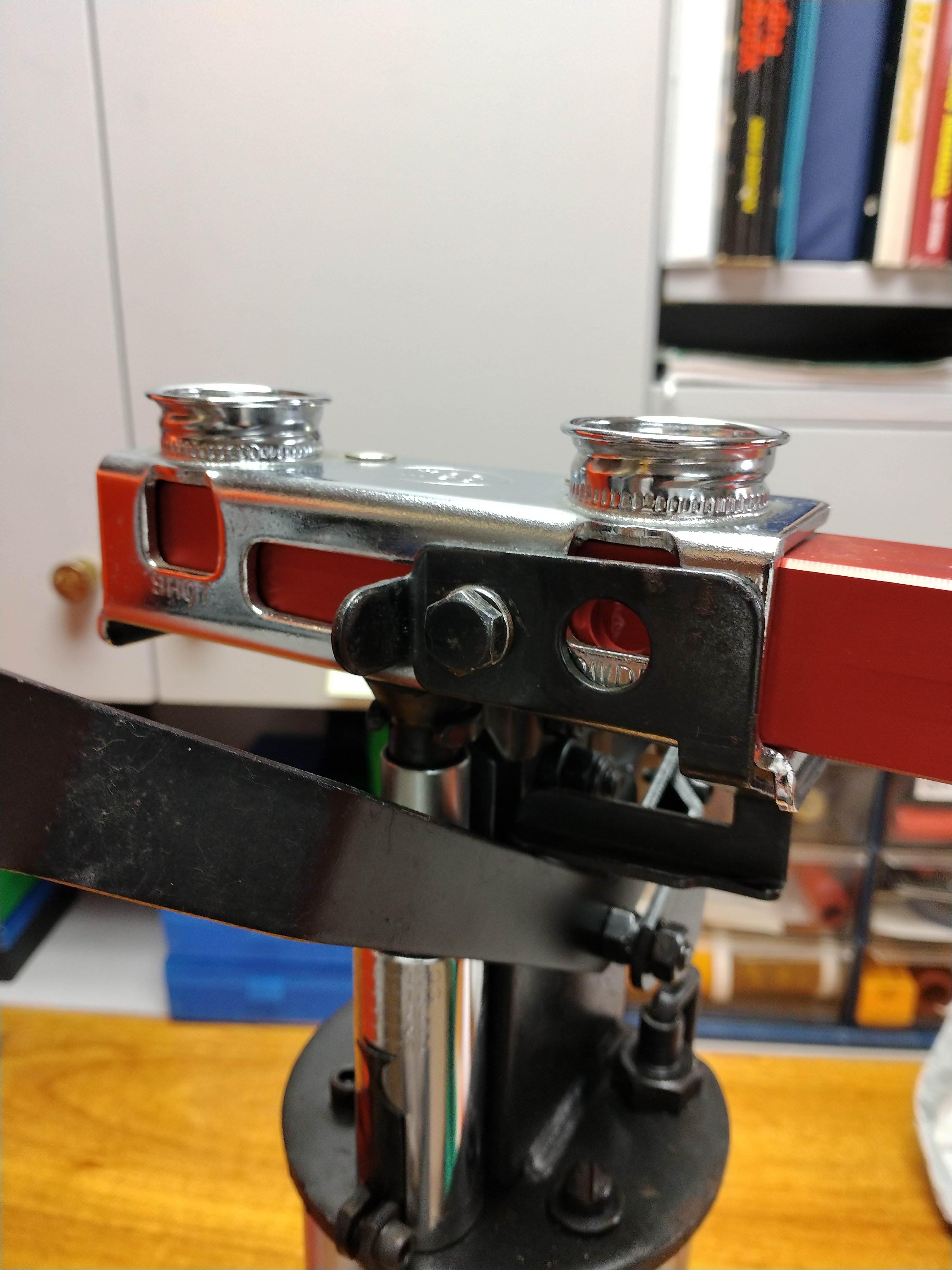

Blackwater 53393 Posted June 16, 2025 Posted June 16, 2025 I got the eight fold crimp starter installed and rough adjusted this morning. I want to try out my new 10ga smokeless load before I build up any more new shells, so fine adjustments and photos will follow once I fire off the half dozen I’d already assembled. BUT!! I discovered a minor issue, or rather exacerbated an issue that I’d noticed, when I installed the new die. Have any of you, dealing with the MEC 600s encountered a misalignment in the base? It’s not very much, but the drop/wad station, and the pre crimp and crimp stations were out of plumb slightly to the operator’s right when looking at the press. The stamped steel plate on my machine has the shell misaligned just enough that I would occasionally have to slightly lean the shell to my left for it to feed into the pre-crimp and crimp dies. It isn’t enough to cause a problem with the factory pre-crimp die because that unit is mounted on a ball and can swivel a bit. But the new die is more solidly mounted and I would have to concentrate on making sure that I tilted every shell just right for it to make a good crimp start. I fiddled around and removed the plate and examined it closely, reassembled it two or three times, and figured out that the plate needed to be moved slightly to the left. I carefully bent the tab that fits inside the main spring slightly. Better, but still not good enough! So I took it out again and bent the tab a little more and also bent the portion of the plate where it hooks unde the platform. Now it is almost perfect! As soon as I can get out or get one of my young’uns to shoot the sample load, I’ll put it to work and do some fine adjustments.
Eyesa Horg Posted June 16, 2025 Posted June 16, 2025 I don't use my 600 jr. much anymore, but can't say I ever noticed an alignment issue. Is it possible somebody before you dropped it?
Blackwater 53393 Posted June 16, 2025 Posted June 16, 2025 4 minutes ago, Eyesa Horg said: I don't use my 600 jr. much anymore, but can't say I ever noticed an alignment issue. Is it possible somebody before you dropped it? Doubtful! Possibly a mis-stamped shell plate. The press is practically new and there’s no chips, scratches, or dents on it anywhere. It doesn’t even have the usual dust and dirt in those places where nobody thinks to clean! I was considering giving MEC a call and talking to their technical support staff. Like I said, I gently tweaked a couple of places on the stamped steel part and it’s working great now. What it amounted to was a tiny shift in alignment to the left.
Eyesa Horg Posted June 16, 2025 Posted June 16, 2025 Sounds like you did a slight technical adjustment. Fine job!
Blackwater 53393 Posted June 16, 2025 Posted June 16, 2025 9 minutes ago, Eyesa Horg said: Sounds like you did a slight technical adjustment. Fine job! It always pays to check a little deeper! I went ahead and called MEC and got a technical advisor! He explained that I could adjust the base plate of the press slightly. Where the mast bolts to the platform, there’s a bolt that goes through the platform and the hole for it is slotted. I can handle that! Just another “fine adjustment”!! 😎
