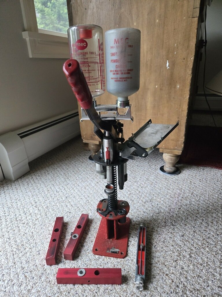

Sam Sackett Posted June 7 Posted June 7 On 6/6/2025 at 9:56 AM, Sheriff Dill said: I watched several videos on them yesterday they seem like really nice presses that are easy to use once you know how they work and adjust them. $50 is the asking price. Not sure what’s the going price range for one with everything included all ready to reload. Here’s a photo of what is included. The unit shown is a very early model 600 or VersaMEC. It is not quite the same as the current 600 jr. the wad guide shown is the original model and is no longer made. This can be upgraded to the new style. Also, the crimp started is the original that takes an insert. The insert needs to be changed out for 6 point or 8 point crimps. This is another easy upgrade. I have a VersaMEC from way back. I made the mentioned upgrades and it is a great machine. If you can get that unit for $50, grab it! You’ll have another $50 or so in the upgrades, but that package is worth the bucks. The adjustable charge bar alone will be worth your cost. Sam Sackett 1 4 Quote
Blackwater 53393 Posted June 7 Posted June 7 (edited) That auto-primer feed is $75.00 new too! For the price of a ten buck lid for it, you’ll be another $65.00 ahead of the game!! If I didn’t have one already, I’d be glad to have your press just for that adjustable charge bar and the primer feed!! Edited June 7 by Blackwater 53393 3 Quote

Dapper Dave Posted June 8 Posted June 8 So, to jump in here, another newbie shotgun reloader with MEC jr questions. First, this happened today. Thank you, Kid Rich! I am going to find a nice thick board to mount it on, but I have never used a MEC or reloaded shotgun other than tool-less black powder shell loading. I was kinda apprehensive until I saw the video above - this thing looks really easy to use! 3 Quote

Edward R S Canby, SASS#59971 Posted June 8 Posted June 8 DD, you can download manuals from MEC's website. These show how to make adjustments if needed. There are metal and rubber washers between the bottles and the sliding charge bar. These are often missing on used presses. Without them the charge bar will leak powder. I've worn out some and bought replacements online. They are inexpensive and readily available. Glad you found the video useful. 2 Quote
