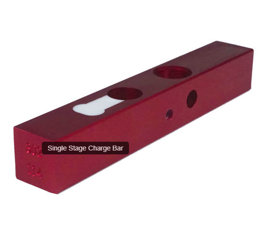

Sedalia Dave Posted June 9 Posted June 9 40 minutes ago, Dapper Dave said: Thank you. The bar it came with looks like it might be a steel shot charge bar - will that work for lead shot, and if so, what might I want to look out for to make it work right? There is a selection of bushings that Kid Rich very thoughtfully provided, MUCH appreciated! I watched a few videos on using the MEC 600jr, and once it's properly setup it looks really easy, much faster than my metallic cartridge reloading on my single stage RCBS RS! Of course, I'm not going to be loading 500 hulls in a sitting since the only thing I shoot shotgun for right now is SASS...but bunny busting is always at the back of the mind. Would I need to get another powder bottle to use with black/APP and the original strictly for smokeless? Sorry, I am full of questions, thank you all for all the great help. You can use the same bottles for smokeless or APP. The steel shot charge bar will work with lead shot. You just can't use steel shot with a lead only charge bar. So you know the difference, charge bars suitable for use with Steel shot will have an insert next to the cavity for the lead. See the below pic. Personally for the single stage MECs, I love my adjustable charge bar. It allows me to fine tune the shot charge for the perfect crimp. 3 Quote

Scarlett Posted June 9 Posted June 9 22 minutes ago, Sedalia Dave said: I love my adjustable charge bar. It allows me to fine tune the shot charge for the perfect crimp. This!! It’s much easier for ME than dealing with bushings. I have one of the steel shot bars - didn’t know why it was red until now! 🥰 Thanks! 8 minutes ago, Edward R S Canby, SASS#59971 said: BTW, it is possible to spill shot or powder while loading on a MEC Jr. THIS IS VERY TRUE! Steal a cookie sheet with a RIM from the kitchen or buy one. Install your MEC JR over it. You WILL drop shot without a shell… IYKYK, right! You will thank me later! 1 2 Quote
Sedalia Dave Posted June 9 Posted June 9 (edited) On 6/9/2025 at 8:24 AM, Scarlett said: This!! It’s much easier for ME than dealing with bushings. I have one of the steel shot bars - didn’t know why it was red until now! 🥰 Thanks! All MEC charge bars are red. What denotes a steel shot charge bar is that little off-white insert. I was wrong. New MEC charge bars are red for use with Lead shot and Black for Steel. Some of the Multi-Scale adjustable charge bars also had this insert so they could be used with steel shot. Edited June 10 by Sedalia Dave 1 Quote

Dapper Dave Posted June 10 Author Posted June 10 13 hours ago, Sedalia Dave said: All MEC charge bars are red. What denotes a steel shot charge bar is that little off-white insert. Some of the Multi-Scale adjustable charge bars also had this insert so they could be used with steel shot. I was looking at MidwayUSA and they had red lead shot bars and black steel shot bars for sale, that's what I was basing it from, sorry. https://www.midwayusa.com/product/1833751329?pid=755467 1 Quote
Sedalia Dave Posted June 10 Posted June 10 14 hours ago, Dapper Dave said: I was looking at MidwayUSA and they had red lead shot bars and black steel shot bars for sale, that's what I was basing it from, sorry. https://www.midwayusa.com/product/1833751329?pid=755467 I stand corrected. I have never seen a Black MEC Charge bar. Thanks for the education 1 Quote
