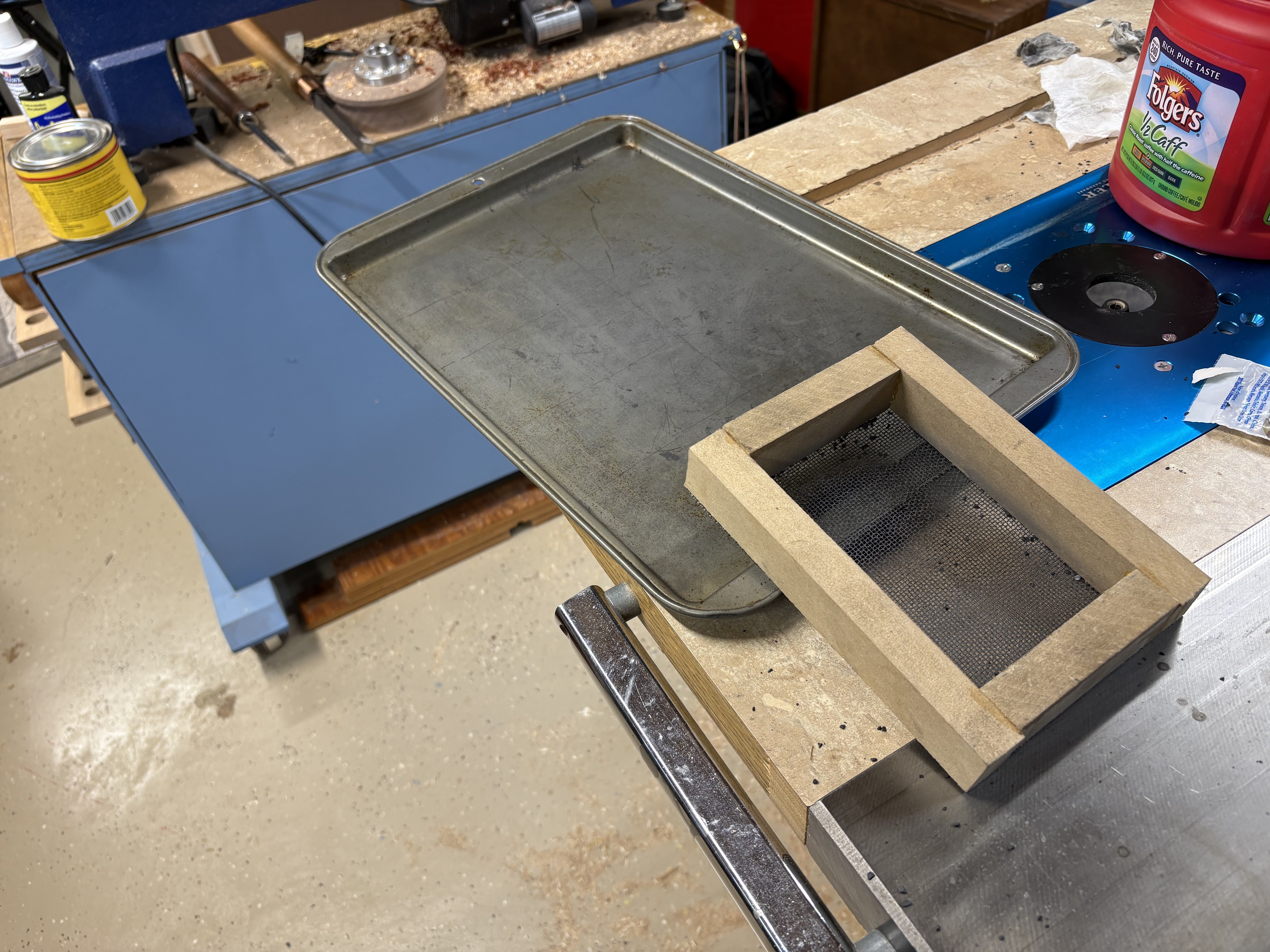

Chancy Shot, SASS #67163 Posted June 1, 2025 Author Posted June 1, 2025 3 hours ago, Shooting Bull said: You used your wife’s cooking tool in the gun room?!?!? I think you’ve got bigger problems to worry about!!! 😳 I received permission first. I am a little slow, but not stupid. Thank you for all the advice. Here is how I proceeded. I went to Menards and bought a window screen repair kit. I built a small frame and stapled the screen to it. I put a cookie sheet (mine, not my wife's) to catch what fell through. I have been using Wano Renactor BP for my shot shells, so a lot of the powder fell thru, but not all. I ran everything over the screen twice and called it good enough. I now have a cup of finer Renactor that I will use in my pistols and four pounds of mostly shot. I am wondering if the little bit of powder remaining in the shot will be ignited when the shell is used. Perhaps I will save them for a night shoot. Chancy
