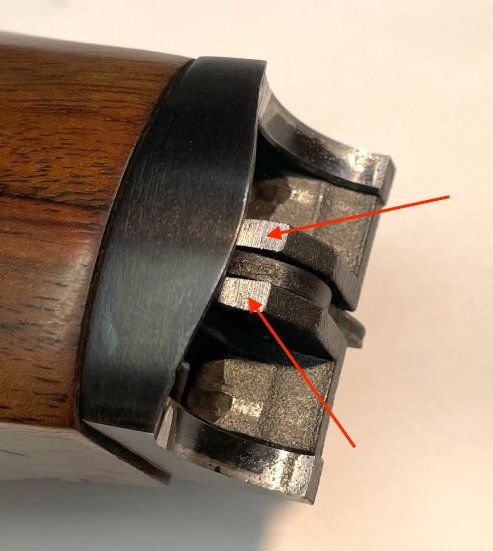

Randy Saint Eagle, SASS # 64903 Posted May 23 Posted May 23 16 minutes ago, Roger Rapid said: One more thing... regarding the "some work done to it" ... Some folks will alter the cocking levers by removing material from the top of the levers with the goal of having the action open wider. This is the wrong way to accomplish that on a Stoeger. Removing material from the top of the cocking levers causes the levers to delay whem the hammers are pushed back, which means that the firing pins are still protruding into the fired primers are you try to open the action, and that makes it much harder to open the barrels. RR This may not be a simple answer but I’ll ask anyway. I bought one of the Black Friday synthetic stock Stoeger’s and I would like to get it to open a little wider but not sure what to do? Thanks Randy
Roger Rapid Posted May 23 Posted May 23 RSE... To get the action to open wider on a Stoeger s/s single- or double-trigger shotgun file down the two bosses that are on either side of the extractor lever. (See file marks in pix below). File down until the file begins to touch the extractor lever - no further. RR
El Sobrante Kid Posted May 23 Posted May 23 Hi Roger Rapid, Thank you for your descriptions, and the pic. I think you are talking about the two surfaces with the arrows. Do you keep the factory angle (which I assume is parallel to the water table), or do you modify that angle when filing? Thx!
Roger Rapid Posted May 23 Posted May 23 El Sobrante Kid... Since the barrels are swinging open in an arc I do try to modify the angle slightly by taking more off the left of the bosses - as you view them in this photo. Very little needs to be removed since it doesn't take much to alter the opening angle of the barrels. Again, just go to where you begin to file on the ejector's opening lever. This adjustment should open the action about 4°-5° further. RR
Randy Saint Eagle, SASS # 64903 Posted May 23 Posted May 23 38 minutes ago, Roger Rapid said: El Sobrante Kid... Since the barrels are swinging open in an arc I do try to modify the angle slightly by taking more off the left of the bosses - as you view them in this photo. Very little needs to be removed since it doesn't take much to alter the opening angle of the barrels. Again, just go to where you begin to file on the ejector's opening lever. This adjustment should open the action about 4°-5° further. RR Thanks for the information 🤠 Randy
