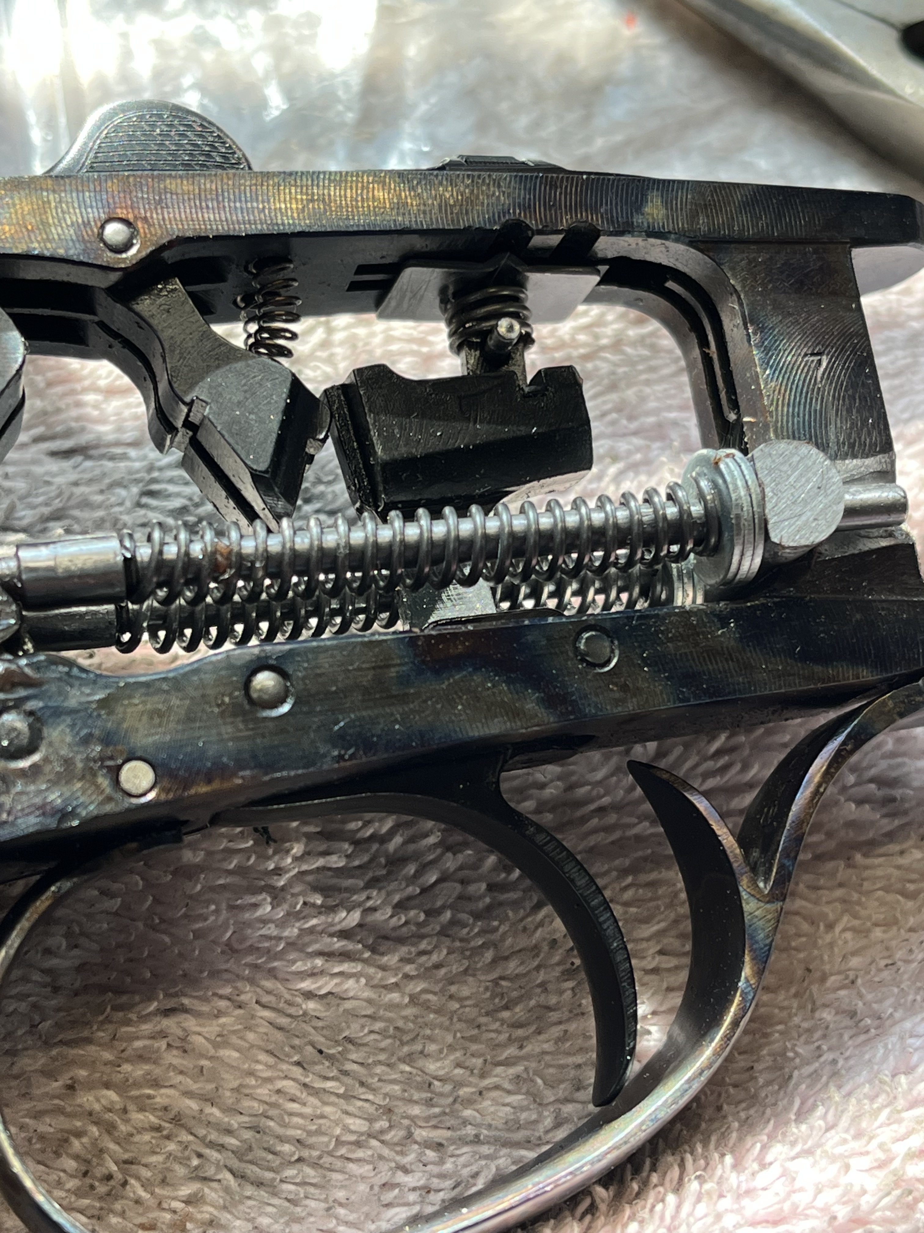

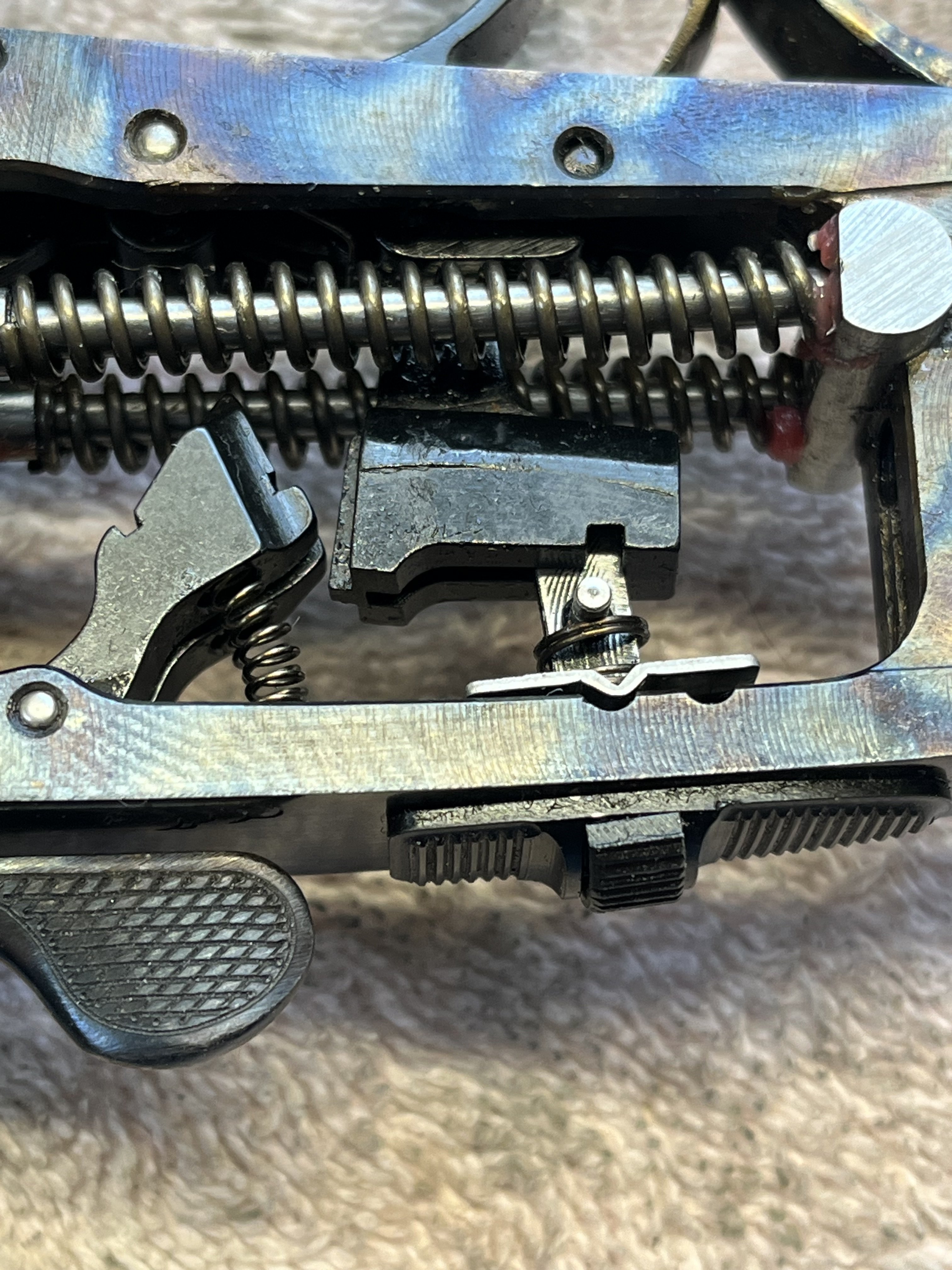

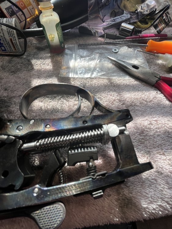

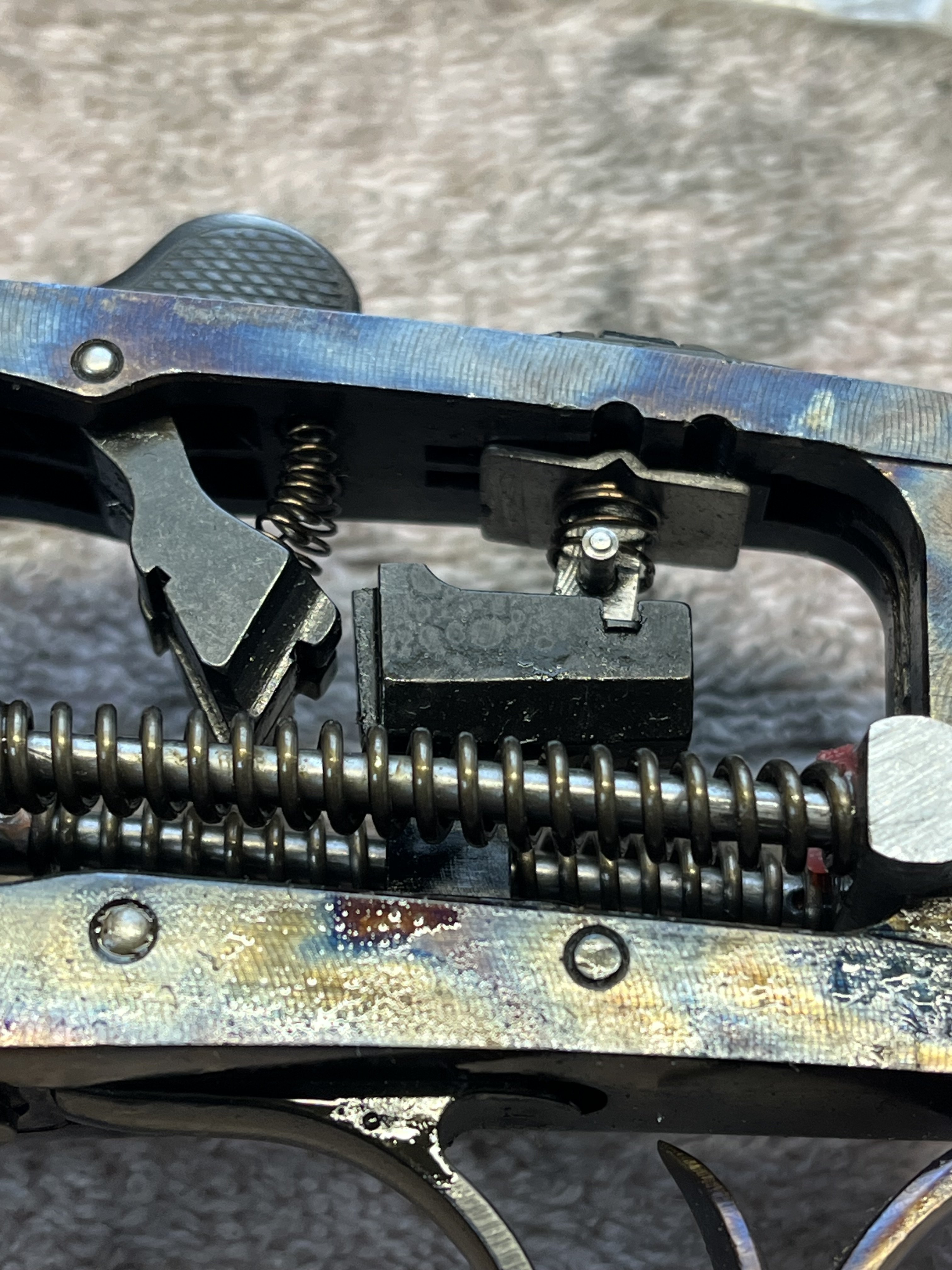

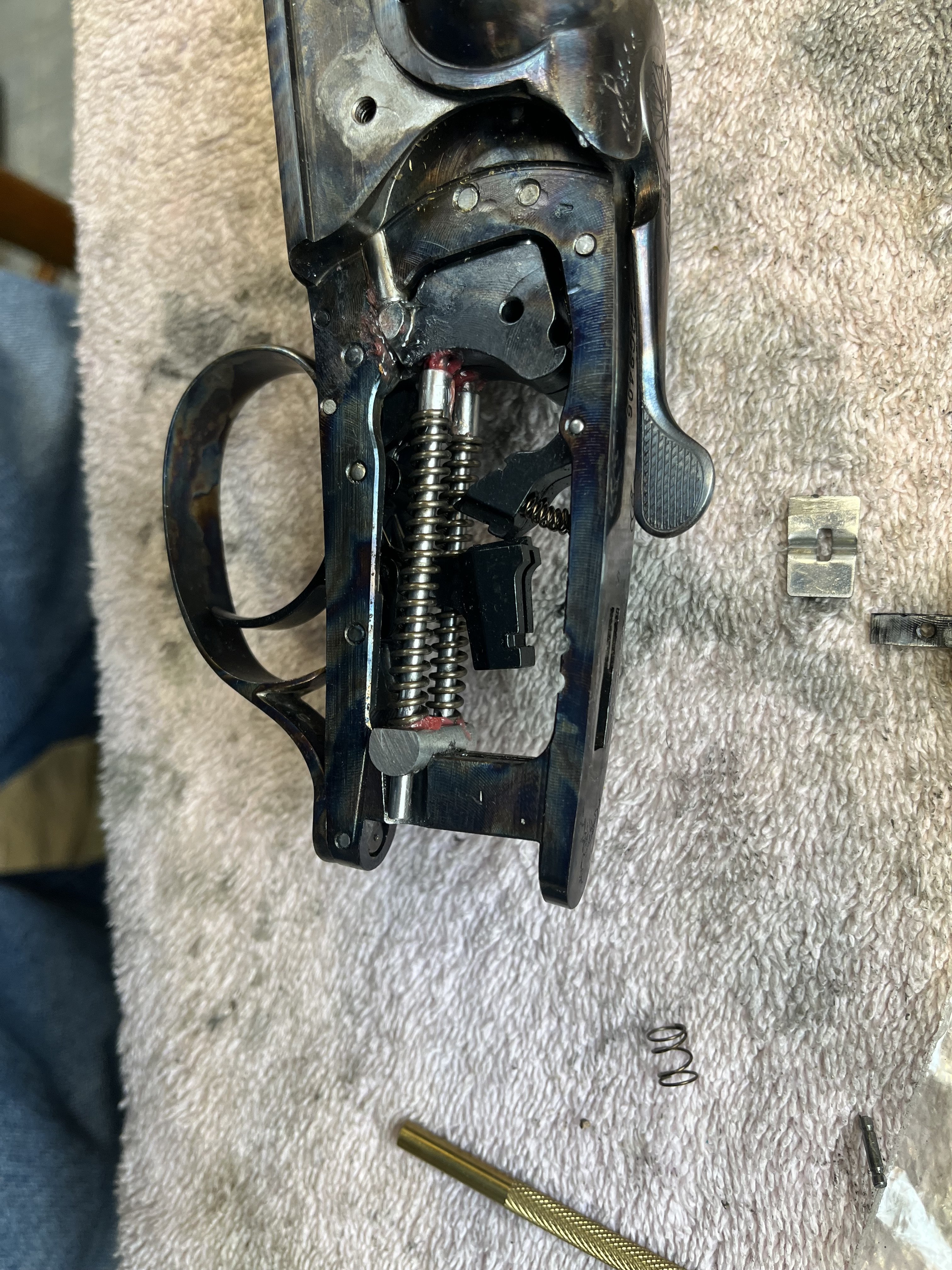

Randy Saint Eagle, SASS # 64903 Posted May 22, 2025 Posted May 22, 2025 10 hours ago, Windy City Kid said: Was it an easy mod? (easy for a dummy like me lol) does Ken have the springs? According to Idaho Gunslinger Ken does have stiffer springs. I just used some assorted spring stock from Brownell’s. Here are a few pictures that might help you decide if you can do it? Sorry they aren’t very good and some are upside down. Randy 1 1 Quote
Randy Saint Eagle, SASS # 64903 Posted May 22, 2025 Posted May 22, 2025 I need to clarify, I said mine was originally done by Ken but I don’t know that for sure I bought it used and that’s just what I was told. Also the hammer springs are not what was in it when I got it. I have been playing around with springs and that’s what was in it in January when I took those pictures. Sorry if there was any confusion. Randy 1 Quote
