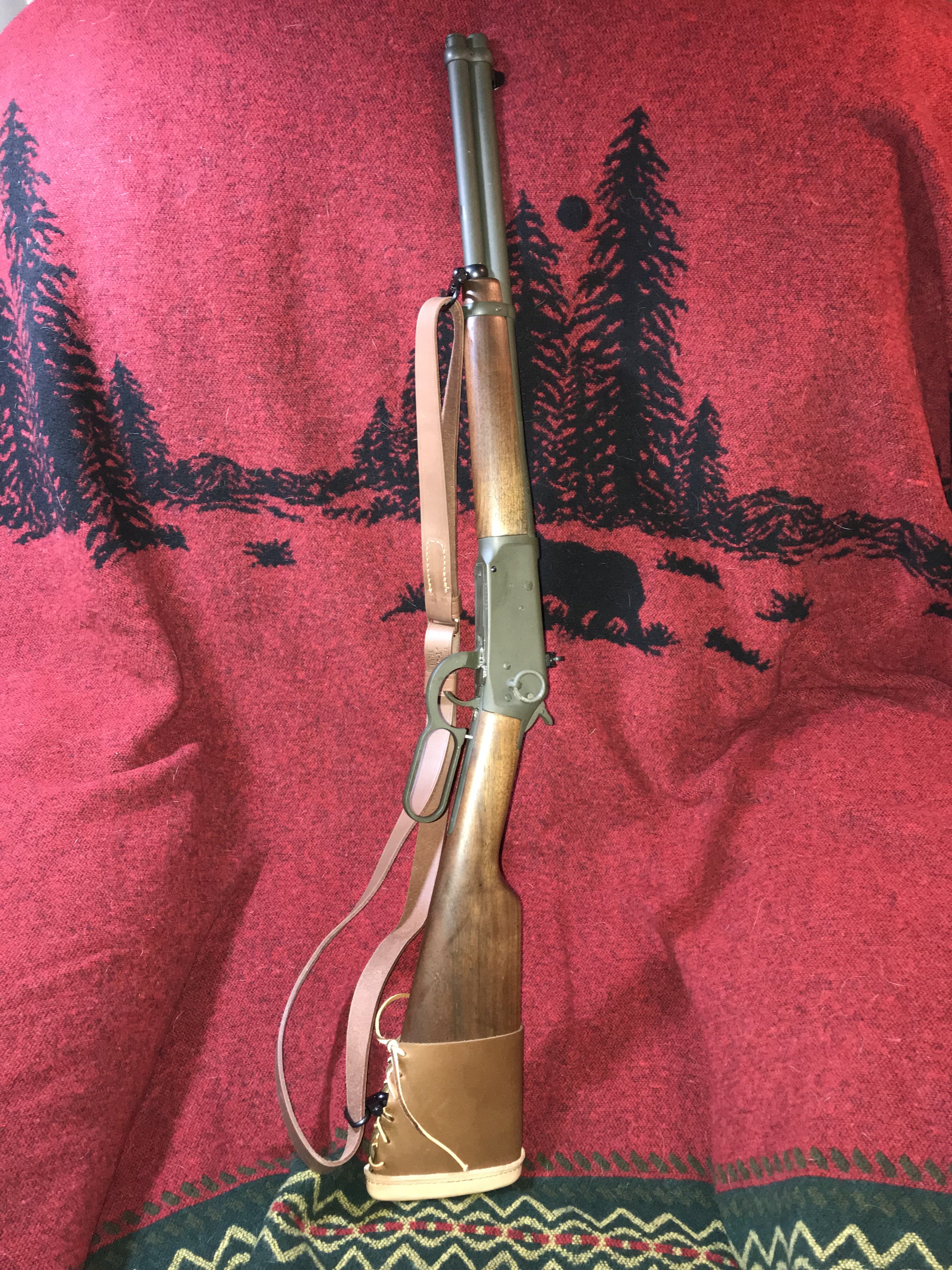

Pat Riot Posted May 16, 2025 Posted May 16, 2025 38 minutes ago, Nickle said: I was watching utube videos last night. Sagebrush longshots have a bunch of video's of shooting 30wcf from 300 to 1000yards. In one video I thought he said he was using 10 grains of unique. His barrel looks custom and longer than 26"and he is using a quality Montana vintage arms vernier tank sight, He is always shooting when there is no wind. I'm thinking high velocities and accuracy with cast bullets just don't go together and suspect ones who claim it are just repeating what they have heard. I would like to get a vernier sight and just see what this gun could do. In my moly-coated lead bullet testing my test data is all gone or somewhere I haven’t looked yet. Having moved many times over the years I have lost a lot of information. Typically what I do is I un ladder tests on loads and create index cards for the most accurate of all my tests. Here are 2 load cards that I tested in my old Winchester 94 30-30 Carbine. I no longer own the gun, but I had a lot of fun with it. These loads were developed and tested for accuracy in the early 00’s. I did not chronograph them. Gratuitous photo of my old 94. Yes, the metal is green. I had it Cerakoted in 2012 after an idiot ex-friend’s “cooler that doesn’t leak” did leak in the back of my Suburban thus causing my 94’s gun case to become saturated. I figure it was like that for 7 days. My gun was covered in rust. I had it Cerakoted. EDIT: I forgot to add that I tested these loads at 125 yards. After paper testing of ladder loads I tested the “Whack of these loads on several 25# 4”x6”x12” solid steel blocks at 125 yards. The results were impressive in that the sound these bullets made on the steel and the movement of the blocks was quite gratifying.
Texas Joker Posted May 16, 2025 Posted May 16, 2025 Steel wool rust smooth and either oil it or boil it. One is browned one is blued
Pat Riot Posted May 16, 2025 Posted May 16, 2025 16 minutes ago, Texas Joker said: Steel wool rust smooth and either oil it or boil it. One is browned one is blued I was going to do that but wanted to try Cerakote. I liked it and wouldn’t hesitate to do it again.
