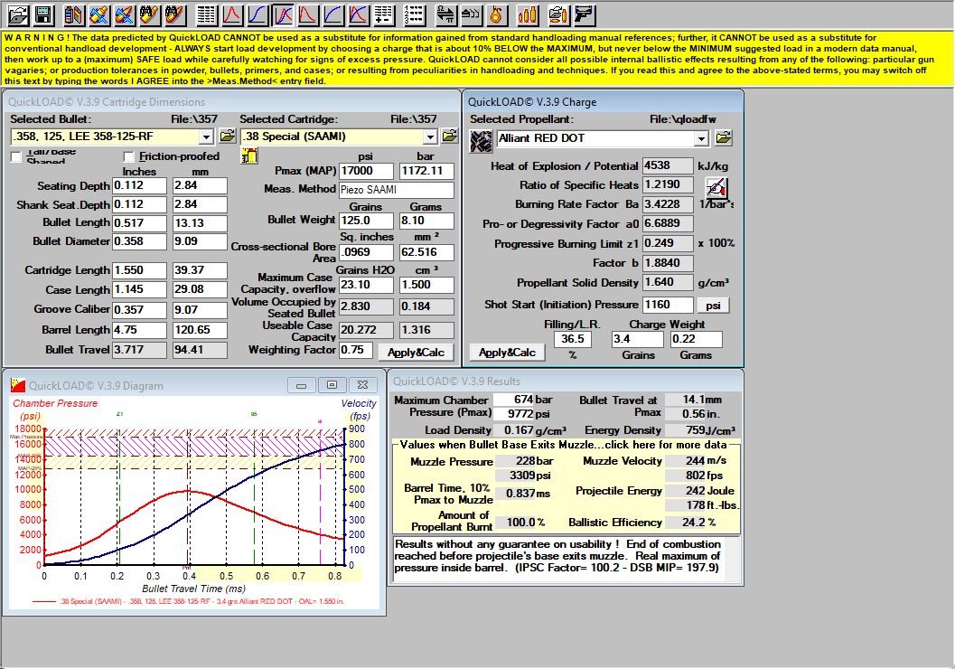

Buckshot Bear Posted May 13 Posted May 13 G'day pards, after some load advice. I've just about run out of my ADI AS30N/APS350 (Clays) which I have been loading my .38's for years now running 125gn projectiles, 3.6gn powder and approx 800 fps. I REALLY like this load and want to duplicate it as close as possible. I have lucked out and got many many years worth of freshly made and imported Red Dot. Anyone using Red Dot, shooting 125gn projectiles in .38 brass around 800fps? Its pretty close to Clays - Quote
Edward R S Canby, SASS#59971 Posted May 13 Posted May 13 My Laser-Craft Reloading Handbook states 3.4 grains of Red Dot gave 879 fps out of a 6-inch barrel revolver. This is the starting load. (I do not shoot Red Dot and personally have no ballistic data.) 1 Quote
Erasmus Posted May 13 Posted May 13 As a data point, 3.1 grains of Red Dot under a 125 RNFP gets me about 550 fps in a 5.5 inch barrel. 2 1 Quote

Wild Eagle Posted May 13 Posted May 13 I shot Red Dot for quite a while. When it got hard to find I saved it for my shotgun loads, now I'm almost out of it. You should get close to your 800fps using about 3.4 grains with a 125 grain bullet. I usually load 38 special to 1.500" COAL. If you load a little shorter, you should be right at 800fps. PS. Happy to hear that you guys are getting fresh supplies of Red Dot. Maybe we'll see some soon too. 1 1 Quote
Major E A Sterner #12916 Posted May 14 Posted May 14 I always used 3.5 (Three point five) grains of RedDot in my .38's with either a 105 or 125 grain bullet, I used a heavy crimp and had no problems. 2 1 Quote
El Chapo Posted May 14 Posted May 14 (edited) You guys definitely load hotter than me. My Clays load was 2.7. I'm using 2.8 of Ramshot Competition right now, all with a 125 Lee RF bullet. I never really thought these were gamer loads, just start loads out of the book. Edited May 14 by El Chapo 1 Quote
