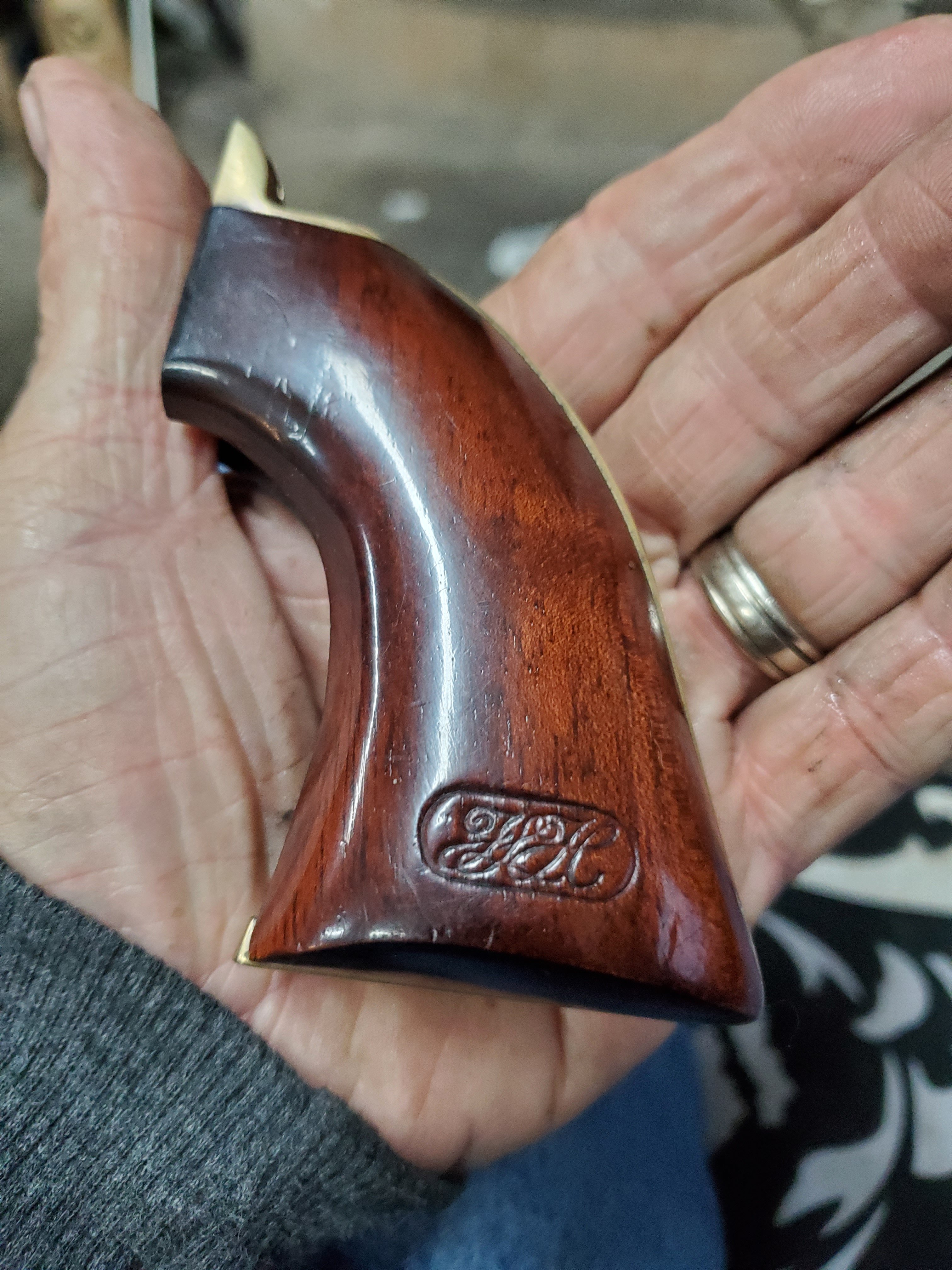

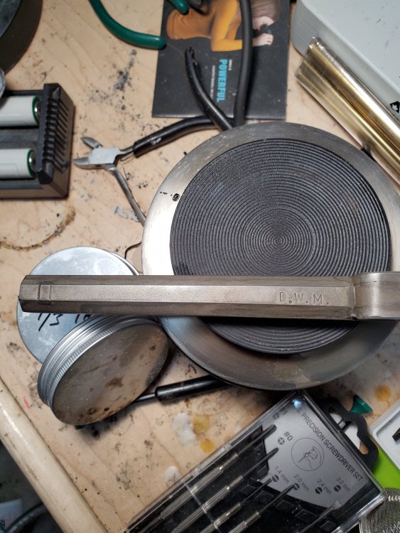

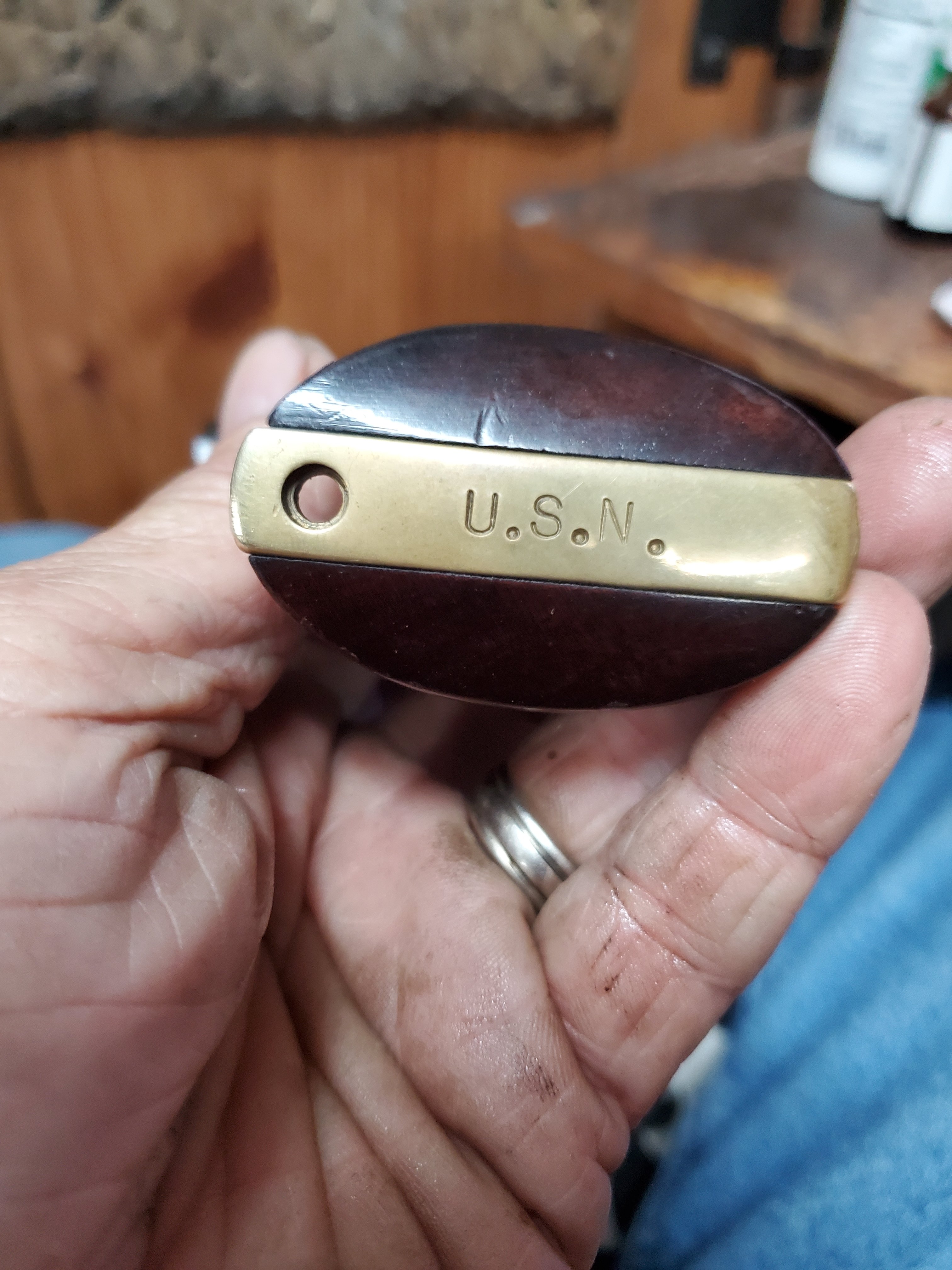

Frank Moon Posted April 15 Posted April 15 Can anyone identify who used these grips? They came off a 1851 Navy mason-richards conversion that shoots .38 LC. On the bottom of the grip is engraved USN and there are the initials D.W.M. engraved oh the bottom of the barrel. It's not a Colt as I've found Italian proof marks across the left side of the frame. I've had it completely apart unable to find a makers mark. I broke the ejector rod and can't find a replacement that fits. I hoped an uberti ejector assembly would fit, but no such luck; the lug that fits in the frame is way too small, nor will it align with the cylinder. I have little chance of replacing the ejector assembly without knowing the maker. Any help would be appreciated. Quote

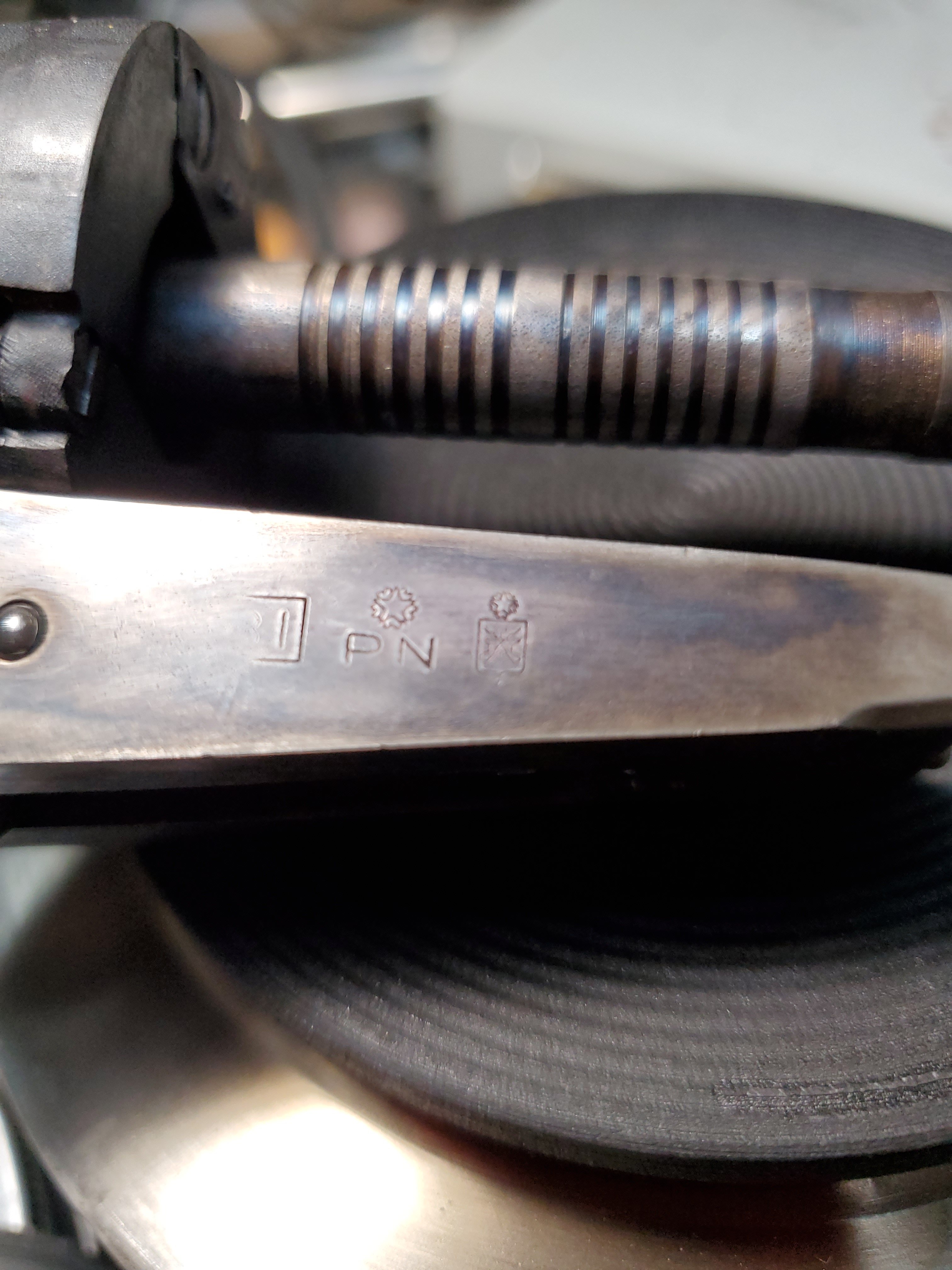

PaleWolf Brunelle, #2495L Posted April 15 Posted April 15 Can you post a photo of the proof marks? Quote

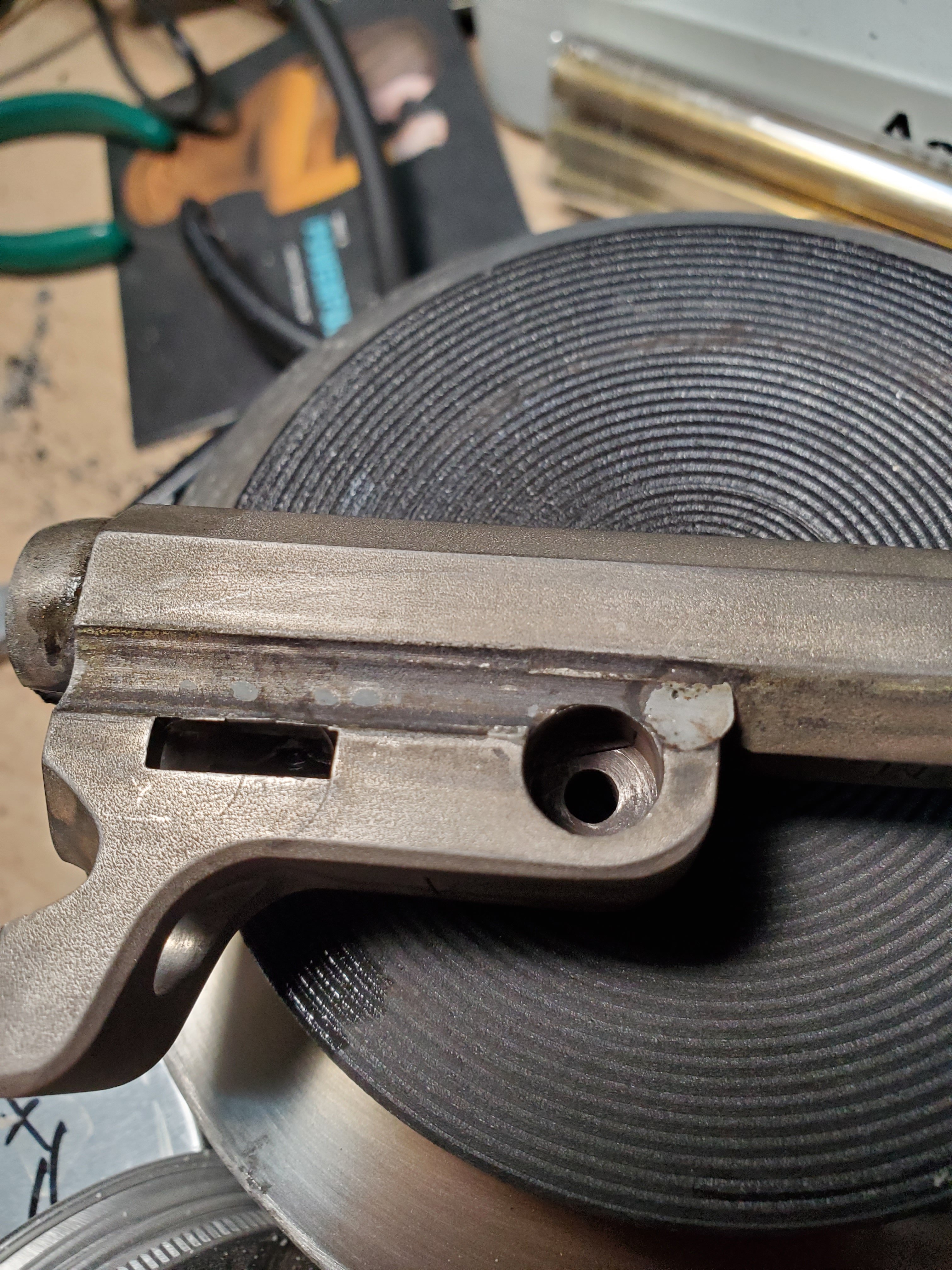

Frank Moon Posted April 15 Author Posted April 15 Sure can, I'm pretty sure they're Italian. The date marks (as seen) are fairly worn. I'm also including a picture of the barrel assembly. Notice the large lug opening. There are also two cut in the front of the barrel and the letters D.W M. towards the frame end. It's also noted that unlike the uberti ejectors, there is a retaining nut on the end of the ejector pin. Quote

Sedalia Dave Posted April 15 Posted April 15 2 hours ago, Frank Moon said: The above marks are from Left to right. Data Code ( Too faded to make out ) Black Powder Proof Gardone Proof House (Italian) Quote
Sedalia Dave Posted April 15 Posted April 15 (edited) D.W.M sounds German in origin. Given that you have a cartridge cylinder on a Black Powder frame and a barrel with no discernable proof marks, I suspect that you have a frankengun that has been cobbled together from at least 2 or possibly three different pistols. Edited April 15 by Sedalia Dave 1 Quote
Abilene, SASS # 27489 Posted April 15 Posted April 15 (edited) Some Armi San Marcos " '51 Richards conversions" (which yours is not) had the ejector housing break off from that tab fairly often. The fix was to try to solder it back on which didn't always work, or you might try J B Weld. Good luck. Edited April 15 by Abilene, SASS # 27489 1 Quote
Abilene Slim SASS 81783 Posted April 16 Posted April 16 It’s been a long since seeing one, but isn’t that EMFs cartouche on the grip? Could be a Pietta? Quote
Chickasaw Bill SASS #70001 Posted April 16 Posted April 16 given what I can see in the pics My thoughts is it is a "de-farbed" FRANKEN GUN de farb removal of Mfg markings , I have seen that done often with reenactors the grips appear to have been refitted to the frame I could be WRONG , but I can not come up with anything else Chickasaw Bill Quote
Abilene, SASS # 27489 Posted April 16 Posted April 16 Agreeing with gunsmith conversion, but somebody put some effort into it since they milled the right side of the barrel for the ejector. Quote
