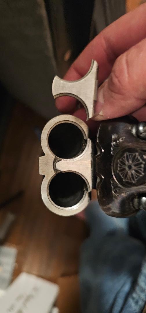

Dacotua Posted April 11 Posted April 11 I have a CZ Hammer Coach that I shoot in classic cowboy. When it was new, like everyone else has said, mine was stiff to open. I ended up open/close, repeat, watching TV - to loosen it up. I then went out to my hunting lease and shot a lot of buckshot and heavy bird shot (Blowing up cabbage, soda cans, etc...) That helped a ton. I also ordered a spare extractor for mine. I ended up shaving the top of the extractor so that only the bottom has a radius, while the top now does not. This stopped me from having the extractors spread my shells out while loading. (Hence why I said spare, I can return it back to original at any time) (See pic below) You'll see the extractor in the gun that I ground off the "ears" and you'll see the factory ejector next to it in my hand. (Yeah I didn't do a great job in grinding off the ears, but it works well for me.) - Like I said, I can always return it to stock since I have the original unmodified.
