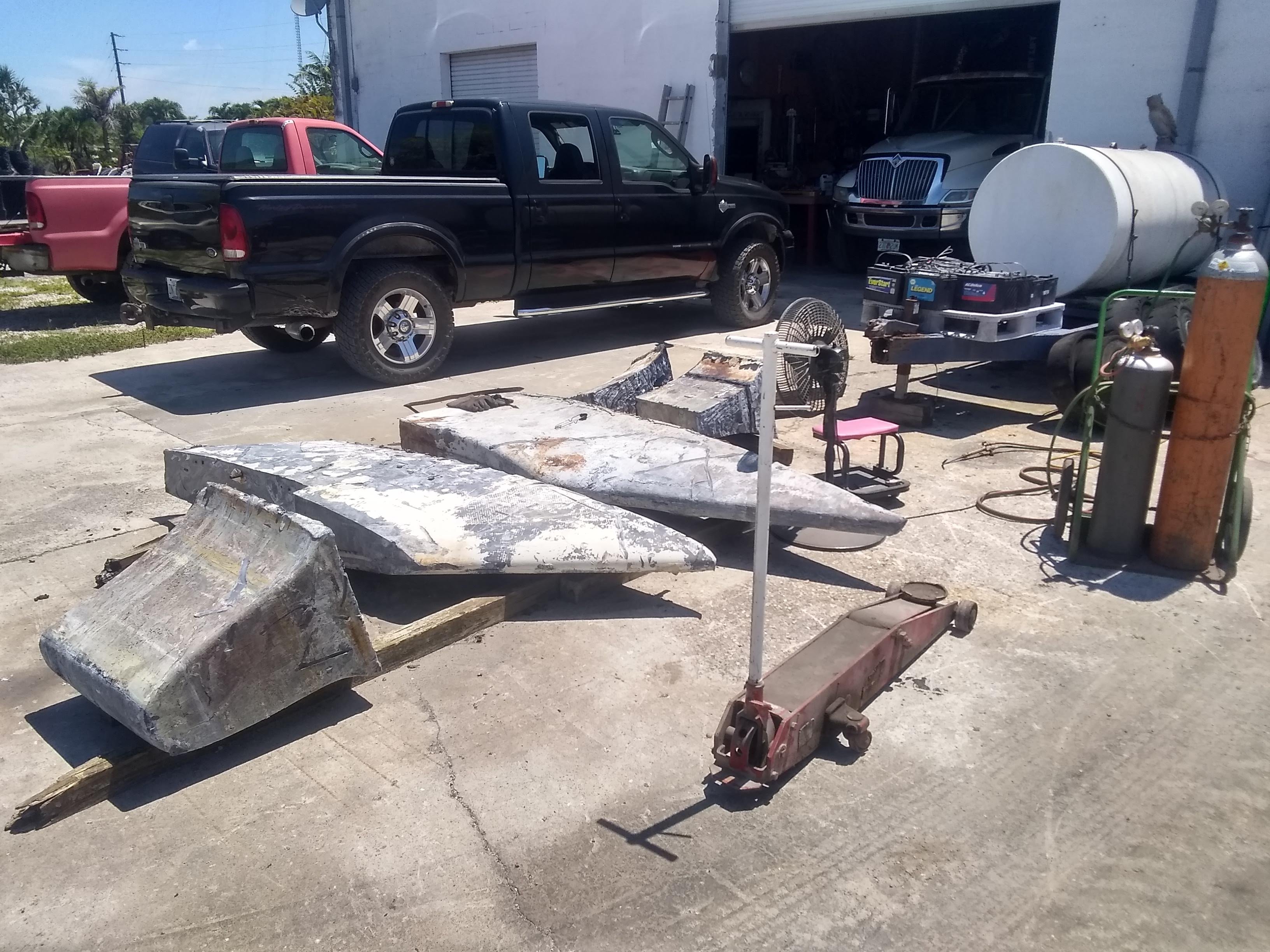

Waimea Posted April 3 Posted April 3 These are a few of the keels I used to use for bullets. These were small, around 3500 lbs. Last time I talked to my old landlord at the boatyard they had 250,000 lbs of keels. He said he missed me processing the keels. 4 1 Quote
