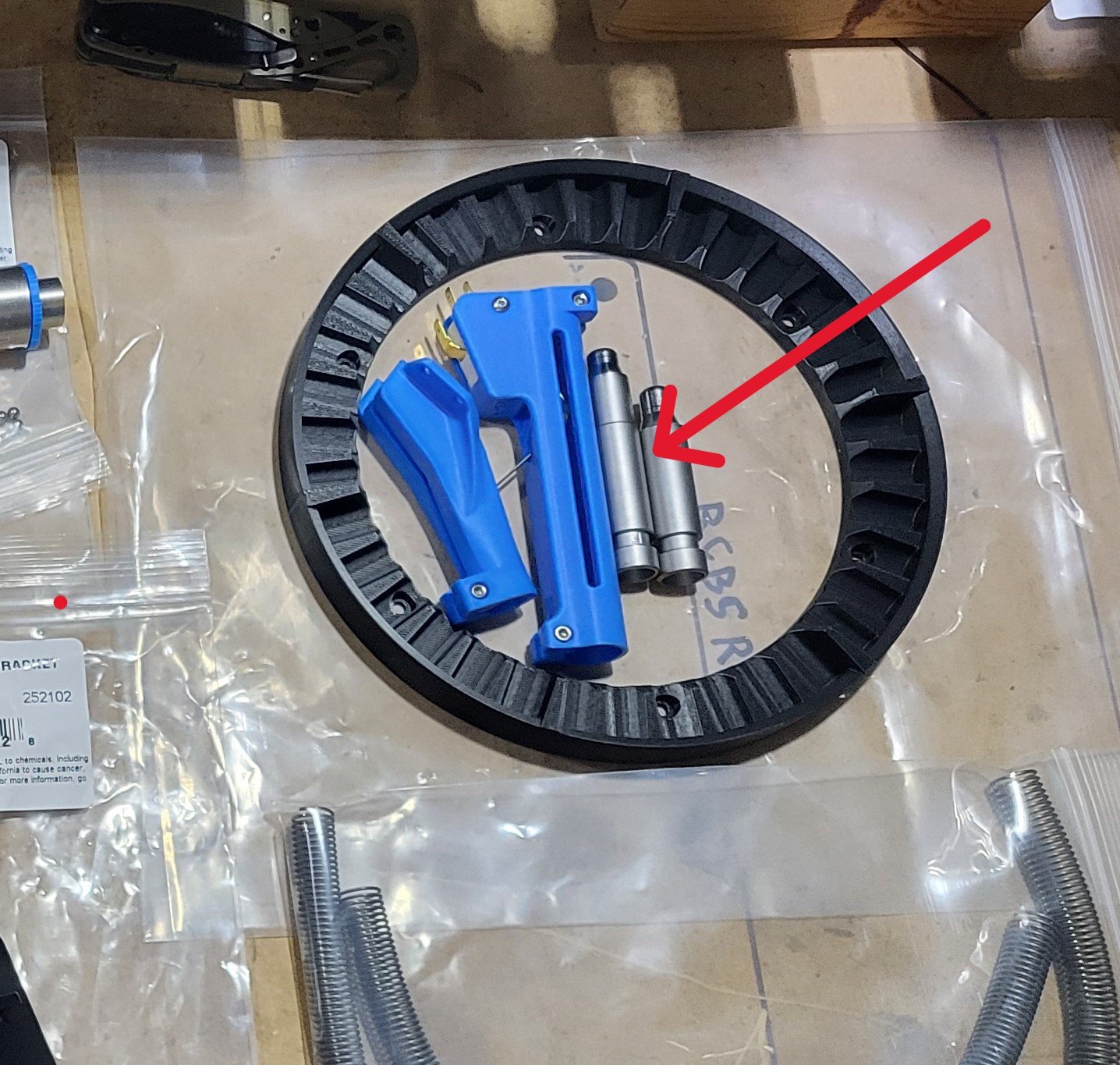

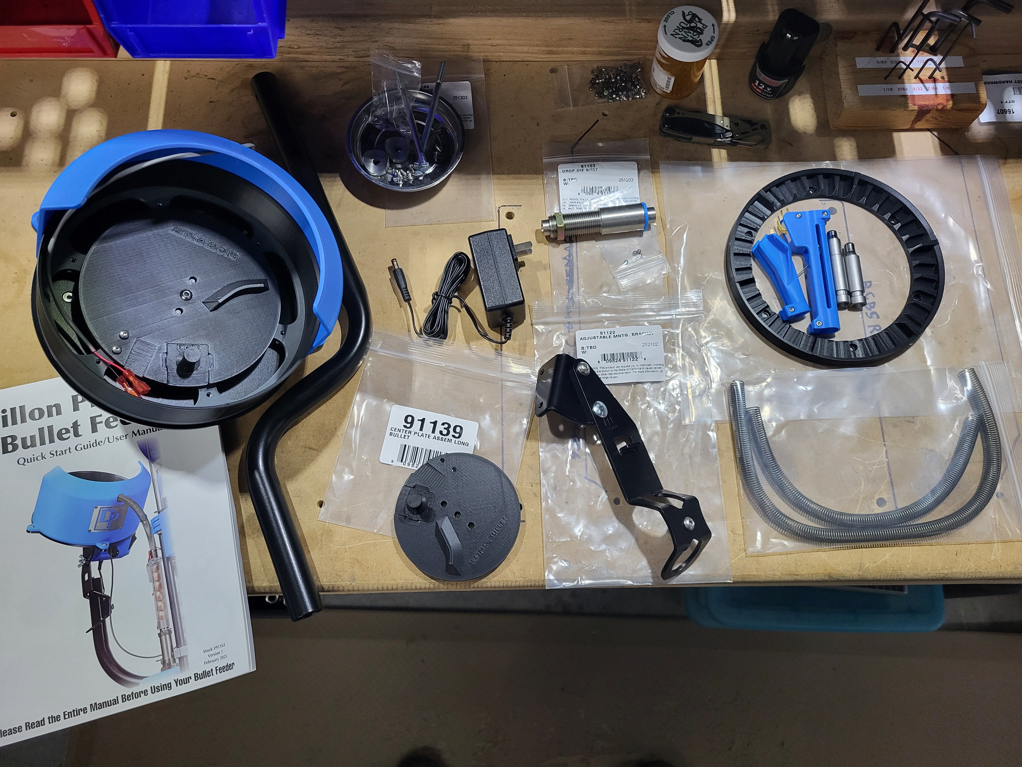

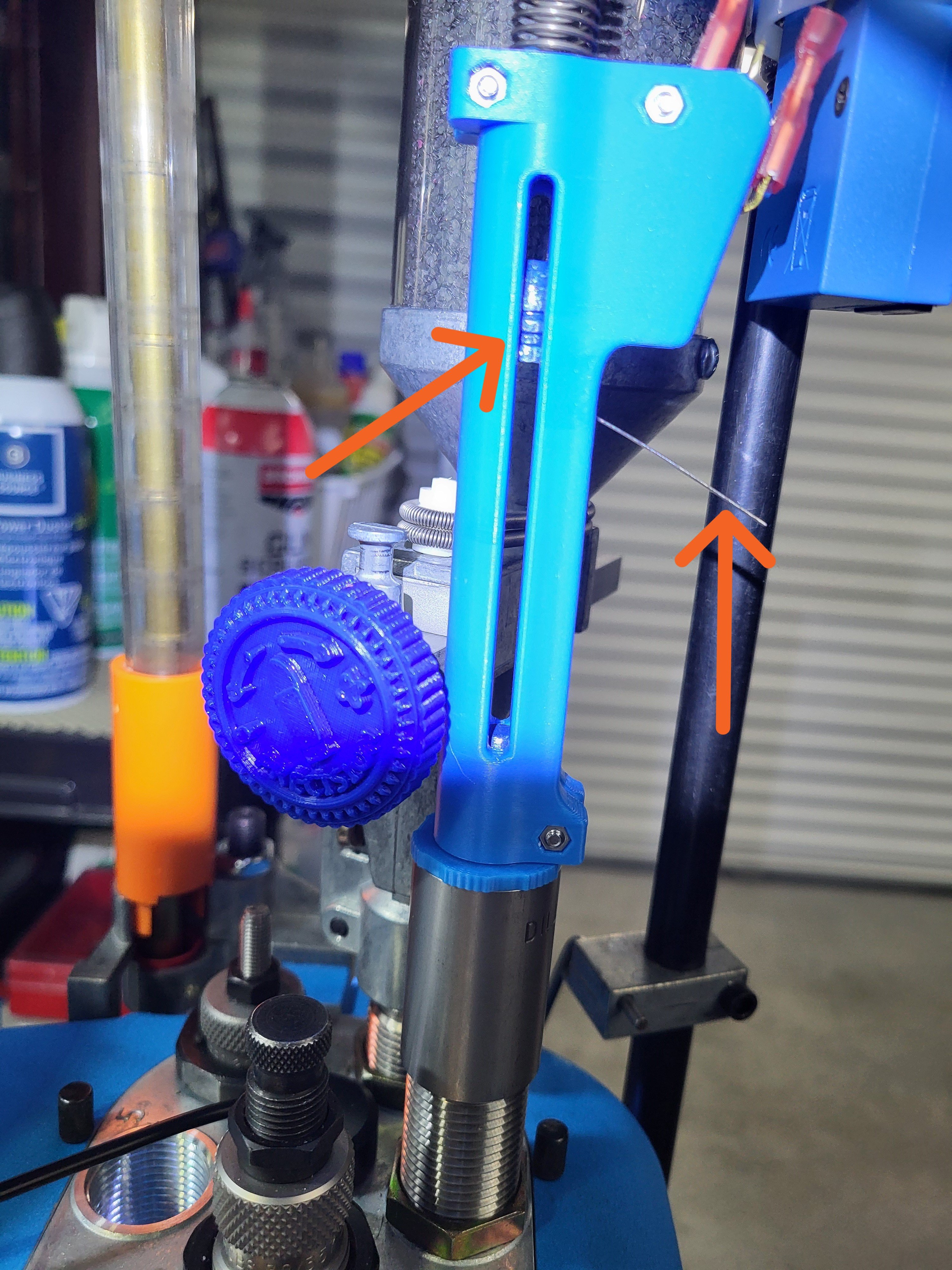

Nostrum Damus SASS #110702 Posted March 29, 2025 Author Posted March 29, 2025 Okay, it arrived today. I unboxed and proceeded to begin assembly of my new Bullet Feeder. But I did not finish. Here is my initial report, which mirrors the Support Ticket I opened with Dillon. There are two major issues that they do not mention anywhere, either or both of which might dissuade someone from buying a Dillon Bullet Feeder. First, you cannot attach the bullet feeder mounting tube to your 750 if the press is sitting on a Dillon Strong Mount and is equipped with a Dillon Bullet Tray. How they screwed that up is beyond me. A modified Bullet Tray mounting bracket is required. I asked them to design, fabricate, and send one to me. Second, they did NOT address the known interference of the bullet dropper die with the Dillon Powder Dropper's charge bar on the 750. As is the case with the Mr. Bullet Feeder as well, you cannot run a powder check die in between the powder die and bullet drop die because the bullet drop must be installed in Position 3 -- UNLESS you buy Double Alpha Academy's Extra-Short Dillon Powder Bar. Frankly, that is ridiculous. Dillon should provide a similarly short powder bar with the Bullet Feeder to allow me to use my powder check dies (in every toolhead). Everything else is minor, in comparison. One part arrived broken, sort of -- a very tiny machine screw was cross-threaded into its semi-captive nut fitted into a plastic part; attempting to either loosen or tighten the screw caused the nut to strip the hex-shaped hole in the plastic part it is assembled into. I asked for a replacement sub-assembly. I have Version 1 of the User Manual. Some information I would have expected to find in it is not, and other stuff doesn't match what comes in the box. Specifically, some of the subassemblies are already partially assembled, so the instructions telling you to put them together make little or no sense. And you can't find the parts they are referring to because they've already been put together and some are hidden behind or underneath other parts. I get it -- this is Version 1. But I do still have two more screws than it seemed I needed to follow the assembly instructions anyway -- I have no idea whether they are indeed extras or if I missed something due to the nonsensical instructions. One other thing is worth mentioning. The Bullet Feeder is supplied with substitute powder funnels for the powder drop die. These are supposedly needed to create the correct flare that allows the bullet to seat properly in the case mouth. I recently spent $50 on a Mighty Armory 9mm Powder Funnel Flare to reduce the "sticking" I've experienced when loading 9mm. I will be miffed some if I have to swap out that part. It isn't all doom and gloom, of course. I was able to run and adjust the feeder to reliably feed 125gr coated RNFP .358 bullets in the correct orientation. I'll report further progress when appropriate. 2 1 Quote

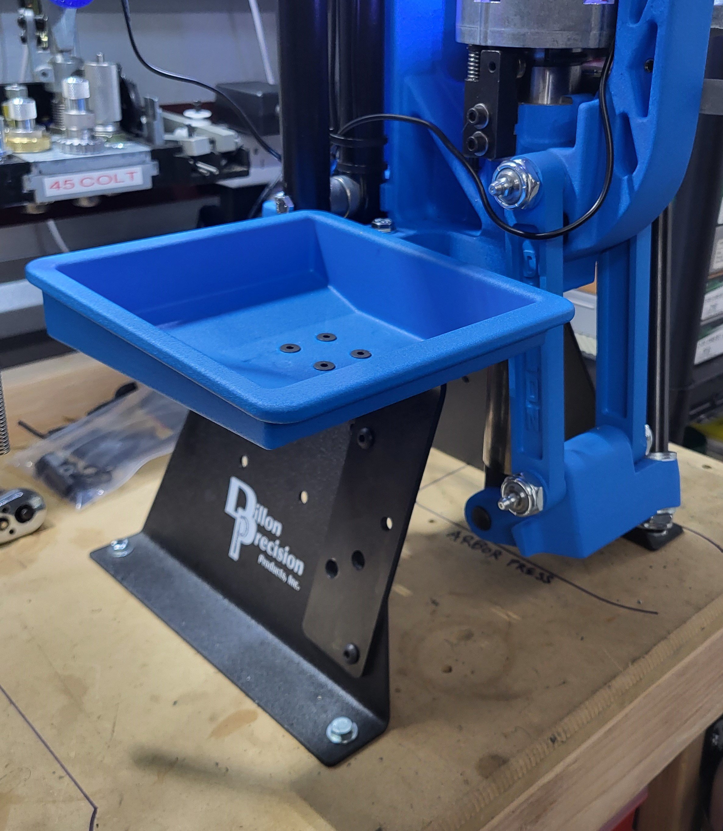

Nostrum Damus SASS #110702 Posted March 30, 2025 Author Posted March 30, 2025 Among this morning's further set-up and shake-down tasks is the quick job to see if I can relocate the bullet tray by simply drilling two new mounting holes in the strong mount to correspond to the holes in the bullet tray bracket. Kingsley, thanks for that confirmation. I was going to try sticking with the MA funnel (no pun intended) first, anyway. Back at it shortly ... but I'll wait to hear from Dillon before ordering three Double Alpha short powder bars -- I'll just do the set-up as instructed, without the capability of running a powder check die. Quote
Nostrum Damus SASS #110702 Posted March 30, 2025 Author Posted March 30, 2025 Progress. Relocating the bullet tray was a snap. Position it and drill two new holes in the Dillon Strong Mount. 1 Quote

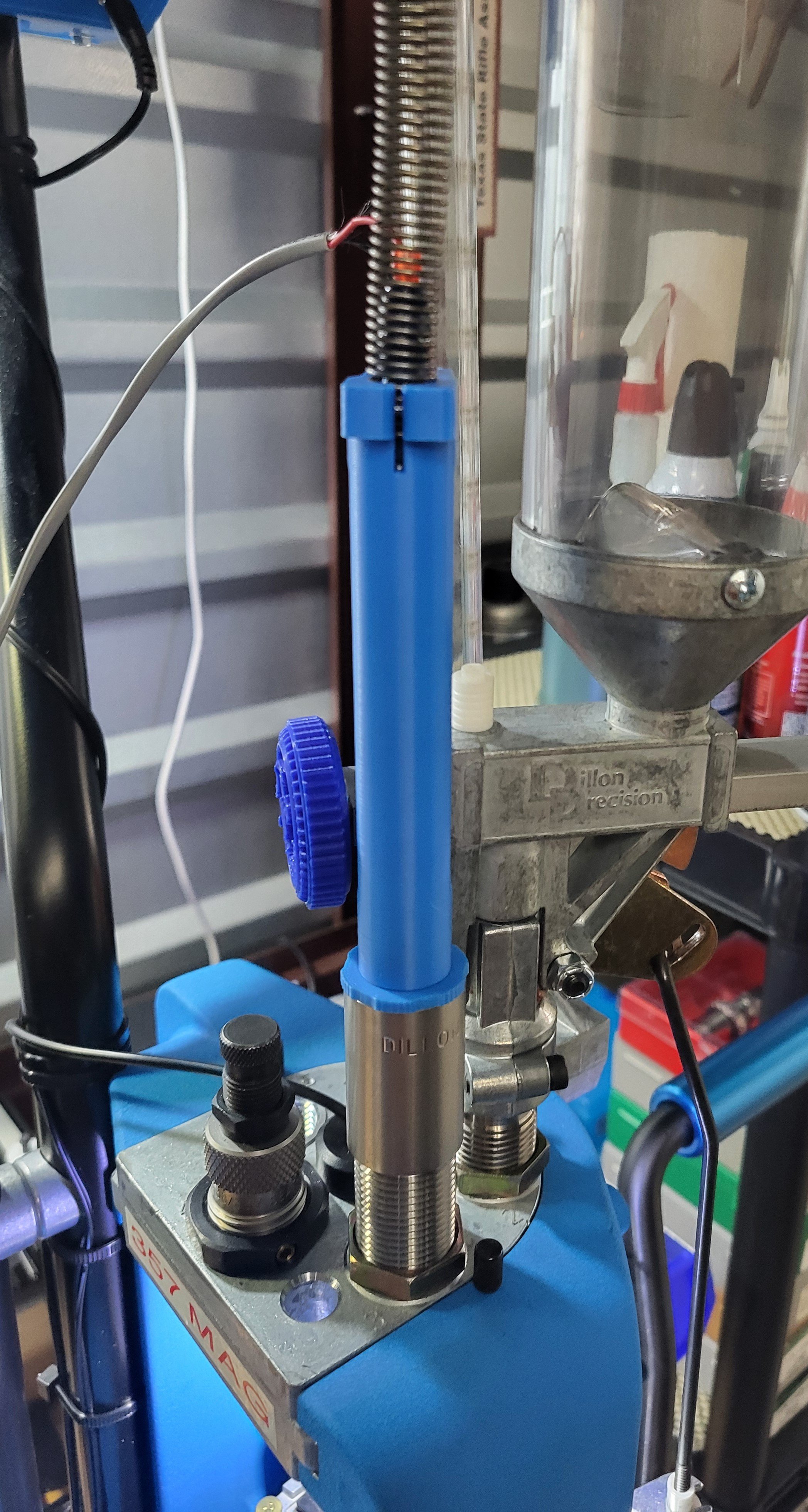

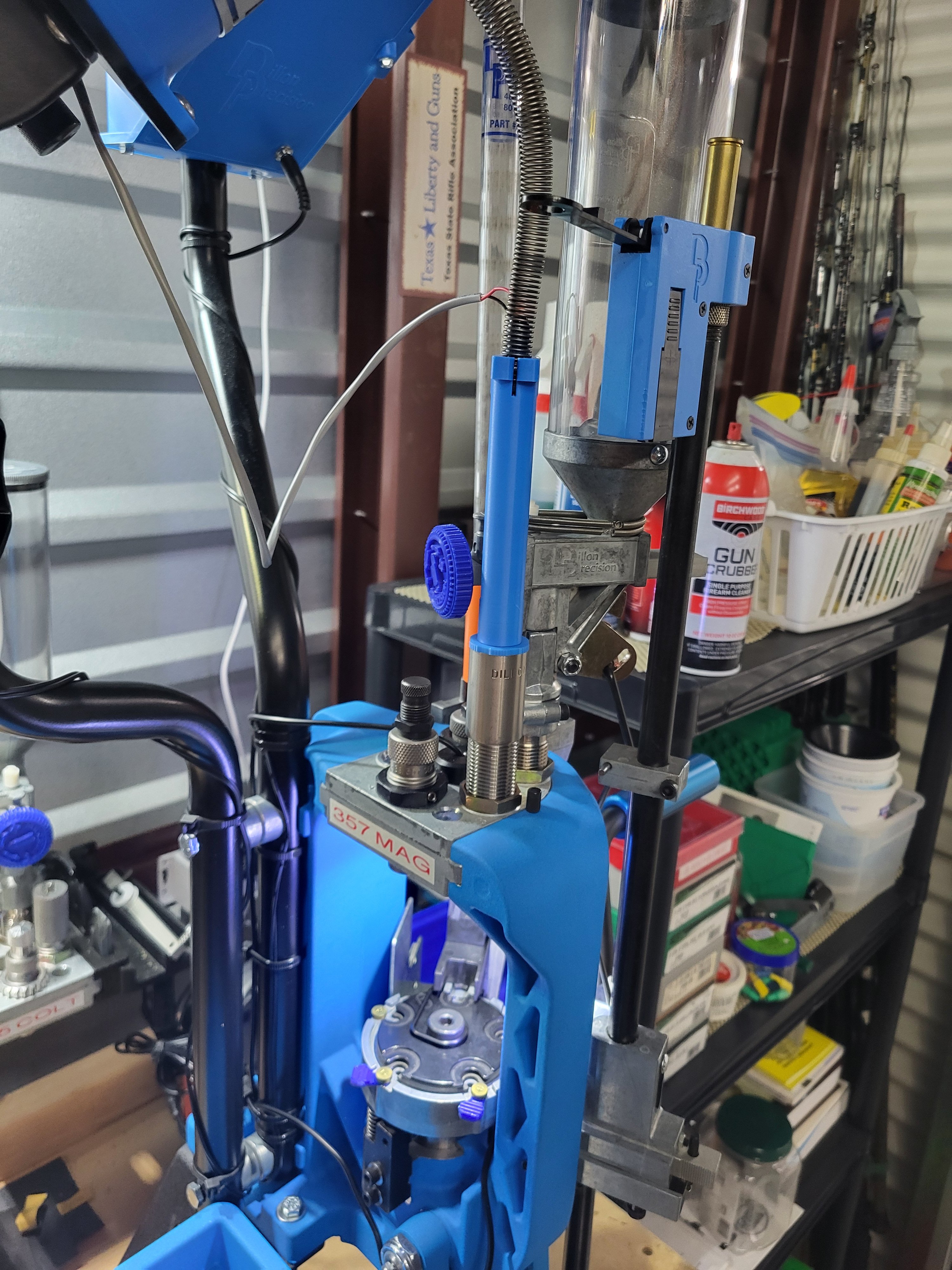

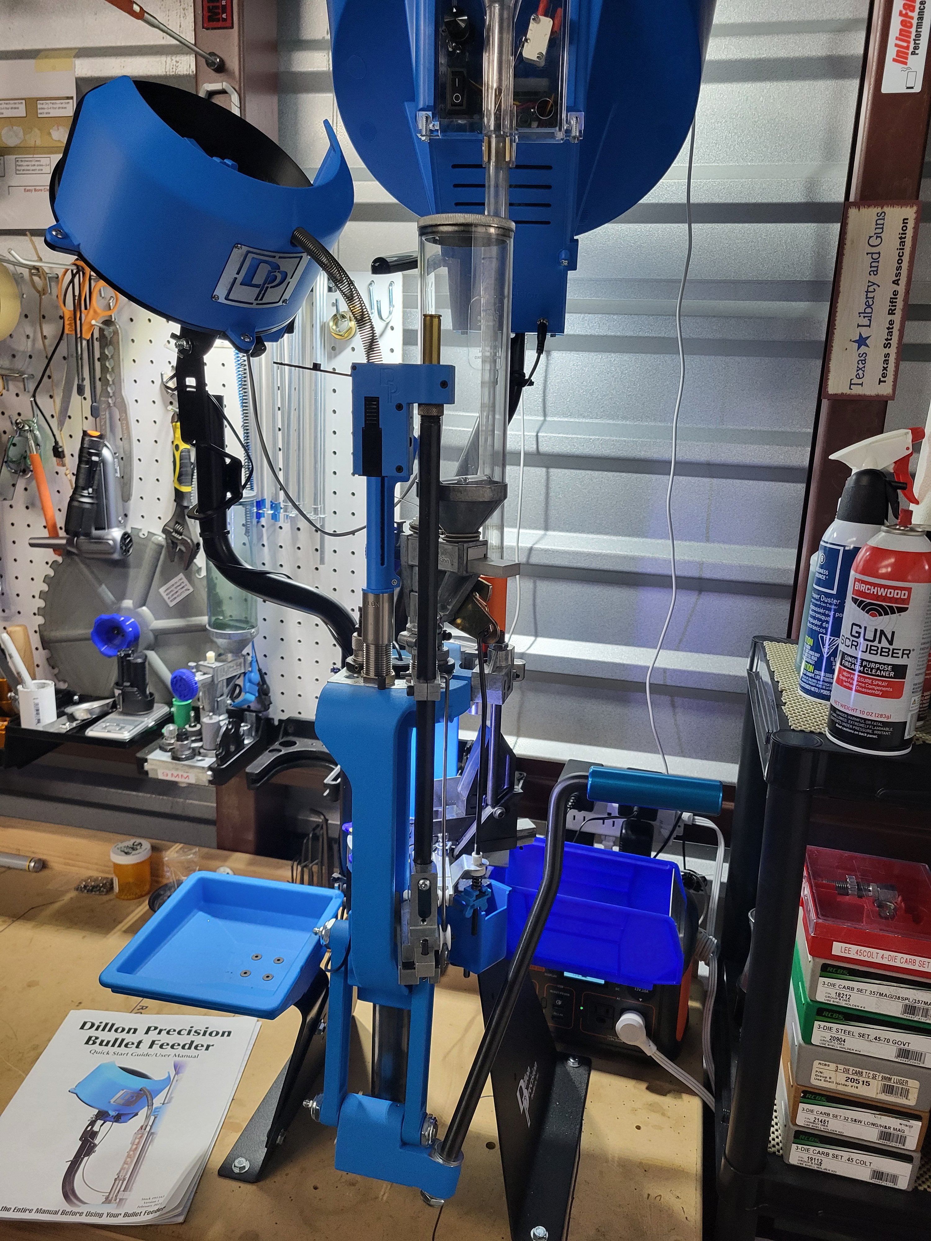

Nostrum Damus SASS #110702 Posted March 30, 2025 Author Posted March 30, 2025 More progress. I got the whole thing set up and operating nicely, with only one issue. I first set it up to load 9mm FMJ. Adjustments of the bullet bowl (angle, speed, tuning block height) to get it feeding totally reliably were simple and straightforward. Set-up of the Bullet Dropper Die was also simple. It turned out that adjustment of the Dropper Die for the 9mm FMJ and .358 dia RNFP bullets was the same -- ball bearings in the uppermost of the three pairs of holes in the inner sleeved of the die. That's a good thing since I'll be switching the Bullet Dropper Die between my 9mm and .357 Mag toolheads (and setting the height of the die is very quick and easy.) The whole thing is shown in the photos. I'll mention the issue in the next post. 1 Quote

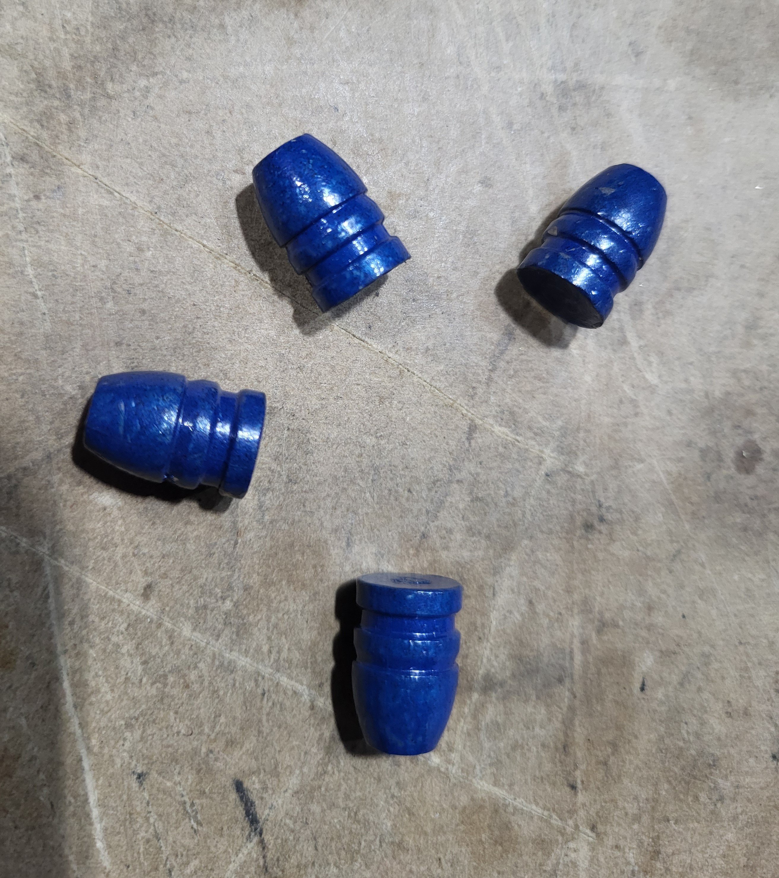

Nostrum Damus SASS #110702 Posted March 30, 2025 Author Posted March 30, 2025 And here is the issue: while it was functioning perfectly for 9mm, when I started testing the .357 Mag set-up the coated RNFP bullets kept falling over as the cases travel from the Bullet Dropper Die to the seating/crimping die. This happened with a range of flaring from .013 to .018 inch. I believe the cause is the sharp corner on the bottom edge of bullets cast in Lee Mold 358-125-RF, as seen in the photo. Thus, I think I am going to be searching for a bevel base bullet mold; as I understand it, bevel base bullets were developed to improve reliability and minimize misfeeds in commercial loading machines. Any other suggestions are invited. Other than that, and the issue that I cannot run a powder check die in Position 3, I'm generally pleased with this new addition to my 750. The previously mentioned minor issues will be fixed by Dillon in due course, I'm certain. Quote
Kingsley Posted March 30, 2025 Posted March 30, 2025 All I cast are bevel base, no problem what so ever. Also running a zip tie between the shell locations eliminates a lot of shell wobble and helps stabilize the bullet when moving to the seat/crimp location. Cardboard 4 Quote
Nostrum Damus SASS #110702 Posted March 30, 2025 Author Posted March 30, 2025 Great tip re the zip ties, thanks! And I think beveled base bullets are in my future. Quote
Shawnee Hills Posted March 30, 2025 Posted March 30, 2025 You may need a two-step flare powder funnel like what is used with the MBF. Can’t imagine that a single flare of the case mouth will work for any bullet that isn’t a boat tail. 1 Quote
Nostrum Damus SASS #110702 Posted March 30, 2025 Author Posted March 30, 2025 (edited) 45 minutes ago, Shawnee Hills said: You may need a two-step flare powder funnel like what is used with the MBF. Can’t imagine that a single flare of the case mouth will work for any bullet that isn’t a boat tail. Dillon provides their own version of the two-step funnel with the new bullet feeder. It is installed and didn't stop bullets from tipping over. It works just fine with 115gr 9mm FMJ pills. The lower edge of the copper-jacketed base is just a bit rounded rather than sharp corner, and it sits nicely without any wobble at all. Edited March 30, 2025 by Nostrum Damus SASS #110702 Quote

Nostrum Damus SASS #110702 Posted March 31, 2025 Author Posted March 31, 2025 (edited) SUCCESS! The stepped funnel flare must be set quite precisely, and when just enough flaring is applied, the bullet sits square in the case mouth. So while you can tolerate a little extra flare when setting bullets on charged cases by hand, that little bit of extra (and unecessary) flare allows the bullets to tip over when they travel from Pos 3 to Pos 4. It is a thing of beauty to see how nicely the bullets sit inside the case mouths after flaring with Dillon's version of the Double Alpha-style stepped powder funnel. OK, here's a recap of my issues, now that the thing is set up and running nicely: First, you cannot attach the bullet feeder mounting tube to your 750 if the press is sitting on a Dillon Strong Mount and is equipped with a Dillon Bullet Tray. How they screwed that up is beyond me. A modified Bullet Tray mounting bracket is required. I asked them to design, fabricate, and send one to me. Problem easily solved by drilling two new holes in the strong mount. Still, Dillon should tell folks that this is necessary if you want to continue to use your bullet tray. Second, they did NOT address the known interference of the bullet dropper die with the Dillon Powder Dropper's charge bar on the 750. As is the case with the Mr. Bullet Feeder as well, you cannot run a powder check die in between the powder die and bullet drop die because the bullet drop must be installed in Position 3 -- UNLESS you buy Double Alpha Academy's Extra-Short Dillon Powder Bar. Frankly, that is ridiculous. Dillon should provide a similarly short powder bar with the Bullet Feeder to allow me to use my powder check dies (in every toolhead). Still annoying. I'll have to decide whether to buy one DAA Extra-Short Dillon Powder Bar for EACH of my toolheads. Everything else is minor, in comparison. One part arrived broken, sort of -- a very tiny machine screw was cross-threaded into its semi-captive nut fitted into a plastic part; attempting to either loosen or tighten the screw caused the nut to strip the hex-shaped hole in the plastic part it is assembled into. I asked for a replacement sub-assembly. Dillon will send me the replacement sub-assembly, of course. But the press runs with the one it came with -- the spring bullet guide simply isn't as securely attached to the lower end of the bullet chute (located entirely inside the bowl, thankfully) as it should be. I have Version 1 of the User Manual. Some information I would have expected to find in it is not, and other stuff doesn't match what comes in the box. Specifically, some of the subassemblies are already partially assembled, so the instructions telling you to put them together make little or no sense. And you can't find the parts they are referring to because they've already been put together and some are hidden behind or underneath other parts. I get it -- this is Version 1. But I do still have two more screws than it seemed I needed to follow the assembly instructions anyway -- I have no idea whether they are indeed extras or if I missed something due to the nonsensical instructions. Dillon will improve Version 2 of the manual, I'm sure. One other thing is worth mentioning. The Bullet Feeder is supplied with substitute powder funnels for the powder drop die. These are supposedly needed to create the correct flare that allows the bullet to seat properly in the case mouth. I recently spent $50 on a Mighty Armory 9mm Powder Funnel Flare to reduce the "sticking" I've experienced when loading 9mm. I will be miffed some if I have to swap out that part. I did indeed do the swap on my .357 Mag toolhead. After getting the amount of flare precisely set, it works great. I'll see if it is necessary to swap out the funnels on my 9mm and .45LC toolheads when I set them up. Either way, no problem. And here is the issue: while it was functioning perfectly for 9mm, when I started testing the .357 Mag set-up the coated RNFP bullets kept falling over as the cases travel from the Bullet Dropper Die to the seating/crimping die. This happened with a range of flaring from .013 to .018 inch. I believe the cause is the sharp corner on the bottom edge of bullets cast in Lee Mold 358-125-RF, as seen in the photo. Thus, I think I am going to be searching for a bevel base bullet mold; as I understand it, bevel base bullets were developed to improve reliability and minimize misfeeds in commercial loading machines. Any other suggestions are invited. As mentioned, getting the funnel set correctly is critical. Basically, the wider stepped portion of the funnel should go all the way into the case mouth, but no further than that. I started getting tipping as soon as the case mouth started to be inclined or tilted outwardly. Once I got that right, no more bullet tipping. And I don't need to switch to bevel base bullets, nor put zip-ties on the bosses between locator pins, either. I imagine that Version 2 of the User Manual will include some of these hints and explanations. Overall, I'm very happy with the set-up. Next task -- see how it all performs when loading 500 rounds in a timed session. Edited March 31, 2025 by Nostrum Damus SASS #110702 1 2 Quote

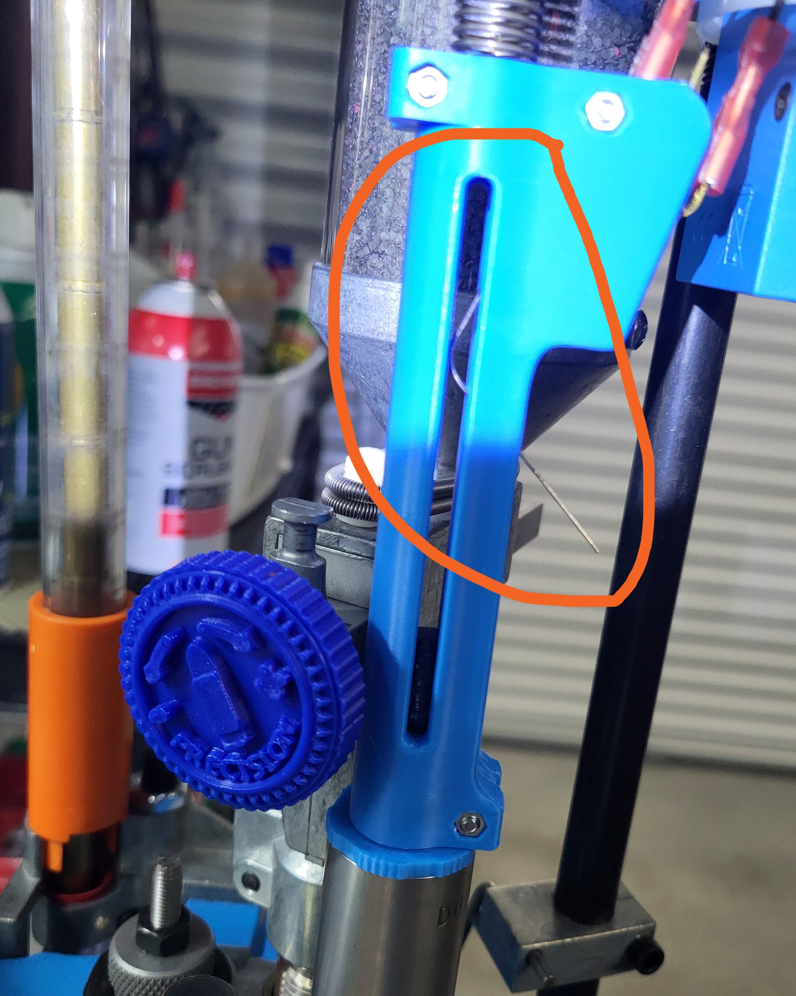

Nostrum Damus SASS #110702 Posted April 3, 2025 Author Posted April 3, 2025 I had fun chatting with the good folks at Dillon Precision today, twice. First, here are some photos of issues or problems I was having when the machine is set up with the 9mm/38/357 caliber kit and using these coated cast lead .358" dia 125gr projectiles: First, just as bullets entered the bullet chute in the bowl, they were snagging and tipping up, thus blocking the chute, like this: The reason seems pretty clear to me: the Center Plate's surface is ribbed crosswise to the direction of bullet travel! This area, seen more clearly in these next photos, needs to be smooth: The chatter marks left in this area of the Center Plate by the additive manufacturing process must go! Dillon now know about it, if they didn't already. (It seems that the Service Dept is up to its eyeballs in Service Tickets and phone calls about the new Bullet Feeder which, to be honest, seems to me to still be in "beta test" mode.) Next, I inspected the internal throat of the Bullet Switch and it is 100% clear that my bullets are not hung up on any structure that is part of the assembly. It is quite obvious in these photos that the bullet simply did not have enough downward momentum to overcome the frictional braking applied by the contact switch's actuation arm (note the relative vertical positions of the bullet and the contact arm -- there is no internal structure near the lower end of the bullet that it could possibly hang up on): The bottom of the bullet is even visible hanging in thin air below the bottom end of the contact switch actuation arm: So, it is totally clear that the issue is insufficient momentum of the bullet when it arrives at the contact switch actuation arm. It needs to be traveling faster. The best way to accomplish that, in my opinion, would be to raise the height of the bowl; I suspect that 6 inches would do the trick but I don't have the means to test that hypothesis. That will require a redesign of the mounting tube and Dillon providing longer Bullet Conduit Springs. That might be all that's needed. But maybe not. The second best way, in my view, would be to enlarge the diameter of each component of the bullet dropper assembly so that the bullet falls faster. Basically, I think all three of these components are too small in I.D.: Since I also bought the 45 caliber conversion kit for my 200gr coated cast RNFP bullets, I decided to swap these components from that kit for the same in the 9mm/38/357 kit, as a test. The Dillon guy didn't know if it would work, and in fact expressed some doubt. It turned out, well ... EUREKA!! The .352 coated pills FLY down the Conduit Spring and flash right past the microswitch actuation arm in the Bullet Switch. In fact, it works so well that, had I not known I had installed these three parts from the 45 cal conversion kit, I would have said the whole thing works PERFECTLY AS DESIGNED. There is apparently enough diameter in the .352 bullets to cause the Bullet Switch to disengage the bowl motor when the stack inside the Bullet Switch is sufficiently high. And there you have it! AND as a bonus, this swap of parts ALSO seems to have eliminated the "bullet tipping" issue at the entrance of the Bullet Chute inside the bowl. Go figure! Last two problems solved. The folks at Dillon are now fully up to speed with everything I've been tinkering with. 1 Quote

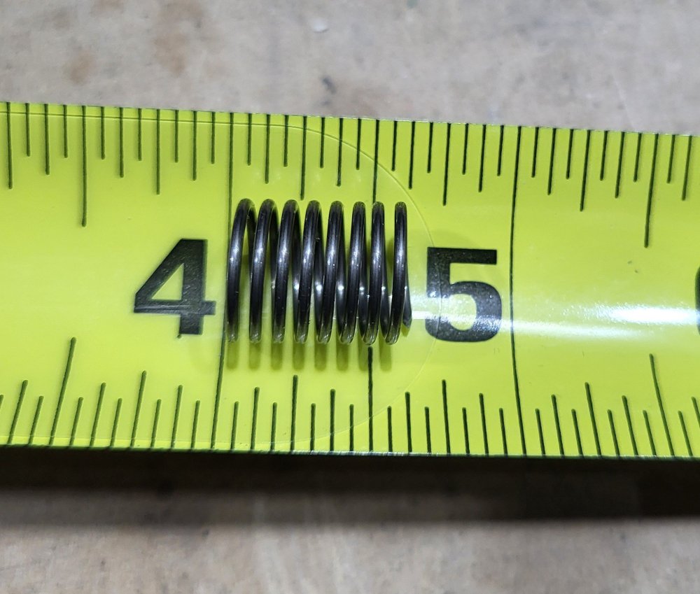

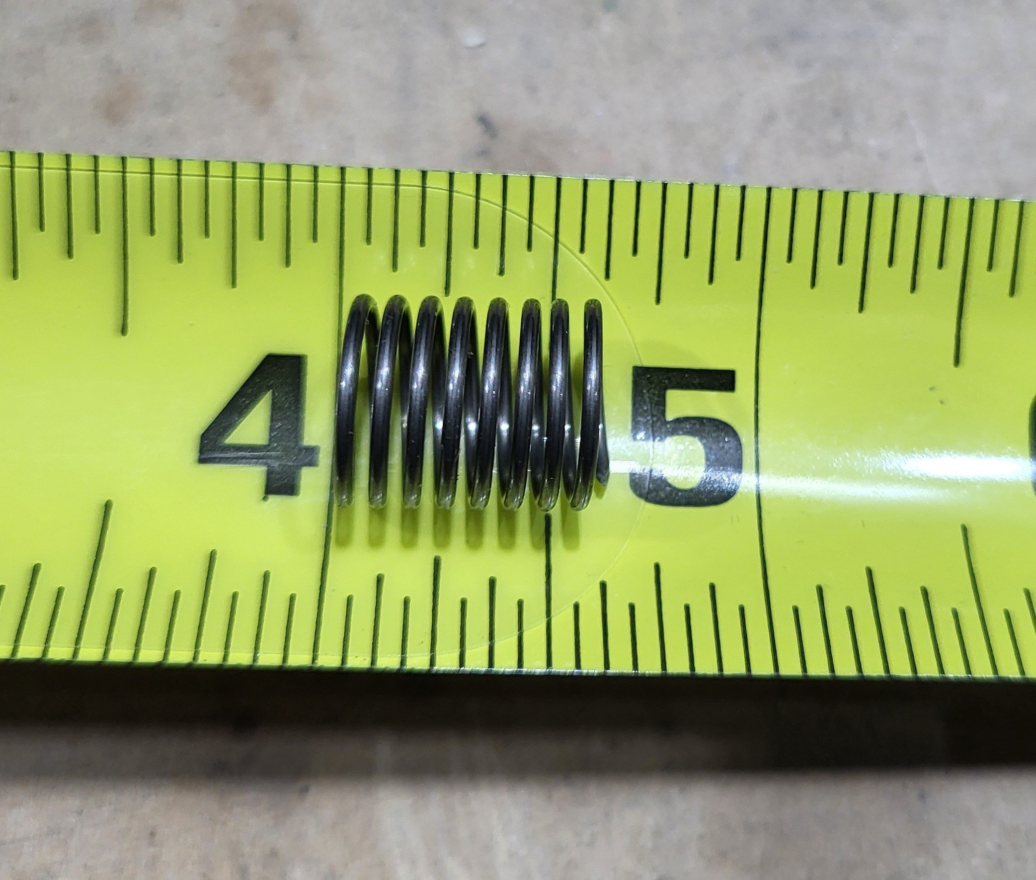

Mogollon Munk,SASS#303 Posted April 17, 2025 Posted April 17, 2025 I have seen a prototype bullet tray bracket that provides clearance for the bullet feeder mounting post. An anvil should be included in all R&D shops! The case feed mount is adjustable in height by several inches where it mounts onto the post. No reason to cut any springs. No plans to offer a shortened powder bar. We still recommend seating and crimping in two separate steps. Feel free to bend the soft metal arm in the blue switch housing. Quote
Nostrum Damus SASS #110702 Posted April 20, 2025 Author Posted April 20, 2025 (edited) On 4/17/2025 at 11:41 AM, Mogollon Munk,SASS#303 said: I have seen a prototype bullet tray bracket that provides clearance for the bullet feeder mounting post. An anvil should be included in all R&D shops! The case feed mount is adjustable in height by several inches where it mounts onto the post. No reason to cut any springs. No plans to offer a shortened powder bar. We still recommend seating and crimping in two separate steps. Feel free to bend the soft metal arm in the blue switch housing. That prototype bullet tray bracket should be offered even though most folks can just drill two new mounting holes in the strong mount, as I did. Both the case feeder and bullet feeder are designed to be mounted at a specific height on their respective posts. There are stops that prevent the components from sliding down the post as the fixing screws loosen over time from normal vibration. The RCBS seating/crimping dies work great; whether one wants to seat and crimp at separate stages is personal preference, I think. The problem is that the bullet feeder die MUST be installed in Position 3, immediately after the powder drop position, because it is the bullet feeder that interferes with the powder bar, so no sort of powder check die can be used between the powder drop and bullet drop positions. That's an issue for me. Bending the metal arm in the switch housing is hardly simple or intuitive as to how it should be bent by the user in a way that it will still function correctly, in any case. That's not a practical solution IMHO. All that said, I do appreciate it that you thought about these things. Edited April 20, 2025 by Nostrum Damus SASS #110702 Quote
