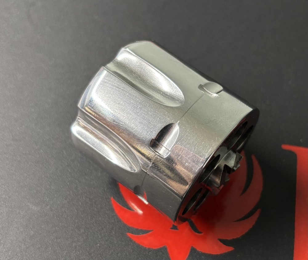

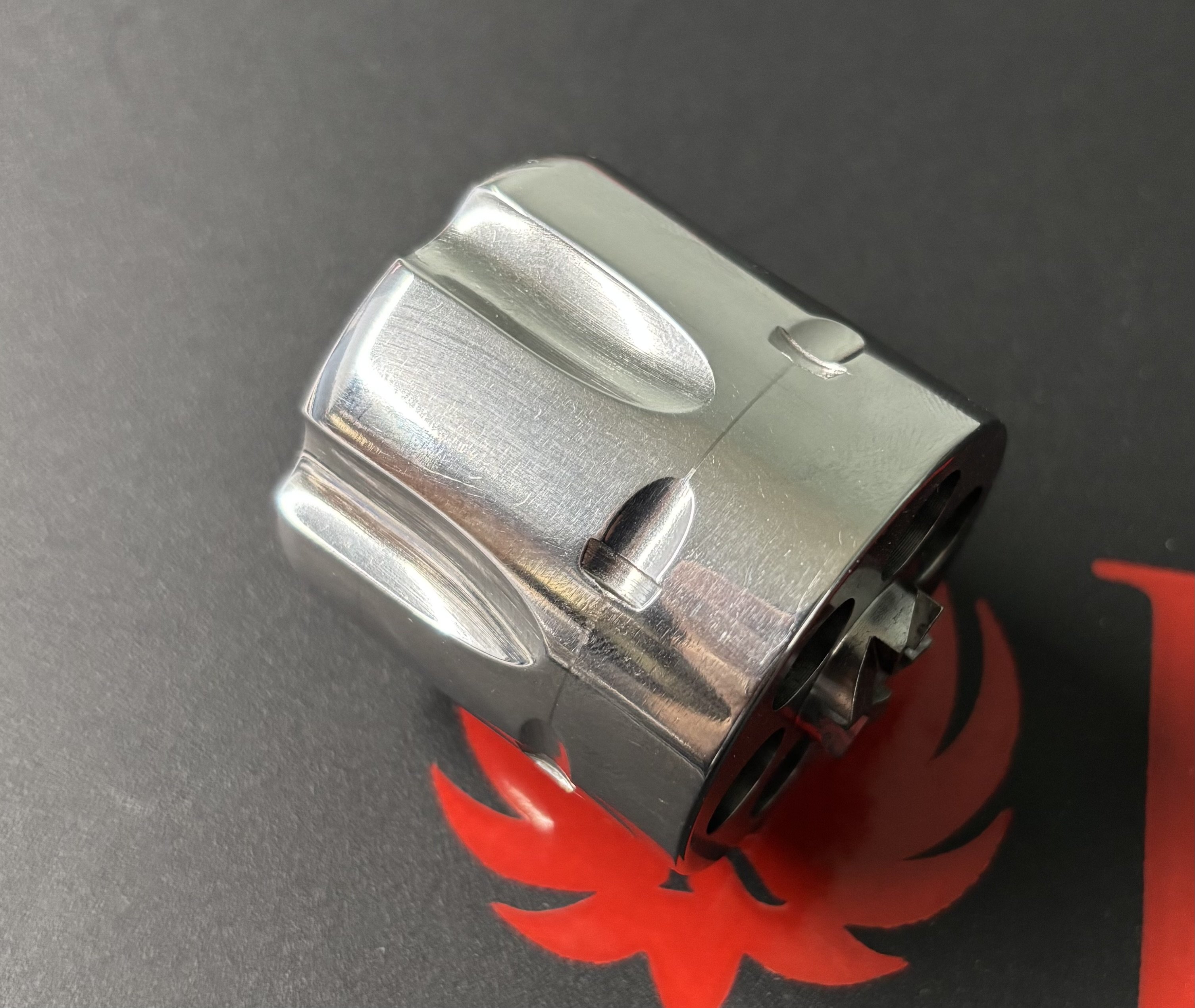

Bingo Montana Posted March 21, 2025 Posted March 21, 2025 Yes , brand new Ruger New Vaquero with the same issue, on its way back to Ruger for repair. You can see in the photo where the cylinder latch is damaging the cylinder locking slot. This is the condition of the cylinder right out of the box, zero rounds fired.
The Original Lumpy Gritz Posted March 21, 2025 Posted March 21, 2025 42 minutes ago, Bingo Montana said: Yes , brand new Ruger New Vaquero with the same issue, on its way back to Ruger for repair. You can see in the photo where the latch is damaging the notch. This is the condition of the cylinder right out of the box, zero rounds fired. That 'latch' is called a cylinder stop.
Bingo Montana Posted March 21, 2025 Posted March 21, 2025 21 minutes ago, The Original Lumpy Gritz said: That 'latch' is called a cylinder stop. Just going by Jerry Kuhnhausen's book "The Ruger Single Action Revolvers, A Shop Manual, Volumes 1 & 2, as well as Ruger's parts list, where the part is described at "cylinder latch". Probably should have described the notch as the cylinder locking slot as well. I will edit my original post, thanks.
The Original Lumpy Gritz Posted March 21, 2025 Posted March 21, 2025 2 hours ago, Bingo Montana said: Just going by Jerry Kuhnhausen's book "The Ruger Single Action Revolvers, A Shop Manual, Volumes 1 & 2, as well as Ruger's parts list, where the part is described at "cylinder latch". Probably should have described the notch as the cylinder locking slot as well. I will edit my original post, thanks. No biggie Just for cit's & giggles, try the other cylinder in this problem gun.
