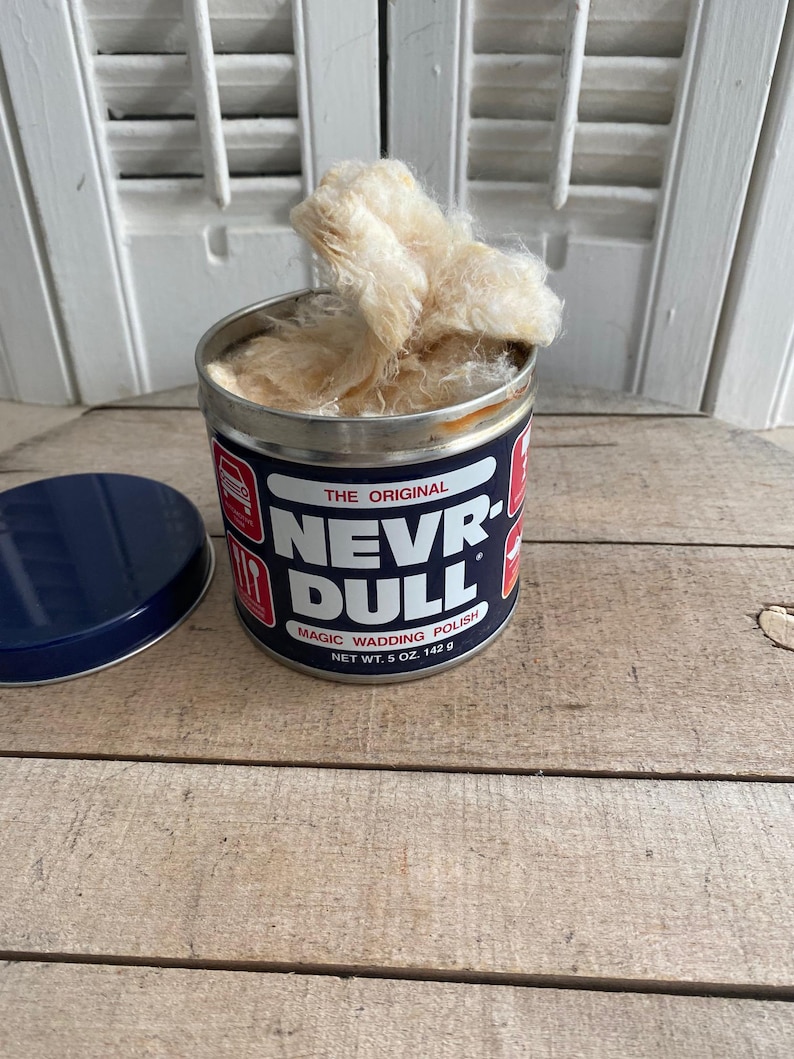

The Rainmaker, SASS #11631 Posted March 18, 2025 Posted March 18, 2025 I've used Nevr-dull wadding polish on some loaded cartridges I had that I wanted to shine up a bit; worked great. https://eagleone.com/products/all-metal-polish/ 1 Quote

Dapper Dave Posted March 19, 2025 Posted March 19, 2025 16 hours ago, The Rainmaker, SASS #11631 said: I've used Nevr-dull wadding polish on some loaded cartridges I had that I wanted to shine up a bit; worked great. https://eagleone.com/products/all-metal-polish/ Nevr-Dull, ouch. I shined a LOT of brass in the military with Nevr-Dull, hate that smell. 3 Quote
The Rainmaker, SASS #11631 Posted March 19, 2025 Posted March 19, 2025 Haha, how do you think I know about it? Damned water fountain... 😆 3 Quote

Frontier Lone Rider Posted September 6 Posted September 6 On 3/19/2025 at 6:08 AM, Dapper Dave said: Nevr-Dull, ouch. I shined a LOT of brass in the military with Nevr-Dull, hate that smell. I have never heard of Nevr-Dull, but we used bunches of Brasso. And, yes it has an odor also. Quote

Griff Posted September 6 Posted September 6 4 hours ago, Frontier Lone Rider said: I have never heard of Nevr-Dull... 1 Quote
