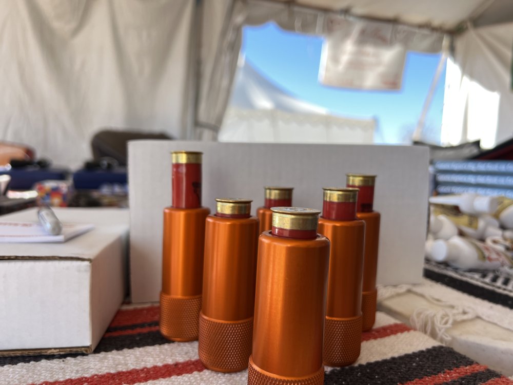

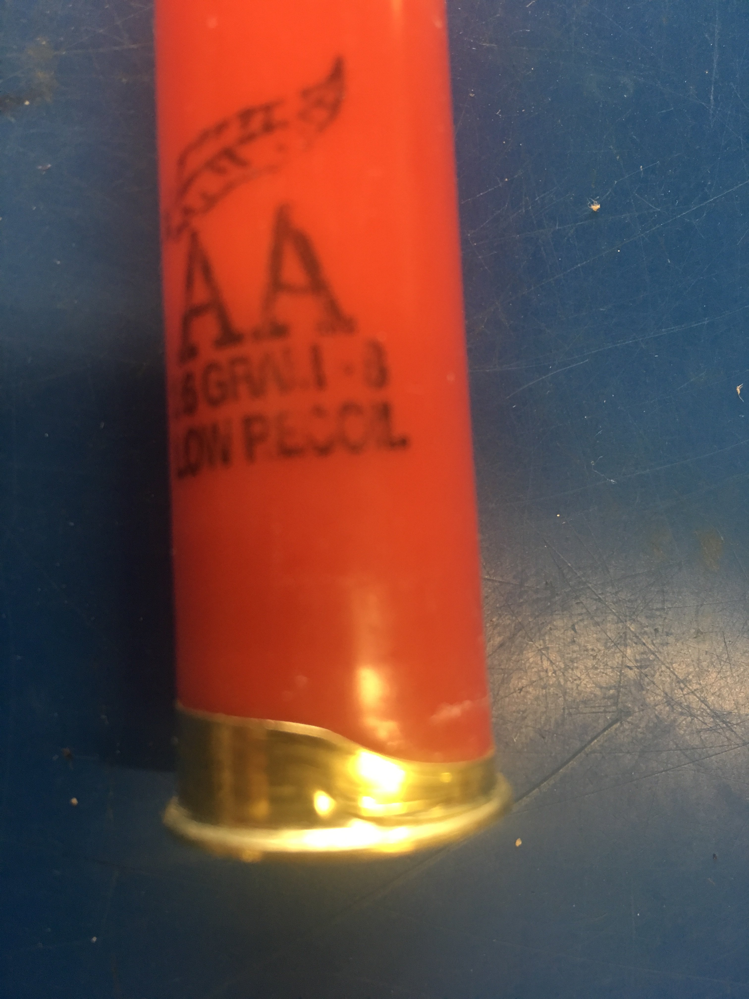

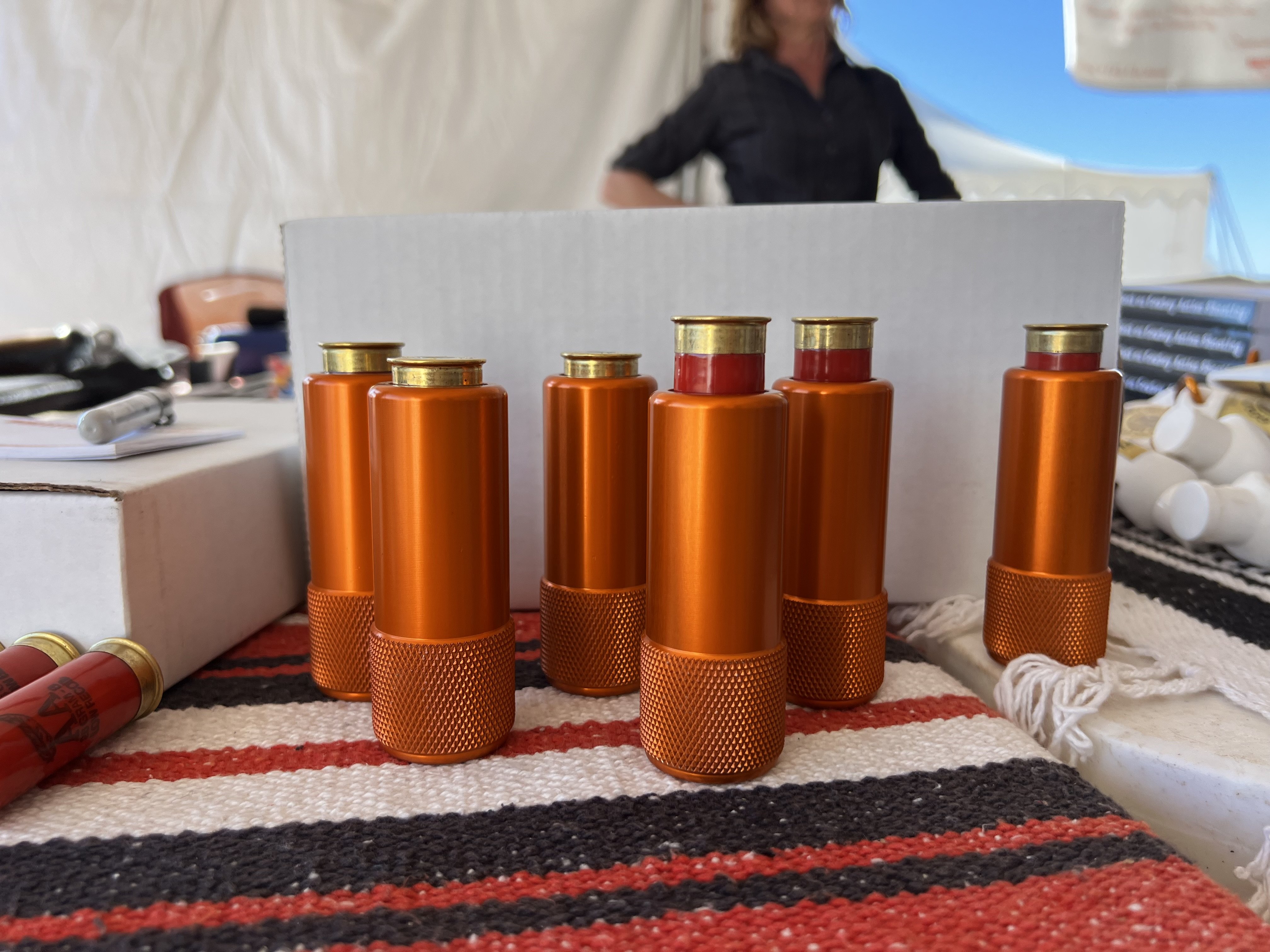

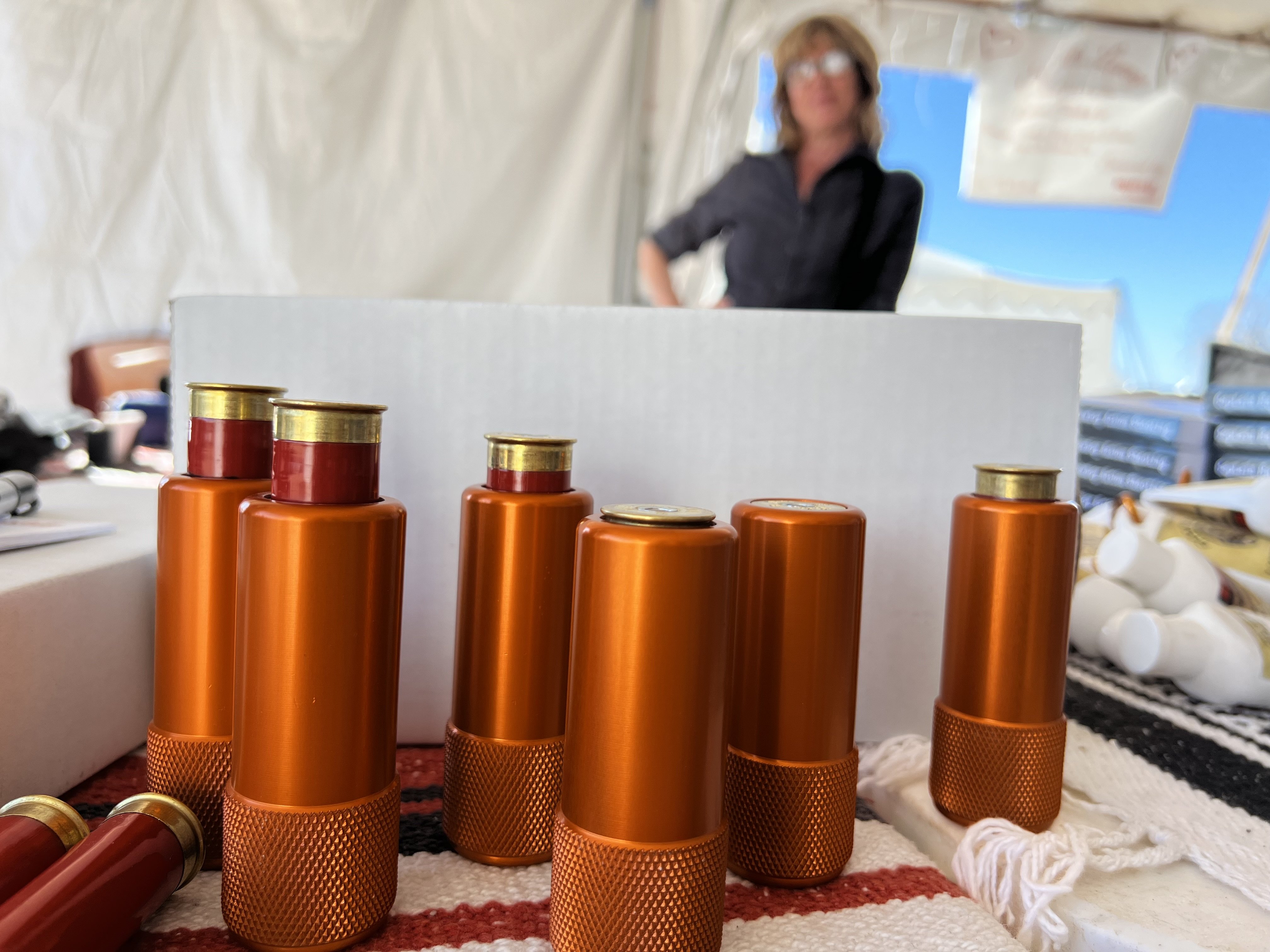

Because I sell the Slixprings Gauge and the Ryder Sizer, I took a new case of AA to EOT - plus, in case some folks forgot them. It was before the main match started… I checked 4 boxes. 100 shells. 66 did NOT gauge. After I ran them through the Ryder sizer, they all gauged.
These are just a few of those…. It makes for good show and tell. And, if they went in, they rarely would fall out. I want them to drop in/out without any effort. Hugs!
Scarlett
