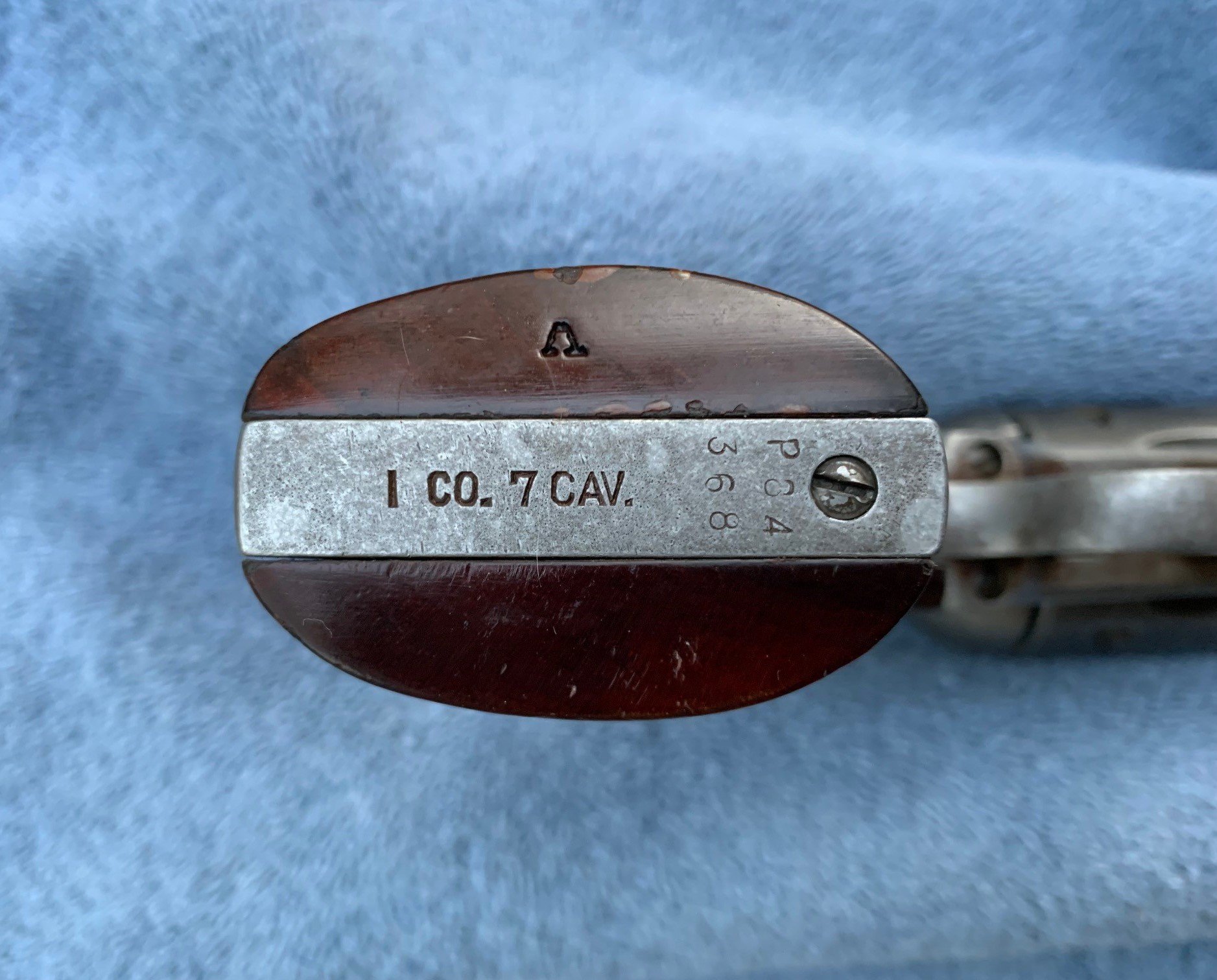

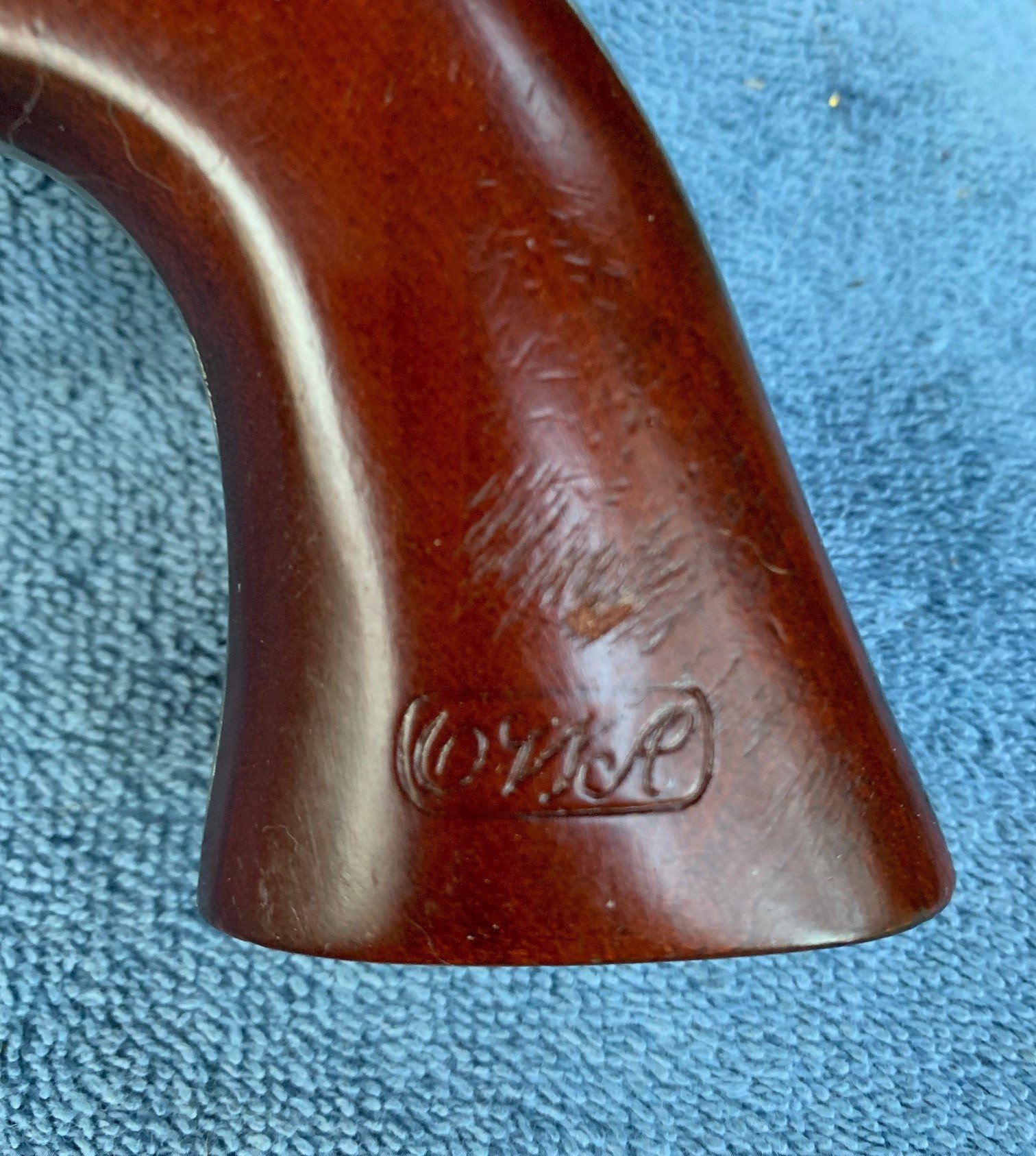

I have a Cimarron 7th Cavalry Model P in the "Original Finish."  It's a dandy revolver, nicely put together, and very smooth right out of the box.  They did a good job with the finish, too... It really looks like a 150 year old veteran.  Like the original Colts, it has a removable cylinder bushing, solid, hammer-mounted firing pin, and "four clicks."  This particular one also has the correct military markings, including the Ainsworth initials on the left grip panel.  The bottom strap has 7th Cavalry Co. I stamped in (I think that was Keogh's company).

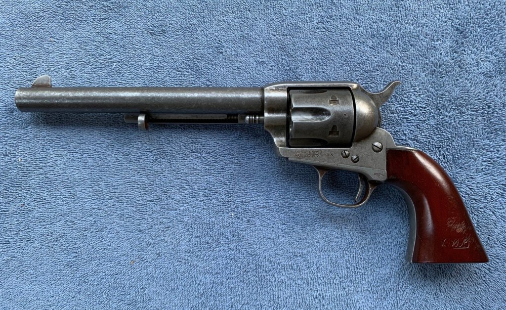

I'll try to post a picture of the left side of the revolver so you can check 'er out.
