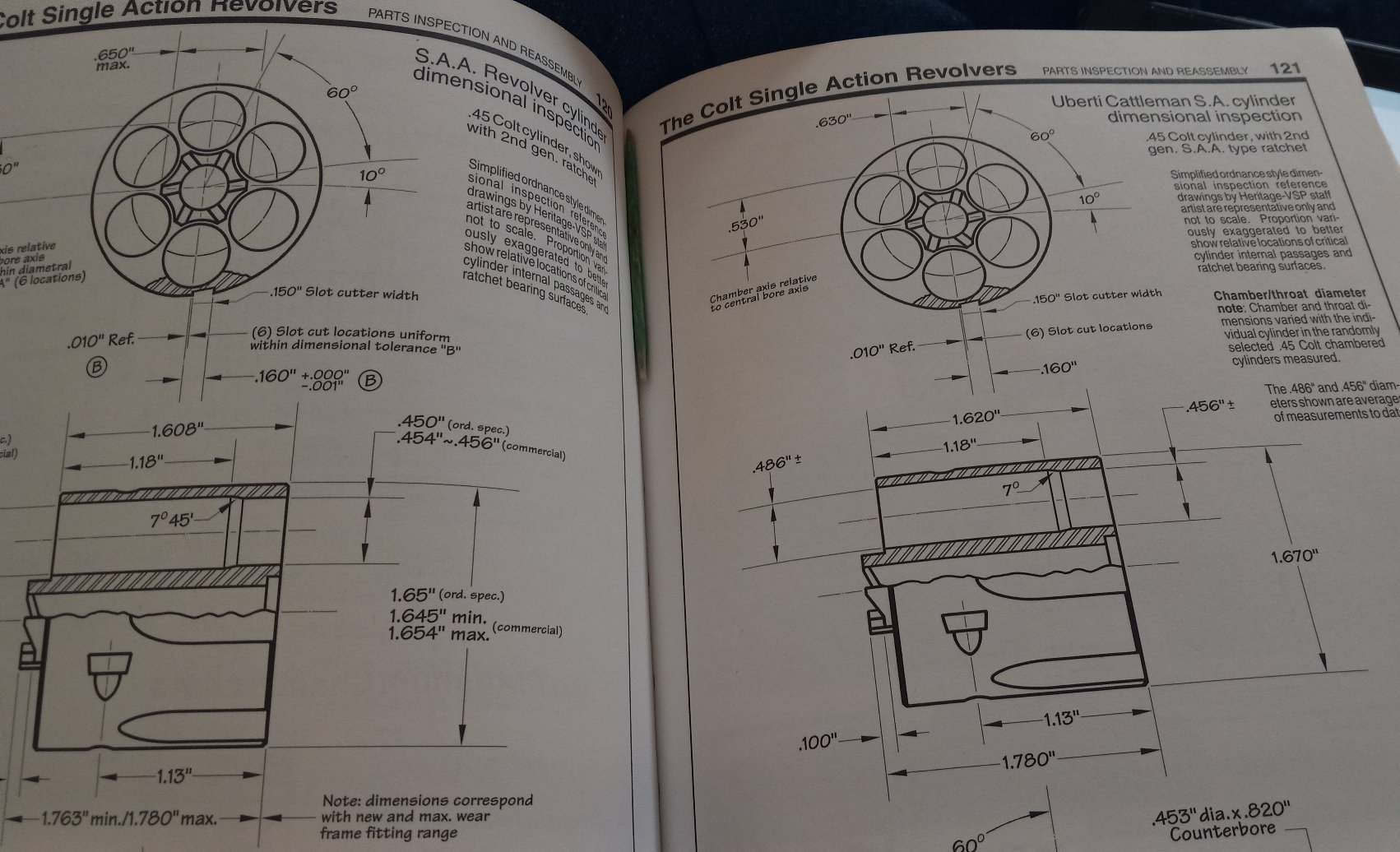

JackSlade Posted March 11, 2025 Posted March 11, 2025 I need to see comparison photos with measurements, because I've always known that rugers are GIANT compared to a proper peacemaker, but I've never heard that ubertis are bigger than colts before.
Warden Callaway Posted March 11, 2025 Posted March 11, 2025 From Jerry Kuhnhausen's shop manual. And its be stated a number of times in various places.
Abilene, SASS # 27489 Posted March 11, 2025 Posted March 11, 2025 Very quick measurement on cylinder diameter: Colt 1.651" Uberti 1.667" (typing while Warden posted the kuhnhausen page)
Buckshot Bob Posted March 11, 2025 Author Posted March 11, 2025 Pietta is pretty close to a Colt . I always heard the rumor that Standard Manufacturing bought out the tooling from USFA when they went out of business. So that’s why they build the Uberti size pistol
Rye Miles #13621 Posted March 11, 2025 Posted March 11, 2025 .015 is not a lot no wonder I never noticed a difference!
watab kid Posted March 12, 2025 Posted March 12, 2025 thats why i didnt notice , i was just about to pull out my colt and the others to check , but that manual spells it out well enough , thanks for that information ,
