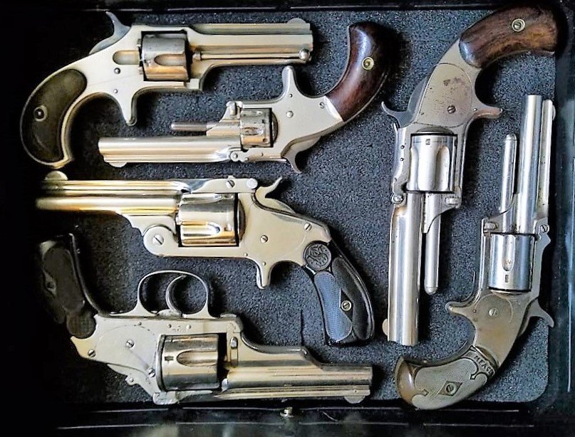

PaleWolf Brunelle, #2495L Posted March 8, 2025 Posted March 8, 2025 Here are a few of mine (most are SASS-legal for side match use):

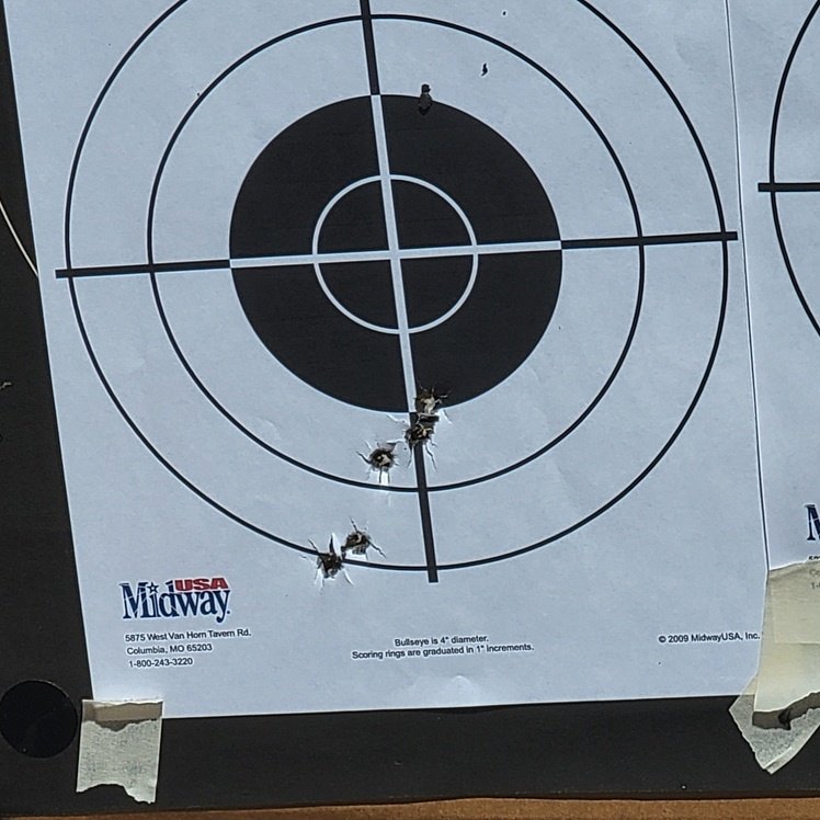

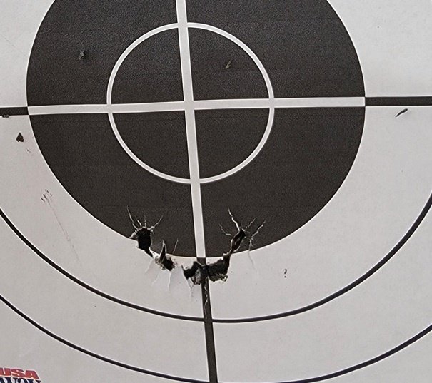

Dapper Dave Posted April 9, 2025 Author Posted April 9, 2025 I know this thread has been dormant for a while, but I asked my Territorial Governor about pocket pistol matches and he said we had never done one...because nobody HAS one. However, he was open to adding it to the Annual Match in November. Side note, safety wise, I found it interesting that my little Iver Johnson actually has a transfer bar safety, and the even smaller Harrington and Richards Young American 32SW I am trying to acquire also has a transfer bar safety - I seriously thought that was a recent, (like last 60-70 years), development. I did try the little Iver at 5 yards with the black powder gallery load a few weeks ago. That looks paper plate sized. I think I need to go easier on the lube - gobs of black lube ended up on the target at that range.
