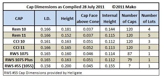

Griff Posted March 7 Posted March 7 In case you're wondering what caps easily interchange... here's a chart I found on another forum that gives dimensions of some of the more common caps.
Big Gus, SASS# 66666 Posted March 9 Posted March 9 What is the difference between #10 and #11 caps.? Why is it recommended to switch to aftermarket nipples? A BP novice wants to know, that would be me. Thanks Big Gus
Barry Sloe Posted March 9 Posted March 9 2 hours ago, Big Gus, SASS# 66666 said: What is the difference between #10 and #11 caps.? Look at the chart that compares caps. Height and diameter are the two biggest items. As for nipples; try the factory nipples and if they work ... I swapped over to Slix nipples. Just cause. Check your manual for what caps are recommended with the factory nipples. Luck, BS
Edward R S Canby, SASS#59971 Posted March 9 Posted March 9 27 minutes ago, Barry Sloe said: Look at the chart that compares caps. Height and diameter are the two biggest items. As for nipples; try the factory nipples and if they work ... I swapped over to Slix nipples. Just cause. Check your manual for what caps are recommended with the factory nipples. Luck, BS All the factory nipples on my Ruger Old Armys were reliable. Only one of my Italian revolvers had reliable nipples. I had to replace all the rest with aftermarket nipples manufactured with tighter tolerances. Caps would stay on the aftermarket nipples after firing and all go bang. This was not the case with the nipples supplied on the Italian revolvers. As BS said, give the factory nipples a try (before a match) and see if they meet your expectations. You might get lucky. If caps don't fall off before or after firing and all go bang you might keep them. I just shot the Plainsman at EOT. It was painfully obvious who shot stock factory guns with any caps they could buy locally. I saw lots of revolvers lock up and cylinders that would not fire. A lady from my local club shot a pair of my Remington 1858 revolvers with Remington #10 caps on Tesco aftermarket nipples. The revolvers were 100% reliable and she won Ladies Modern.
