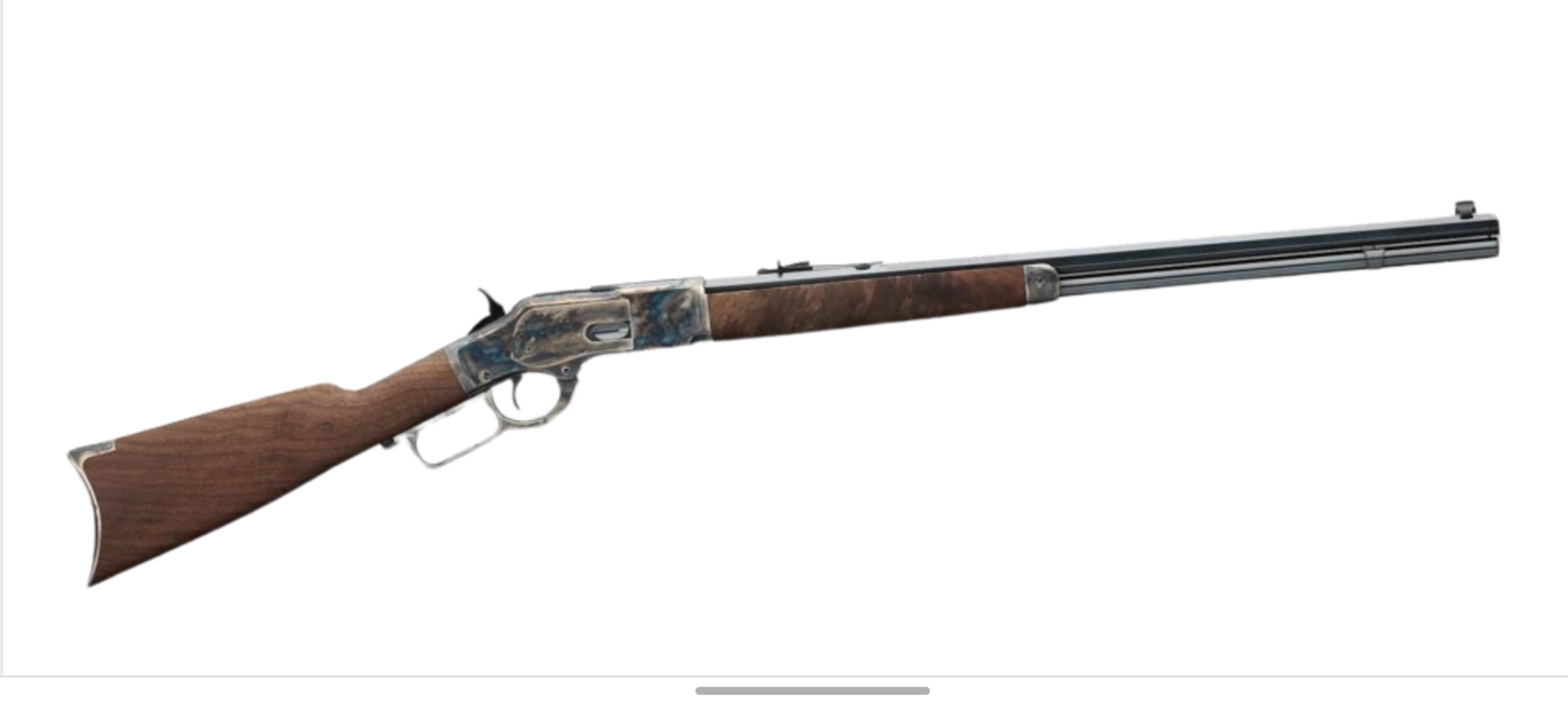

Rooster Ron Wayne Posted March 3, 2025 Posted March 3, 2025 I know there is more then one way to skin a Coon ! I'm looking for advice on what type of chemical striper works the best , I have been reading about Citra strip. I would like to strip the red off the wood on one of my 1873 Uberti Winchester's . I prefer this look much better to the Uberti red . Thank you . God bless. Rooster
Garrison Joe, SASS #60708 Posted March 3, 2025 Posted March 3, 2025 Yep, CitriStrip is one of the most common, and least dangerous to lungs and skin, strippers. I've used several, and now just use CitriStrip. It will USUALLY cut through the sprayed polyurethane finish that the factory puts over the red stain in one or two applications. Get a few plastic bondo spreaders or other medium soft plastic scrapers to pull off the stripper and softened finish. Don't use metal tools or steel wool. Use the woven plastic scrubber pads if you need to have something SLIGHTLY aggressive. Once stripped, do the least amount of sanding or dewhiskering that gives you a smooth surface. It's very easy to take enough wood off to have metal standing proud of your refinish job, which, to an experienced eye, says "clumsy refinish job." Needless to say, make sure you separate the wood stocks from all metal parts before you start. good luck, GJ .

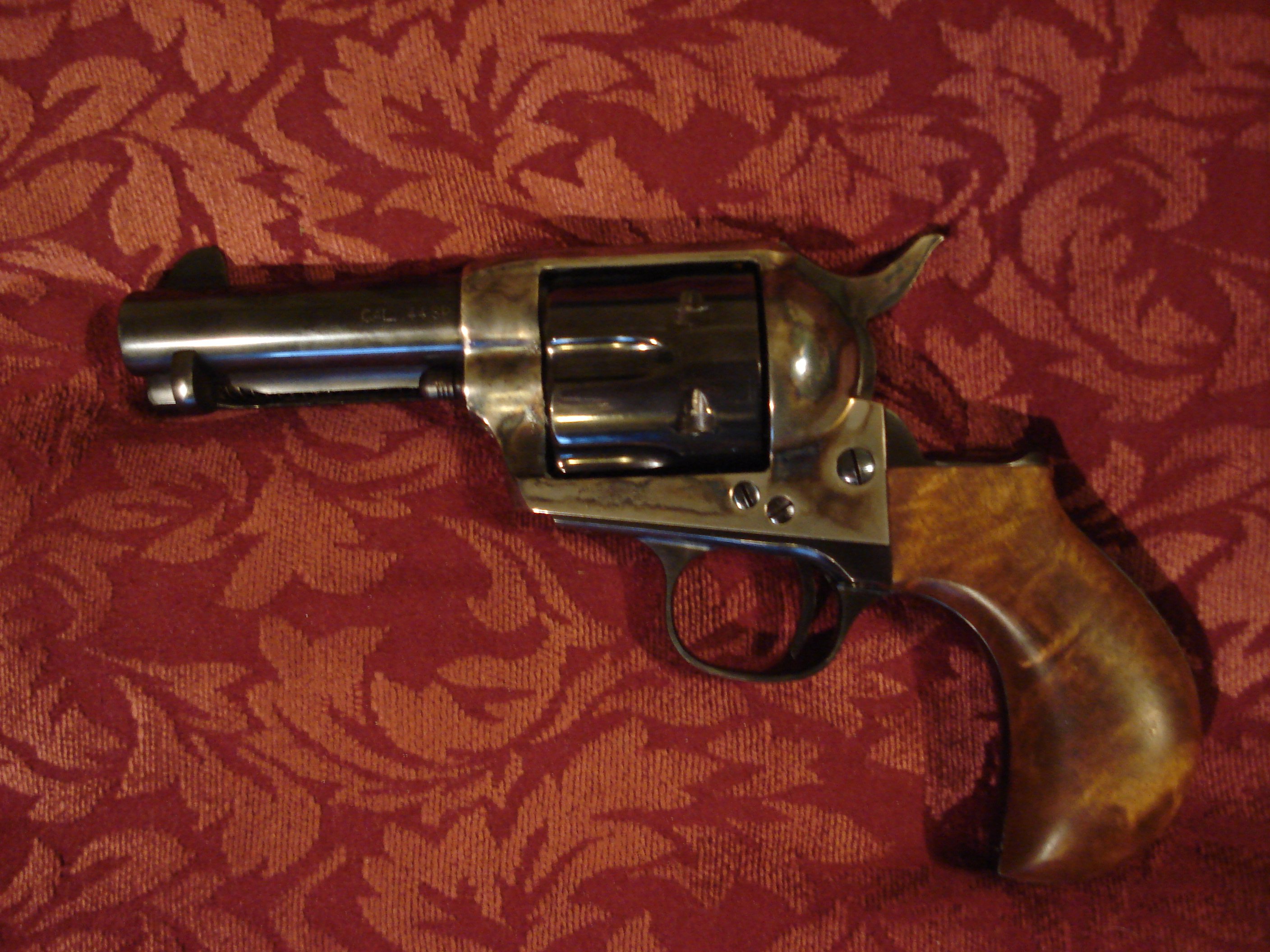

Rooster Ron Wayne Posted March 3, 2025 Author Posted March 3, 2025 4 hours ago, Abilene, SASS # 27489 said: Link works for me, on my laptop anyway. I've always used Citristrip. You can expect the stock to be very light colored so expect to use dark stain. I've used Formbys and True Oil with good results for the finish but lately have been using Ballistol. This is just Ballistal ? I love the colors here .
Abilene, SASS # 27489 Posted March 3, 2025 Posted March 3, 2025 4 hours ago, Rooster Ron Wayne said: This is just Ballistal ? I love the colors here . Minwax special dark walnut stain, then Ballistol.

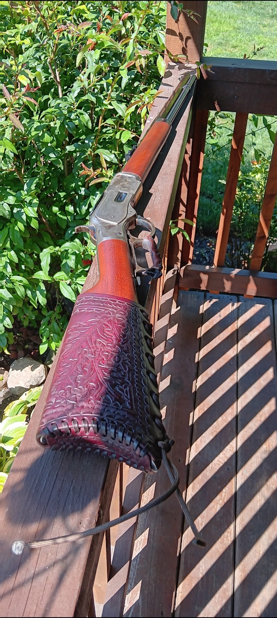

Rooster Ron Wayne Posted March 3, 2025 Author Posted March 3, 2025 This is my 24" Uberti 1873 44 Winchester. This is my favorite 73 of the three I have . This is the one I would like to redo the wood on. I think it would look beautiful with some natural looking wood instead of the red Uberti stain .
