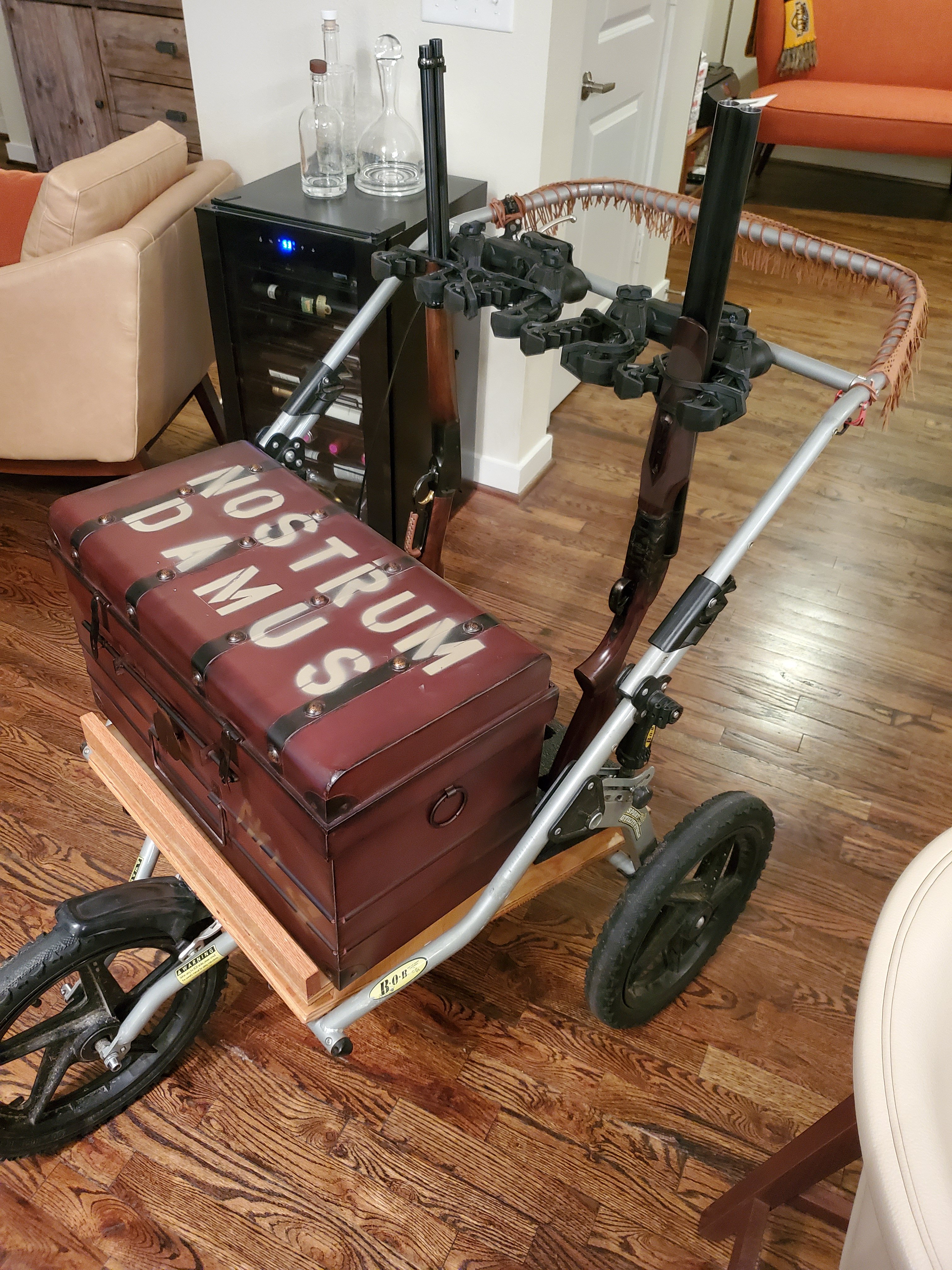

Nostrum Damus SASS #110702 Posted March 4, 2025 Author Posted March 4, 2025 My cart is built on a "twins jogging stroller" -- double-wide three-wheel base, heavy wood platform for the long gun butts and on which also sits an always too heavy "trunk" full of the goodies. Neither stability nor ballast are any problem. 1 Quote

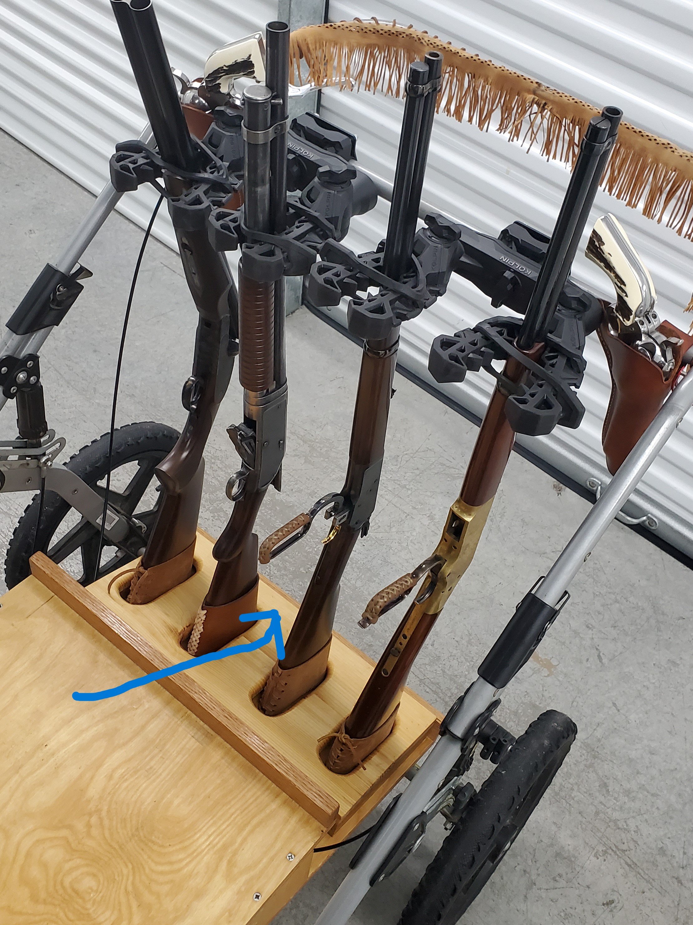

Nostrum Damus SASS #110702 Posted March 4, 2025 Author Posted March 4, 2025 (edited) And that gap in the center between the double gun holders is just the right place to install a PVC pipe mount. The bottom end of the beach umbrella will sit in a hole in the butt holder section. Sounds like a plan. The hole to receive the end of the umbrella will be where the blue arrow is pointing. Edited March 4, 2025 by Nostrum Damus SASS #110702 2 Quote

Nostrum Damus SASS #110702 Posted March 4, 2025 Author Posted March 4, 2025 (edited) All good stuff, thanks again. Mine will require some clever Rube Goldberg gadgetry due to the way the whole thing folds up to nothing when not in use. I've already had the kind of umbrella that just clamps on to the handlebar -- it was sub-optimal at best. I can't, however, permanently attach the lower section of a beach/patio umbrella because the handlebar folds at the hinges just above the wheels, up and then forward and then over (upside down) for stowage. There are solutions to every puzzle. Edited March 4, 2025 by Nostrum Damus SASS #110702 Quote

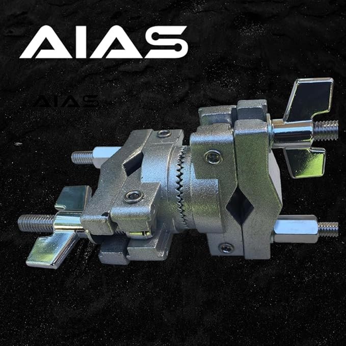

Nostrum Damus SASS #110702 Posted March 14, 2025 Author Posted March 14, 2025 I ultimately used a $17 beach umbrella (from Amazon) and spend the big bucks ($39.95) on a 90-degree clamp to secure the thing to my cart. I used an adjustable 90-degree drum kit clamp: Quote
