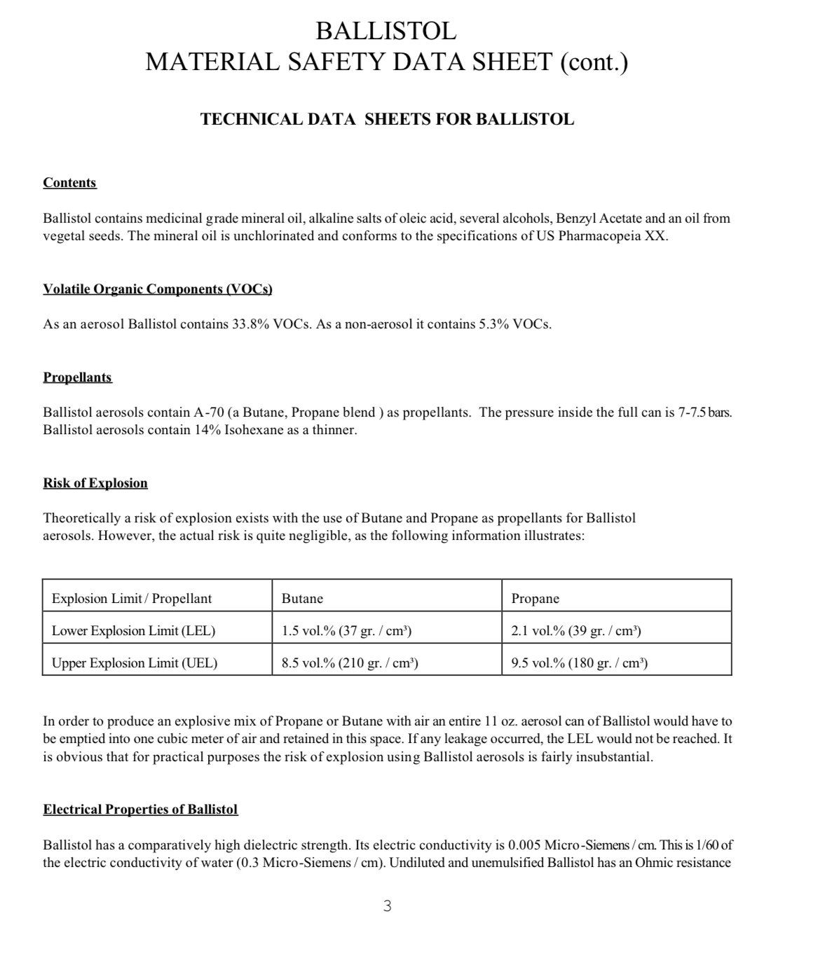

J-BAR #18287 Posted March 5, 2025 Posted March 5, 2025 21 minutes ago, Nickle said: I never see balistal for sale retail in my part of Alberta. I know it because I see Hickok 45 and Mike Bellevue using it. Shipping would be to expensive because spray can and stupid regulations. Is all balistal the same? What makes it different than gun oil that would cause more black powder fouling? I guess it's synthetic and that makes it good? Example oil like 3 and 1 oil gels up over time so it's not a good gun oil. I know regular Lithium grease is the worse thing in the world for bullet lube and black powder. You would be better off shooting unlubed bullets! A page from the Ballistol MSDS: Ballistol is primarily medical grade (food grade) mineral oil. If you can't get the real stuff, you might try edible mineral oil (drugstore) as a substitute. I haven't done this, but it seems reasonable. 1 Quote

J-BAR #18287 Posted March 5, 2025 Posted March 5, 2025 (edited) 7 minutes ago, Nickle said: I'm going to have to look into this. Mineral oil is everywhere here in different grades from the drugstore where my wife works to UFA agriculture store that sells different grades. For black powder lube or to use oil in your barrel there apparently is a big difference between synthetic and conventional oil. If I Google Mineral oil it just says it's comes from refining petroleum. One of the nice properties of Ballistol is being able to dissolve in water. I suspect the addition of those alcohols helps it mix with water. You might have to experiment with some additives to the mineral oil to get it to behave like Ballistol. Good luck! Edited March 5, 2025 by J-BAR #18287 1 Quote
