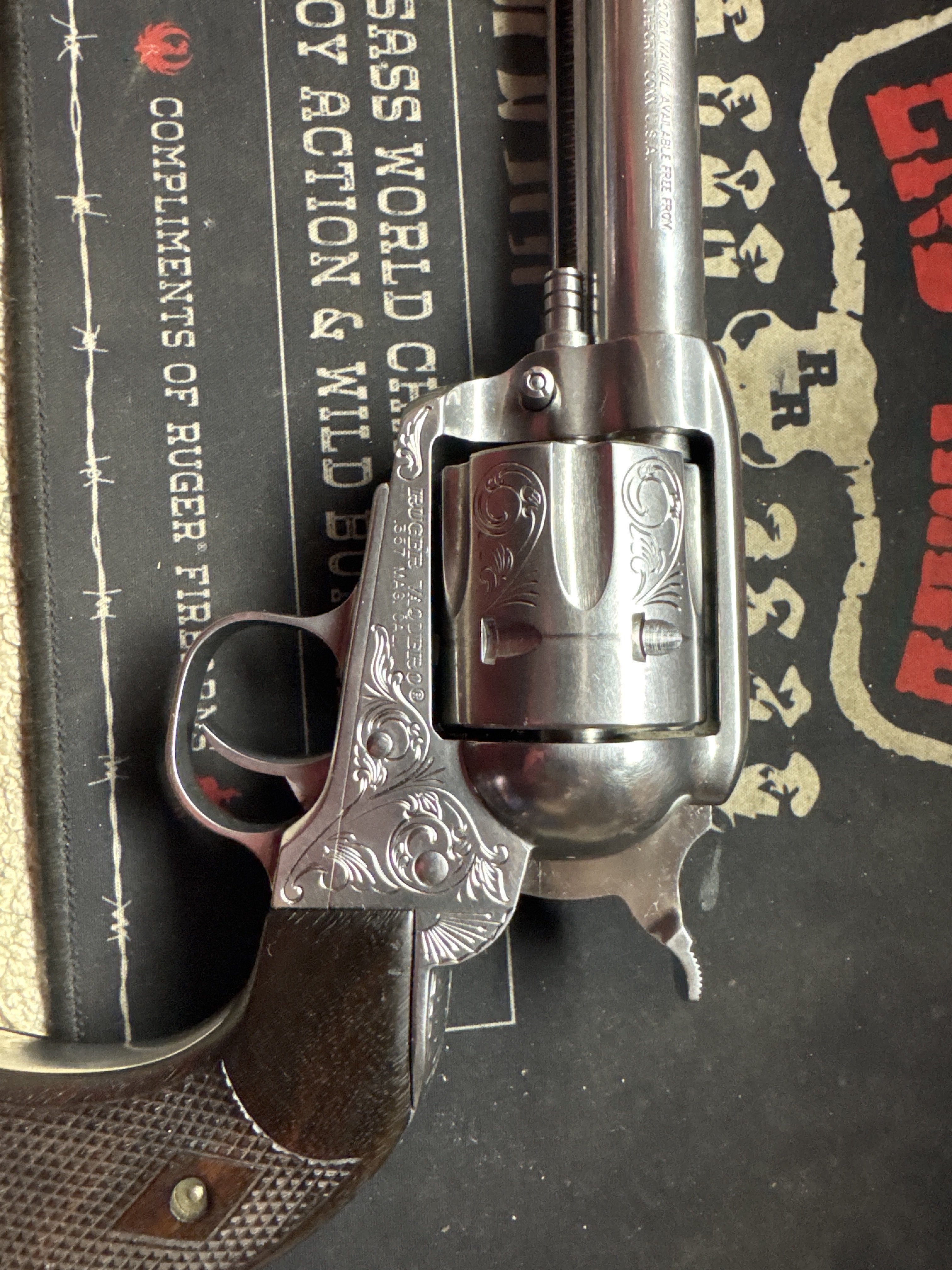

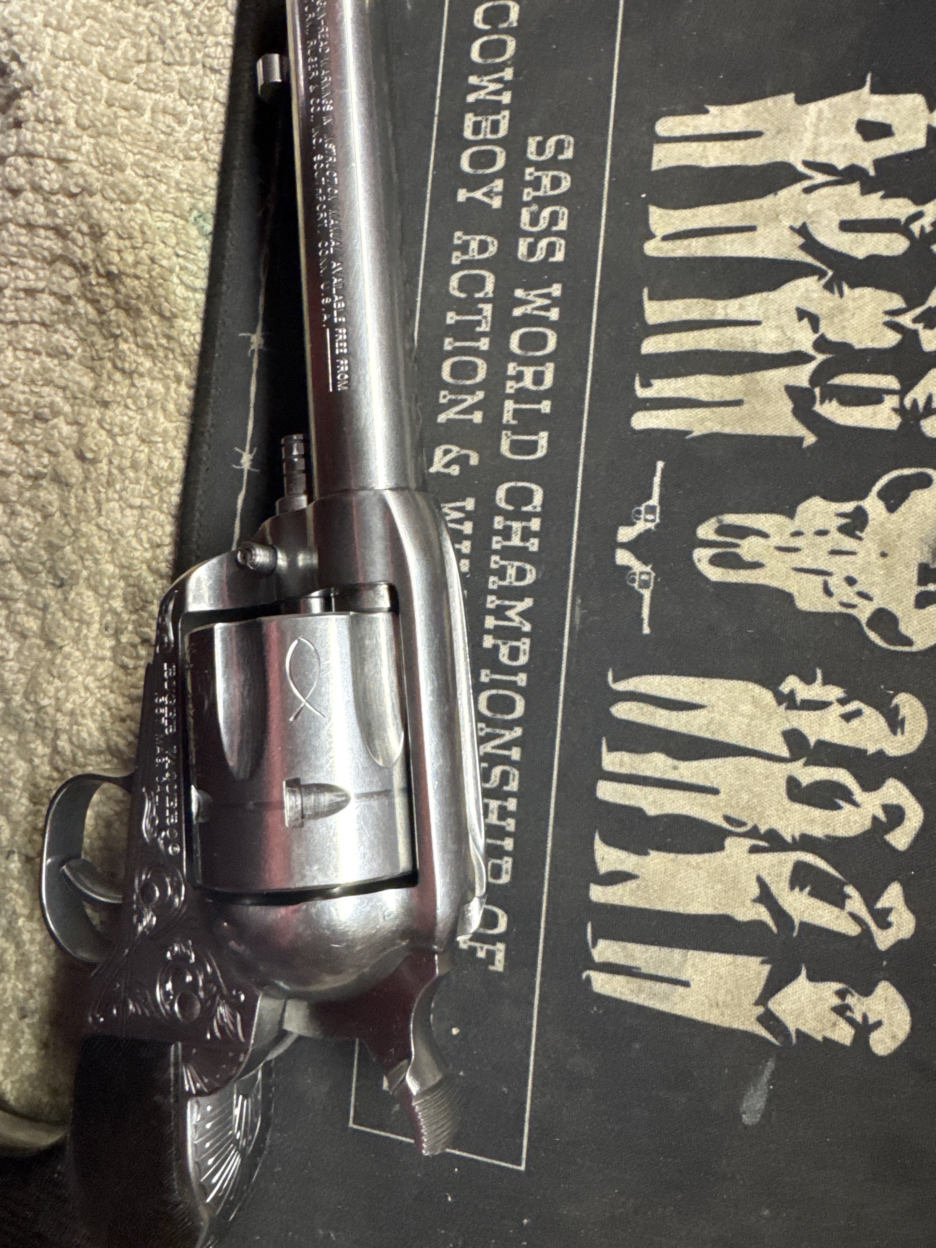

Gateway Kid SASS# 70038 Life Posted February 16 Posted February 16 Guess I am at a loss as to why you don’t want to permanently mark your reload chamber. When I coached 4-H Western Heritage we required some kind of mark whether it be engraving or nail polish. My personal Single Sixes you can’t see the 22 rim from the side, same for my Wranglers and some of the other brands. SASS main match Rugers, five of six chambers have curly stuff, one has a “fish”. As far as re-indexing I just open the loading gate, insert cartridge, rotate till “fish” is positioned as shown, close gate, cock hammer and fire. As far as excessive wear not sure how that would work, since you normally have the empty lined up with the barrel anyway. Biggest thing I found was in the “old days” our reload target was usually a KD of some kind so I used a 357 magnum with 158 gr at 850-875 fps instead of my normal 38 special 125 gr at 750 fps. Having a chamber that never had a carbon ring took the worry out of the reload. YMMV Regards Gateway Kid 4 Quote
