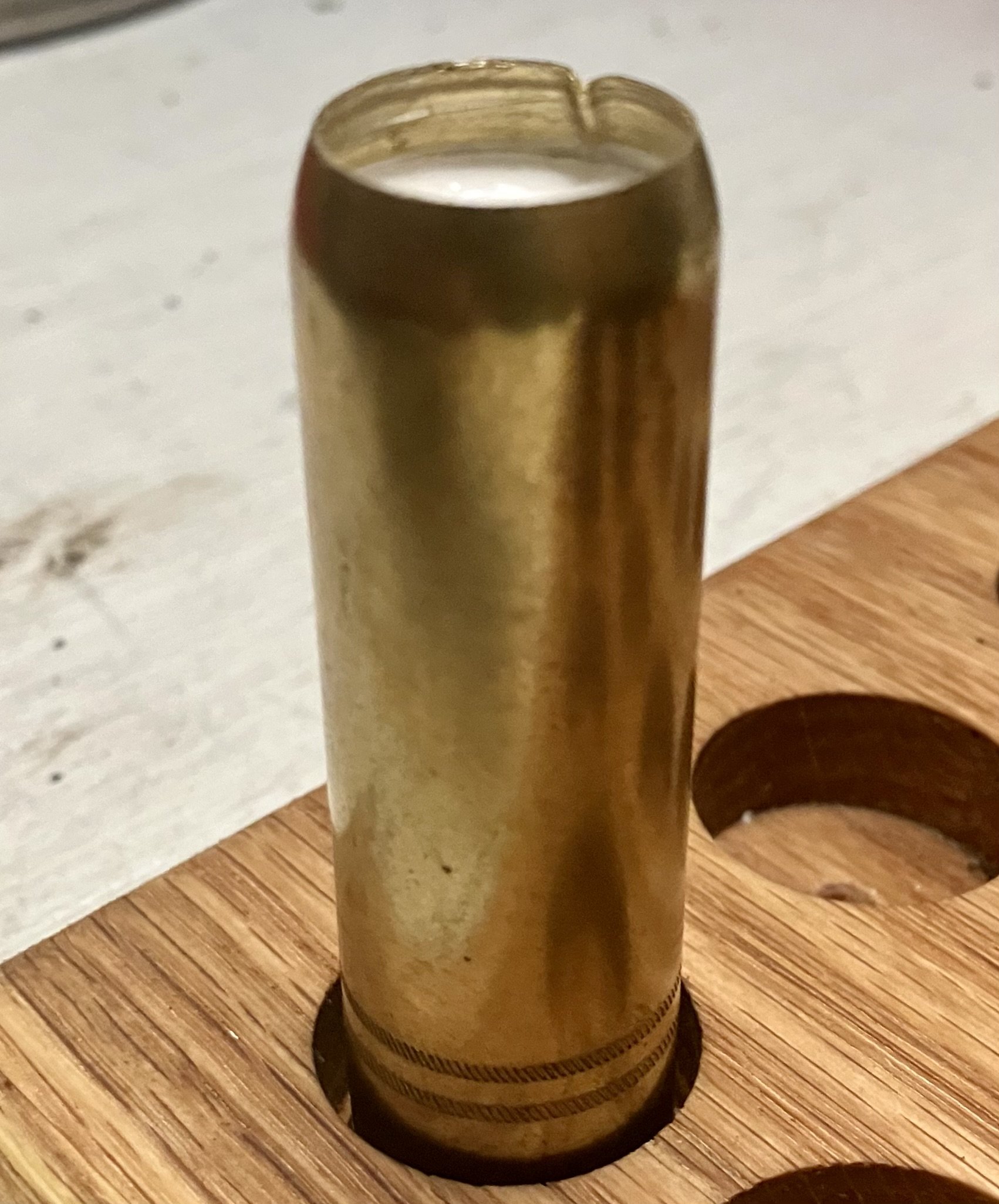

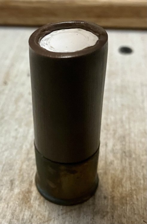

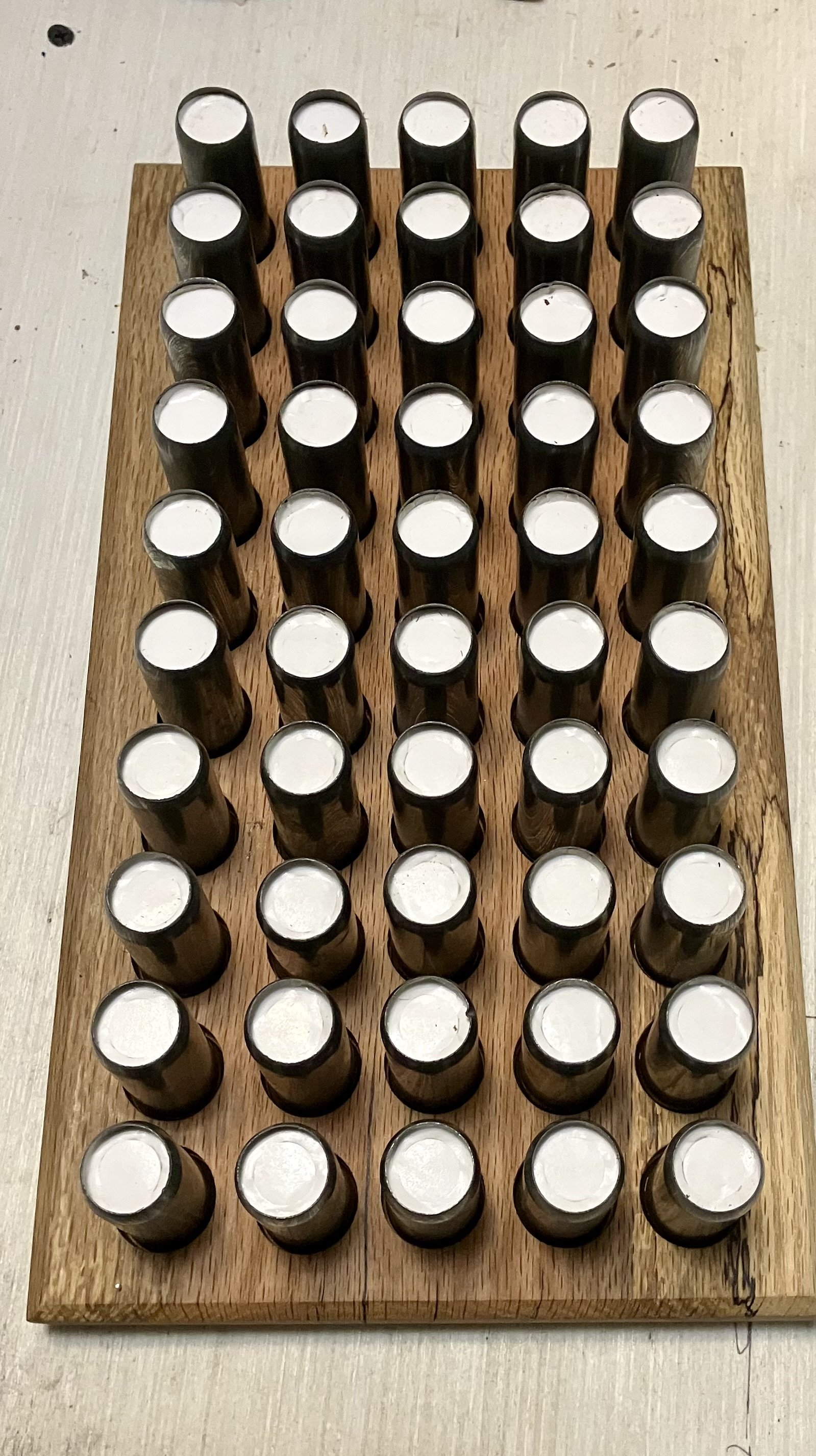

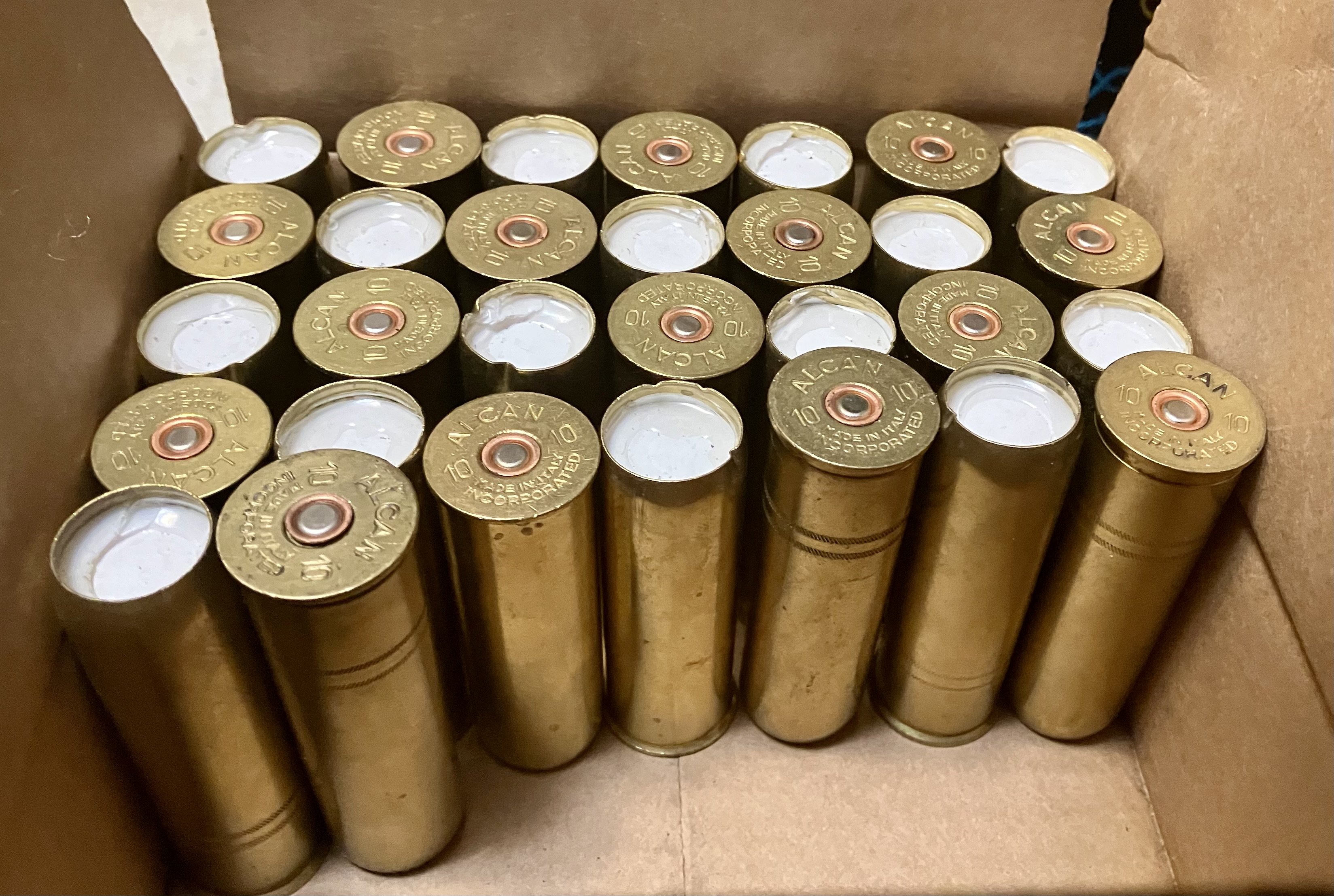

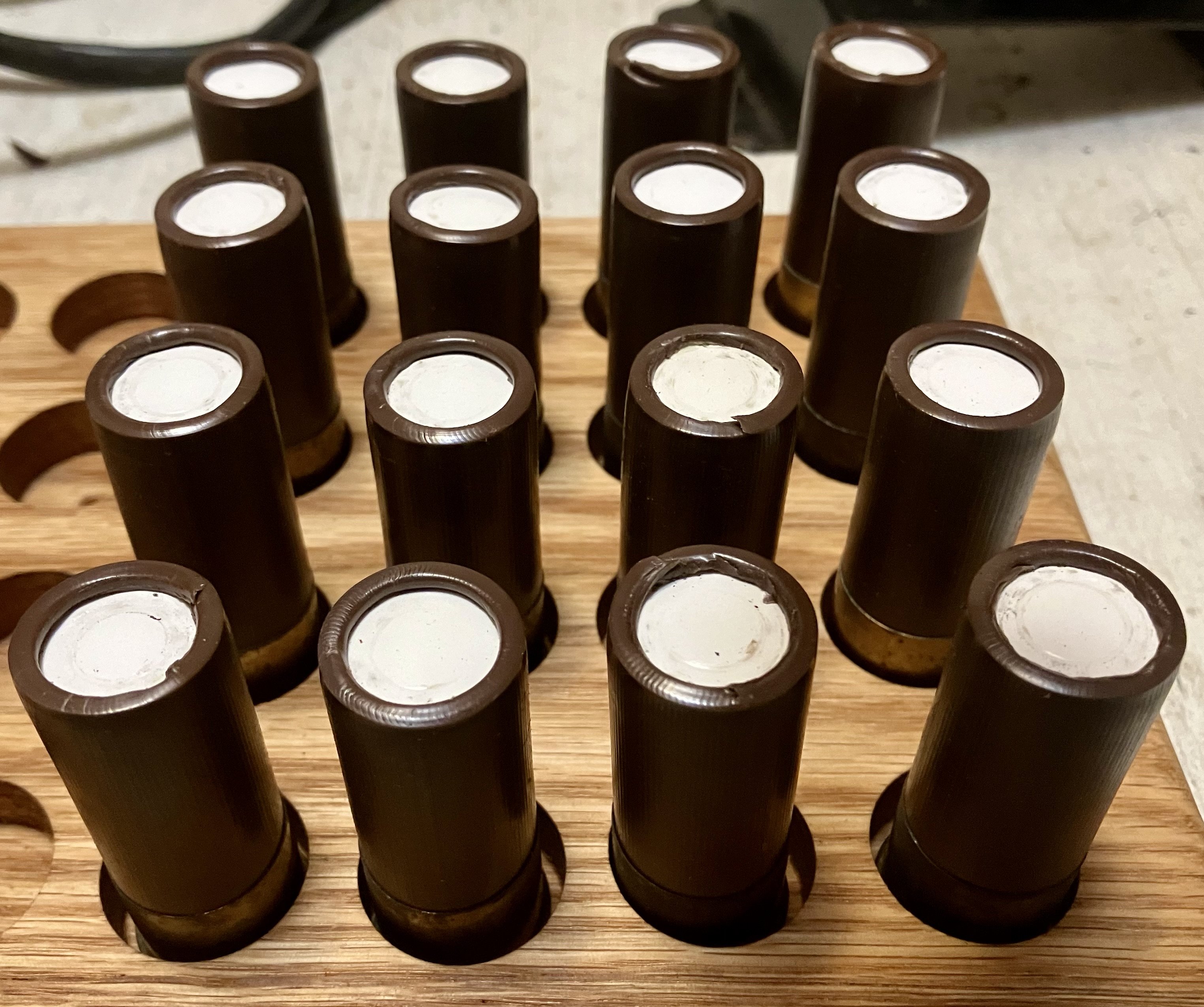

Blackwater 53393 Posted February 12, 2025 Posted February 12, 2025 There are a couple of outlets for 10ga 2 7/8 and 2 5/8” shells on the interweb. They’re usually pretty expensive and limited quantities. Between plastic, paper, and brass I have around 250 rounds put back. I just bought another press for loading 10ga exclusively. I have a trimmer to shorten the 3.5” shells to the lengths that I use, so when I find other’s discards laying around, I’ll pick ‘em up. I can buy the new, primed 10ga shells from Ballistic Products cheap enough to make it worth my while to cut ‘em down and load ‘em up and I can recondition used ones too. SO! YES! You can buy 10ga shells, often locally, and they are even available in the shorter lengths if you’re willing to look around.

Warden Callaway Posted February 12, 2025 Posted February 12, 2025 When I was trying to load for my first old double, I asked everywhere, gunclub, cowboy shooting buddies, at gunshops. Everybody knew someone that shot 10 gauge, they'd get me some hulls. None came up with any. I finally bought a hundred from Grafs. Fiocchi, as I remember. I found I could only get a couple of uses until they burned through. Son lives in the frozen north where they hunt a lot of waterfowl. But he said few that had 10 gauge didn't reload so didn't bring the hulls home. I lucked into brass hulls so use them. Grafs shows 10 gauge brass hulls available in many lengths. Expensive. https://www.grafs.com/retail/catalog/category/categoryId/4040
Stump Water Posted February 12, 2025 Posted February 12, 2025 As the Warden said, all I've ever seen in the store is waterfowl loads. When I got the '87 I found a lot of once fired, high-brass, 3.5" Federal hulls on gunbroker. Look just like the ones Blackwater posted. Trim 'em and load em'. When done they look just like the ones Blackwater posted. BP only in the 1901 '87. . .

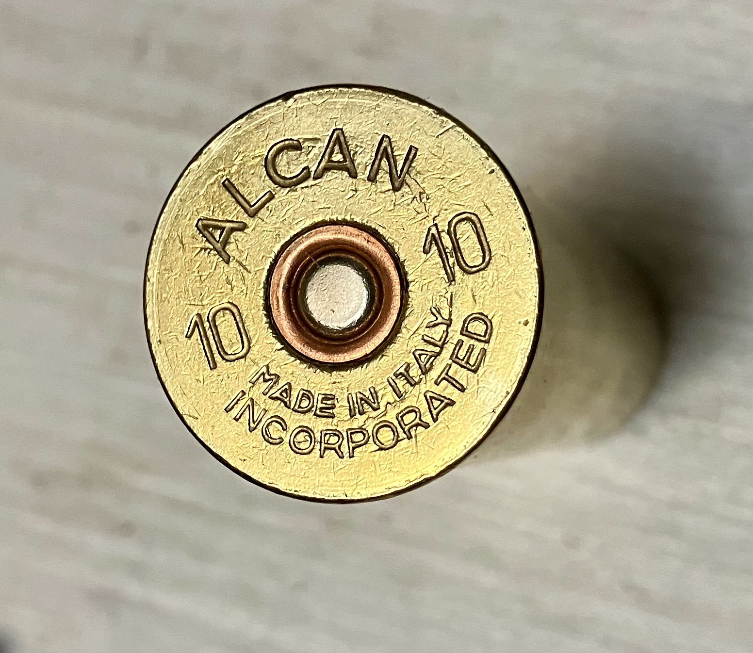

Warden Callaway Posted February 12, 2025 Posted February 12, 2025 I've never crimped my brass cases. Never sized them. They fit ok in every gun. But I've only used light black powder loads. My homemade priming tool.

Chantry Posted February 12, 2025 Posted February 12, 2025 I have 3, 1 modern Spanish 10 gauge with 3.5" chambers and two antiques. Everyone knows when I light off the modern 10 gauge since it 120 grains of 1F or 2F and 1.5 ounces of shot. The other 2 are loaded with 65 grains of 1F or 2F and 1.5 ounces of shot. I load my own BP loads and have a mix of about 75-80 brass hulls. I have some plastic factory, but with BP they don't last long. Smokeless factory is available, but's it pricy and you'll find a better selection online.
